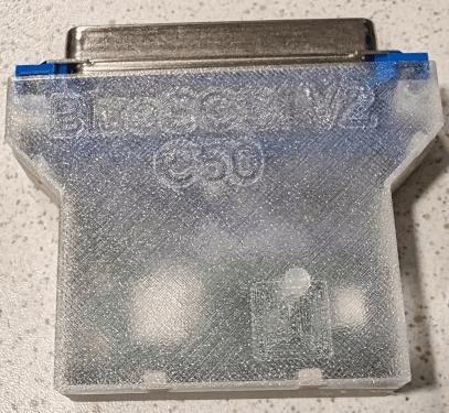

A new version of the BlueSCSI V2 Centronics 50 Pin is now available:
Like it says in the URL, this is literally a shorter version of the previous design.
Similar to the smaller DB25, it's over 1cm shorter than the prior version and has termination always-enabled.

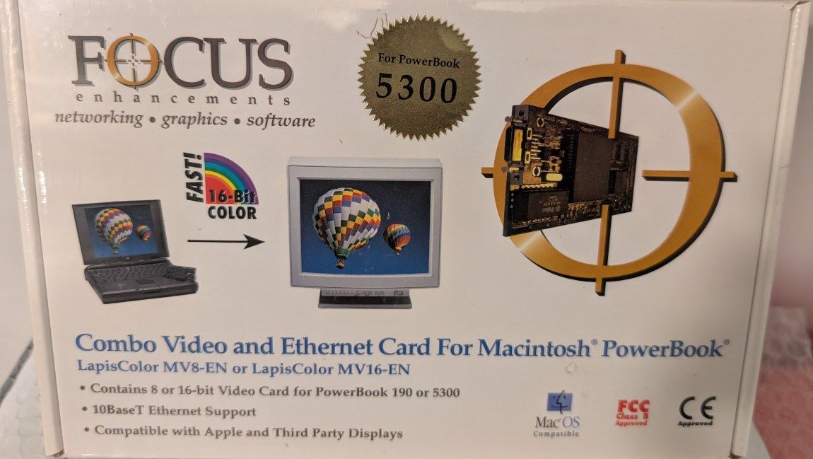

Another "New Old Stock" product has been added to my store, the Focus Enhancements LapisColor MV16-EN for PowerBook 5300. That's quite a mouthful. This expansion card gives you both an external display output *and* ethernet on the same card - pretty cool if you ask me. A version of this card did exist for the PowerBook 190, I've just never seen them "in the wild".
Also in the New Old Stock section, prices have been cut by a few dollars across the board.
Are you sure it doesn't work in the 190? On the back of the box:
These are the 5300 model number, so I would presume they don't work in the 190. The back of the box shows that the 190 model has a different part number, so it's probably something like the onboard ROM is different between the two.
