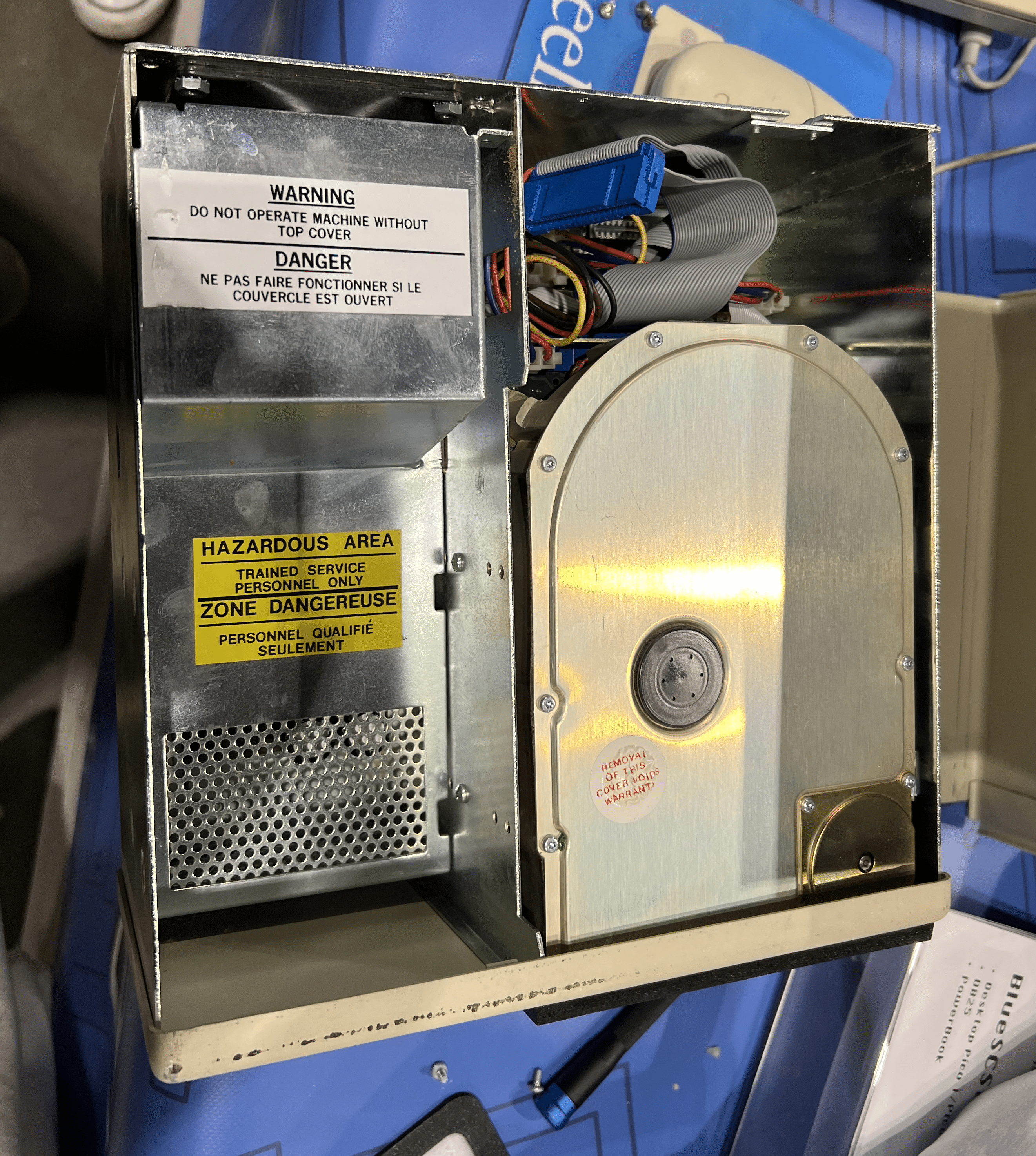

Hey all,

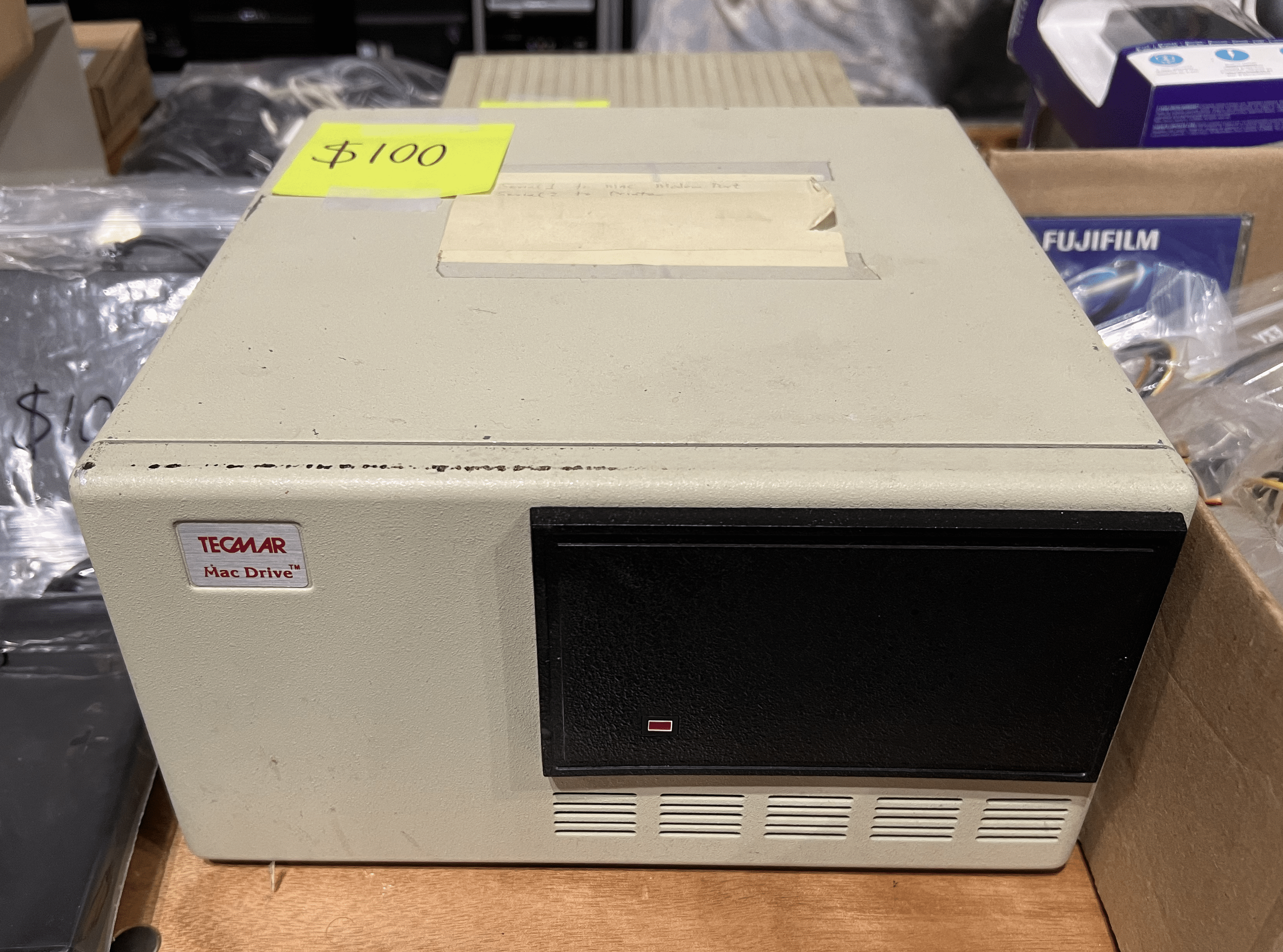

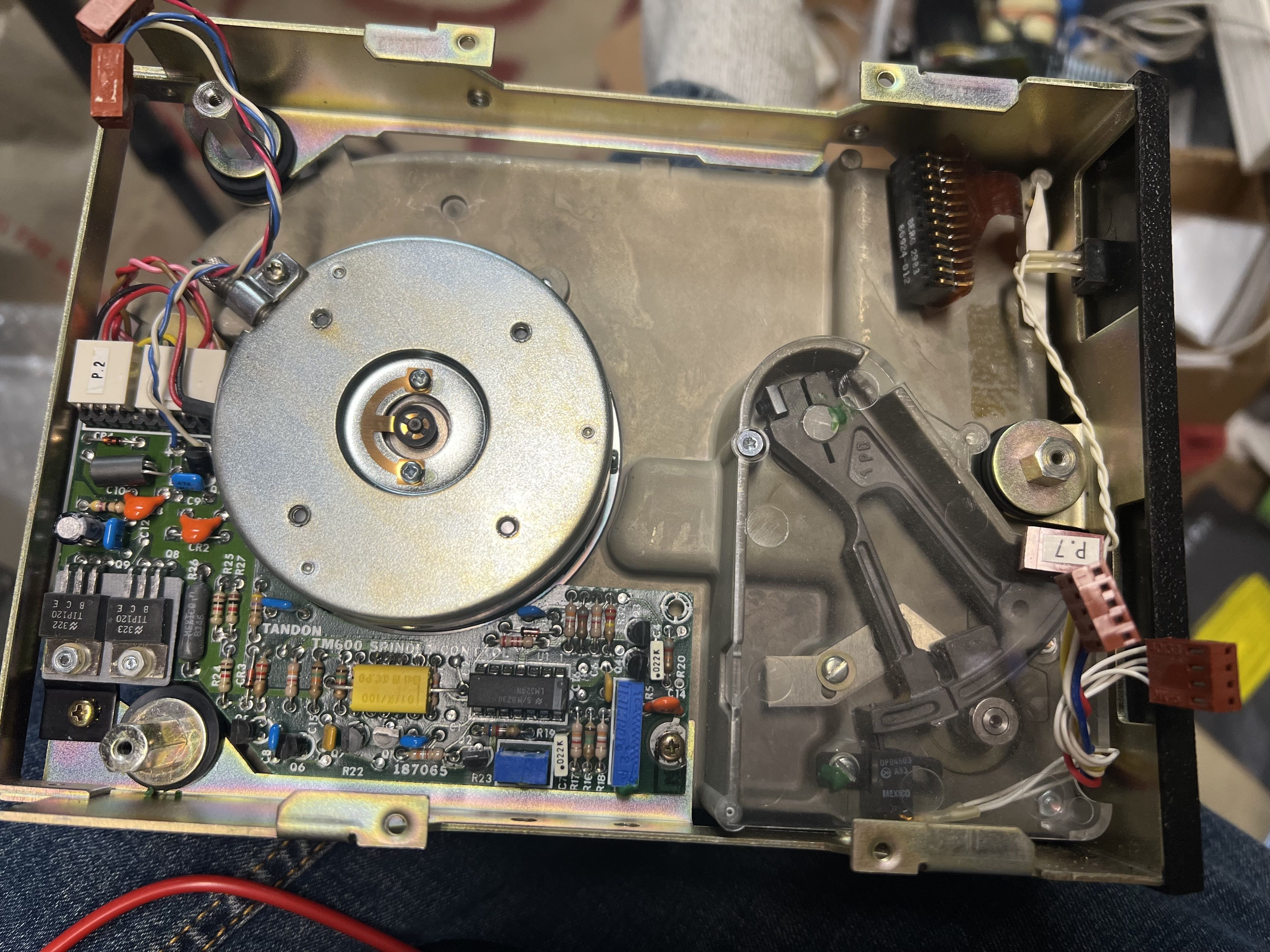

I wanted to share something neat I picked up at VCF Midwest this year, a Tecmar Mac Drive, perhaps the first external hard drive for the Macintosh. This drive uses a serial port to connect to the Mac, and some software shenanigans to get around the storage size limitations of the initial Macintosh file system.
The seller, Peter, who's a fan of the channel, graciously accepted my $40 offer for this hunk of metal. And boy, is this thing a chonker! It took the combined strength of me and @eric to open the case. Inside appears to be a 10MB MFM hard drive by Tandon, model TM 502. Despite not wanting to risk blowing the two RIFA caps in the unit, which looked a bit cracked, I was gently peer pressured into turning the drive on.

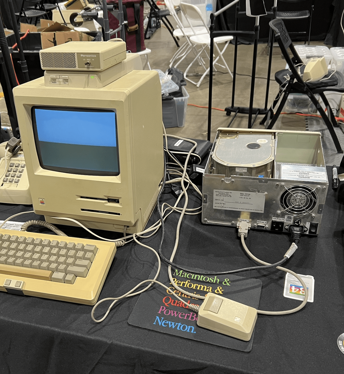

Thankfully, no explosions happened! The drive spins up, and the red light on the front blinks periodically. I can't see or hear the head moving. Although when it's off, the greased wheel toward the front of the drive allows the head to move.

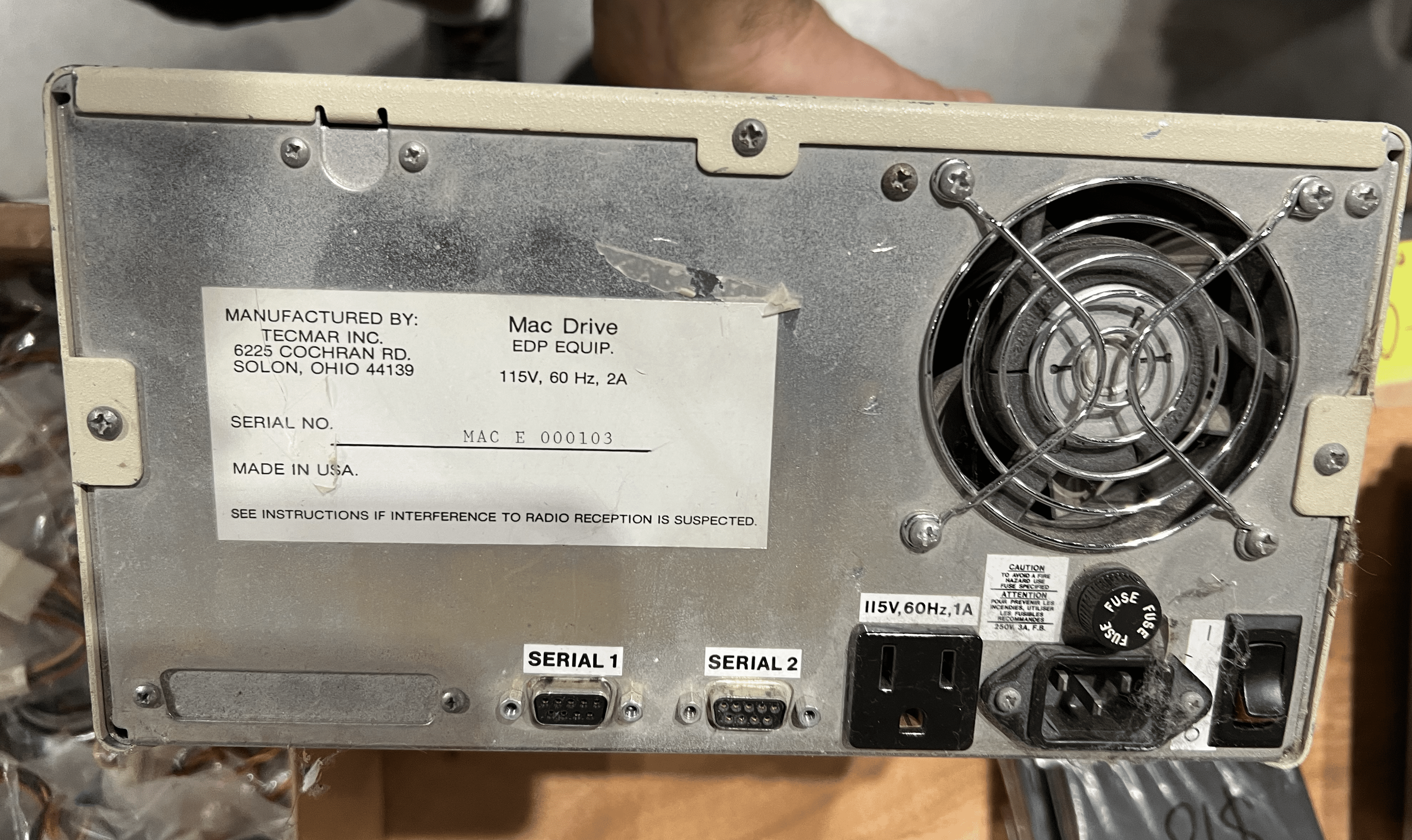

It didn't come with any cables, but I used a straight through serial cable from the free pile to plug in the drive to my Mac 512k. However, the Tecmar software (we tried multiple versions) simply say the drive can't be recognized. It's unknown if that means it can't see the drive, or if the drive isn't formatted, or what.
So I'll have to tinker with it more... but I'm curious, has anyone else owned this kind of drive?❓
They made a model that had a smaller drive inside, but also had a removable SyQuest cartridge drive, which is cool. Apparently the model I have is the 2nd revision, as it has a 2nd serial port for plugging a printer into. BTW, the paper taped to the top of the machine says to plug the hard drive into the Modem port of the Mac, and plug the printer into Serial 2 on the hard drive.

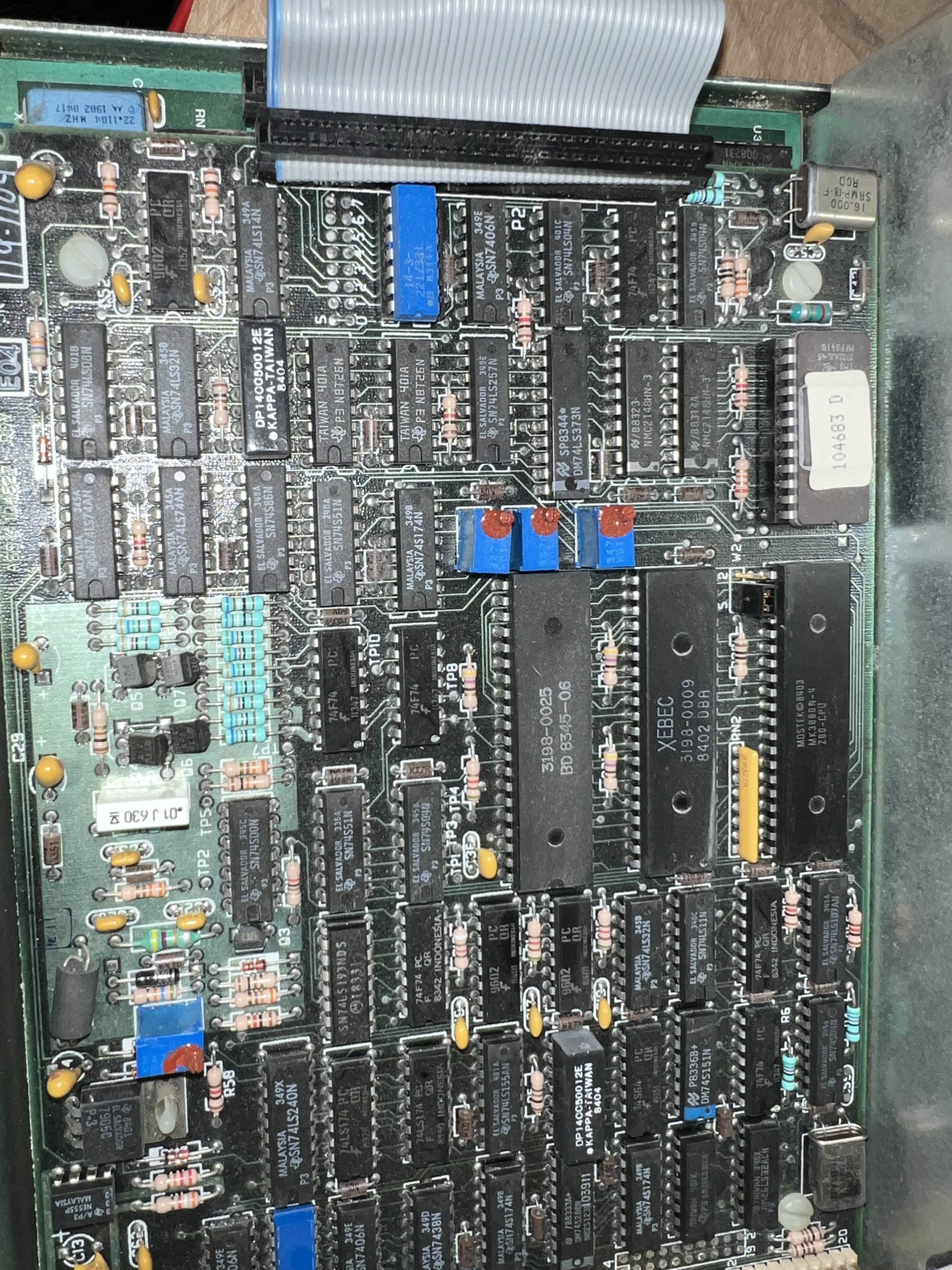

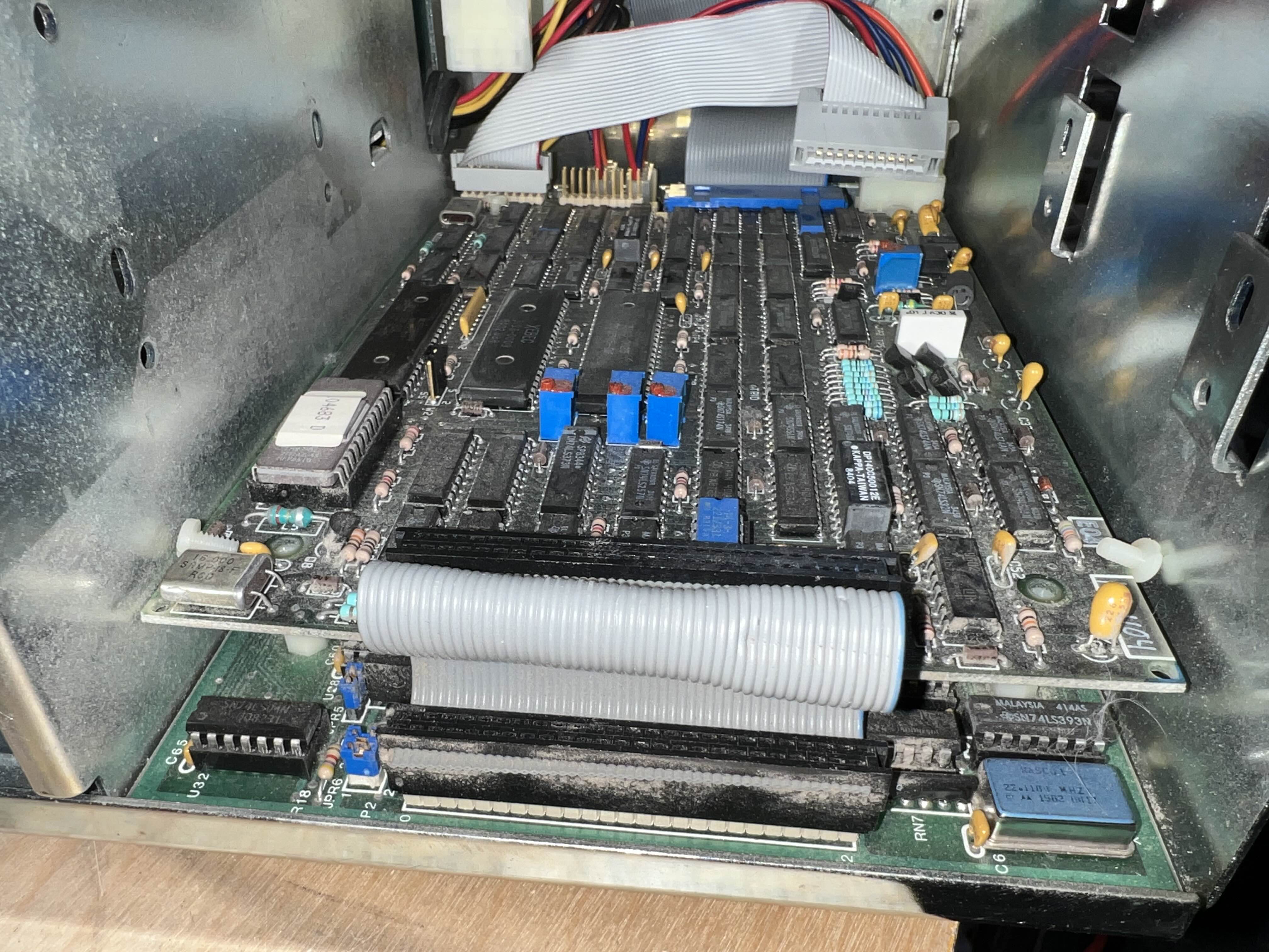

The drive has two layers of boards (at least) inside to convert it the thing to serial. Apparently some reports indicate that the drive can be converted to SCSI. There is a 50-pin ribbon cable on one of the boards, but I'd like to inspect the chips further to determine what signals actually may be being sent through it. Also, the software tricks to make this thing into multiple partitions may simply not work if connected via SCSI? Who knows...
I did end up replacing the two RIFA caps, just in case. The drive spins up and sounds normal, but again the head doesn't seem to be accessing. Perhaps this is only done once the software sends a command? Or maybe something inside isn't happy. 🤔
Either way, enjoy this chonk from 1985!

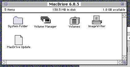

Thankfully the MacGUI article I linked to above (after you log in) has THREE versions of the Tecmar software, one of the later ones should even work with System 6.

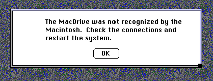

Sadly, as I mentioned above, the software simply says it doesn't recognize the drive. So it could either be not formatted, not functioning correctly, or not plugged in correctly. 🤷‍♂️ I only have the one straight through serial cable, but I'm unsure how the original was wired. So many variables!

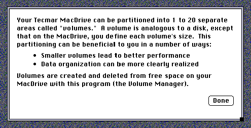

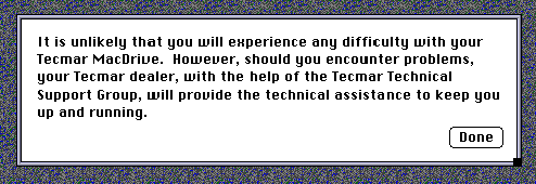

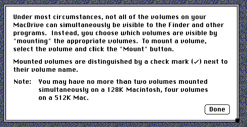

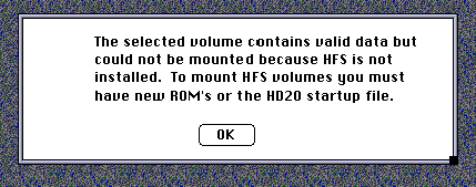

Out of curiosity, I opened up the Tecmar "Volume Manager" software (v6.0.3) in ResEdit and looked through the alert messages.
This is the message I'm seeing when I use the drive. It's kind of vague, but I'm assuming it means it can't find or detect the hardware.

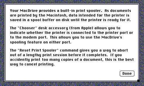

These are some other messages, which detail some of the functionality of the drive. Who knew the hard drive had a built-in print spooler, hah!
I wonder if the platters are the rusty color or the shiny type (don't open it to find out)? When I built my first satellite solar cooker, I only had 3 5.25" platters that were shiny (near the center of the dish). The rest were all 3.5" and 2.5" platters. But it cooked hotdogs in the winter.

Check the continuity on all of the serial cable pins. The MacGUI article indicates the drive clocks the serial port externally.
Use a serial breakout board to verify communication.
MacGUI said they had to leave the drive on for an hour for it to warm up and be recognized.
Try disconnecting the hard disk from the internal enclosure. I'll bet you get the same error message you are currently getting. which may indicate the issue is before the hard disk itself.

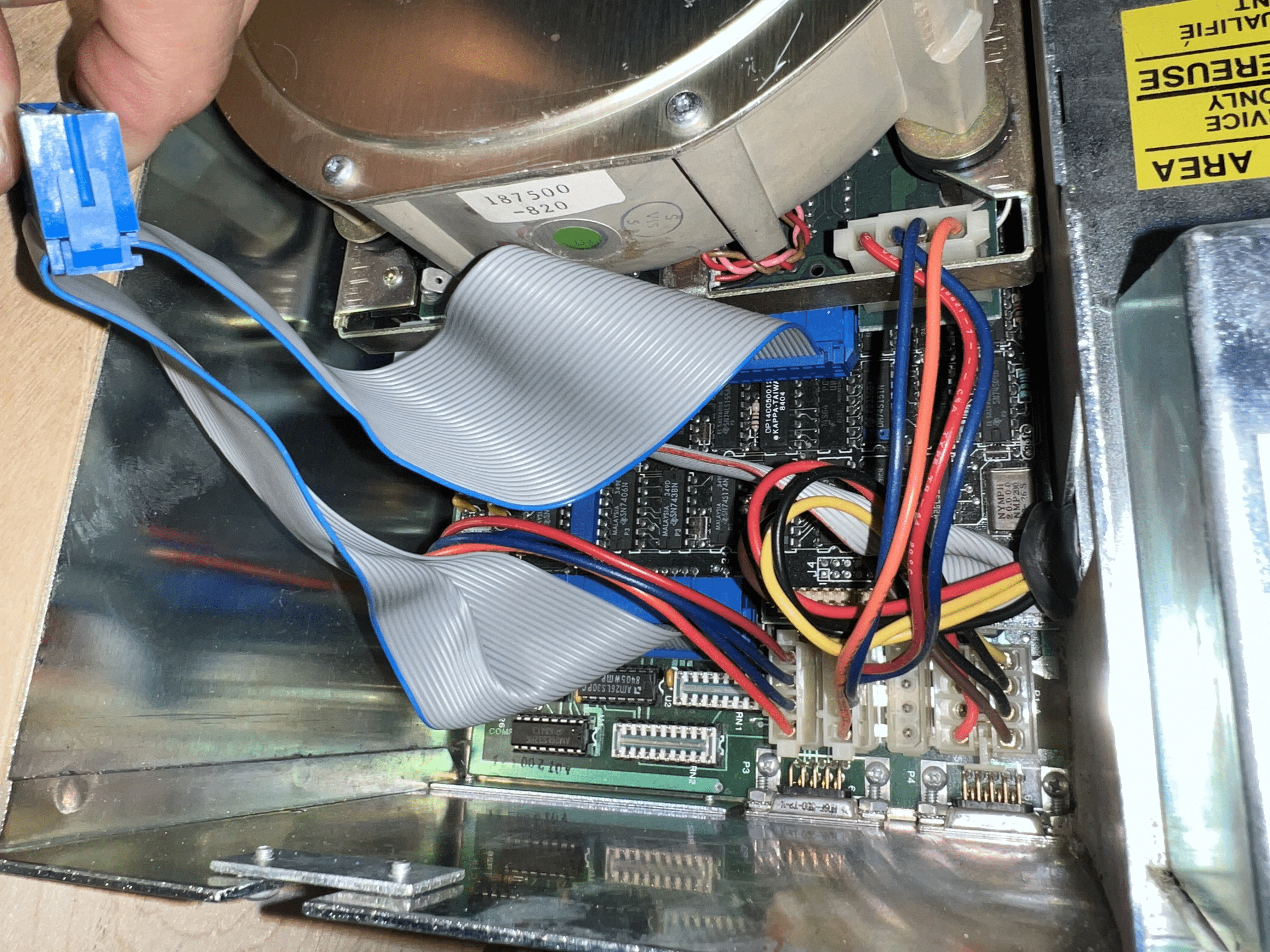

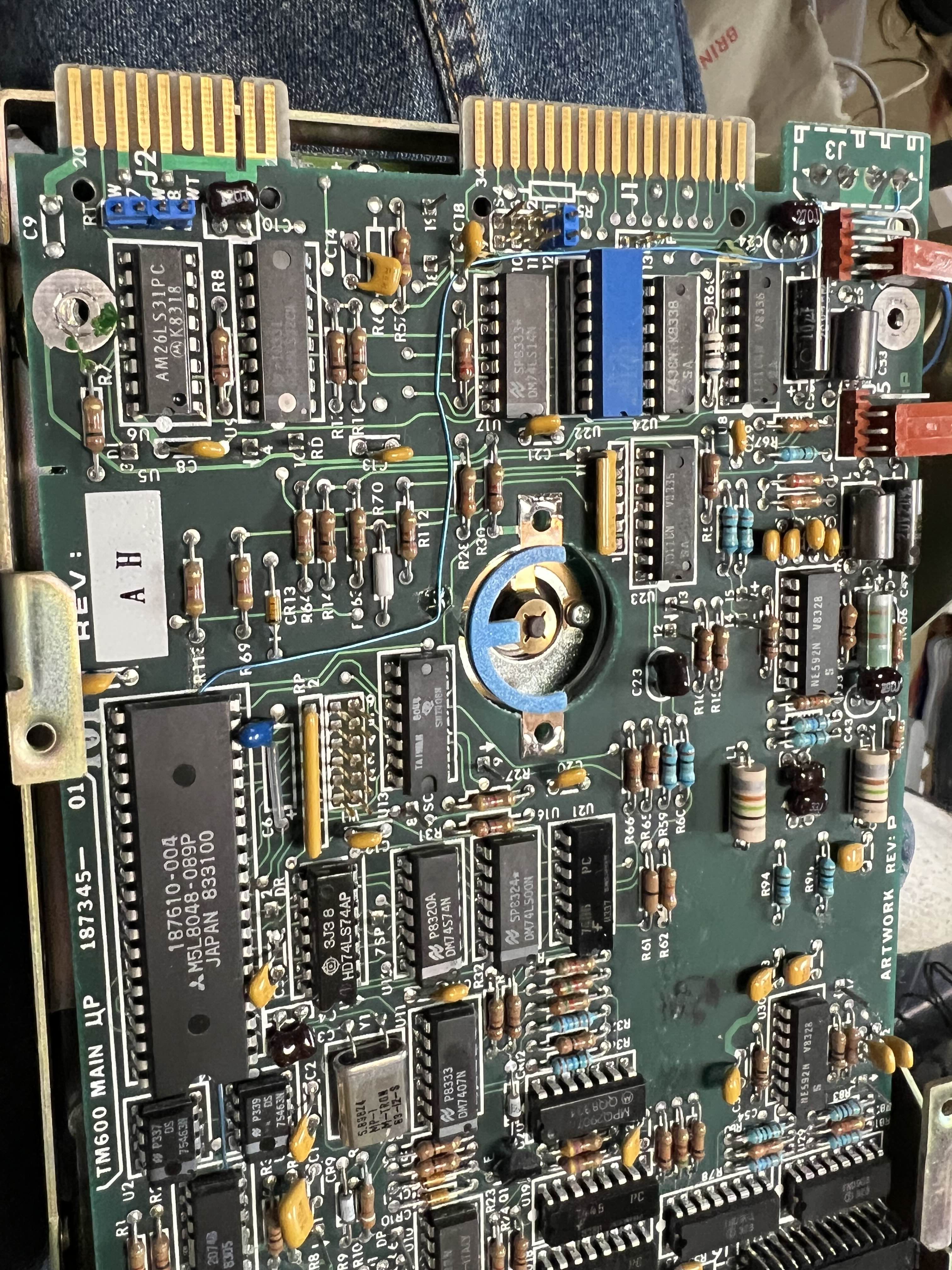

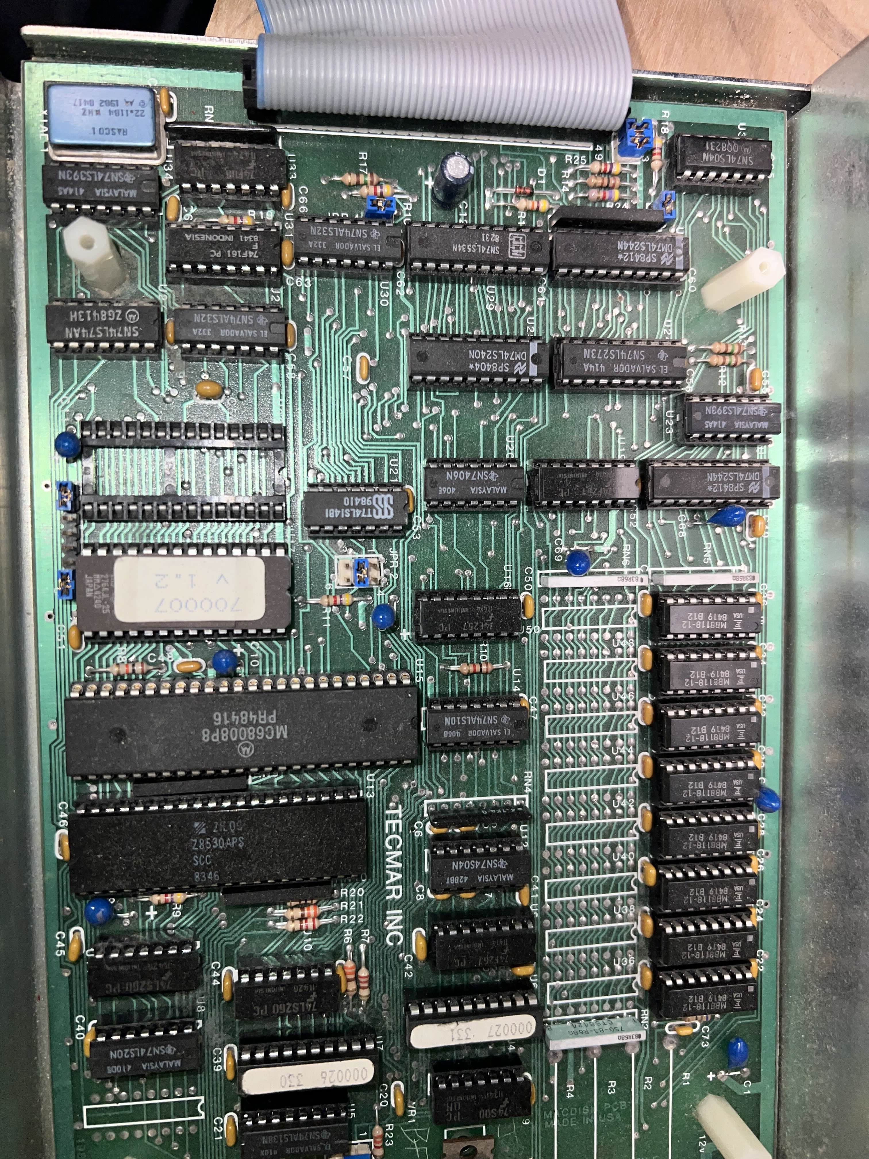

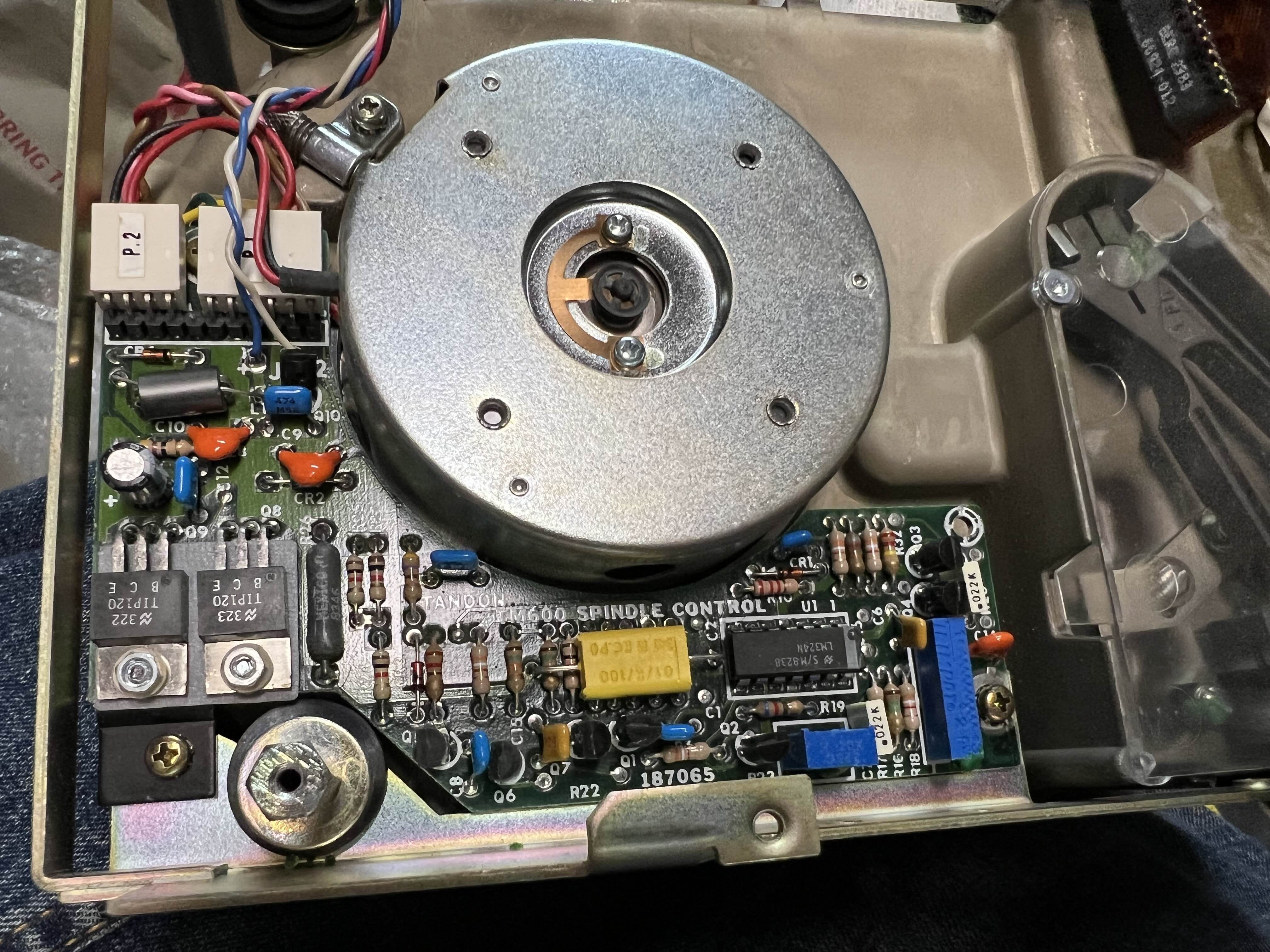

Here are some more photos of the boards... featuring a Z80 and a 68000!
There are certainly a lot of caps and boards to go through on this thing!

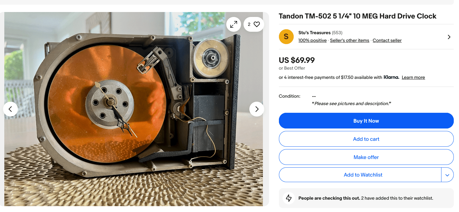

I only took a quick peek, but it looked like copper, similar to this "clock" someone made and posted on eBay of the same model drive. :oops:

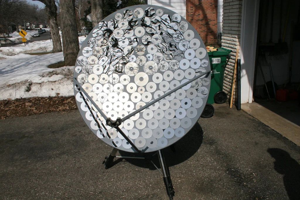

Well that was only my 4 foot dish. I have an incomplete 8 foot dish here with a George Foreman grill attached at the focal point. My 12 foot dish was dismantled and gone (1100 3.5" hard drive platters).
Well, with the HD removed from the enclosure, but everything else plugged in, I get the same error about the drive not being recognized.
I reseated a bunch of chips (but not all) and cleaned a lot of the edge connectors. The drive spins up, but I don’t see any head movement… maybe the sensor that detects the head position has failed… or something isn’t kicking off?
I'm expecting the drive head to move / make noises when power is provided. But then again, I'm not familiar with these drives... Hmm… 🤔

I assume the same message even with the serial port disconnected? I mean, I suspect this message is really saying "I can't talk to the Tecmar at all".
Correct, sorry for not stating that above.
So currently, I get the same error if 1) the drive is plugged in and turned on with a straight serial cable connected to the modem port. 2) the same (but with the HD removed from the case), or 3) with nothing plugged into any serial port.

I highly doubt the caps are the reason, but full disclosure, I did recap the drive mechanism in my HyperDrive Mac, in addition to its dedicated secondary PSU. But I had no issues with the HyperDrive kit prior to that
Not sure the lack of head movement is the issue. I don’t think there is any sticky goo that would prevent movement as there is in some Quantum drives. And if your peek inside didn’t reveal any rust (which I shouldn’t because it’s sealed), then the root problem is likely something else.
The HyperDrive software consists of various apps, and when I experienced the non booting, non mounting problem, most of those apps wouldn’t recognize the drive mechanism at all. I then found the correct HyperDrive app that did the low level format, and then it suddenly mounted and all other Hyperdrive apps could see and use the drive.
If that same exact drive mechanism was used in early PCs of the day, it would be interesting to see if one of those could mount it and format it.
