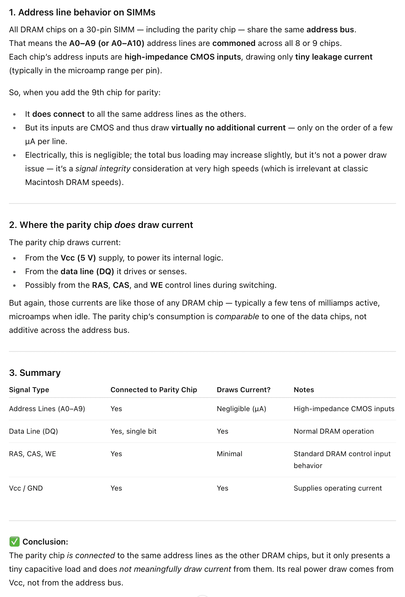

If the 128MB SIMMs have parity chips on board, removing those could make the difference by reducing load. Although, do parity chips draw current on the address lines?
The following info from ChatGPT needs to be vetted, but it does make sense...
