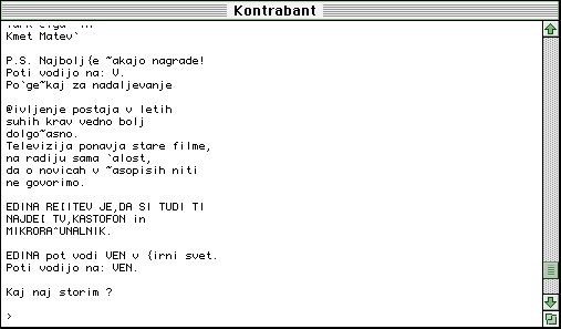

I want to finish text adventure game for Mac OS. The game should look like Zork for Macintosh 128/512k. Simple window, font, font size, maybe save/load game option.
Github files of the original game. I am not a programmer so I got help from cheesestraw from 68KMLA who does not have time for further development but he said I can use the code (See attachment kontra-2025-08b.sit). The game si playable but it needs Mac GUI tweaks. So I made resources in AppMaker for MENUs, WINDOWs and ALERTS (See attachment Kontra APP.sit).
What it needs to be done is to combine this with the game. Can anybody help here finish the game? Thanks!

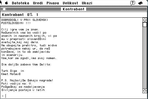

* Simple window -
* The Font menu would change the displayed text above.

Thanks to @nilobject this game is close to be finished! I am very happy with his work. Really appreciate his time and work on this project.
Not that he implemented all the code he also made a music that was in original game to play on a Mac what a amazing job.
