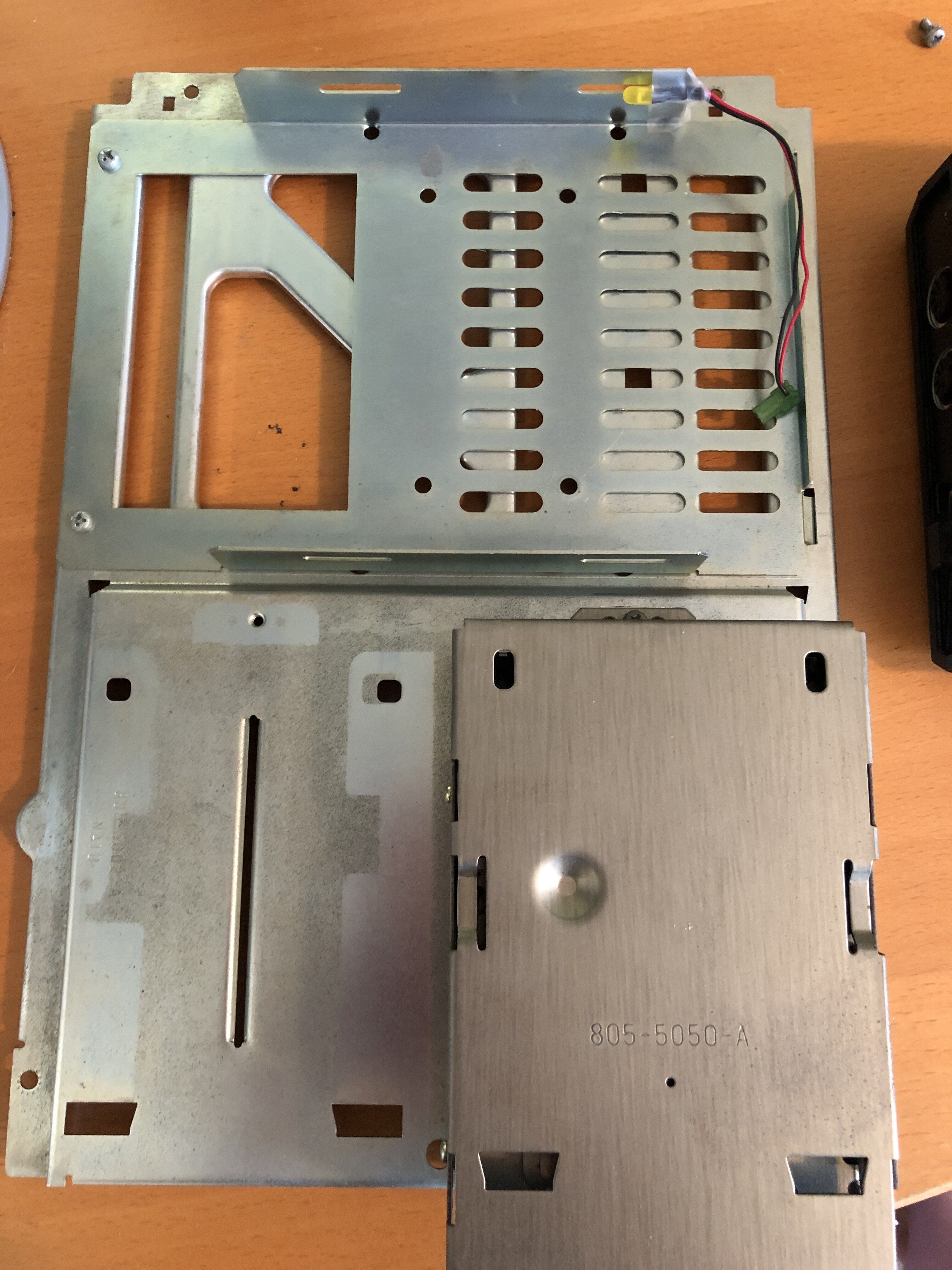

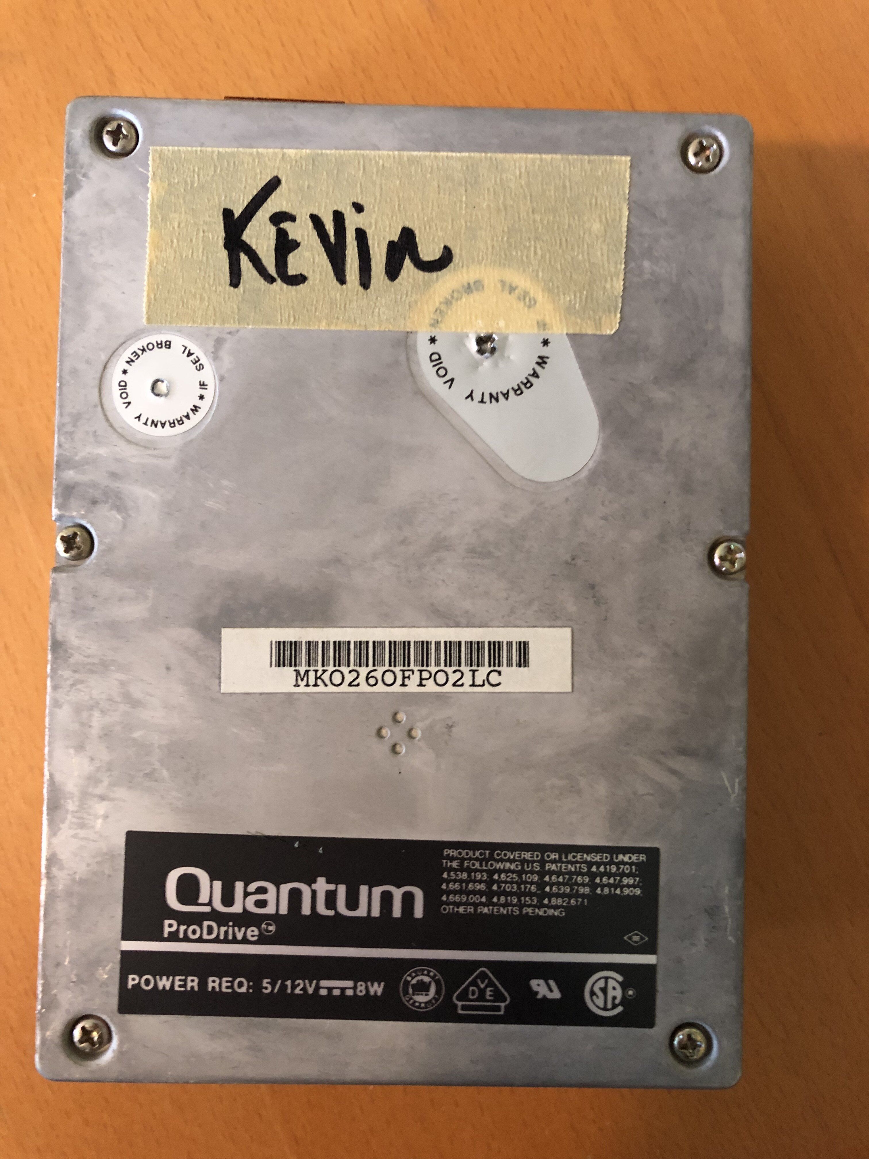

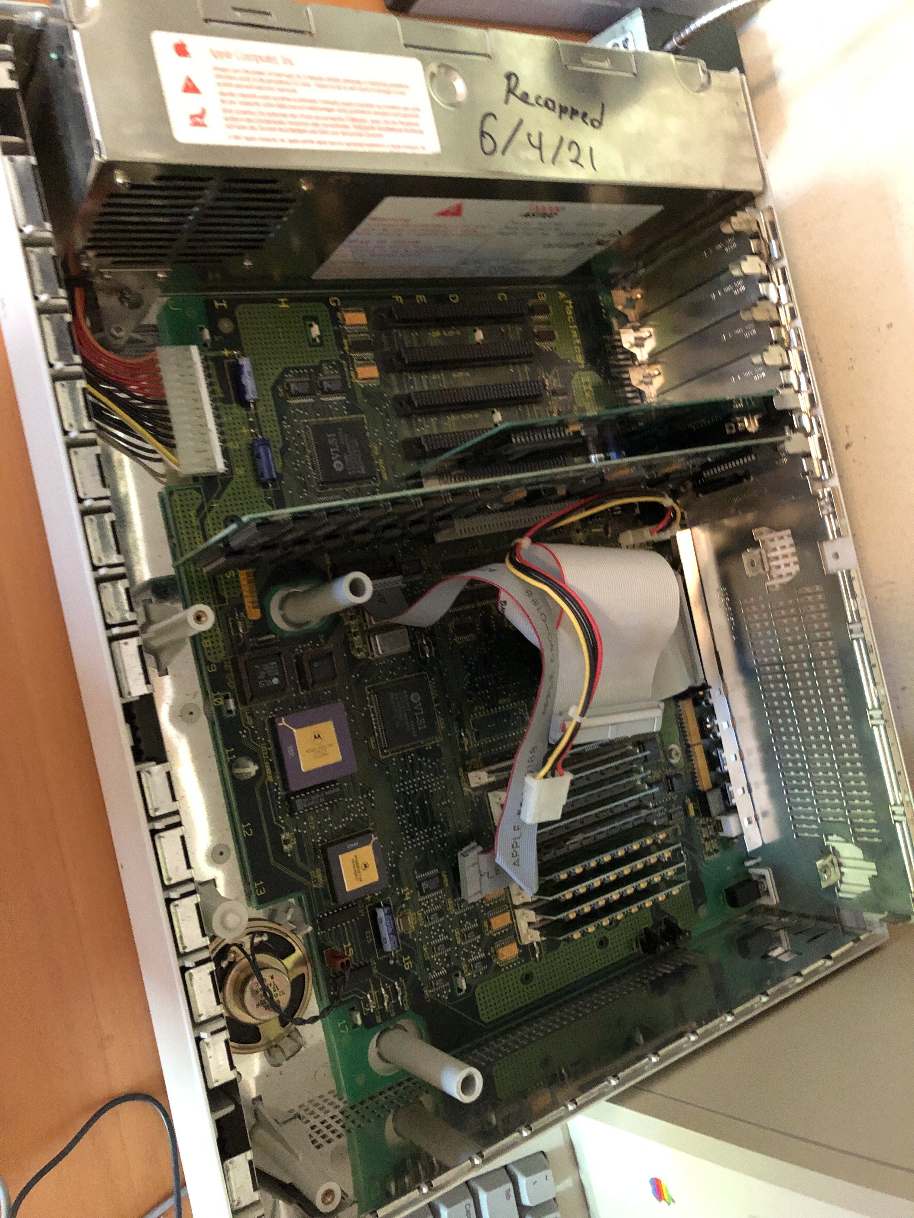

This afternoon when I went to turn on my IIx, the hard drive spun up but I got nothing but the floppy icon. This was pretty normal; my IIx has a thing where I need to restart the computer to get the hard drive to read. But when I did this, still nothing. I tried again and again, but still nothing. I eventually decided to open up the computer, and reseated the SCSI and power connectors. Still nothing, but now I could see that the activity light was solid. I knew the hard drive must be dead, so I took it out, and tried to open it. I thought that maybe the heads were stuck, and maybe I could get the drive to work again if I was quick. I was wrong, and with my clumsy hands, actually dropped an opening pick inside. I couldn't get the last screw out, so after prying really hard on the lid, I could get the pick to come out. I put the screws back in, knowing that I wouldn't able to get any further, and plugged the drive back in. Now, it didn't spin up at all, and instead made a heavy kachunk. I also felt a chip getting hot, so I decided to call it quits on this drive. Unfortunately, my thriving city from SimCity yesterday seems to be lost forever.
Something that I've been looking at for a while is building my own BlueSCSI, but I've never fully understood the instructions, since a lot of the videos I have found are using a kit. I am using this GitHub page, linked to on the official BlueSCSI website. Until I build one, I'll plug my BMOW Floppy Emulator into the second floppy port and have it emulate a hard drive. I'll see how far I can get with building a BlueSCSI on my own, and will update when I make progress (or fail).
**Side note: In case you're looking at the pictures, I have no idea who Kevin is.

I know this is too little too late, but opening a hard drive is almost never the answer. The symptom you're describing is almost always an issue with voltage from the logic board to the motor, and not any of the internals. I currently have the same model drive in the same state, and I traced the issue to the motor control IC (U212 I think?), a HA13441 with bad output voltage to the motor.
With these drives in particular, you can often replace a board component or even just swap the whole board for a working one, and the drive is fine.
Reactions: phunguss
Do you know the voltages that I should be expecting from the logic board?
I'm so far three for three getting Quantum ProDrives working again by opening them up and freeing the stuck heads. Two were older "40S" model like the one in the first post of this thread, the other was a newer "LPS" model. I'm still new to the mac scene, but I've picked up three SE/30s over the past two years and each of them the HDD would spin up but the heads wouldn't move. Opening them up and moving the heads around freed them up and I was able to image all of them with BlueSCSI Initiator mode. I wrote about the first one here:
I wouldn't use them long term after I'd opened them - I was just curious to see what was on the HDDs.
I think I was a bit unlucky with my attempt, since I couldn't get the screw under the warranty label out but had already broken the seal.
On the HA13441, pin 2 (Vcc) should be 12V, and pins 18, 20, and 22 (the outputs) should each be around 5V. The dead drive I'm currently working on has 12V on the input but less than 1V on each of the output pins, so it's likely that the IC is bad. I've seen this before and have fixed a few with board swaps, but with this one, I may need to source a new HA13441 and try my luck at desoldering and re-soldering.
Based on your original description of the problem, I don't think you needed to open the drive in this case. The drives that @djc6 was able to fix by opening all had spinning platters but stuck heads, and in that case, you do need to physically free the heads somehow. But it sounds to me like your drive was not spinning up at all, and that's more likely to be an electrical issue than anything else.
I'm very sorry if my description of the problem wasn't great, but I could tell that the platters were in fact spinning. I could hear a loud, continuous whir, and after a second boot attempt the drive would work. It was only after I opened the drive and clumsily dropped my pick in that the platters stopped spinning. I will confirm that I am getting the right voltages, though, once I clean my desk!!
My bad! I missed the part where you said "the hard drive spun up but I got nothing but the floppy icon." So, yeah, if you can hear (and feel) that the platters are spinning, then the motor is working and it's not a voltage issue. If the head is stuck, you can sometimes free it up without opening, by lightly tapping the drive, but often you'll just need to open it up, and know that it won't last long after that. I have read that putting the drive in the freezer for a while and then starting it up while it's still cold can sometimes fix a stuck head, but I've never tried this myself. Maybe someday!
This used to work really well, but I haven't had it work for me in years, including this week. The rubber might just be too gunky by now.
I'm dealing with a 40MB ProDrive that I unstuck a few years ago and has now become re-stuck, and I also managed to cam out one of the screws in the process. Fun for everybody!
Today, I stuck another hard drive in the IIx, along with another high-density floppy drive. The hard drive I put in is an old Rodime 20MB hard drive from my external Rodime drive enclosure that was designed for the Macintosh Plus. One or two of the capacitors in that enclosure had failed, and would spray electrolytic and release smoke within a minute of turning it on. It also had a couple of old Rifas that hadn't failed yet, but I would still want to replace. So basically, I've borrowed the hard drive from the Rodime enclosure while I recap the power supply board from that enclosure. The Rodime hard drive itself will only temporarily be in the IIx, since I will be getting a BlueSCSI from JCM very soon!
[Edit:] The Rodime hard drive works perfectly in the IIx, confirming the motherboard and power supply are okay.

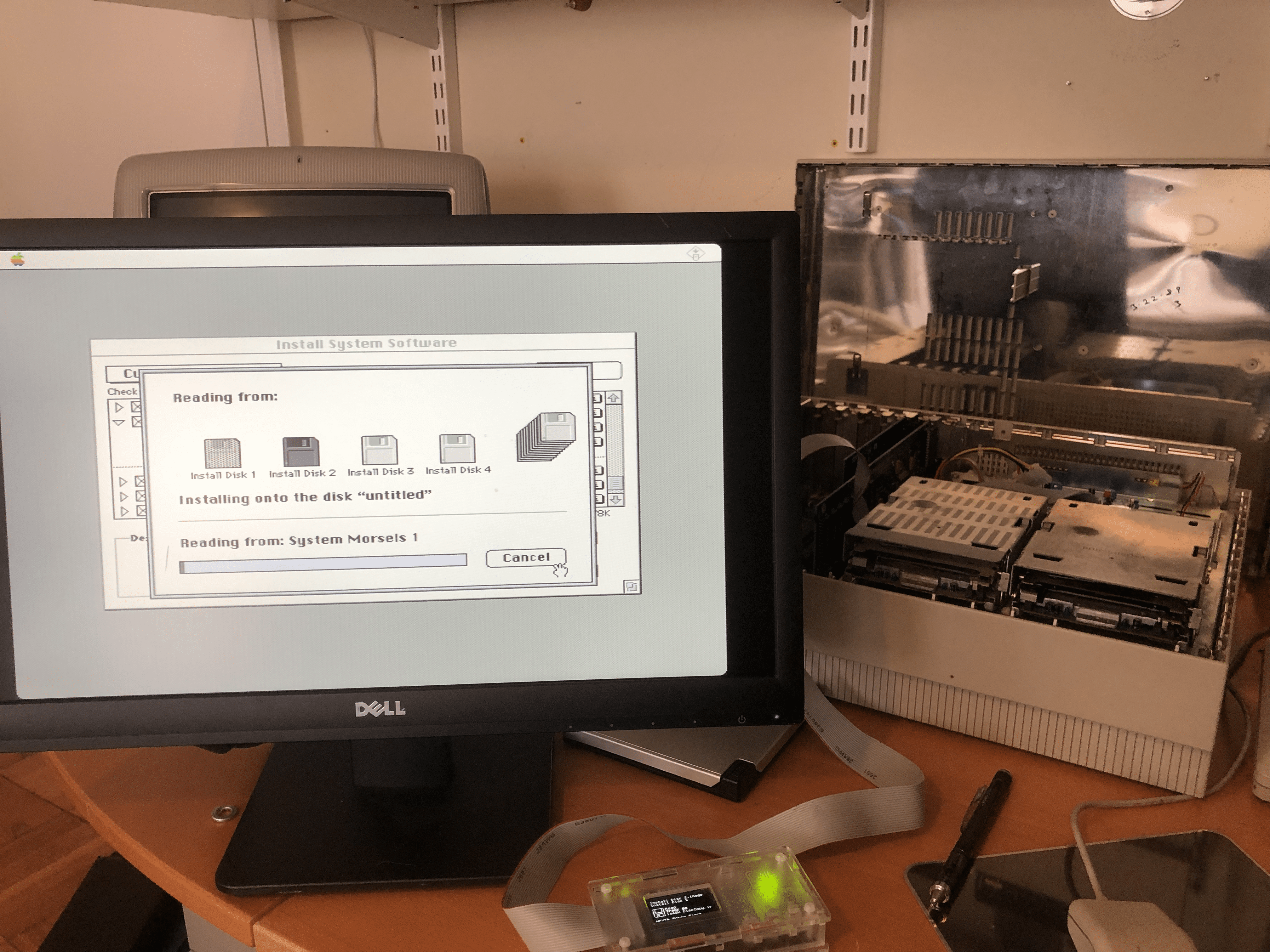

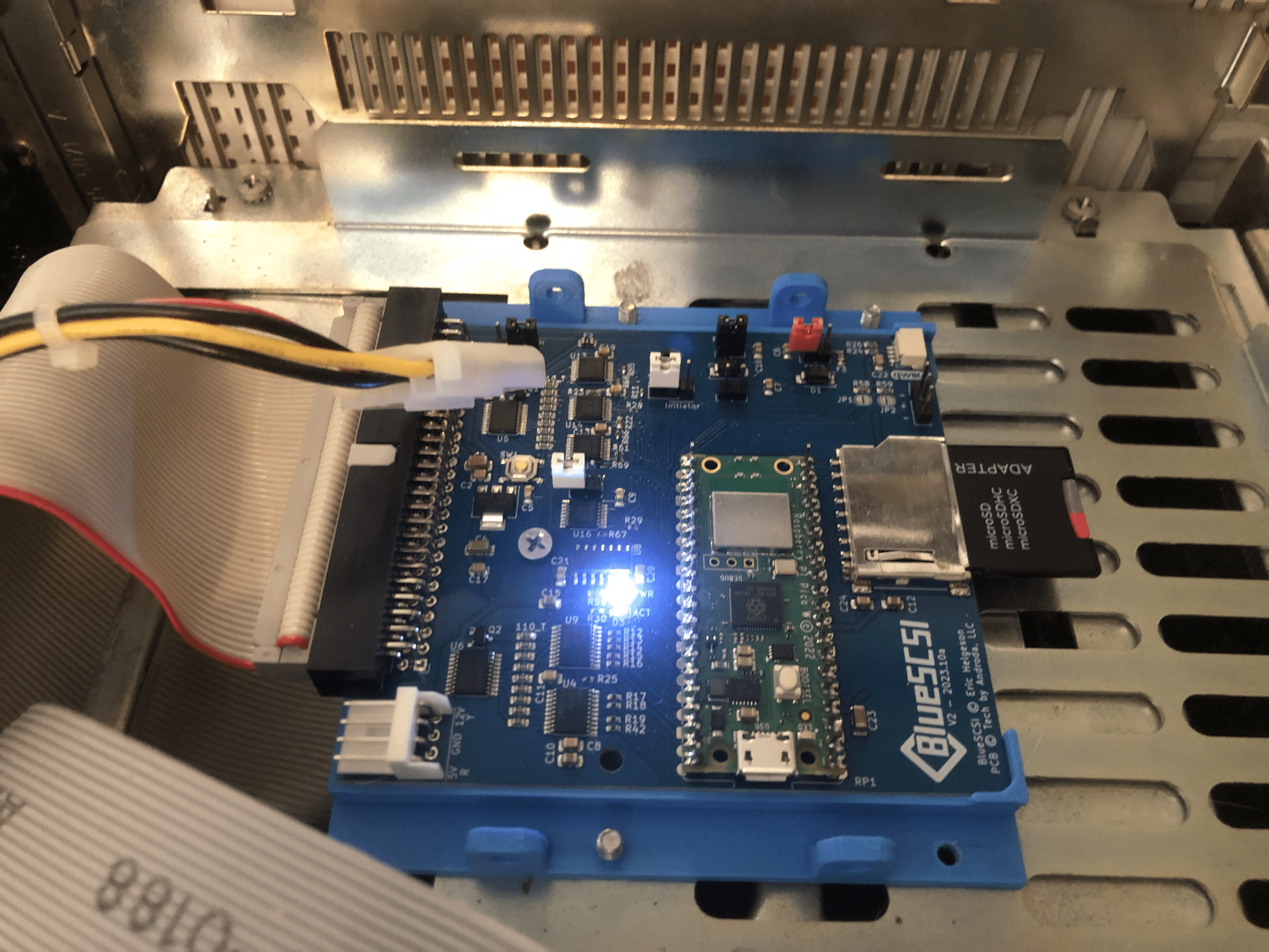

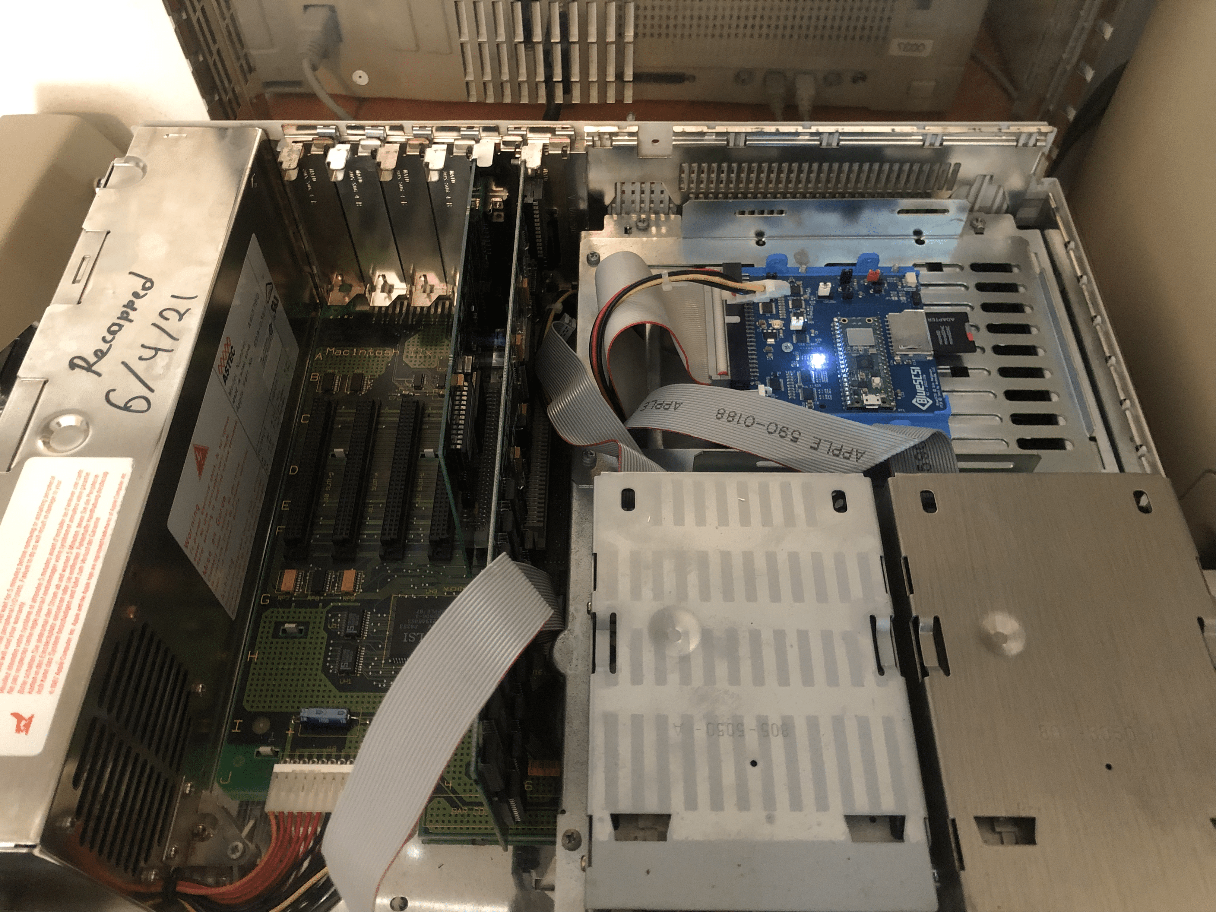

Finally! I got a BlueSCSI from JCM, preassembled. I believe it has wifi functionality, but I haven't tried that out yet. I was initially having some trouble getting my 2GB Microcenter SD card to read in it, but I think it was too old. I instead used a new 64GB SanDisk microSD card in an adapter that I had on hand, which I also got from Microcenter. I created a 120MB disk image on the card using Disk Jockey, and am now installing macOS 7.5.3 on my IIx it using a BMOW Floppy Emulator plugged into one of the ports on the logic board. I still unfortunately do not have an ADB keyboard, so my disk's name will be "untitled" for as long as it takes for me to find one! I do plan on buying a smaller SD card since leaving more than 63GB unused seems like a bit of a waste, but it works fine for now.
