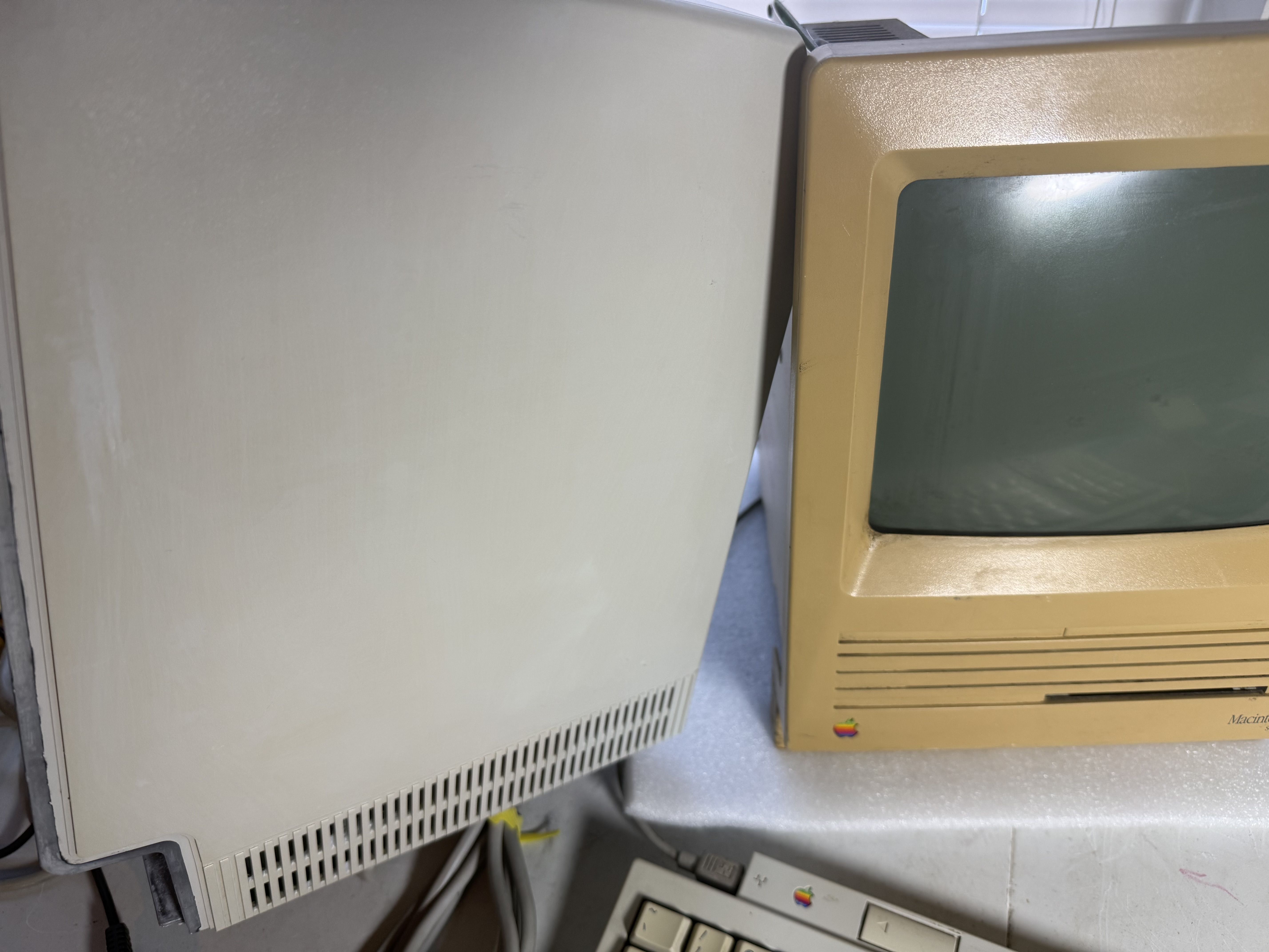

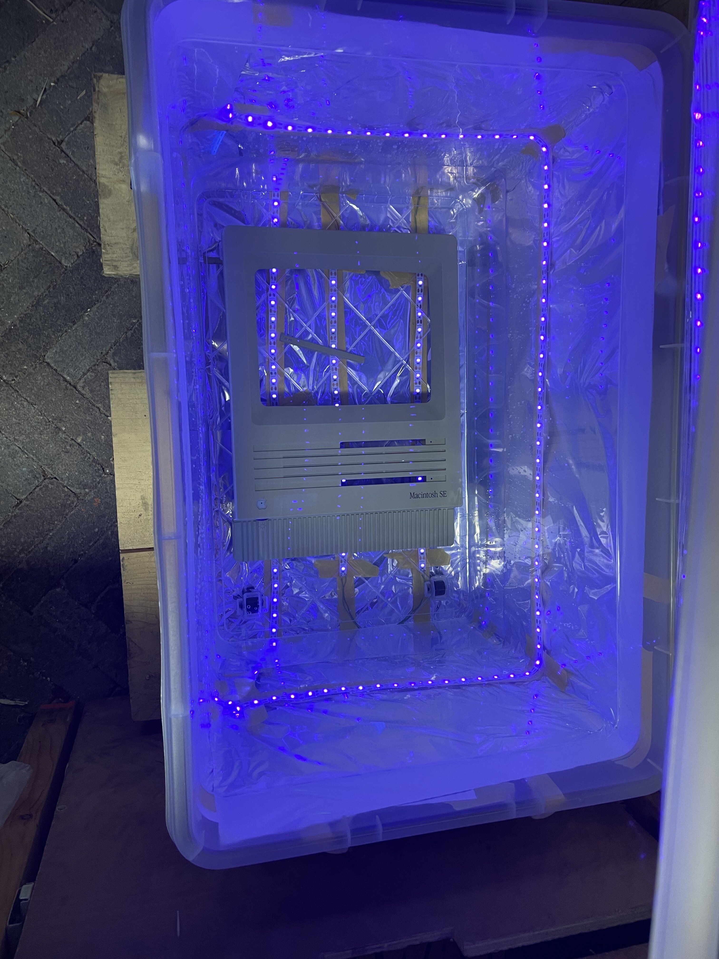

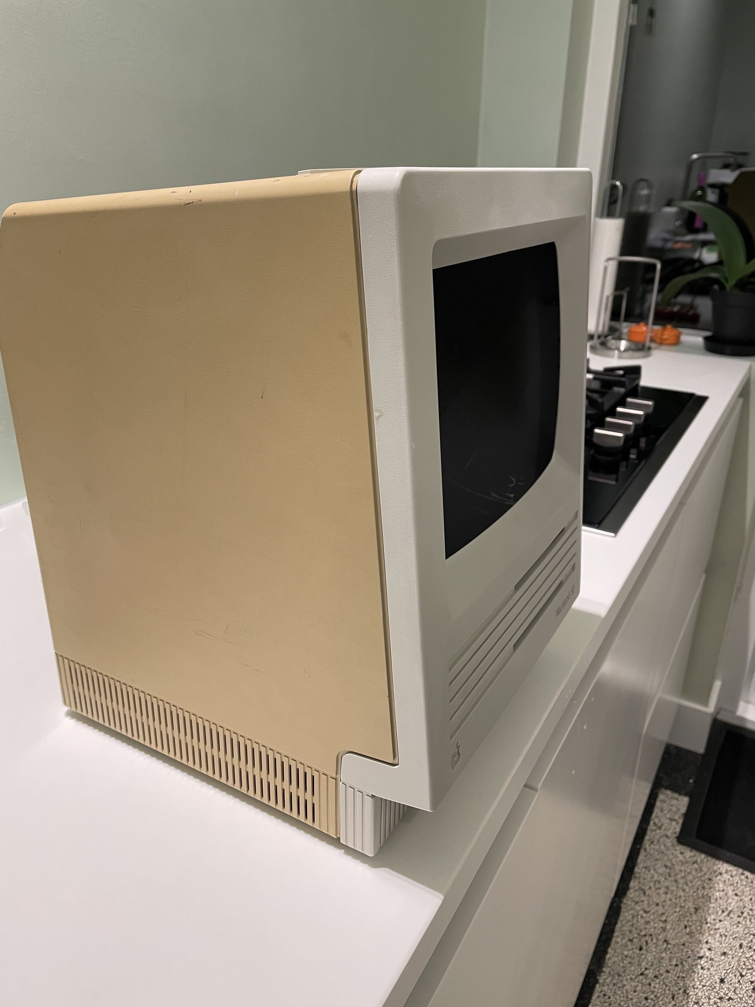

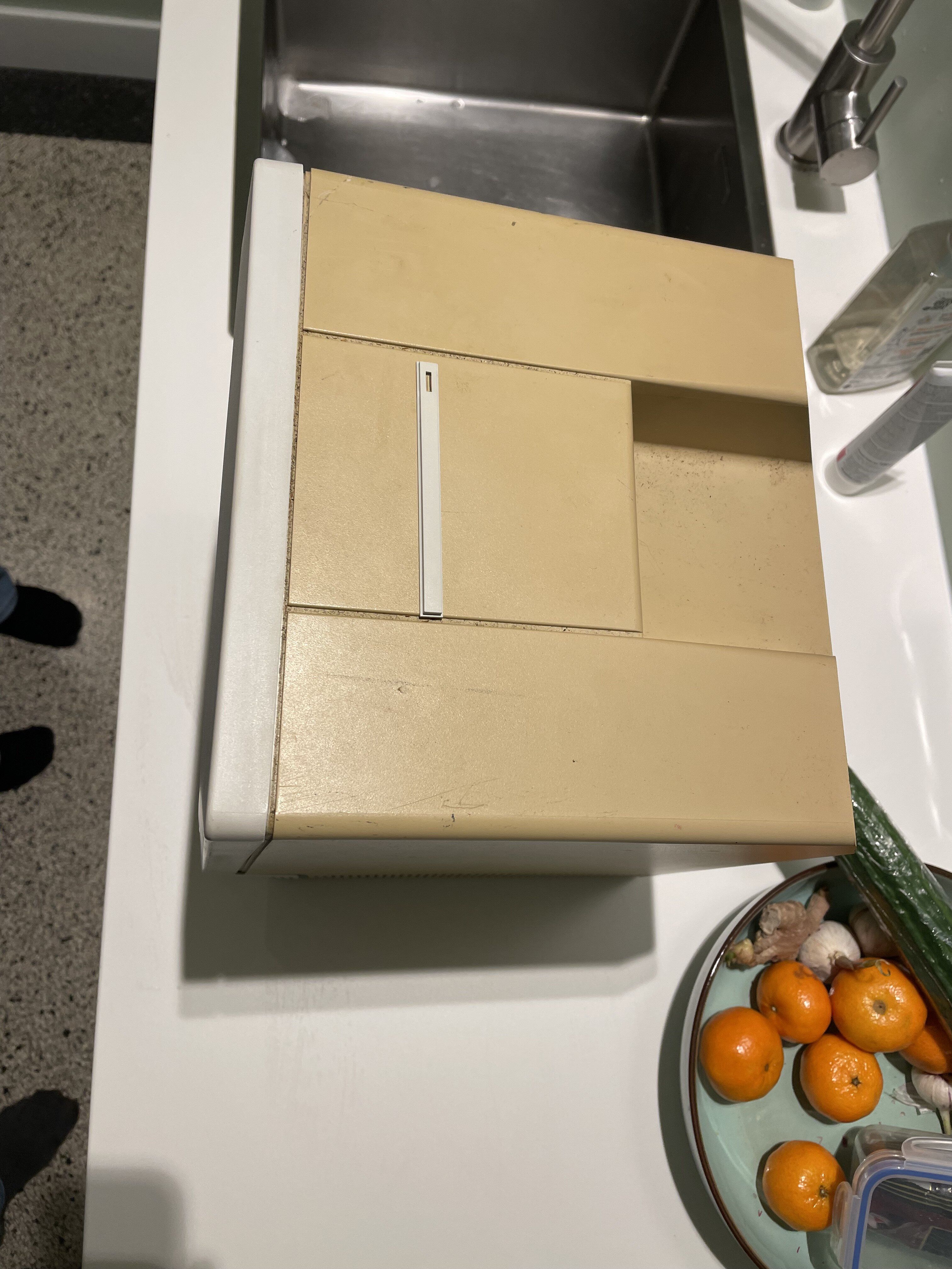

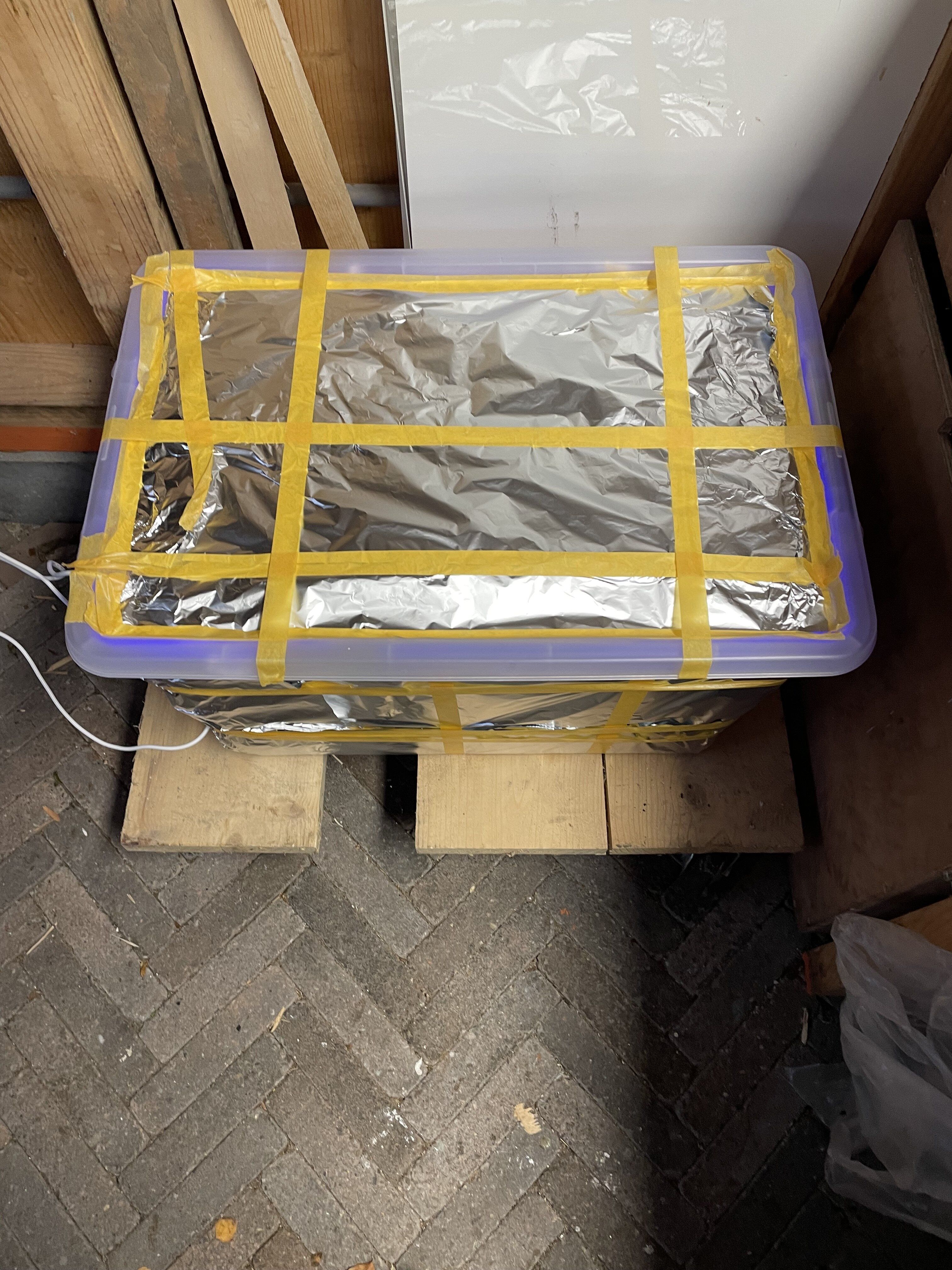

This is my setup.
- Box with some UV Led lights from all angels. (USB Lights from AliExpress - USB power)
- 5 Liter (Live in Europe) 12% Hydrogen Peroxide - Price €20 -> using Big Mac index -> $20 ;-)
(for the hole case I fill it with extra water so it is submerge (use a brick on the inside to keep it submerge)
This SE Front took some 24 hours for this result.
Greetings
