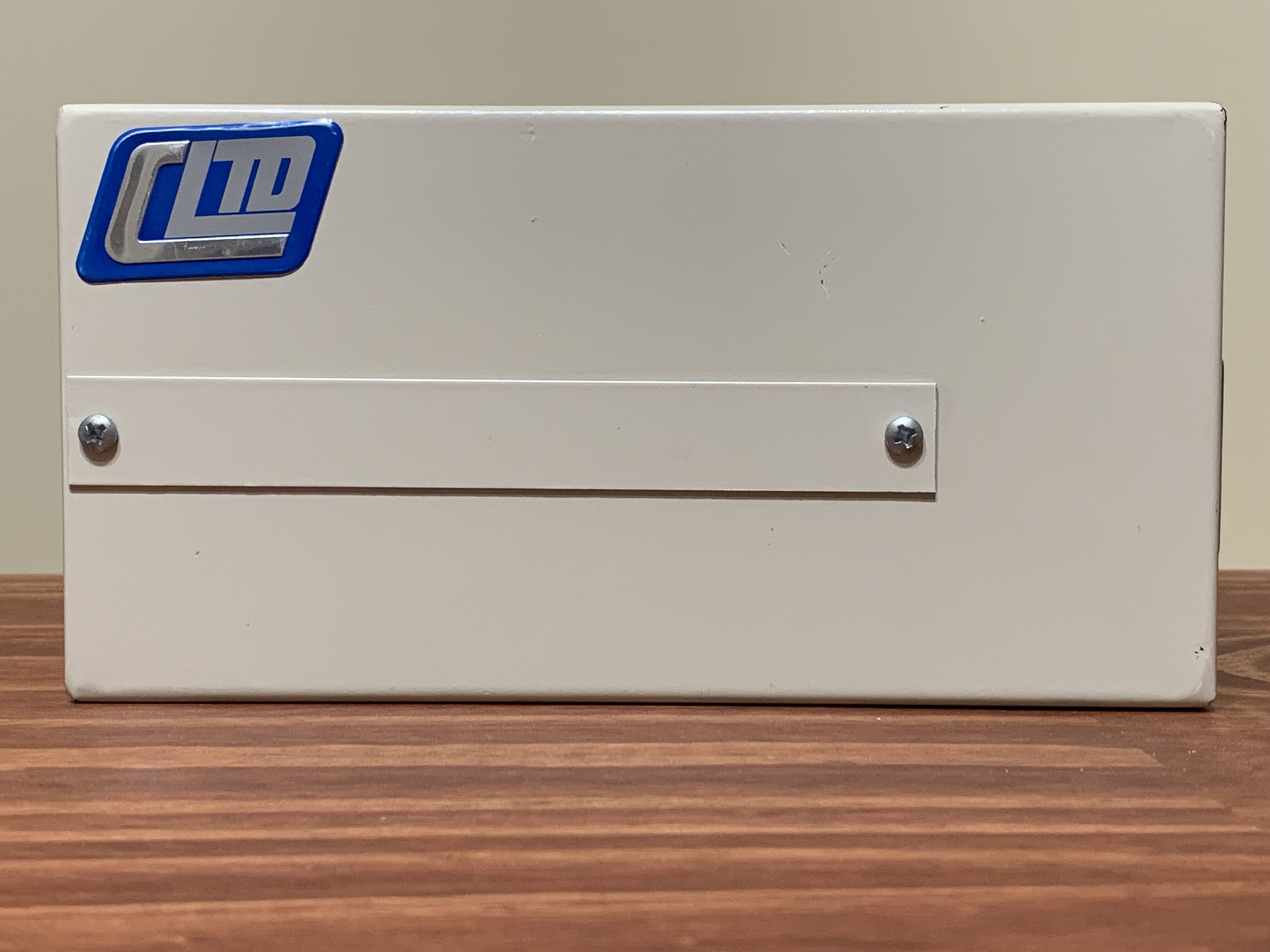

I own a C.Ltd SCSI-1000. It's in a metal enclosure, and the front has a really nice metal badge.

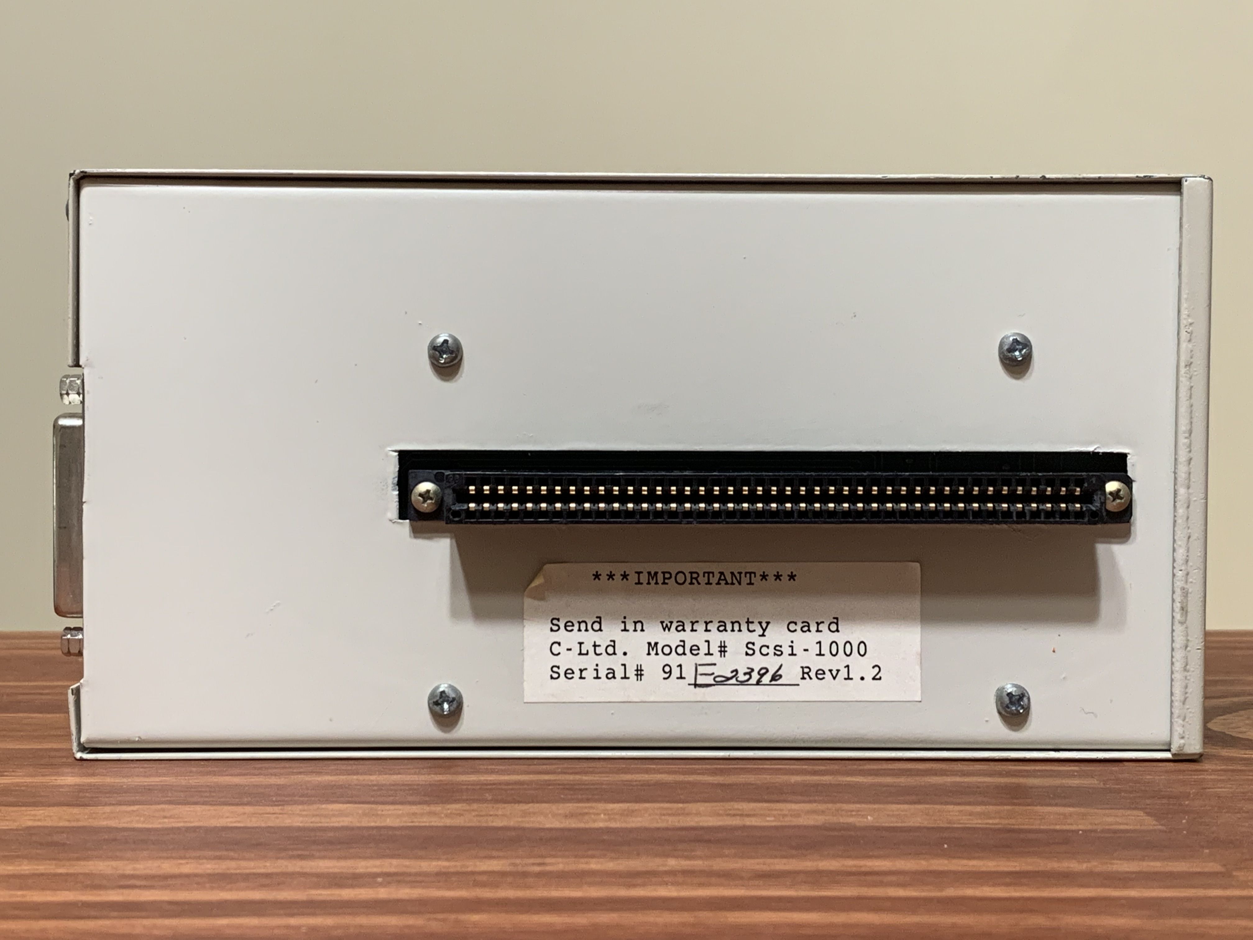

Is it too late to send in the warranty card? (Ha ha!) The back shows that this is revision 1.2, and serial number 91E2396. I'm not sure if this means that they made at least 2396 of these (as they could have started the serial numbers at 1000 or 2000), but they definitely seem like a small business, as the label appears to be photocopied with a hand-written serial number.

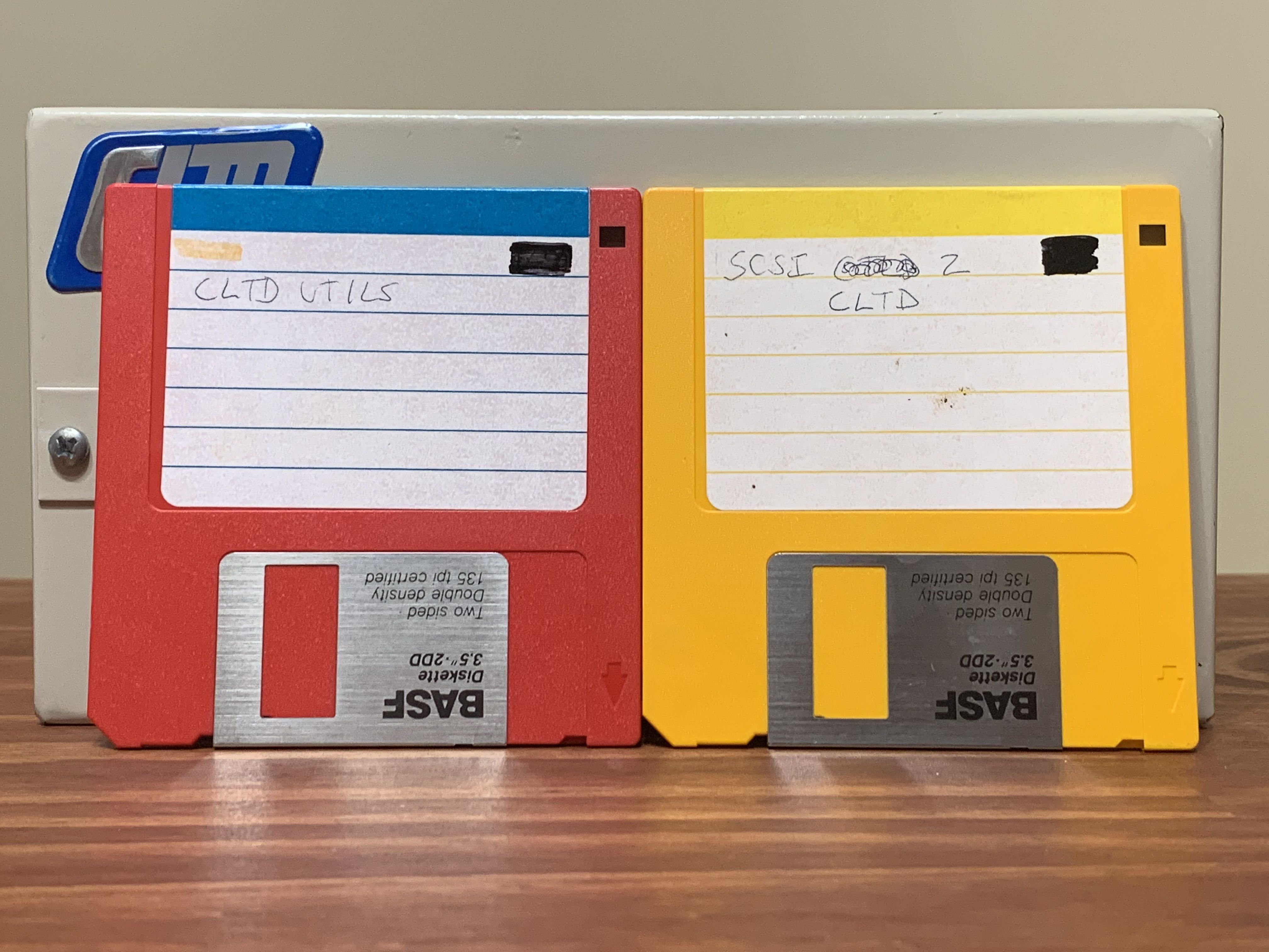

These are the two disks that came with my SCSI-1000. Yeah, unfortunately these aren't the original disks. The seller said they created them from ADF files they found somewhere, but when I requested the original ADF files, they could not locate them.
These disks are labeled CLTD UTILS and SCSI 2 CLTD, which could provide a clue as to what the original disks would have been labeled.

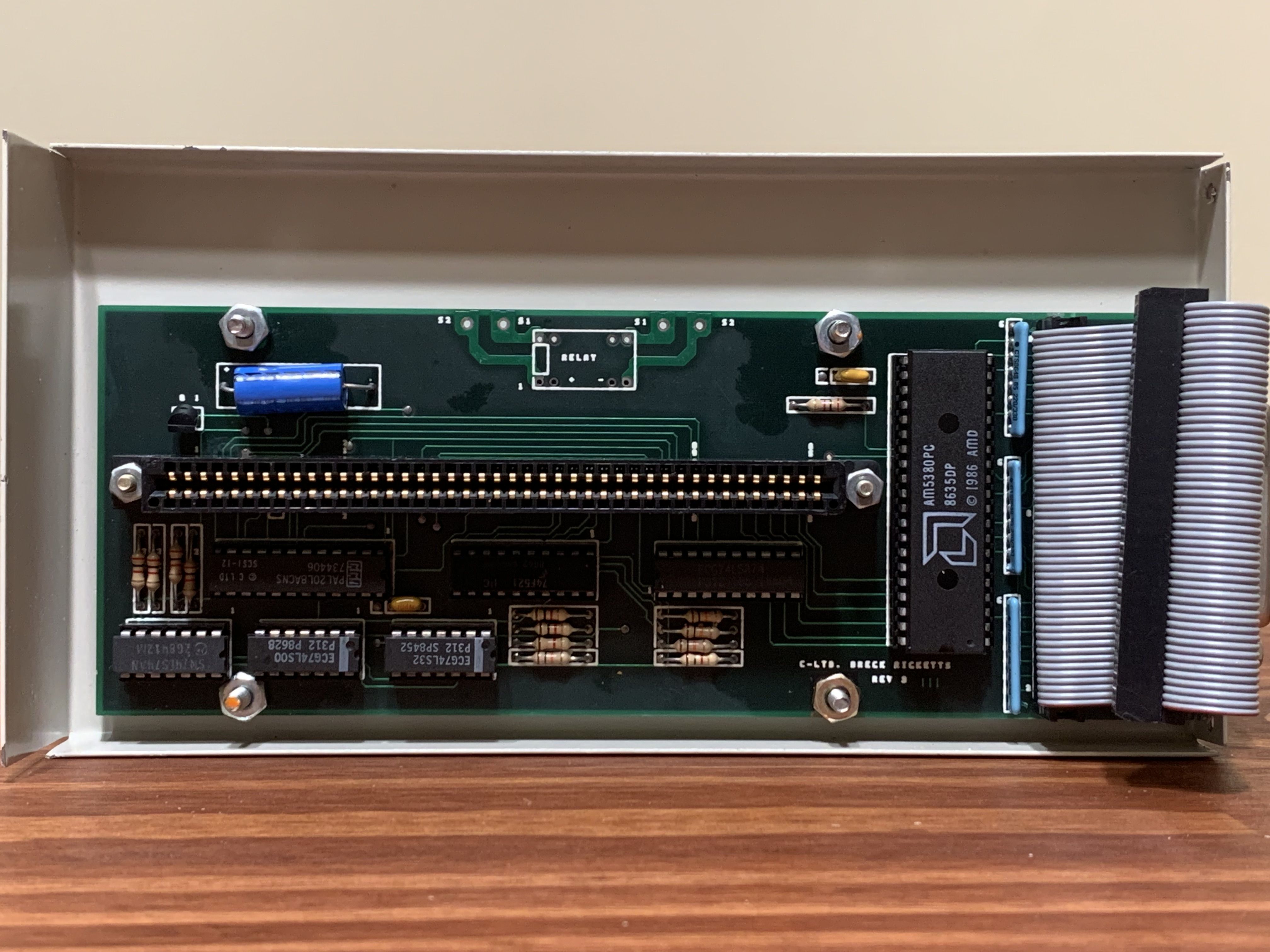

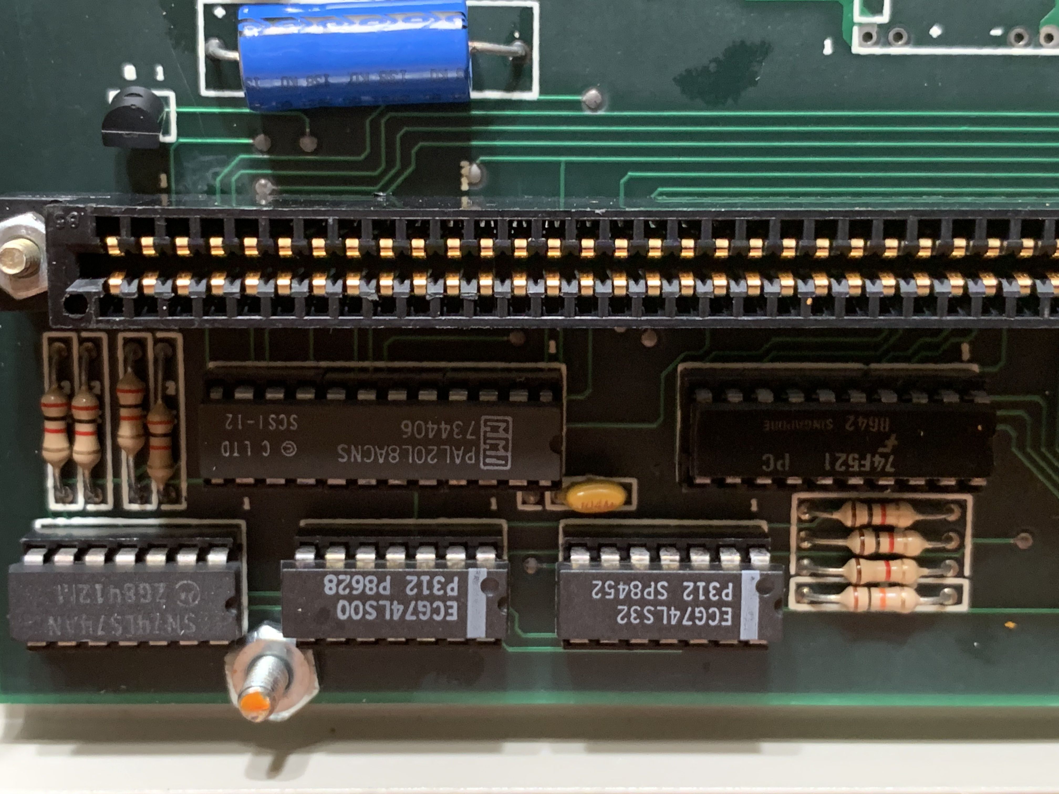

The obligatory inside shot, because folks are going to ask for it anyways. That liquid is Deoxit residue, and the single electrolytic capacitor has been replaced.

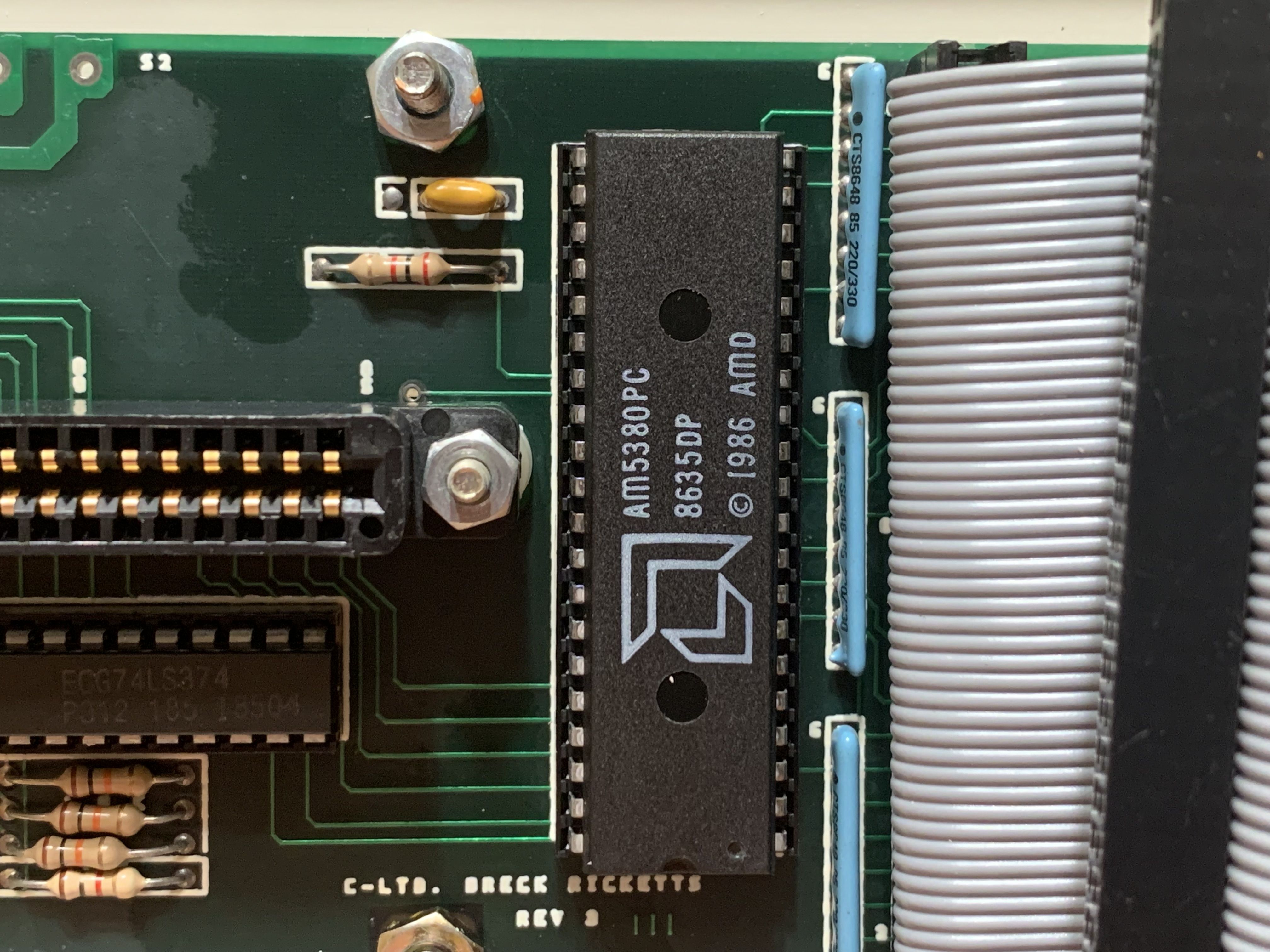

The SCSI chip is an AMD AM5380PC.
Under the SCSI chip, the PCB is labeled:
C-LTD BRECK RICKETTS
REV 3
It looks like a "3", but it could be a "B". (It's hard to read even in-person.) But given what looks like a roman numeral III on the PCB itself, I'm inclined to go with "3".
In case anyone is wondering what the rest of the logic chips are. Other than the SCSI chip and the one PAL pictured here, the rest of the ICs are standard jellybean logic chips.
And yes, if you looked at the photos of the SCSI-1000 on Big Book of Amiga Hardware, you'll notice that I am missing the card edge that would let me daisy-chain another sidecar to this one. (It looks like a passive PCB, so one could be fabricated, assuming someone hasn't already done it.) You will also notice that there is a ribbon cable in this enclosure. I have no idea why, unless it was for a terminator, as that's the only thing at the time that would have fit. (It's possible one could fit a Blue SCSI with a right-angle header, but it might block the bus pass-through connector.)

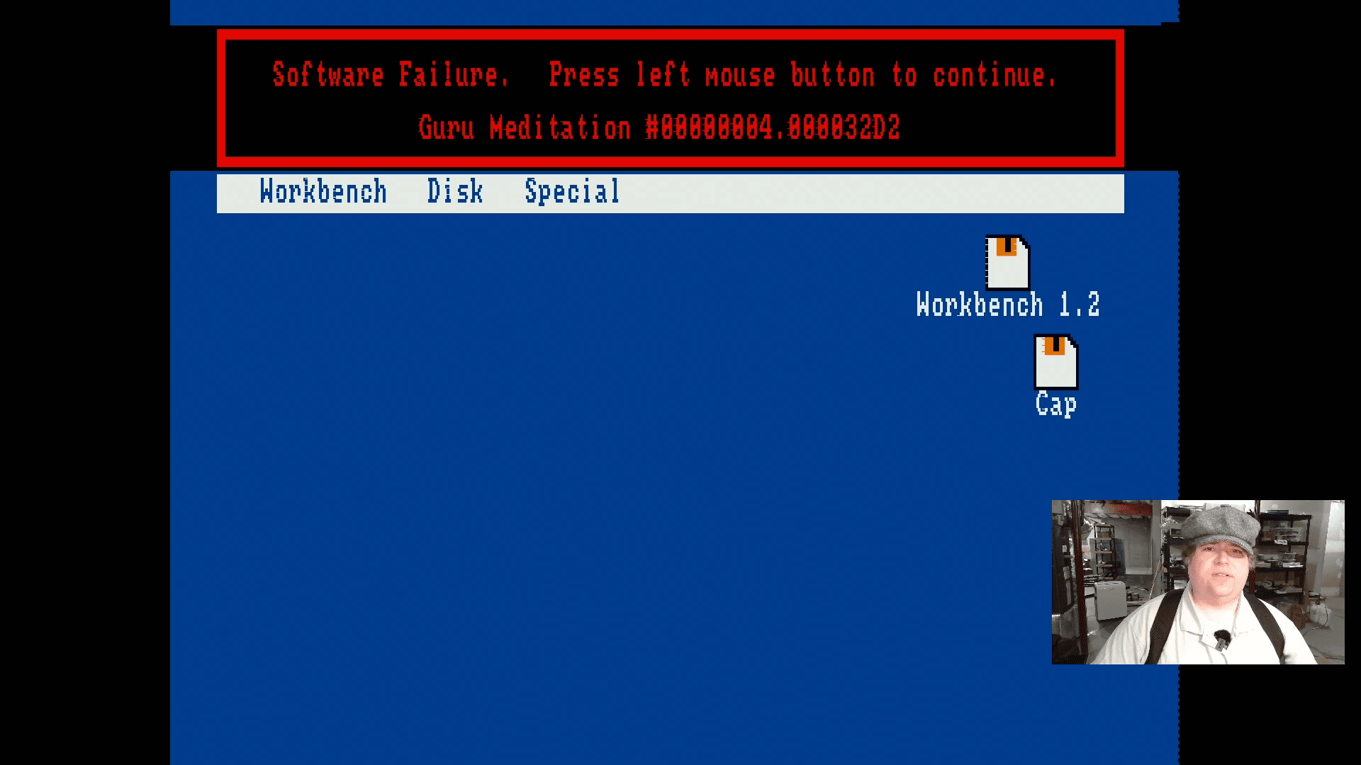

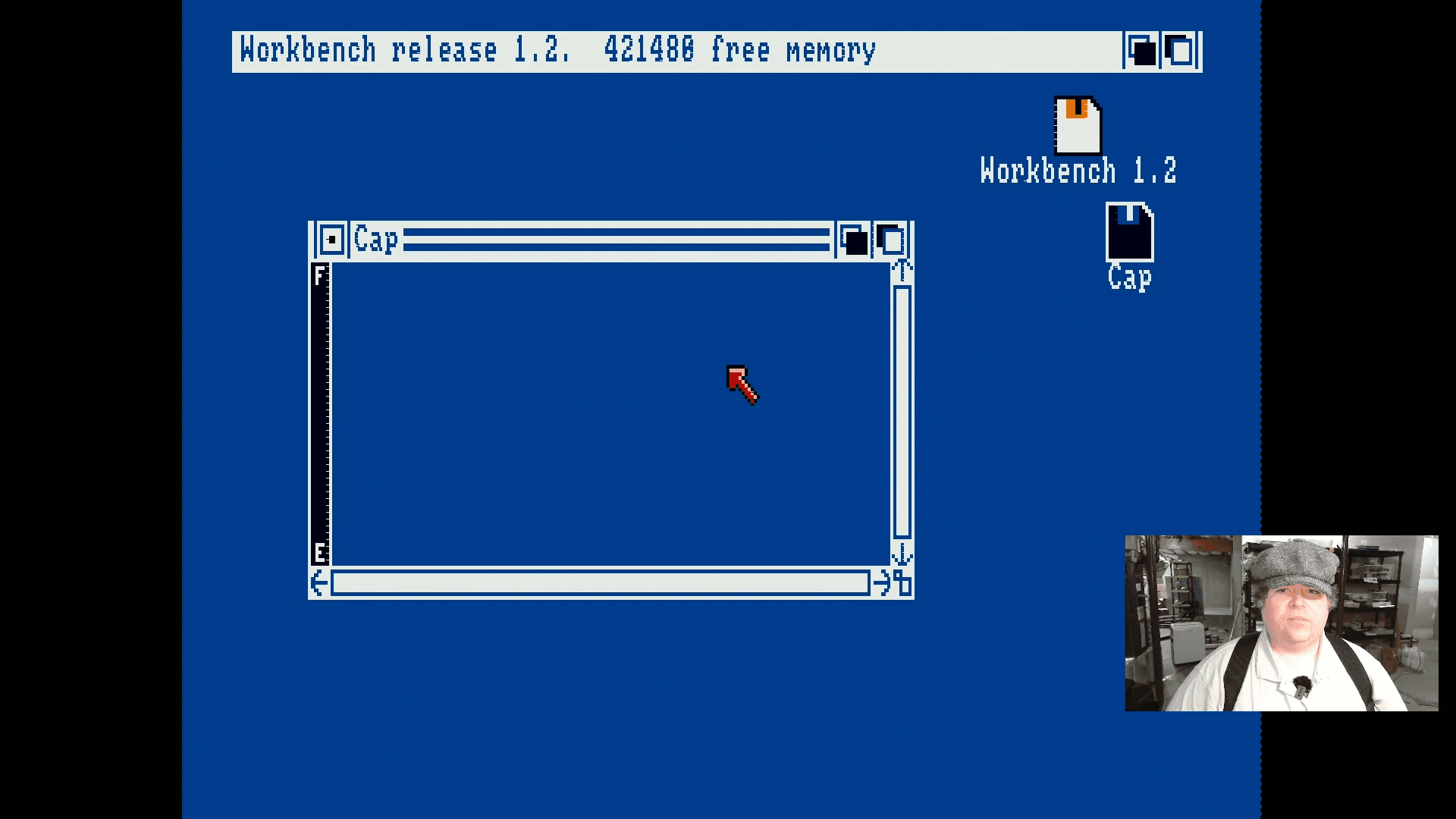

If I plug this card into the Amiga and run SysInfo, SysInfo does report that a card is present. (Sorry, no screen grab of this.) That's as far as I can get, because there seems to be something wrong with both included floppy disks.

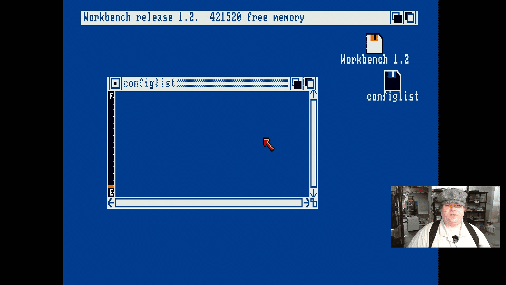

When I insert either disk into the Amiga, a disk is mounted onto the desktop, but both disks have odd names. In addition, if I double-click on either disk, an empty window appears.

And worse, I got a Guru Meditation when one of the disks was in the system (I don't know if it was related)...

I bought a Greaseweazle, and it arrived today, so the first two disks I imaged were the two floppies that came with this card. I've attached those ADF files to this post. I'm hoping that someone more knowledgeable of the Amiga might be able to look at these images and tell why the files don't appear. (There appears to be something on both disks, as I did see some non-zero data in a hex editor, and the data looks like it could be an executable.)
Maybe there's a disk repair program out there. or maybe an Amiga expert will open the ADF files in a hex editor, take one look at the data, and say that whatever is on both disks isn't actually for an Amiga.

Hi @jdmcs
Thank you for all the details -much appreciated. That Guru Meditation - Software Failure error code 32, refers to Diskcopy.
You can fetch the correct drivers for your C-Ltd. A1000 SCSI here, from the Amiga Hardware Database.
By the way, if you ever stumble into any another Amiga users near you, and the two of you have different Amiga models. Disks that stops working on one model, can often be fixed, if a copy is made on another model.
