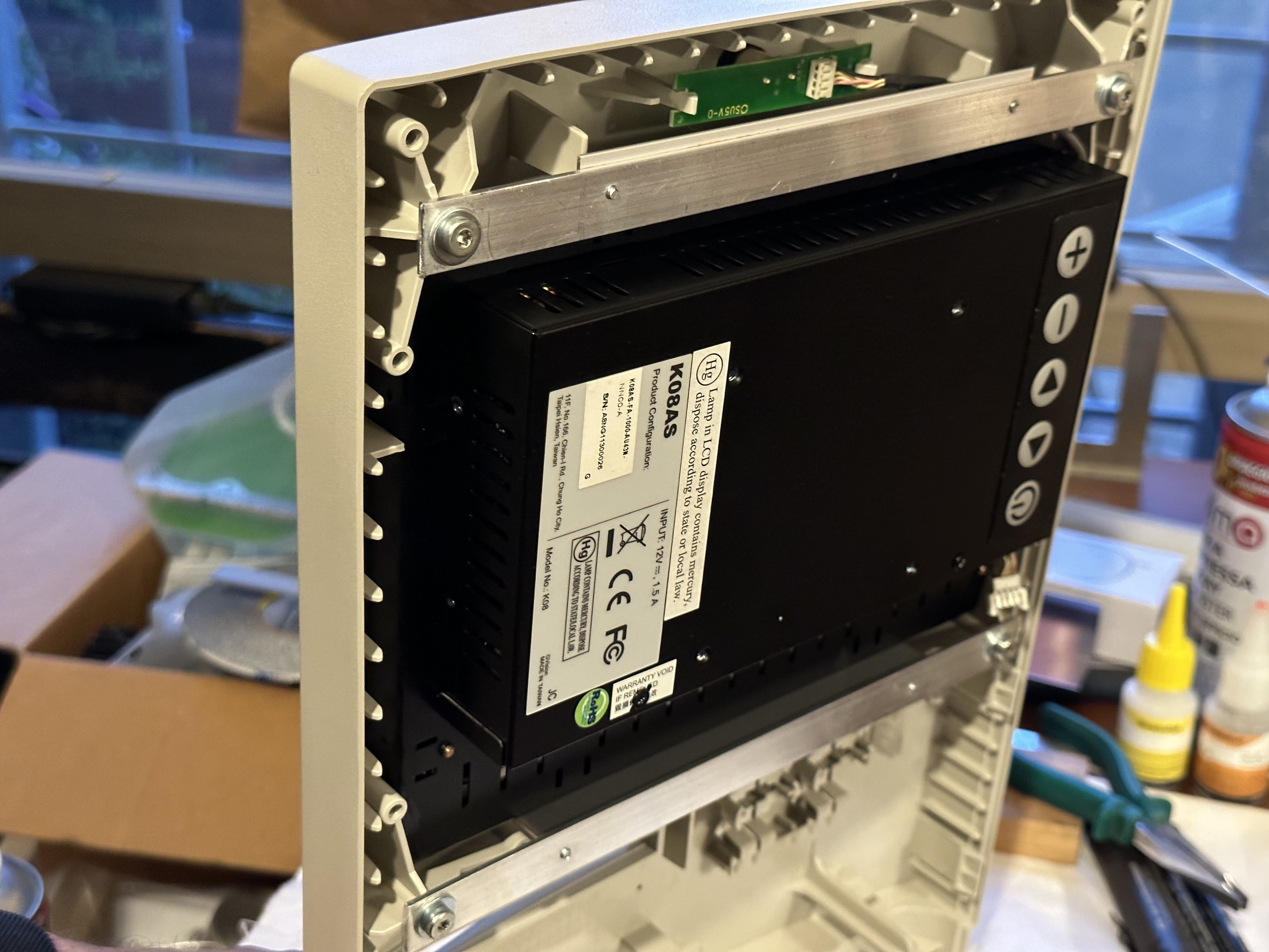

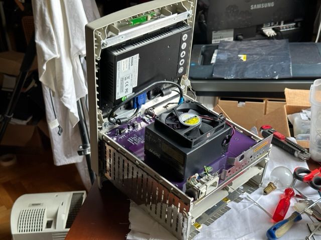

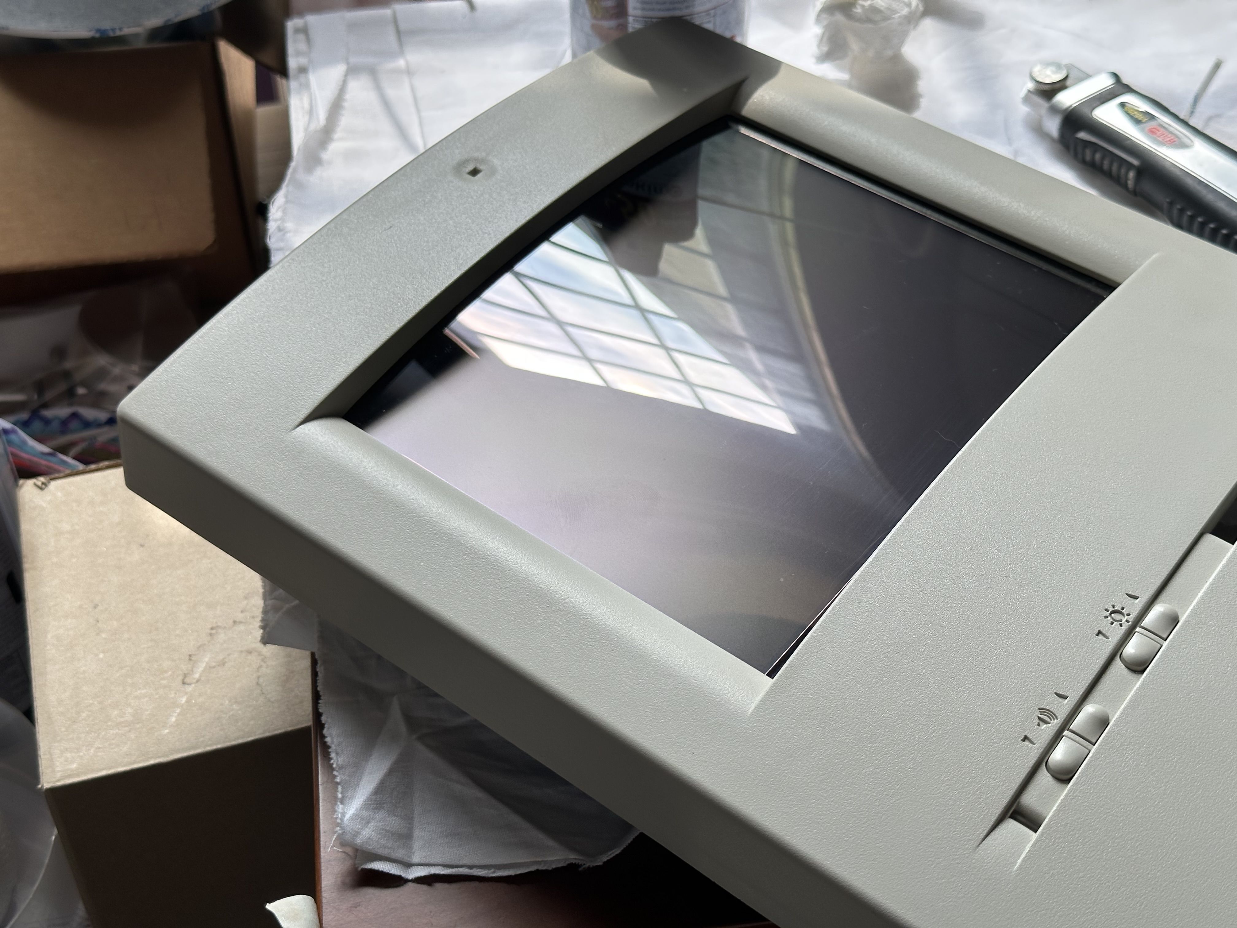

The reason for this post is that I am building a sort of "reverse-Mystic" or Reverse Takky, in the sense that the core idea of Takky -and of Mystic as well- is to replace the logic board with a more powerful one, leaving the original (albeit modded) Trinitron screen and analog board in the machine.
While this may have been a great idea twenty years ago, many things have happened since then. Color Classics have become scarce, for one. Second, the admittedly magnificent CRT of the CC is showing all its age, but most of all, the horribly built Analog Boards with their bean counter minded construction are slowly but surely all failing- and are unrepairable, due to many parts being custom and unobtanium (i-e- the FBT, the big CRT IC driver, all the switching PS transformers...).

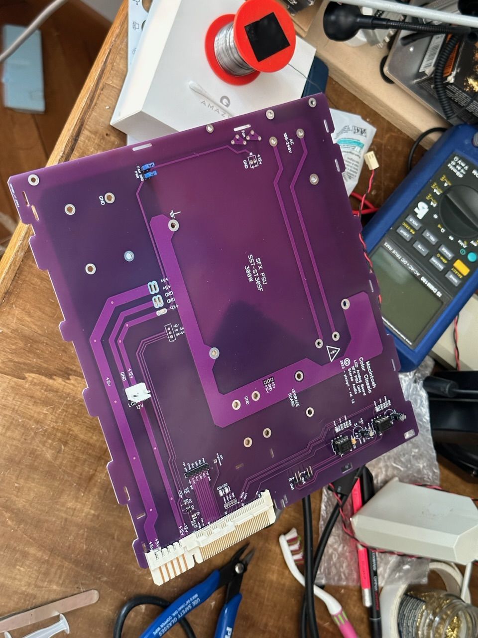

I want to replace the original Analog board with a rebuilt one that includes a PSU, supporting circuitry and a 8.4" SVGA LCD from a POS terminal, original built-in microphone support, even stereo audio amplification, and this could be a solution for many owners of such Takky/Mystics that have overburnt AB and 640x480 driven CRTs to replace them completely. In my design everything is reversible, and no permanent modification is done. At this time, only Takky/Mystics are supported due to the fact that the original 512x384 resolution is unavailable in most LCD displays.
If this sounds familiar, it's because I started this thread back at 68KMLA, however i had contacted JDW because I had hit a wall in information - and I need help to complete this project. Specifically, there is missing information in regards to the pinout of the original analog board. Without this information, it seems that the logic boards installed into a CC with my SFX PSU adapter PCB fail to boot and instead give out a lot of grief. Some pins like pin 39 and pin 3 from the original AB edge connector, carry -5V unregulated, for example. I cannot find any info and cannot trace back everything on the original AB as i am not an EE.....
but, the main problem is that the analog board I am doing testing on is a failed board, without all the EHT portion and FBT.
So, I need some help from an experienced CC owner, that can trace the undocumented pins on the original and fully working AB connector, and also figure what communication is going between LB and AB of a fully booting Color Classic on so that I can replicate it and make my PCB transparent to the LB.
if and when I will be successful, I will release all Gerbers and details on how to perform the Reverse Takky and LCD mod, totally free, for anyone that wants to recover their Mystic - Takky CC to life again - and improve it with a 800x600 LCD screen too!

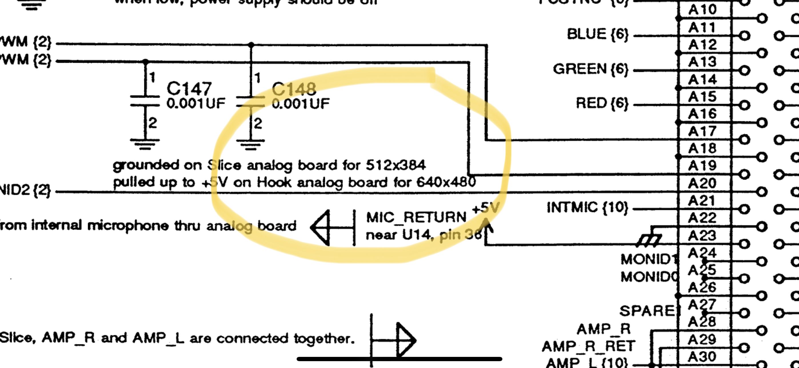

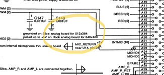

Update: a cage and harness is on ghe way to me, courtesy of “cheesestraws”! And, I laid my hands on two Apple Original (tm) schematics, one of the LC-575 Logic board and the second of the Color Classic. Both detail the Foxconn connector with all signals therefore the goal is nearer than ever! A surprise is that according to the CC schematic notes there is a 640 resolution setting the Splice LB may be capable of, but it is only mentioned.

So, the surprise is not that “Hook” - or 5xx series - has a 640x480, rather that the Splice (or CC) may possibly drive a 5xx analog board for the higher res. Can anybody confirm that placing a CC LB in a 520-575 results in a functioning system? Sense lines are set on the AB after all, not the LB.

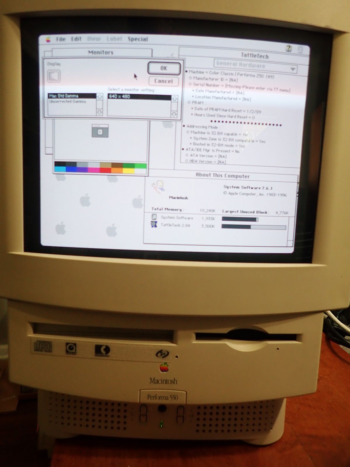

Yes. It works fine and defaults to 640x480. This is an unmodified Color Classic motherboard (LB) in an unmodified 550 (analog board + display). Extra VRAM is not installed, hence 16 colors.
Reactions: iantm
Upgrading the Color Classic board with +256KB of VRAM allows it to display 256 colors @ 640x480 when installed in the Performa 550.

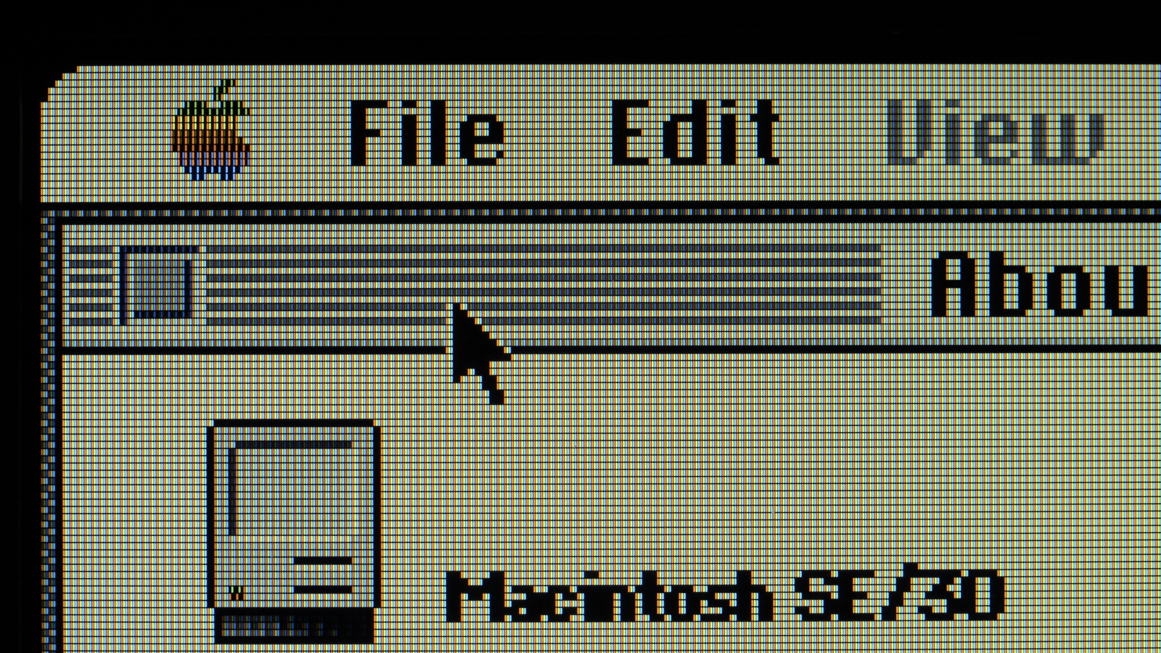

Having installed the LCD Color Kit for the SE/30 by ZZJ, I can attest to how bright and sharp and beautiful that display is — it's quite shocking. Despite NOT being an IPS display, viewing angles are incredible. For example, here is a photo that I took of that display (click on it and zoom in to revel in the sharpness!)...
And so, I am just wondering if there are similar photos out there for your chosen LCD for the Color Classic. If not, and if you have no means to take them, perhaps you could simply describe the difference in words?

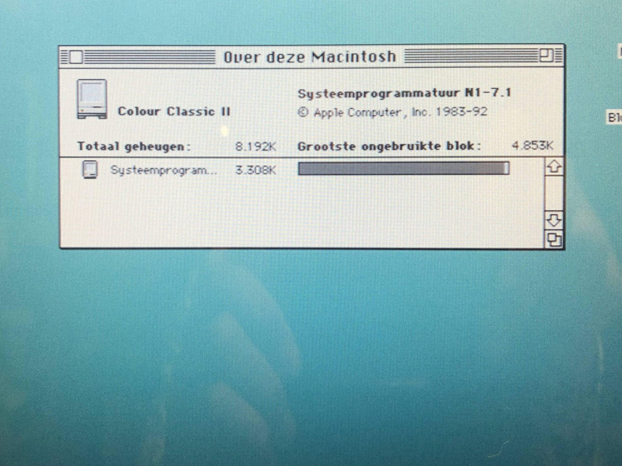

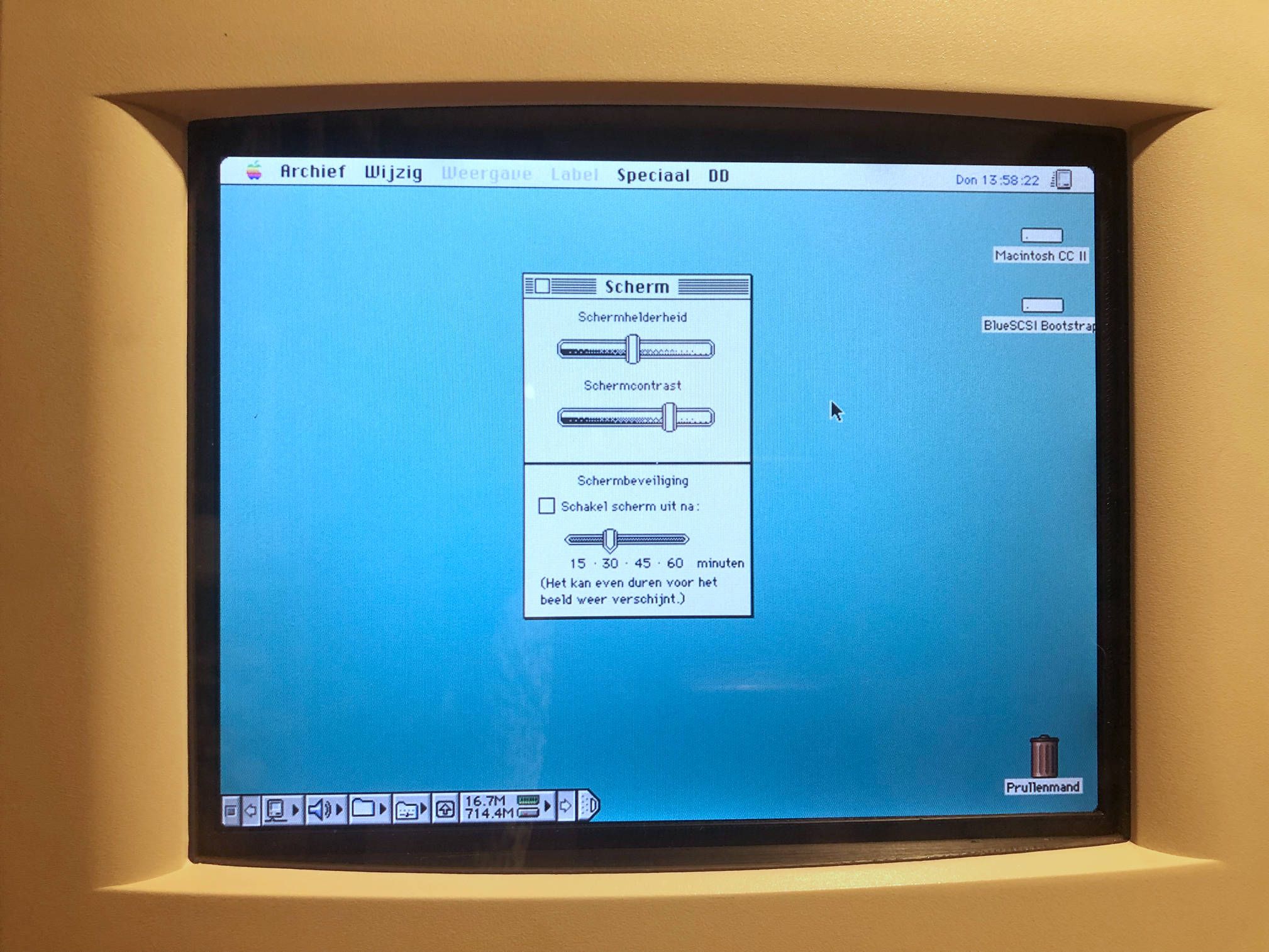

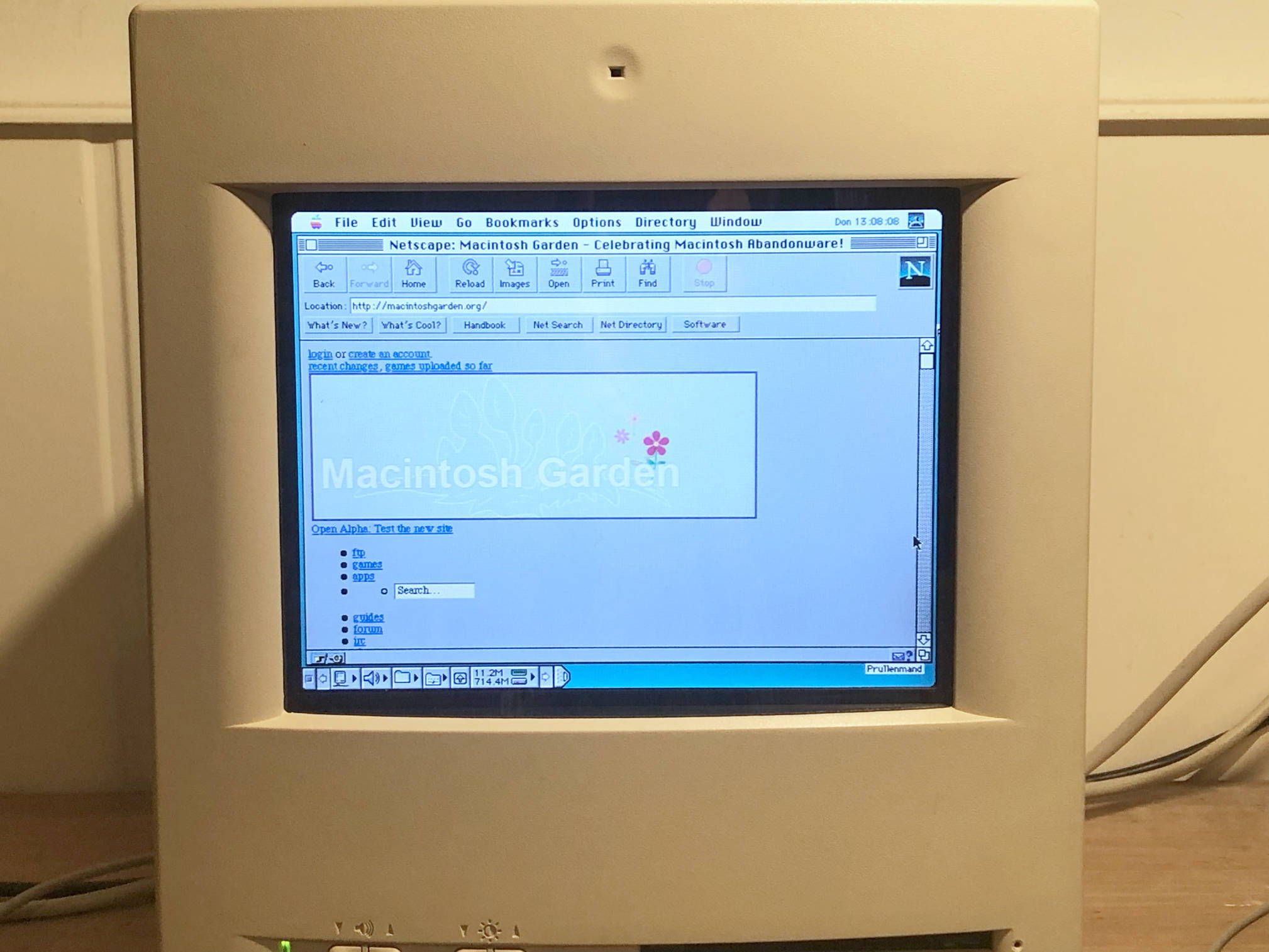

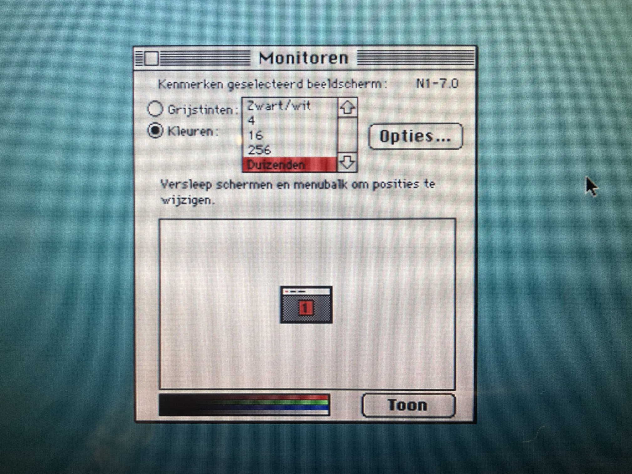

I bought this Color Classic LCD set last june. Here some of the photos I posted over there after installing. Take in considderation that they are taken with an iPhone 8.

The LCD looks good. It does seem that it’s not displaying its native resolution though. Can you confirm?
That's right. The LCD is an 800x600 screen, displaying 640x480. Therefore, in vertical direction is a little bit of distortion. Most visable in the window bar.

Not that the LCD kit displays only 16 colors, but that your custom-built Analog Board, when driving the stock CC’s CRT (not the LCD) can only produce 16 colors due to its limited VRAM?
The 16 colors limitation is only caused by the 640x480 resolution. With the original resolution with the CRT, and a standard 256k VRAM, you have 256 colors. I have an extra 256k VRAM in my CC+LCD and have 256 colors with 640x480.
With an LC550/CCII board, 512k VRAM is standard and with an extra 256k VRAM, you have 32768 colors at 640x480.
