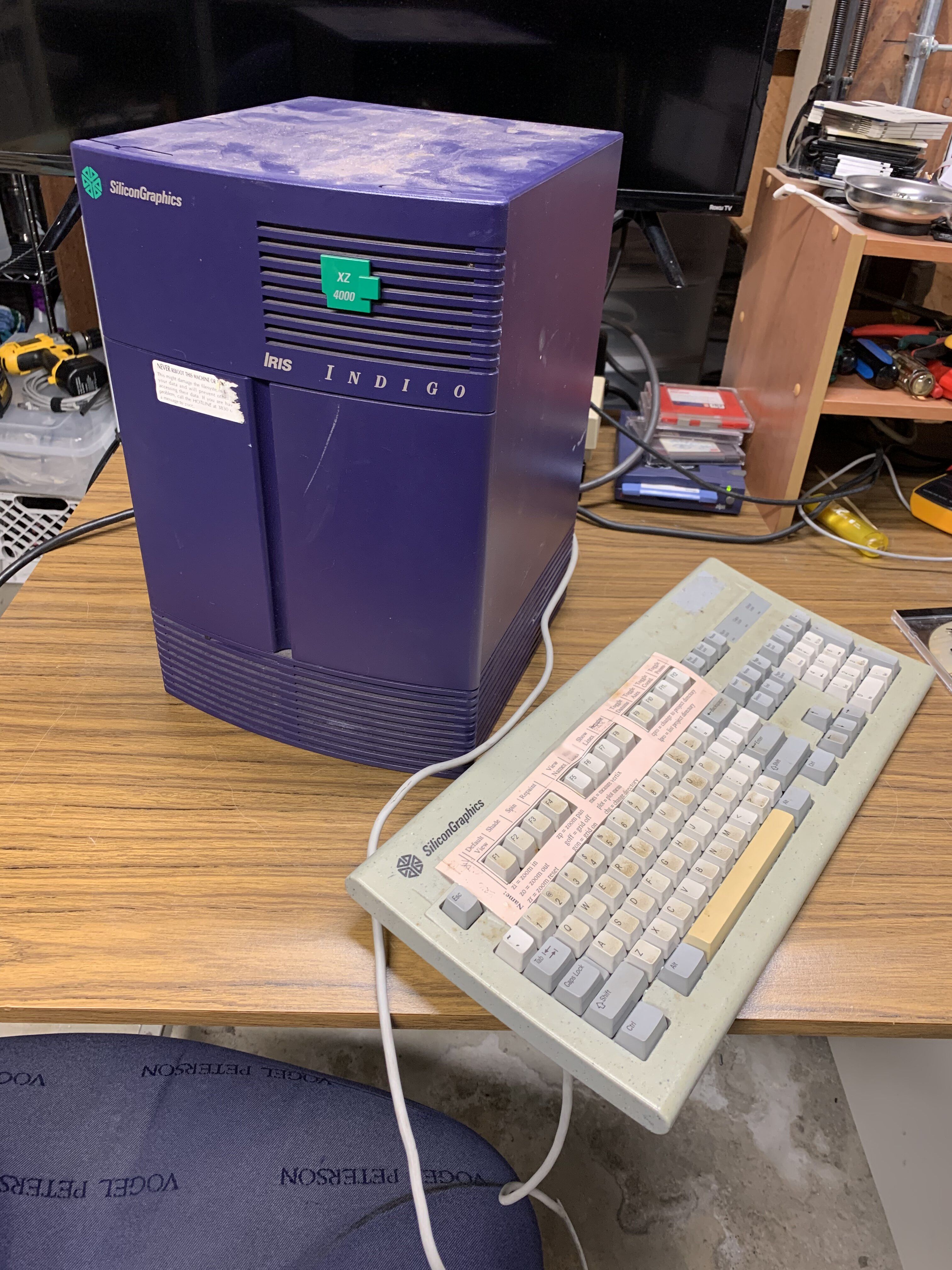

Needs at least a TOD battery. Missing drive sled, but I can use external SCSI until I get that from my friend.

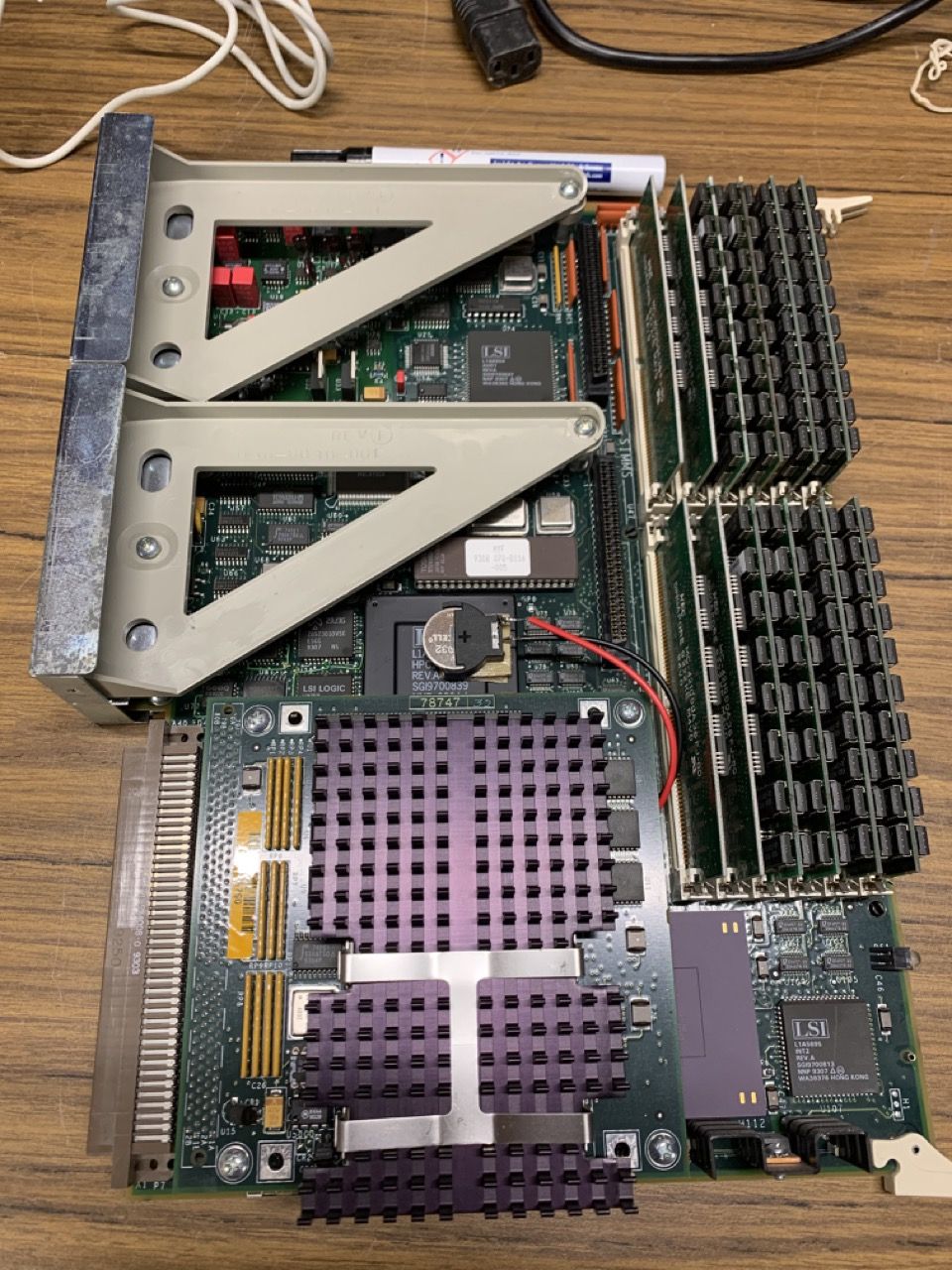

I went a slightly different direction, but it works!
I've used a lot of Glitch's boards like that on my old Suns.
Turns out I have the wrong keyboard/mouse combo.
Anyone have SGI keyboard 9500801 and/or mouse 9150800 they want to part with. Drakware is sold out of his Indigo/USB converters.
I found one from a US seller a while back. While that solved the keyboard issue, the next issue is that the power supply will start the machine, but then the machine locks up after a few minutes, and won't start again until the PS is left unplugged for a couple of hours.
That project was pushed off the bench, but should be coming back soon...
