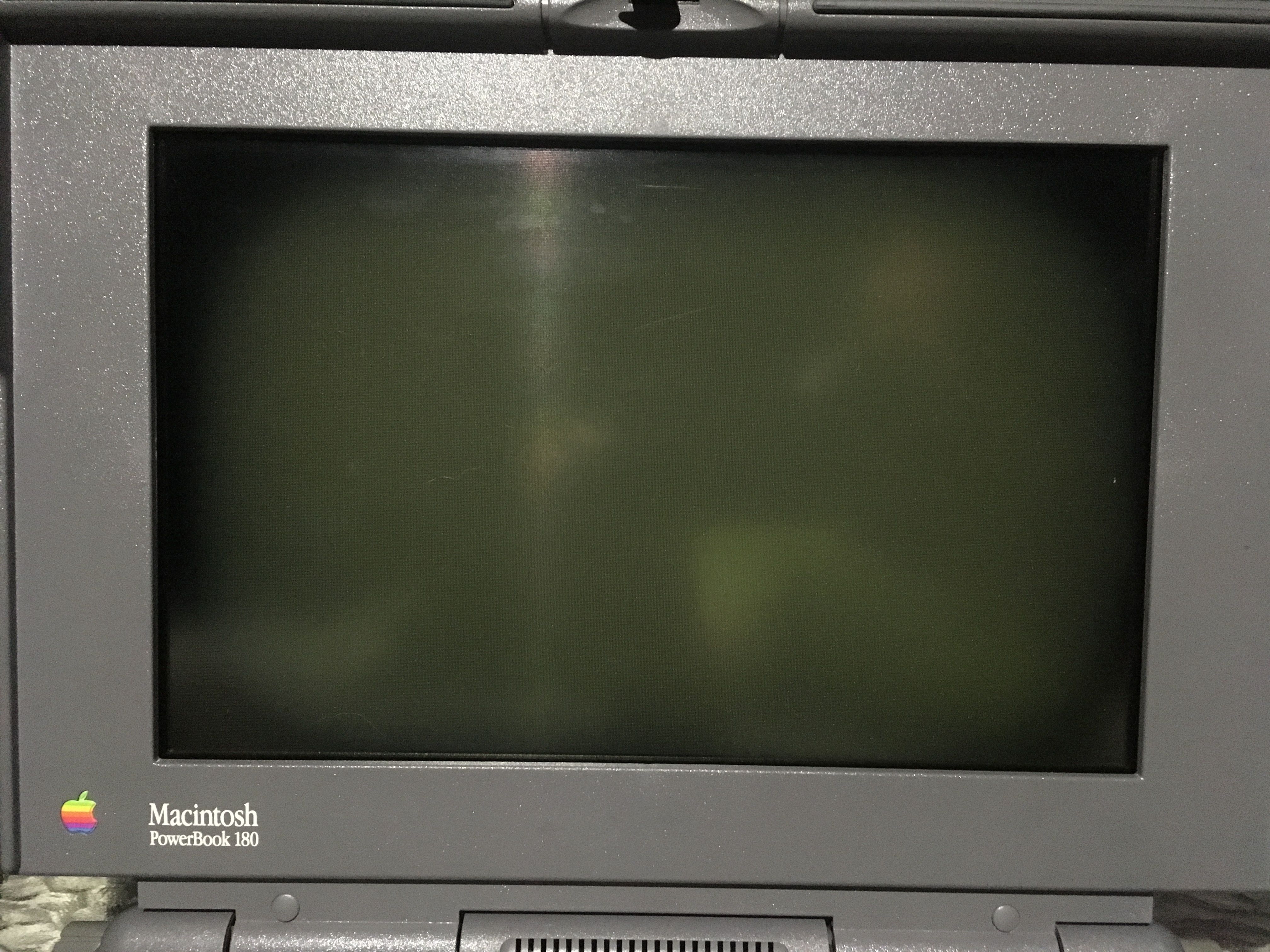

I recently purchased a Pb 180 and it has the tunnel effect (takes some time to show signs). This seems to be such a common problem for these model Macs, why hasn't anyone created replacement panels?

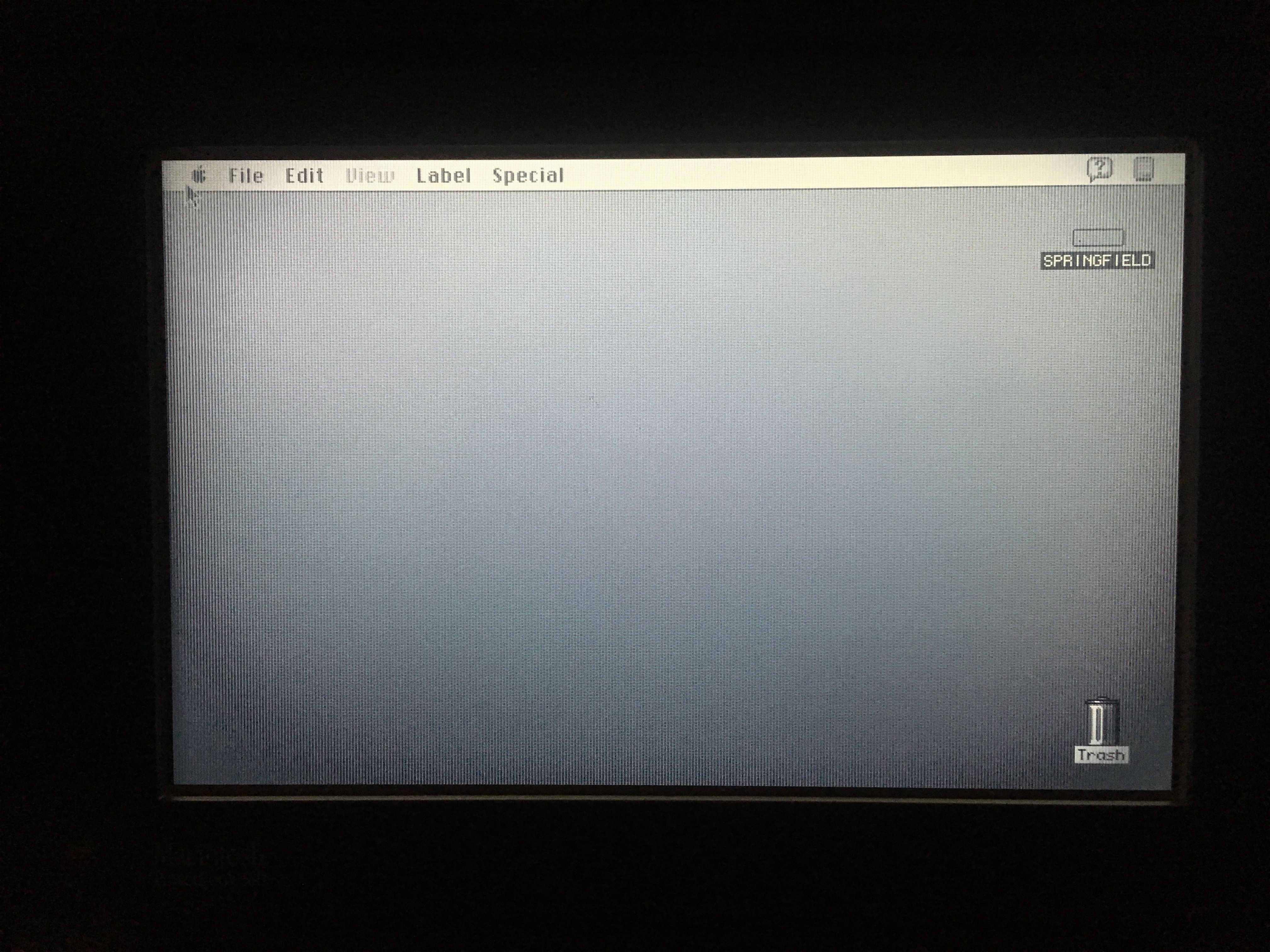

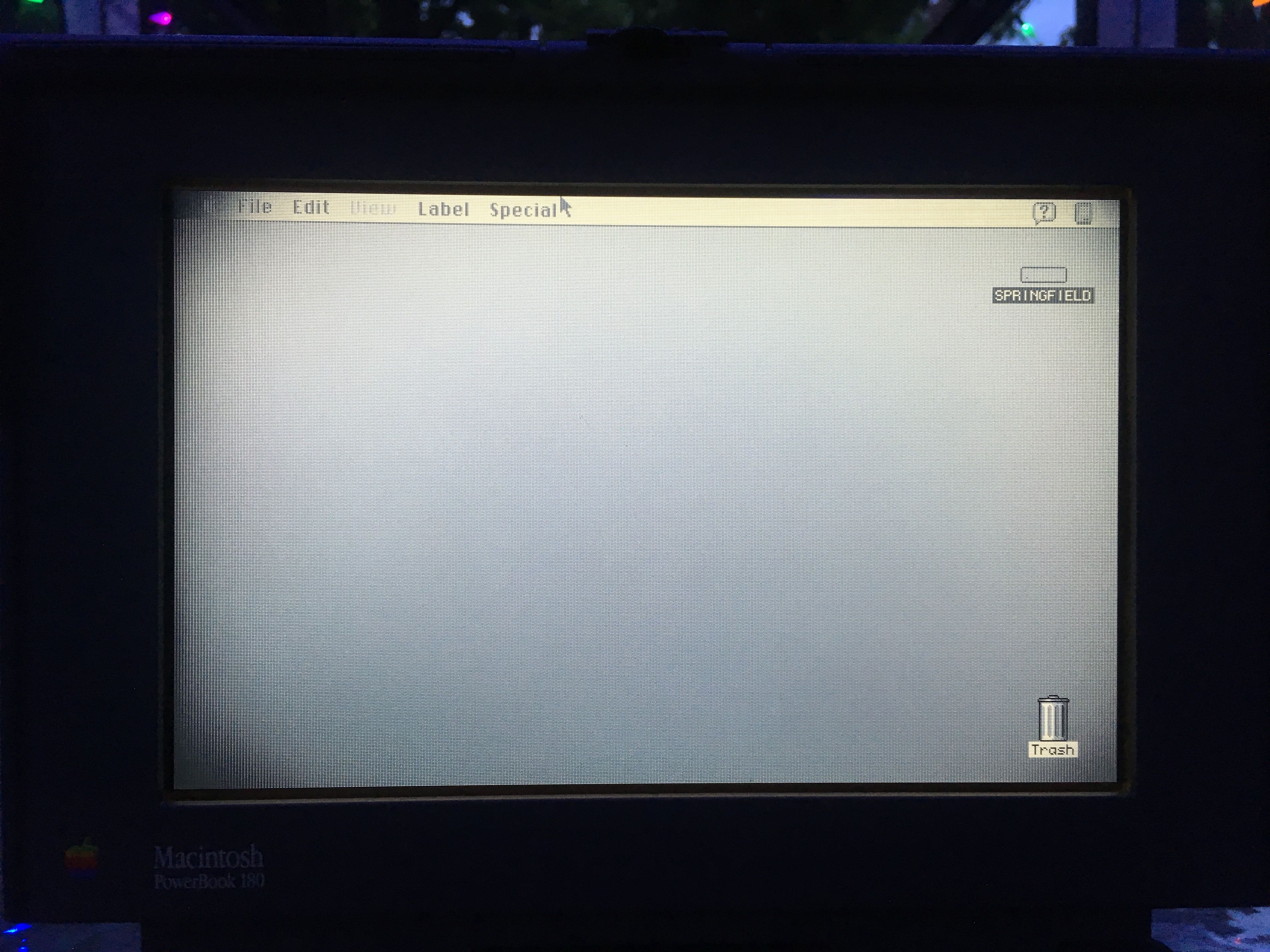

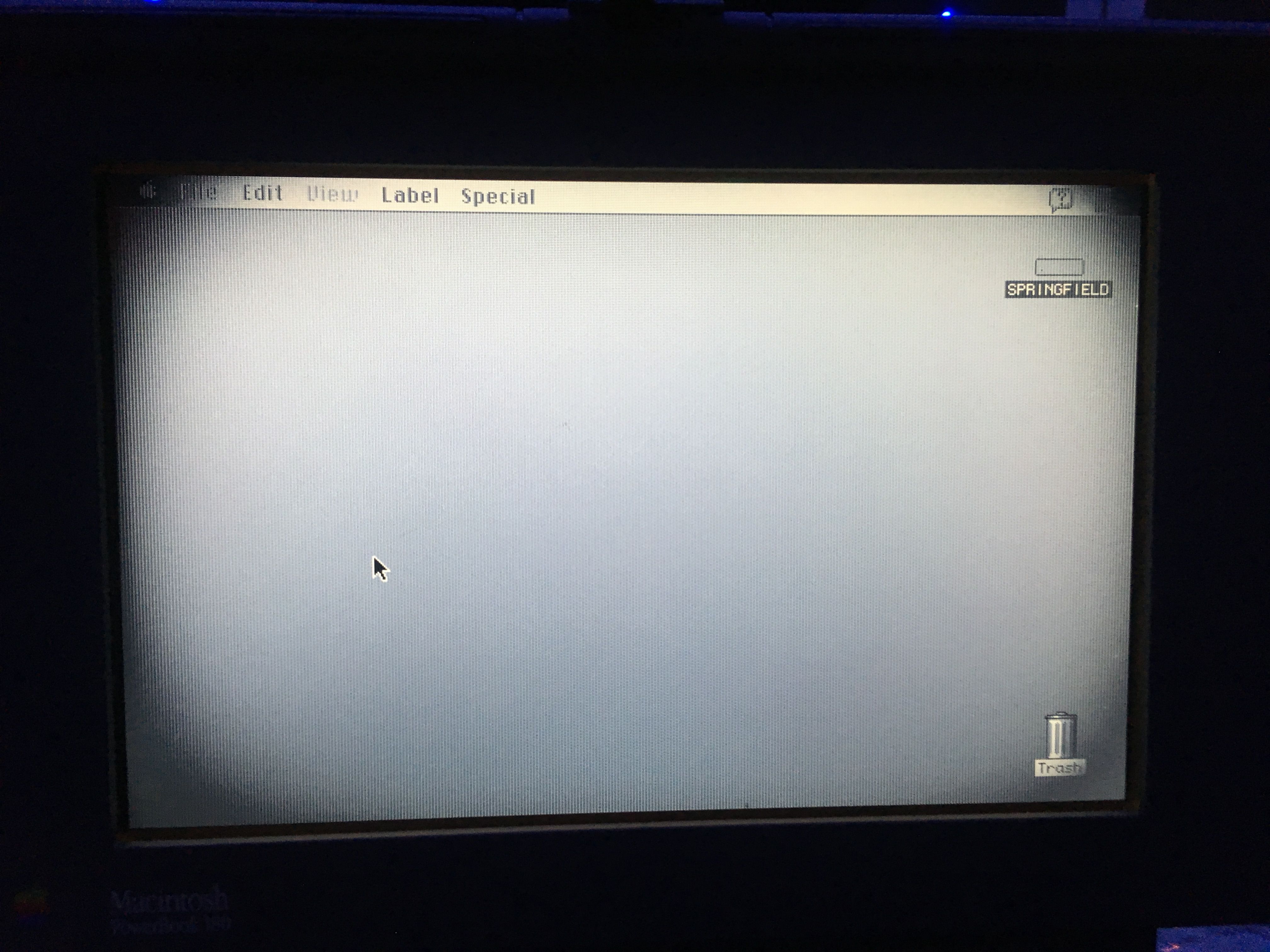

I've been experimenting with my Powerbook 180. The pictures below are after I opened up the screen and torqued the convectors at the corners of the circuit board towards it (so 2-3 on each side...not just twisting them vertically but also horizontally). Outside temp in mid 70s.
The first picture is after 90 minutes with screen constantly on. Second is after an additional 90 minutes but with screen blanked (didn't seem to make a difference as image still deteriorated). I then turned machine off for 120 minutes and the screen in off still looks pretty bad. However, upon turning it on, it doesn't translate to the picture (that part is weird).
My next step is to remove the LCD again and this time press down on circuit board and tap all the tabs with a small hammer to evenly fit the screen as snuggly as possible between the elctromeric strips and the bezel to see if it improves it further (same time test).
Note that I do have a video of me using the machine originally and after 30 minutes it was worse than the 90 minute image today.
Reactions: starlite
Ok, finally was able to do my tap test. It failed. I tried twice, the second time, while firmly pushing down the circuit board to the bezel, I tapped pretty rigorous with a small hammer. Any harder would not have been wise. The screen still showed signs after 45 minutes. Is it less bad? That is so hard to put a finger on as it depends perhaps on heat (82 degrees both times) and humidity (not in AC'ed place).
So what's the next step? Perhaps baking can still be a solution. I still think it's not about moisture but about adhesion and that baking may be re-flowing that part...if that's the case is also means that it could last a bit longer than just driving moisture out.
Again, all just a theory so if anyone better informed knows it to be moisture I wouldn't disagree with enough evidence. I did have high hopes that a tighter fit would do the trick. The first time it looked really good after about 20 minutes, with no signs, but it did then creep in after an hour. There are liklely no elecrtomeric strips all the way round and the bezel has not clips on the side it fails first...so should have known.
