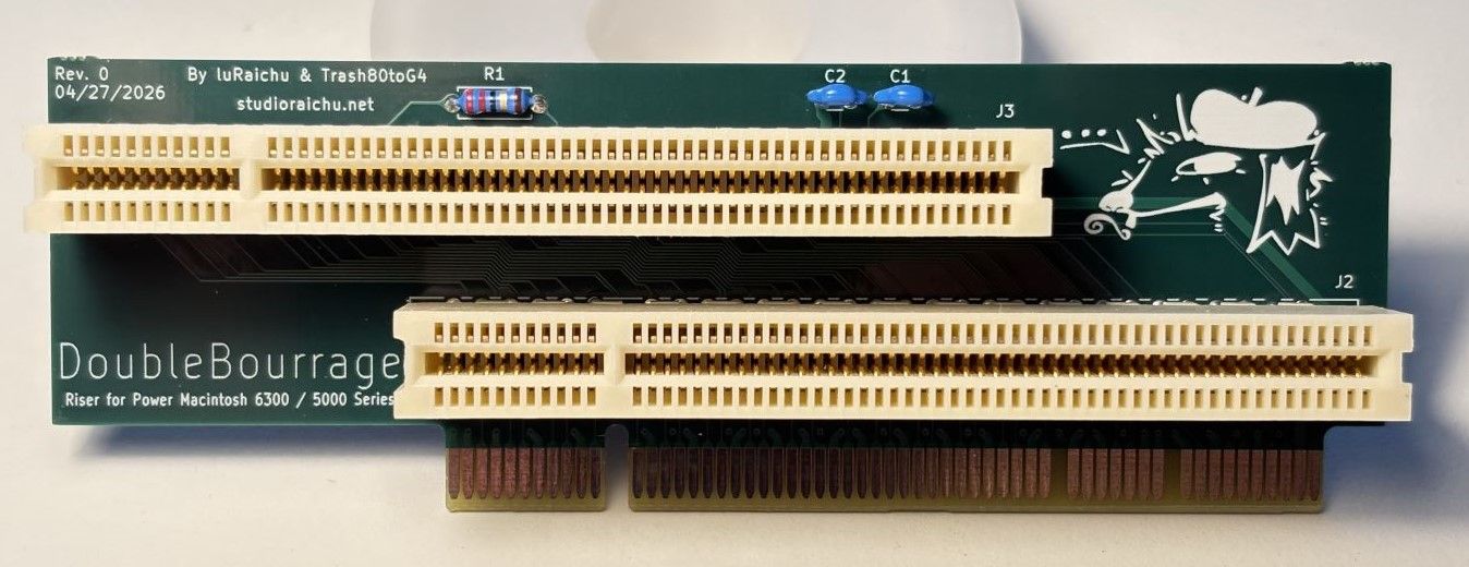

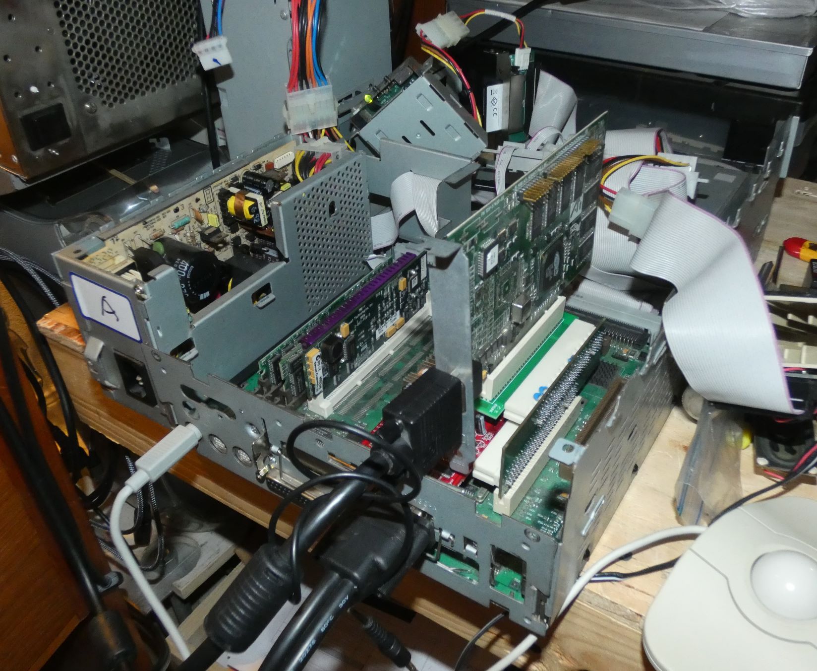

@luRaichu jumped into the project with both feet. He did the board layout, ordered the PCBs, the components, assembled the first one and it's in my grubby little paws for testing! All goes well so far outside of playing whack-a-mole with the gremlins actively undermining my attempts to get a stable testbed up and running.
TwinSlot moniker taken by IIsi card so we're calling this one DoubleBourrage, Double-Stuffer en Francais.

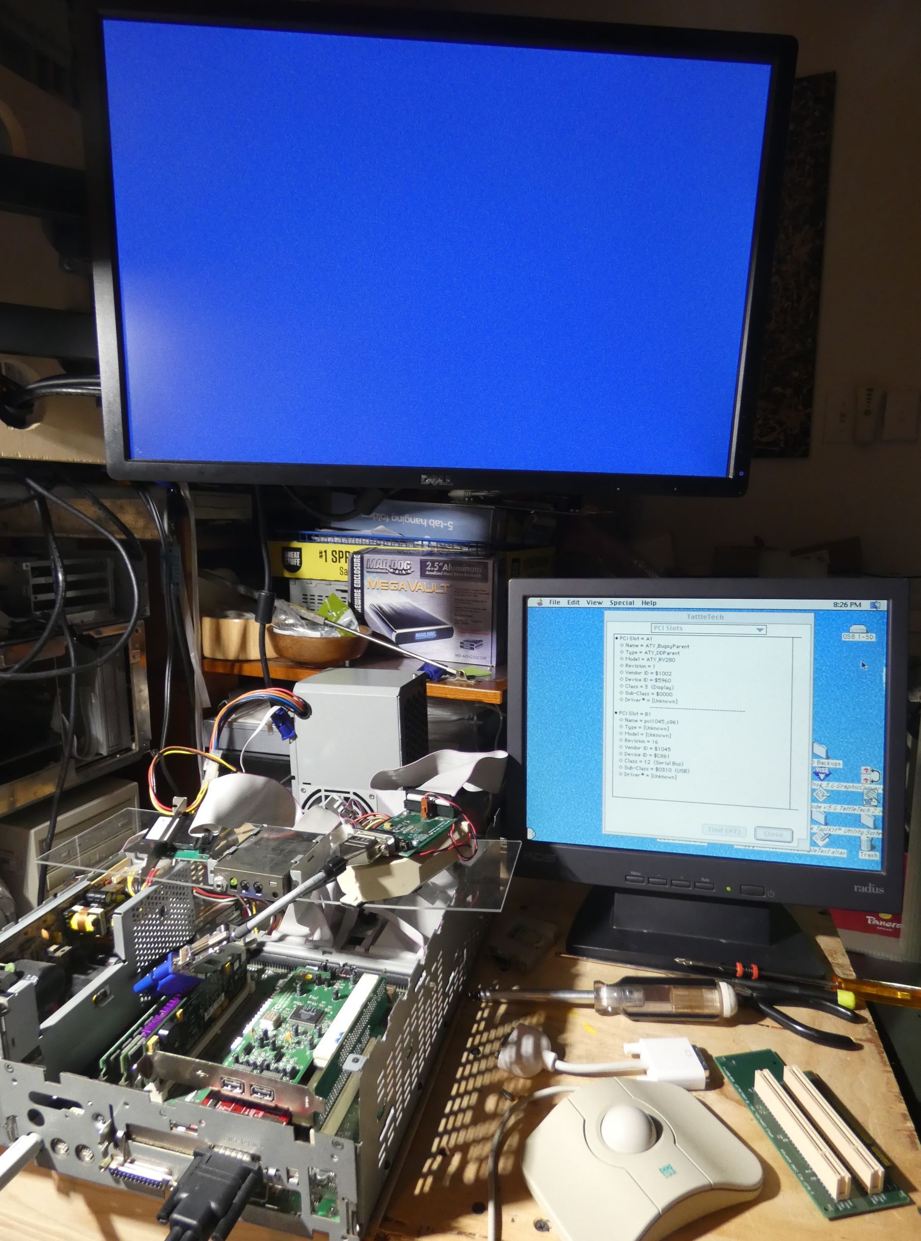

Craziness aside, got the first full test together and it passed with flying colors. Random USB card shows up in TattleTech's PCI Cards report, that's about all I was shooting for at the time. Nice big 1920x1200 main screen. I'd love to see that on a primary workstation with the secondary panel of the TAM active on a KVM setup. But alas, no TAM and no access to its PCI Riser for measurement and adaptation of the board design. Little help there? :unsure:
Need to get OS9.2 set up on another Compact Flash Card before I try to get much further along. Once the Crescendo/L2 is up and running I have all manner of I/O cards destined for the top, set back Slot_B.
Worse case scenario will be one of my trio of Sonnet TEMPOtrio cards, each with two channels of ATA-133, USB and Firewire. They're about the largest cards I can imagine fitting in the top slot. Tested for fit as it's been the aim all along to use one. It PASSED!. Supposedly works in Alchemy architecture, but they dropped support for Gazelle. But PCI Bridge hacks over at the MLA may prove differently?
It fits! But of course I dropped the friggin' CD and killed it. Need to find another one for the OS9 Lives installer.

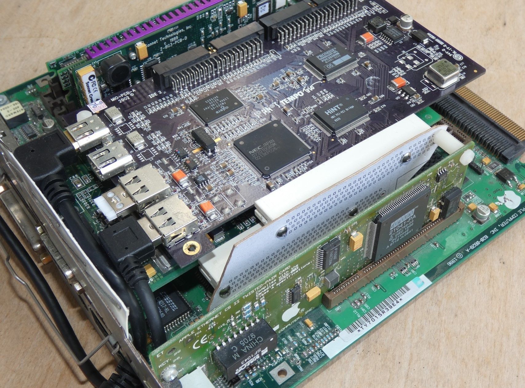

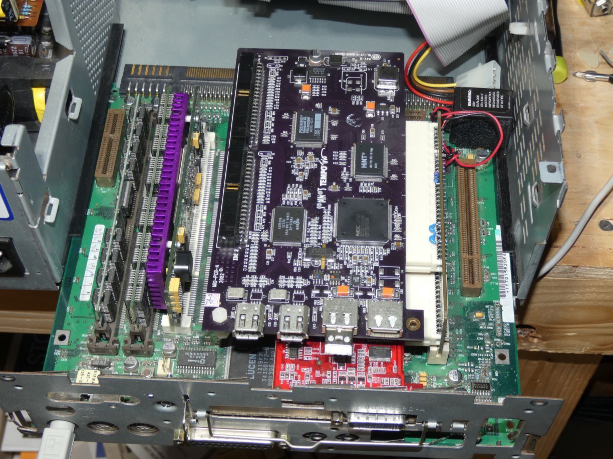

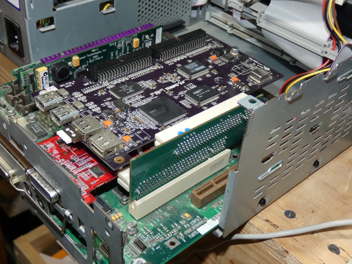

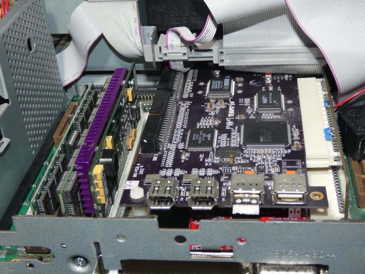

The trio is a full on seven inch PCI Card and I snaked it in there sweet as can be. If there are any problems with the MedusaMess and SCSI Optical I can just run an ATAPI Optical off the trio with a DOM on the other ATA133 Channel.
Set up my series of cardboard prototypes to just barely squeeze the trio in far enough for short, RA USB & FW extension cables to be snaked out the vestigial PDS Slot opening.
I set Slot_B back another tenth inch to make just a tad more room for the RA cable breakout and it still fits under the CD mess! I have quite a few other I/O cards to test. So it's gonna be a slog before official rollout. It's been a very long time coming, but product release is nigh! :D

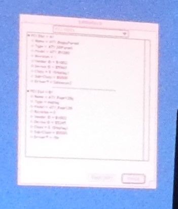

Small screen's the 6360's built-in graphics set at 640x480 so TT Reports show up nice and big.
Graphics Card in standard slot A1 is driving the big panel at 1920x1200.
ATI Graphics are nice, but take up a PCI address, so Gazelle can handle one less PCI Card than Alchemy?

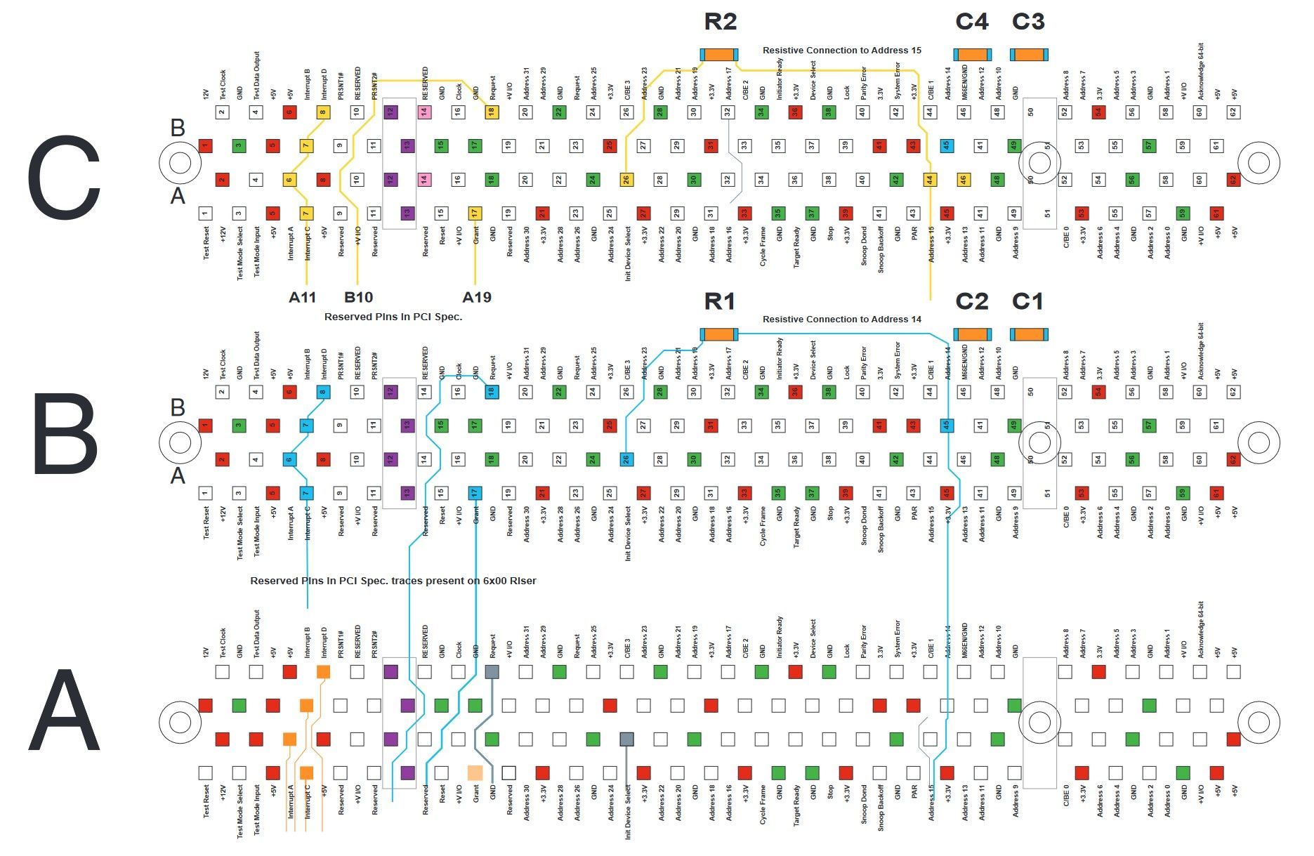

I'm not expecting any problems at all as it's an exact reproduction of the 6x00 riser. It's scrunched way down to fit in the PCI Drawer Macs with Slot_B1 set back for jumper cable extension to the outside world.
Hoping to create a QuadSlot Riser for the Testbed MiniTower some day. As tested, Slot_E1 connections are jumpered from a dummy CSII card to make room for a Gigabit NIC. ;)
but if you can identify the Address line for resistive connection we'd be halfway there.
Not sure what this means.
Since slot F1 has device number @12 (hex), I would expect that address line 18 (decimal) is used for the IDSEL signal for that PCI device. That's what the Power Mac 6500 schematics show (sheet 16 for the ATI-264GT device, area A6 in that diagram).
Slot C1 has device number @F so it must use address line 15 for IDSEL.
The PCI Slot in the 6500 gets 3 interrupt signals but I only see two grant/request pairs so the third slot can't be a bus master?

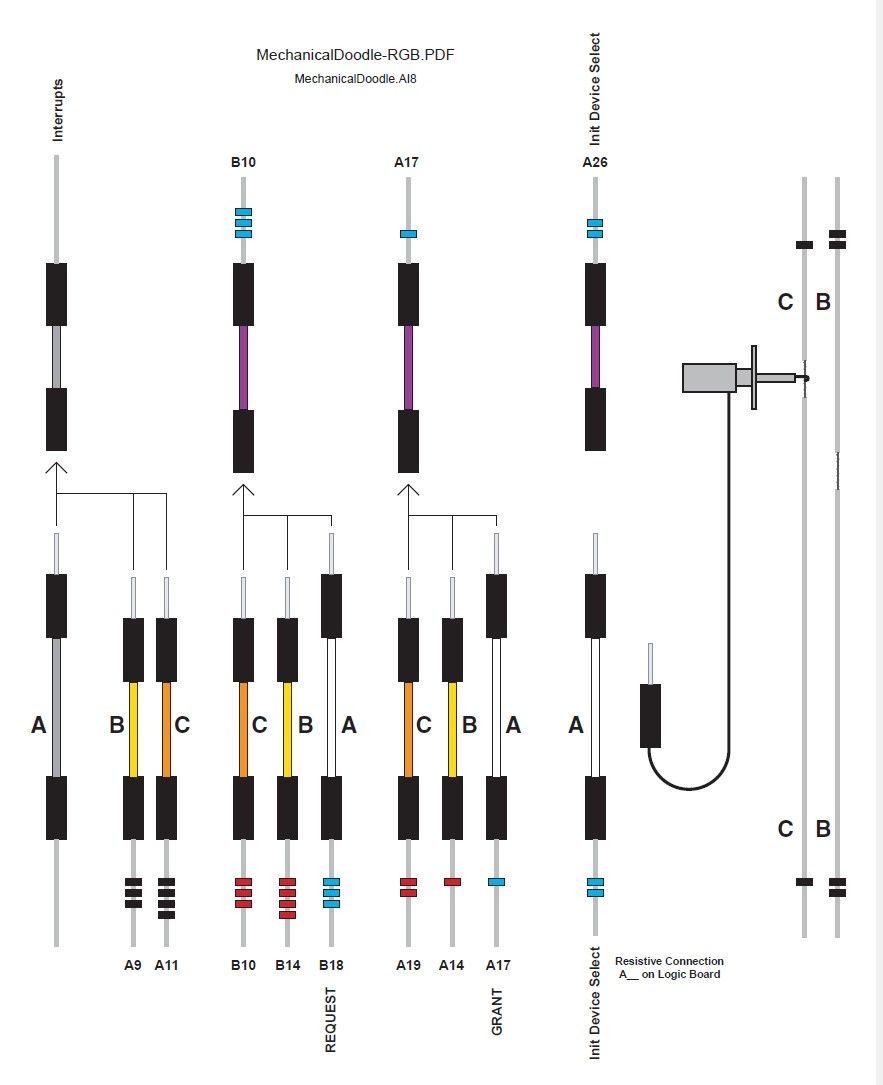

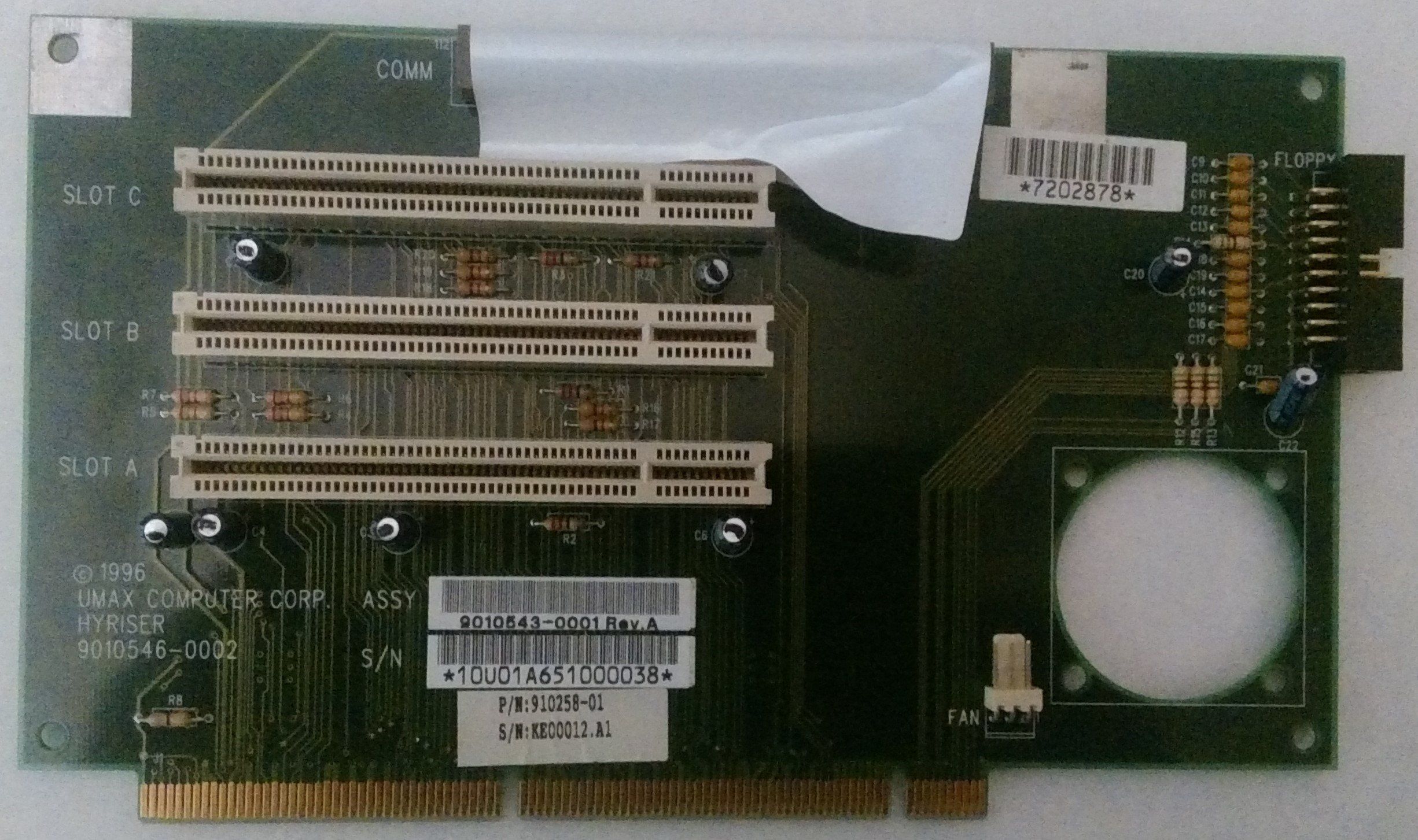

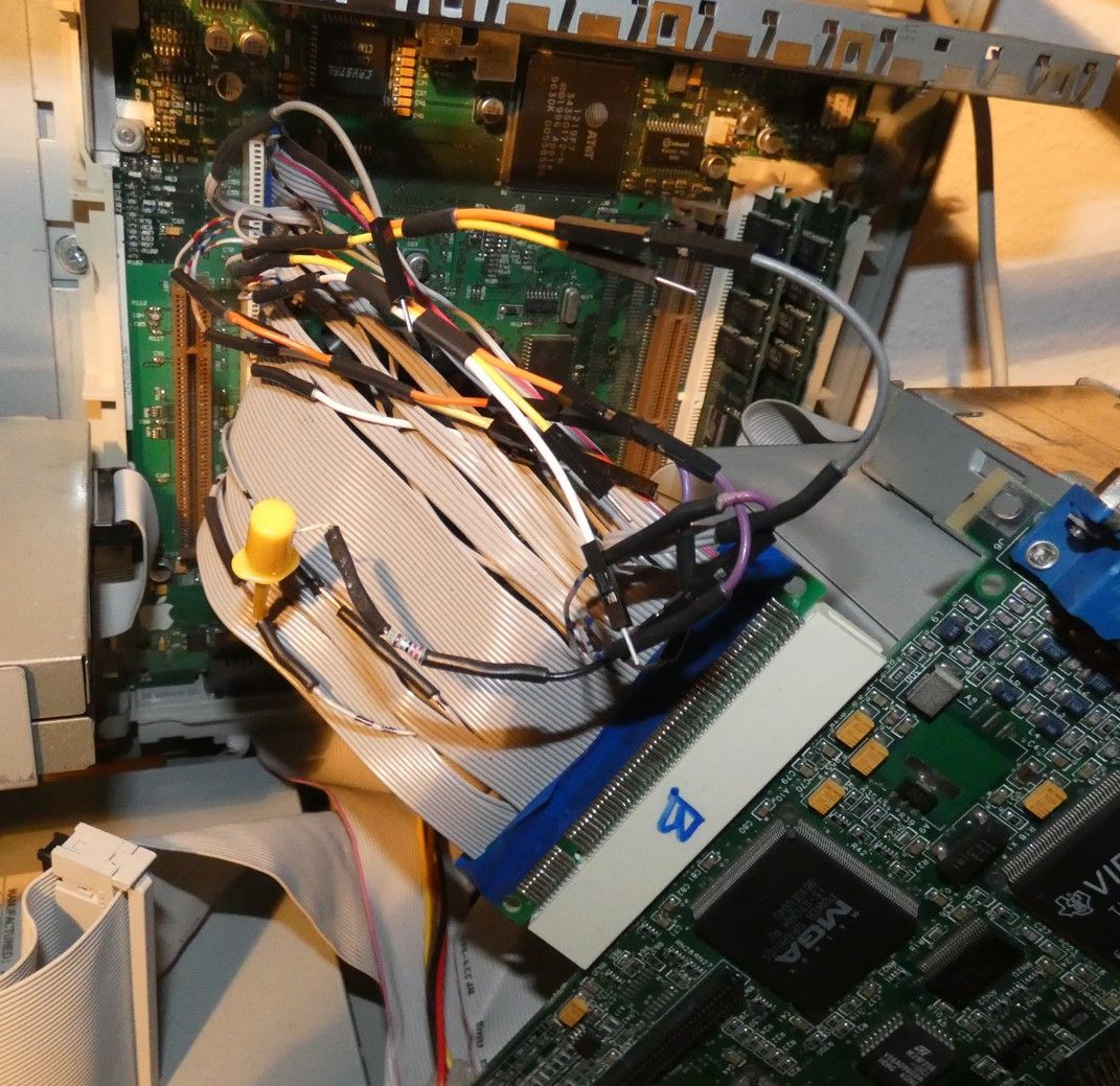

Dunno, all you do is well above my pay grade. I just reverse engineered the 6x00 riser and applied what I'd learned to set up the "Mythical Slot_C" @trag had as the third PCI Slot on one of his clone risers along with a CSII Slot that was taped over.
Apple tied all four interrupts together and came up with their own way of doing PCI, using pins unassigned in the spec . . . Apple! :rolleyes:
Everything is in this AI8 doodle, save for the two capacitor connections we discovered when I took a hacksaw to the connector on a 6x00 riser. Intended to buzz it out . . . but Neolithic Hacker Mode kicked in . . .
I do electron plumbing, in what I use for a brain it's all pipes. valves, connector fittings of every kind, gate valves, backflow prevention and whatnot. Kinda works for me. Grew up looking at the LSI and VSLI textbooks as artwork when dad was a boffin at IBM's Glendale Labs and had that stuff laying around.
This is my test rig, it stopped working reliably, but I can bring it back to life if you can identify what might go where to activate Slot_F1 and I can test for it in jumper wire playtime.
I ignored the capacitor connections and everything checked out in a basic fashion using TattleTech's PCI Slot Report. I'd imagine they're there for a very good reason when it comes to full card function. No Clue there, but I can update the artwork.
edit: first thing to do is check to see if there are any "unassigned" pins remaining on the riser connector.

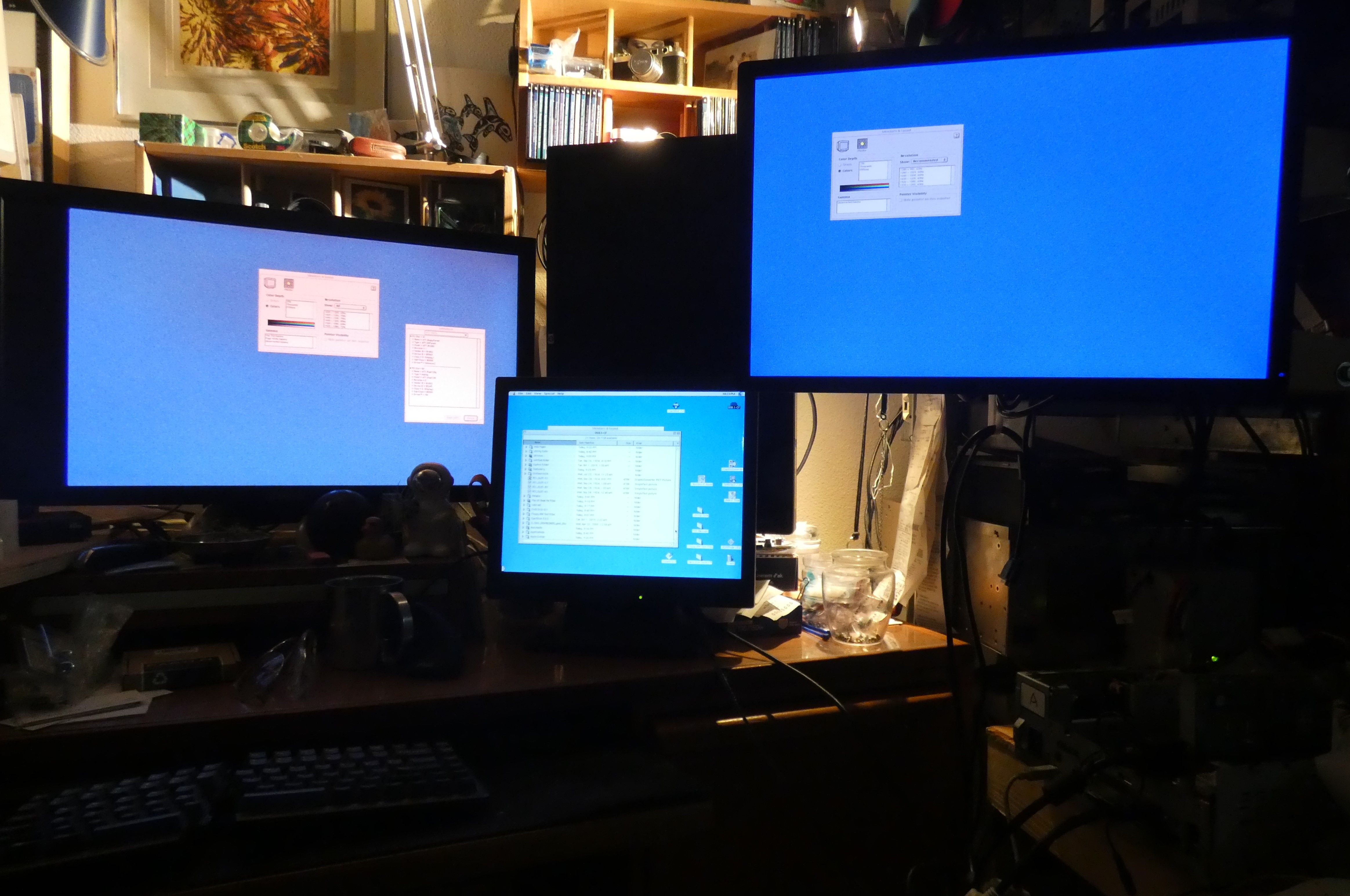

YAY! You got me thinking outside where I'd boxed myself into only using Slot B_1 for USB/FW! :D
I can just as well throw a second VidCard in there for a three screen Alchemy/Gazelle machine as my test case for TwinSlot!

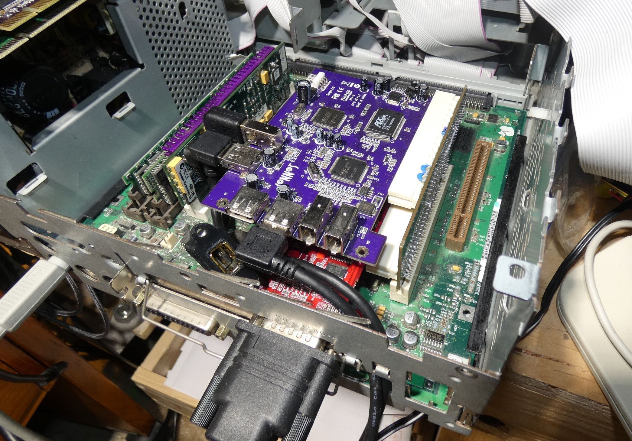

5.2 MILLION PIXELS! Gotta be a record for a 6360/5x00 Machine, on three displays no less with 24bit on the two larger panels.
The backplane plate was in the way to hook up the second VidCard. Couldn't find my RA VGA pigtail in order to move the hookup connector out through the vestigial PDS Slot opening like I did for USB/FW and just quit looking. Snagged a bog standard single slot 1U PCI Riser out of stock and the damn thing wound up looking like this:
Still a tiny bit of strain on the connector, but no problem getting only 1920x1080 up onto main 1440p panel. Post-It Note on the Card said it should do 1920x1200 which would have snuggled right into that display's aspect ratio. That would have made it 5.4 MILLION PIXELS, but who's counting?
Dunno what's with the positioning/scaling problem. but too tired to noodle it out tonight. I've seen such scaling issues many times before and it's always been the display at fault . . . so far anyway.
I'll swap VGA and DVI connections around to see if that'll fix it, but that's no reflection on the Double-Stuffer! It just works!
Screenshot was too wide for GraphicConverter to grok, so you can't see the PCI Report, but you can see the pixels from the capture!

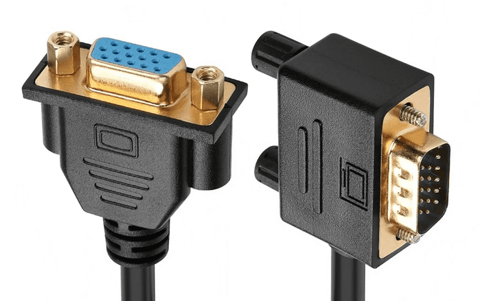

Been working on the cabling end of things. Need to catalog which cables will work with what I/O Card someone will be moving to the upper, setback Slot_B as in the photo.
Got it all worked out on the Sonnet TEMPOtrio in the 6360, but the Sonnet Tango 2 is a little bit nastier with its vertically oriented Firewire ports.
What I have on hand is too short, but would work down angle in a longer length cable. It pushes up against the Tango 2 a tad more than I'd like and it almost touches the Crescendo/L2, but I'd figured it wouldn't work at all. A touch of hair dryer curvature adjustment and it would be good to go.
I think I've found what would be right and left angle varieties that'll look like a verticalized fraternal twin of the USB pigtail plugged into the backplane of the Tango here. Those I've found are all Male to Male, so a Female to Female gender changer on the shortest one that'll hang off the back will likely be best. My panel mount terminated female extension connector's a bit on the unsightly side of things.
I stuck one of the down angle USB3 pigtails I use on my KVM Switch next to the Firewire cable on the card's topside, next to the G3. That one works a treat, the cable is thinner than the Firewire cable as it should be.
Cables run out the back of the 5x00 machines through the same vestigial PDS port opening. Had a heck of a time finding a pic of its derrier!
The relocated Tuner Bay had me thrown off, I knew there was something funky with these machines, thankfully it wasn't a relocated PDS Slot opening, which makes sense if you think about it rationally. :rolleyes:
So far so good, both form factors are easy enough to route the cables and the TAM is a breeze running them straight out the relocated CSII porthole right next to the top slot of the brand spankin' new double riser . . .

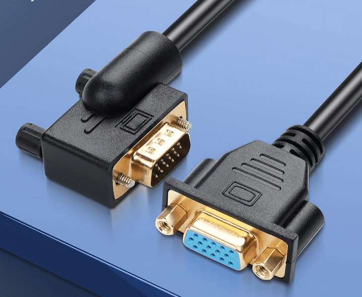

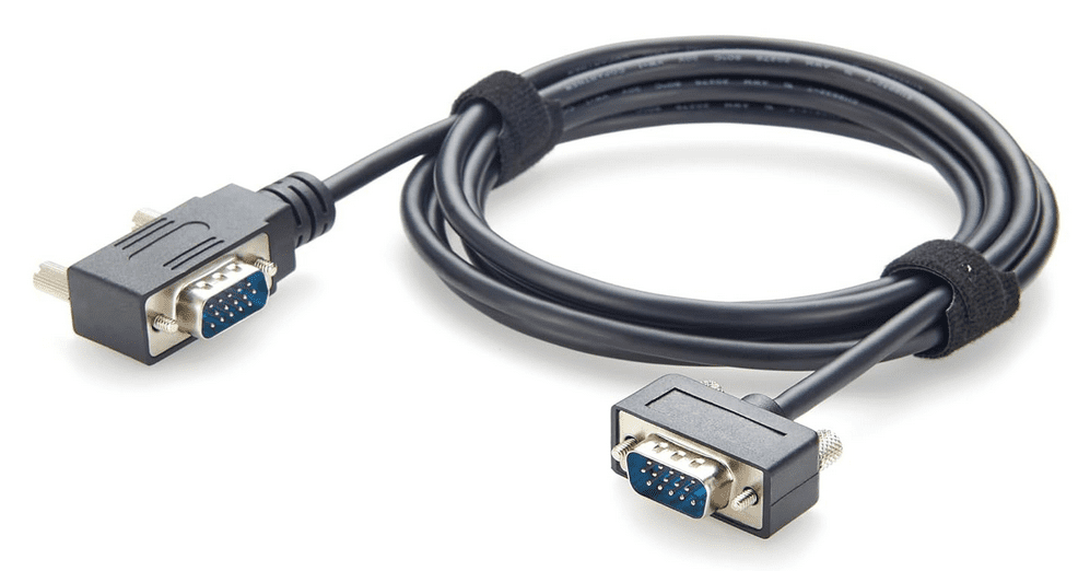

I'm developing a real LOATHE/Hate relationship with that damned Tango 2! First off was the non-booting problem I caused myself when I didn't set the screws correctly when reinstalling its backplane plate. Now its those stupid, vertically oriented Firewire connectors getting in the way of the Right angle VGA cable that arrived today. Cable itself is offset, having a half cylinder running across the "block" of the connector right where the top of those Firewire connectors are located. Nothing a vicious attack with wood rasp and files couldn't fix . . .
Screenshot 2026-05-26 at 19-31-07 Amazon.com PNGKNYOCN 90 Degree VGA Extension Cable,0.5M Righ...png
It's the Left Angle version I had for my last Notebook's swivel stand, but couldn't find it. Only saw this pic:
. . . really? :cautious:
That one was $11, half a meter and overnight. Now I know to get this one for $18 more at 1 meter and a three day wait . . .
Screenshot 2026-05-26 at 19-48-11 Amazon.com Plinkwirekb Left Angled Low Profile VGA SVGA Cabl...png
I'll still have to attack it with the wood rasp and files, but only the angled end.
So it goes . . .
Looks like whichever side of the cable above facing upward will need to be filed/sanded/whatever to get the housing/cover's profile down to the level of the D-Sub connector's outer rim in order to clear the top of the drawer opening. The Rev.0 Prototypes are working great, busy tweaking fitment details, just a tad too tight at the top end.
