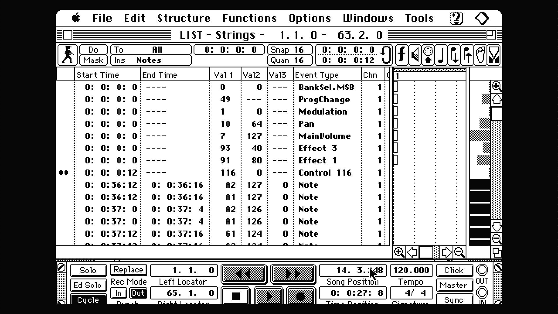

gotta dig inside the details of the list of midi commands for each track. the mid file stashes away an instrument definition there:

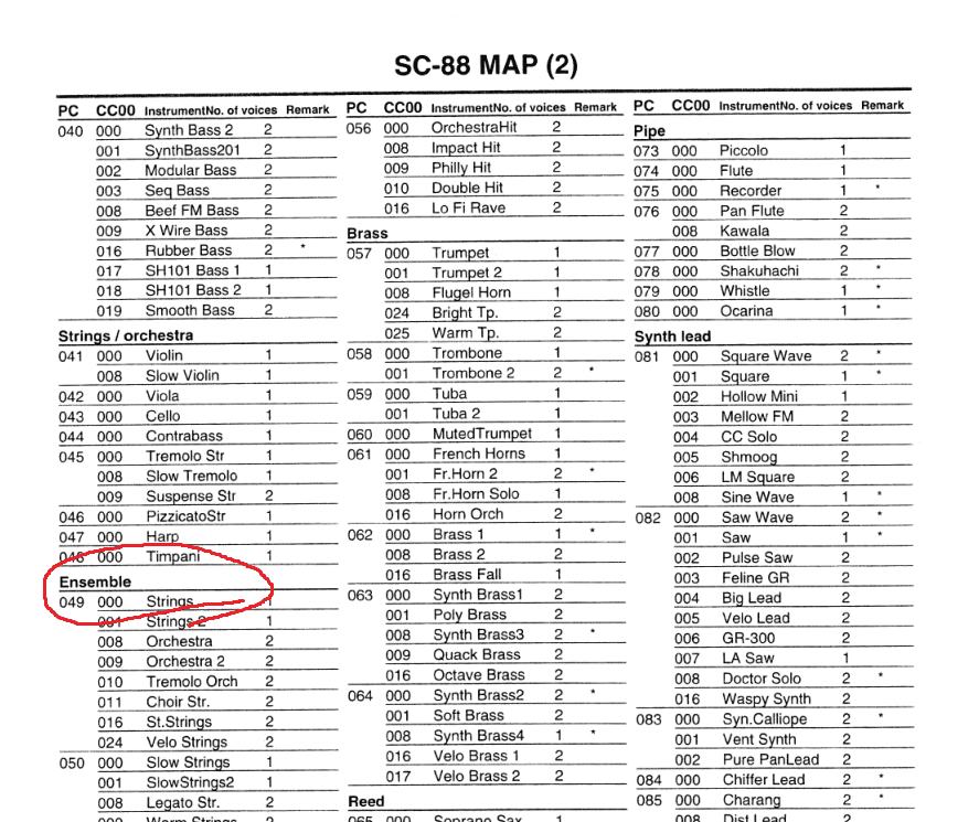

As seen above, event type "ProgChange" with Val1 = 49 corresponds to my Sound Canvas:
I eventually settled on trying to find where "Prog Change" or "Program Change" occured, since it is an official MIDI "Event" in every documentation of all the MIDI gear in existence. That first step was important because prior to that, I didn't know if "Bank", or "MSB Bank" or "LSB Bank" mattered. They didn't. I didn't know if my 88-key m-audio keyboard was the one that I had to use and fiddle with its physical buttons to set my instruments. It wasn't. The madening thing about it all, is that I found 3 places in Cubase where I could see "ProgChange", but I could only manually edit it in exactly one place.

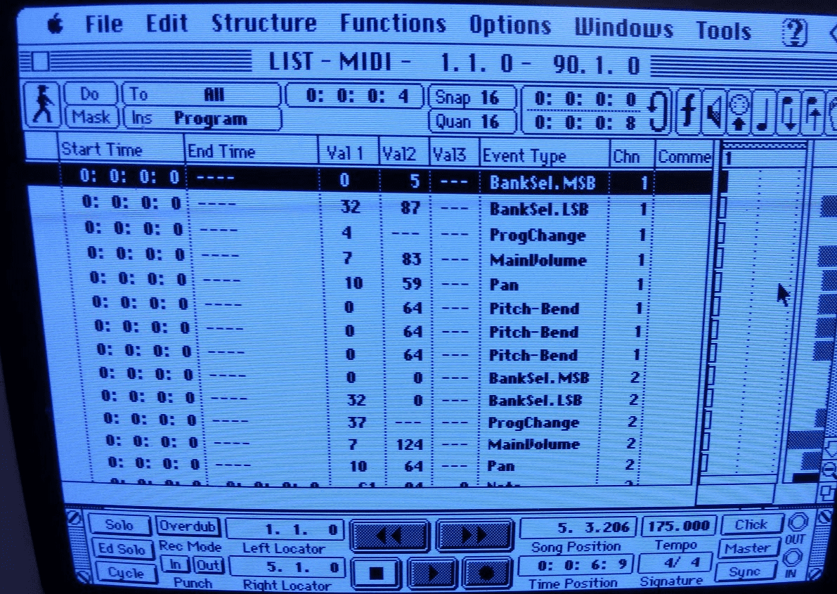

When you open a plain old MIDI file from any era, it will attempt to seed its information in the "Cubase environment" as best as it can, but the real MEAT of the info is found in the "Event list" like in the screenshot above. That's basically where I saw for sure that the instruments were defined right at the start of the tune, for every one of the channels you use (up to 16 simultaneous ones). you can perform Prog Change to swap in and out other instruments later on, but for my simple tune, I didn't need that, I have far less than 16. There's a zillion events in that list (every note change. every key velocity change. every pitch bending, etc etc etc). you can filter them ALL OUT and only keep prog change, which is what I did. And I had to choose the pencil tool, then click-hold the "Ins" nondescript button and select the event type "Prog Change" (the event type "Note" is the default one) and then click on a subspace of the interface to finally insert my progchange events, then edit its value to the instrument # found in the general MIDI specification (also found in my Sound Canvas manual) (edited)
I lost a lot of time believing the Cubase environment CRITICAL song information was going to be transfered over to an "Export to/Save As MIDI". There's a conveniently placed tempo parameter right there on the main screen. Well, it will act when you play your tune in Cubase, but it won't be sent over the MIDI file you're saving. Why? Who knows. You gotta set the tempo elsehwere in a dialog out of view that controls the MIDI Master Parameters. This is why my first exports were running at 120 beats per minute (the MIDI default) rather than the one I was composing on my Cubase environement at 90 bpm. Same goes for every instrument choice I made for all my channels. I selected and heard my instruments correctly as I was composing, but that was Cubase-only stuff, not MIDI stuff. I had to create MIDI event commands myself to make sure it'd export right. (edited)

go to menu Functions, List
go to menu Tools, pick the pencil
click on INS, pick controller
add an event at the beginning of the song, and basically reproduce this screenshot
A full instrument selection compatible with MIDI needs these near the beginning
BankSel.MSB with values of 0 and 0
BankSel.LSB with values of 32 0 (might be able to play with values if your module has more banks)
and then for every instrument change, you need to put in a:
ProgChange with value = instrument #
