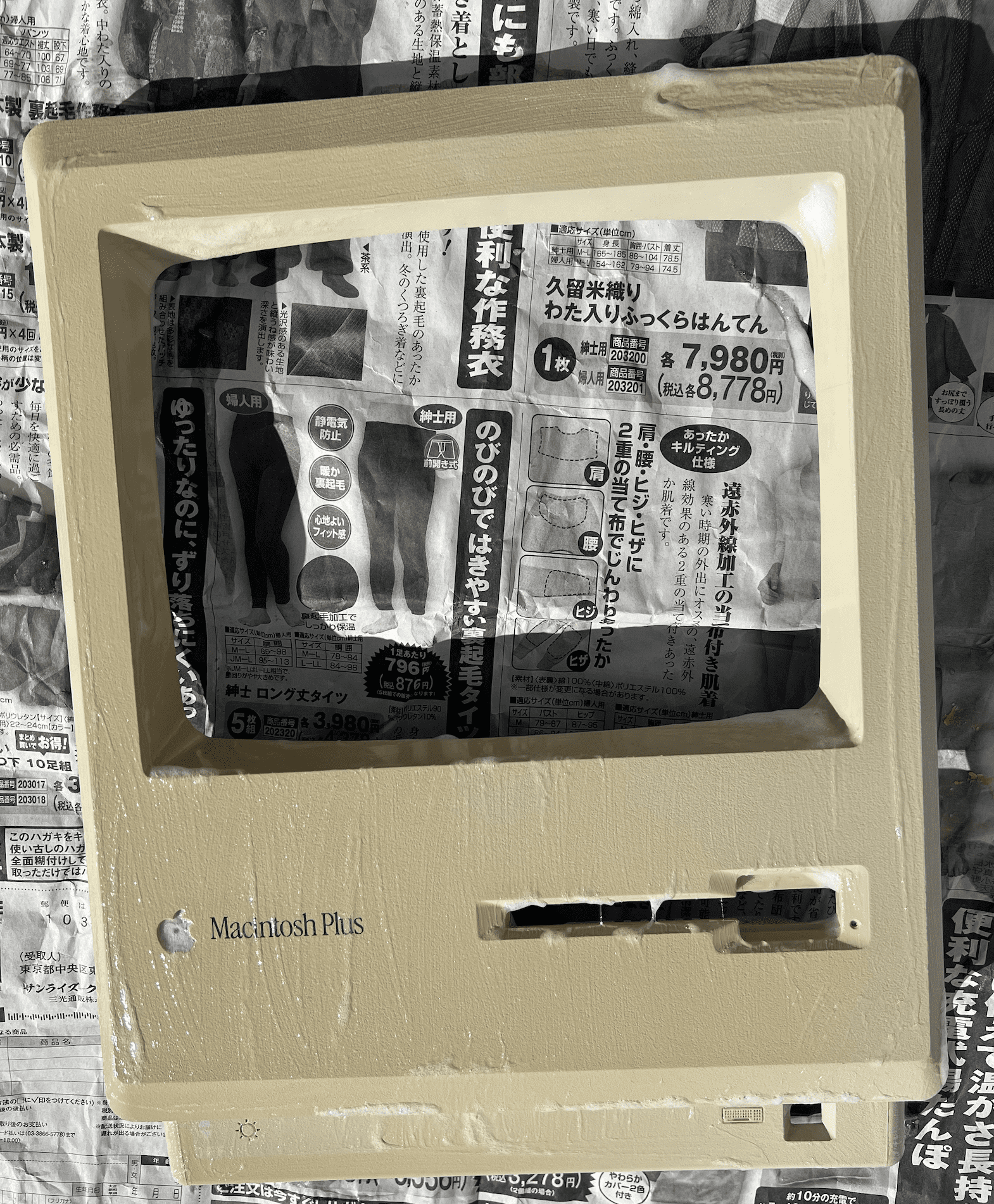

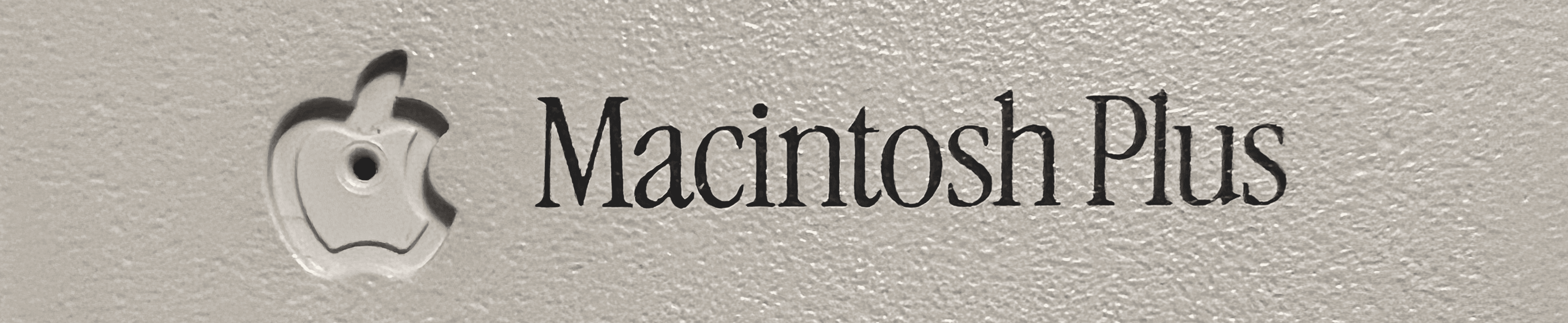

Please note that the cream did NOT over brighten the bezel! From the area under the logo, you can see that the original color was even brighter.

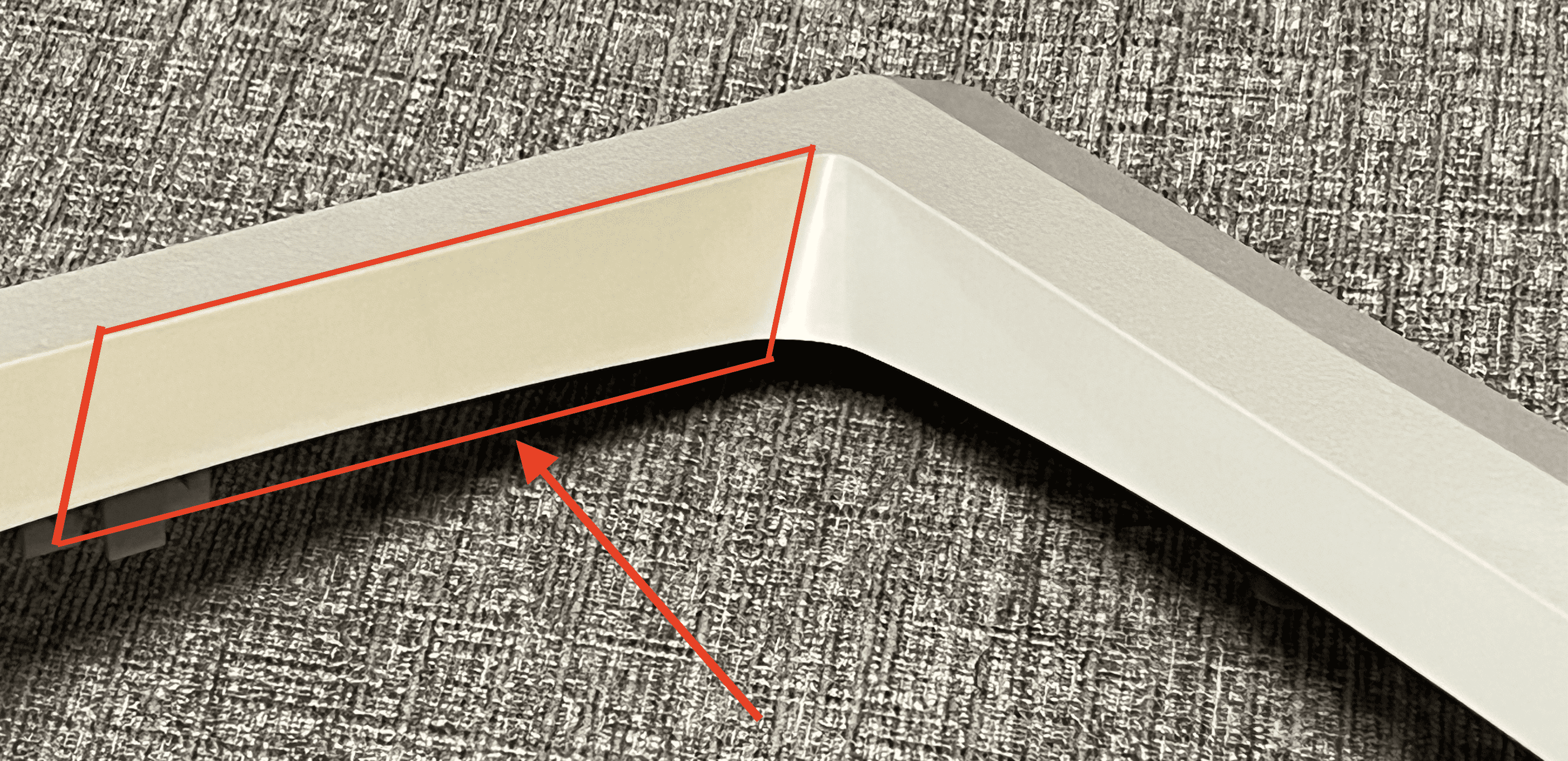

On the negative side for the cream. the bezel color was not evenly restored. On the left side of the inward CRT bend, there's extra yellowing, as highlighted in the image below. This is partially because it's difficult to get all the edges an equal amount of sun in such a short amount of time.

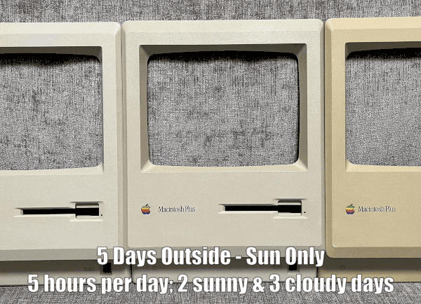

Sun Method​
Bezel was placed outside in the sun, in the middle of January, every day between 11am and 4pm (I get limit sun due to surrounding buildings). 2 of the days were sunny and 3 days were cloudy. Temperature was cold, about 6°C/43°F every day. I did check on it everyday and on cloudy days the bezel would get brighter as well. I would place the bezel at slightly different angles every day to ensure all edges got some sun. Only the top side came out a bit darker, but this can be easily fixed by placing it at an angle to focus on top side.

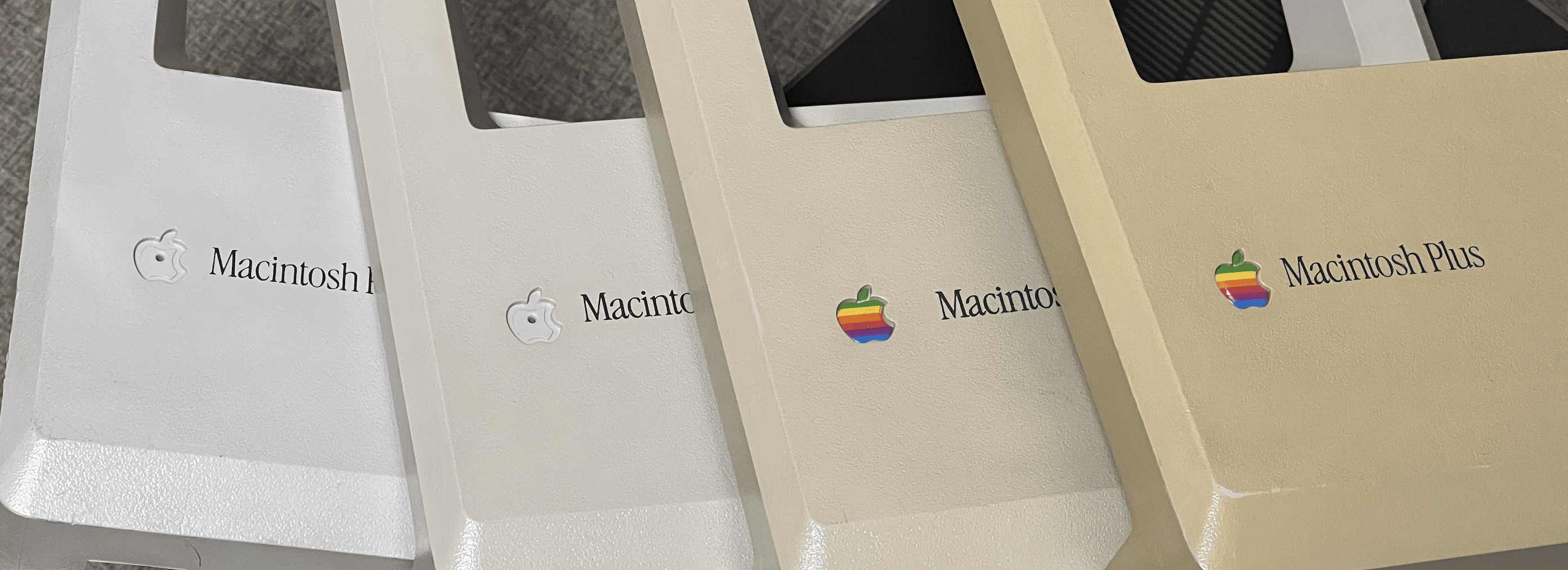

Below is an image of 4 Mac Plus platinum bezels. From left to right:
1. Original Color
2. Brightened via cream, original color can be seen where the logo was removed.
3. Brightened via sun for 5 days
4. Heavily yellowed bezel (right side bezel from above gifs)
Lastly, I'd like to note that the 5 days of sun had no visible affect or discoloration on the badge, however I'm sure that if I did leave it out for a couple weeks it would.

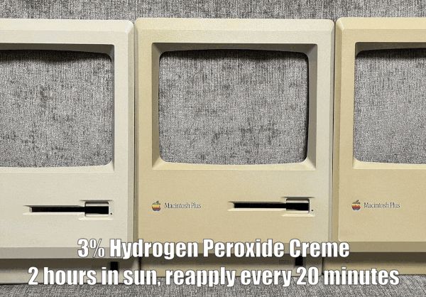

Cream Method​
I followed the method described in this youtube video.

I used a hand mixer to to mix everything, consistency came out very similar to video. I tried to re-apply cream every 15~20 minutes; I'd recommend every 15 as after 20 minutes it was starting to get a bit hard. It was in the sun for just about 2 hours.

The sun did a surprisingly really good job! However it seems you'd probably need to leave it out in the sun for a month if you'd like to remove most of the yellowing.
The cream also did a great job, but it can be hard to get even results on a heavily yellowed bezel.

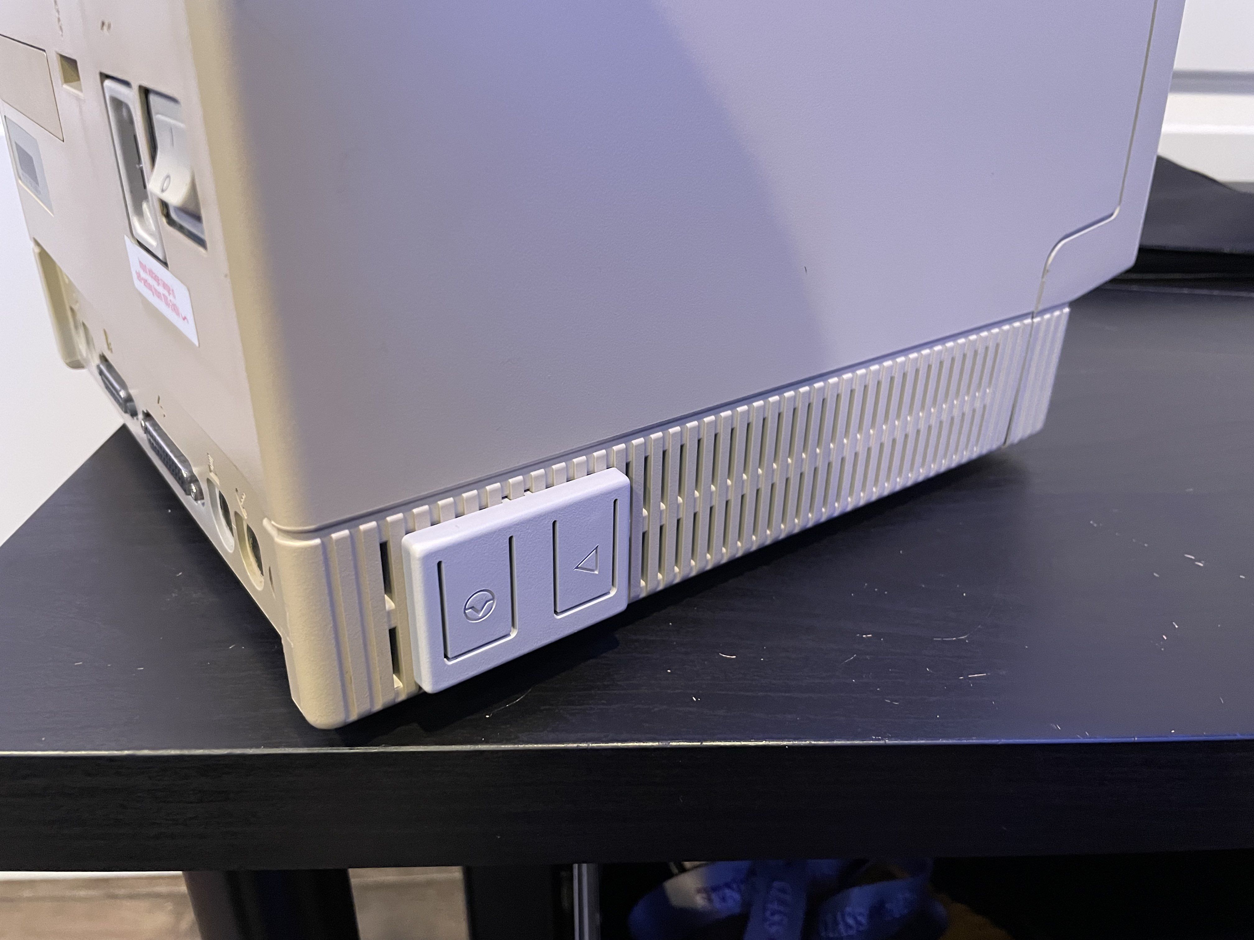

In the meantime, I treated the reset/interrupt switch to give a demo of the contrast between the current yellowed state of my SE and the original Platinum color.

I'll give it a try with my SE face plate for the video, I plan on doing it tomorrow since I just took it fully apart.
Reactions: wottle
Also, I forgot to note that when I do the plastic wrap, I try to ensure I squeeze out any air bubbles under the plastic. I think large air bubbles could allow the peroxide to dry out, which could be the cause of some people's problems.
