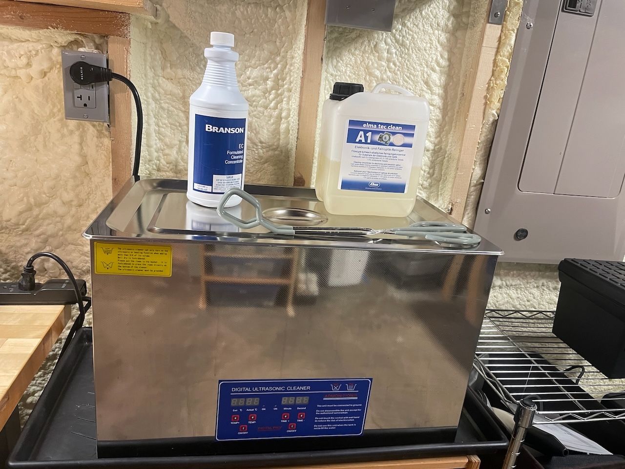

My VEVOR 30L Ultrasonic Cleaner is approaching 4 years of sporadic use and I'm doing a water change now so I thought it might be interesting to create a thread to share my experience and hopefully hear from others too. Let's share recommendations, tips and tricks!
I have a feeling this specific model has gained some new users after @Branchus and @Mac84 did some great videos on it a while back:
Overall I'm pretty satisfied although honestly not sure if there are other options in this size and price range.

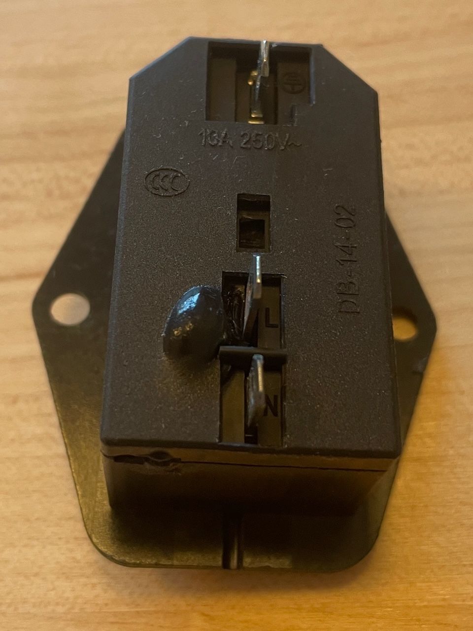

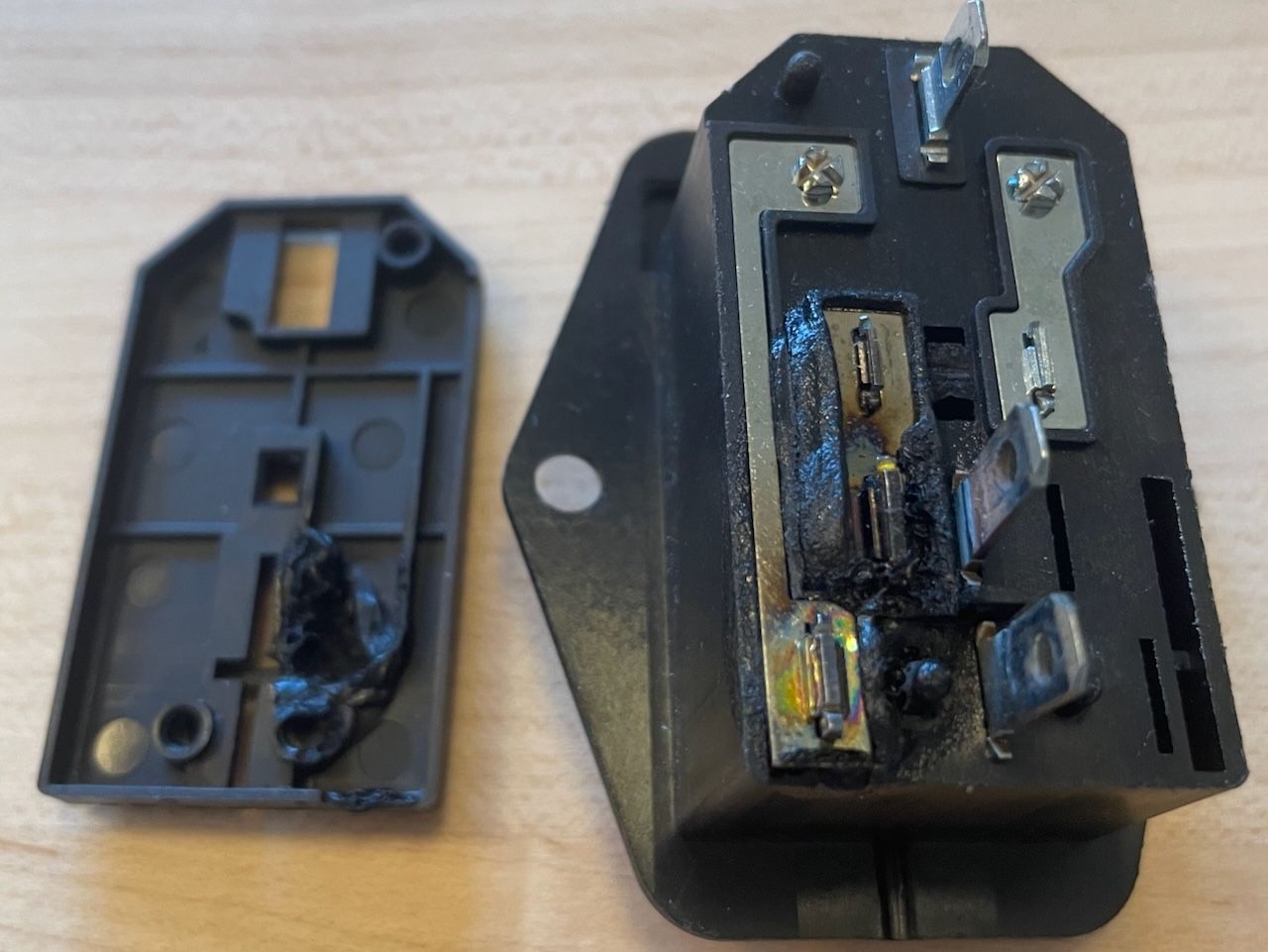

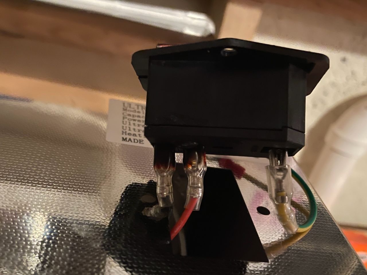

Unfortunately, I have had two issues so far that certainly fall in the "not great" category:
I replaced the switch and its been working okay since. Maybe just a random faulty part?

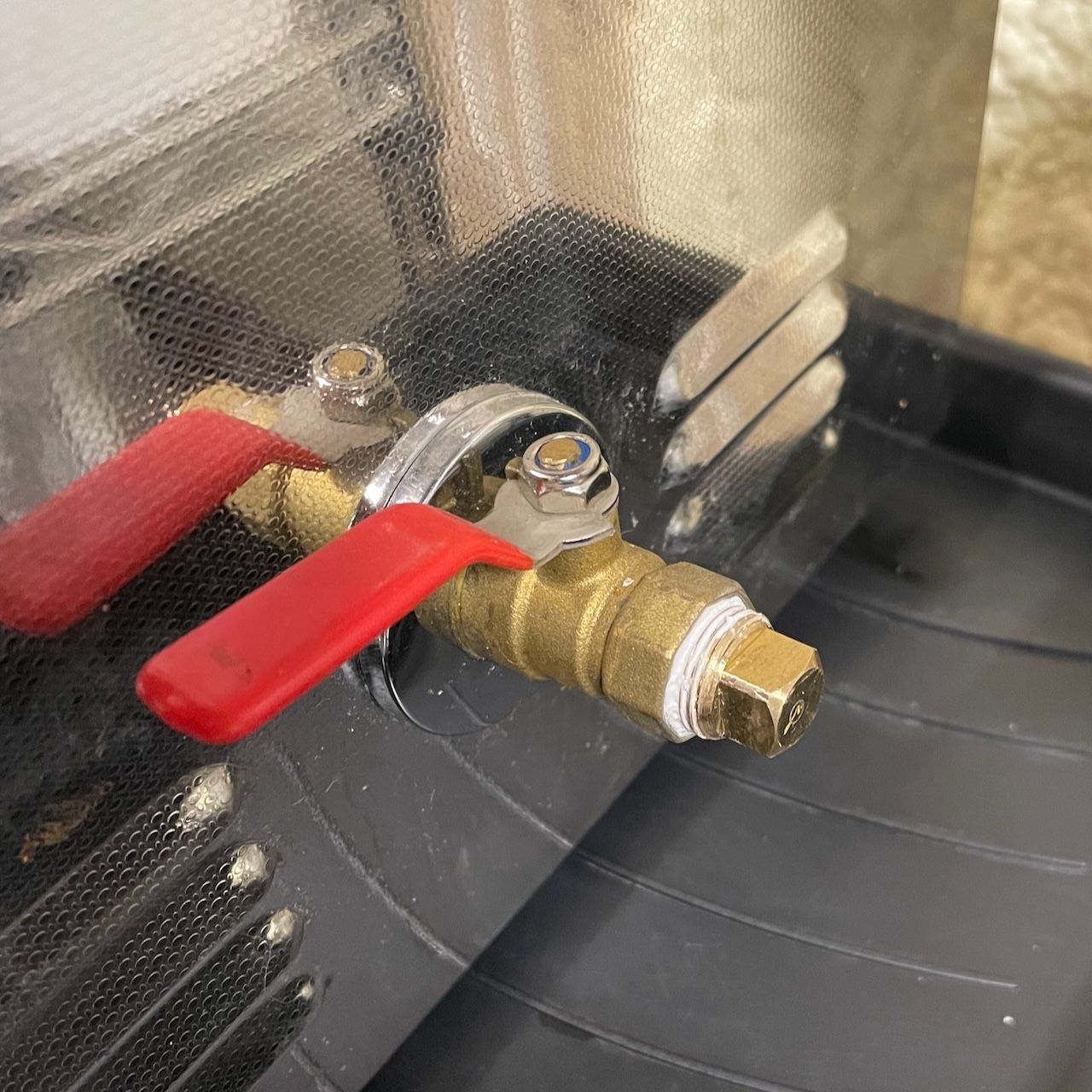

Just recently, after almost 4 years of use, in doing my second water/cleaning solution change the drain valve seems to have given out. When I first opened the valve I only got a trickle until I used a chop stick to agitate the drain hole at the bottom of the tank. I think I underestimated how much gunk had found its way in there in the 2.5 years since I last did this. When it was empty I took it outside and used the garden hose to flush the valve from both sides and some little corroded metal bits came out. When trying to fill it back up with distilled water the closed valve had a steady leak. I thought about trying to replace the valve but ended up just getting a brass screw plug. I wonder if the cleaning solution and/or what’s been coming off the boards could have played at part in the apparent corrosion?
Filling and Cleaning Solution
As others have noted the “30L” size seems to be like the old “15 Inch” CRT monitor marketing (13.3 inch viewable!). I’ve used 6 gallons (22.7L) of distilled water which is as close to the top as makes sense to me (~3/4 inch). Using distilled water at least starts you off without any minerals and impurities that might be in your tap water. Although after a while I wonder how that would compare to what comes off what you are cleaning…
For cleaning solution, up until now I have used “Elmasonic 800 0102 Elma TEC Clean A1 Ultrasonic Cleaner Solution Concentrate for Electronics and Optics” Its $113 for 2.6 Quarts (2.5L) on Amazon (10/27/2024):
https://www.amazon.com/gp/product/B0725WP9Z9/?th=1
The Elma instructions recommended using 3-10% of the water, I used 3%, 23 fl oz (681mL).
However, this go around I’ve decide to give Branson EC a try as it seems highly recommended. I ended up getting it off eBay, “Branson EC Concentrate Circuit Board PCB Ultrasonic Cleaning Cleaner Solution”, $70 for 1 Quart (950mL). Pricier than the Elma.
https://www.ebay.com/itm/185929230724
The Branson instructions say to use 2-5% by volume, with 3% recommended. Which I’m just about to do (anyone go higher or lower with this stuff?).
