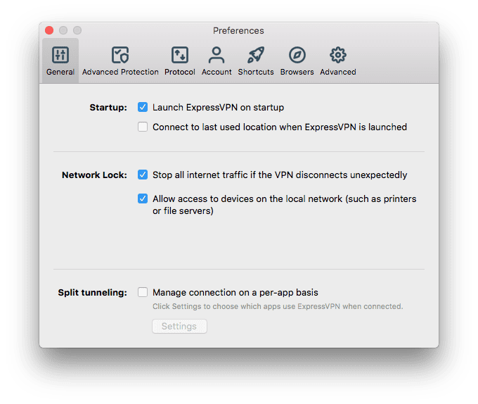

I use Express VPN.
Under Preferences->General, make sure "Allow access to devices on the local network (such as printers and file servers)" is checked?

Try it and see if it cures your bluetooth issues or not. I am assuming you only use the mouse with one computer at a time... and when you turn on the VPN on that computer, then mouse disconnects?
