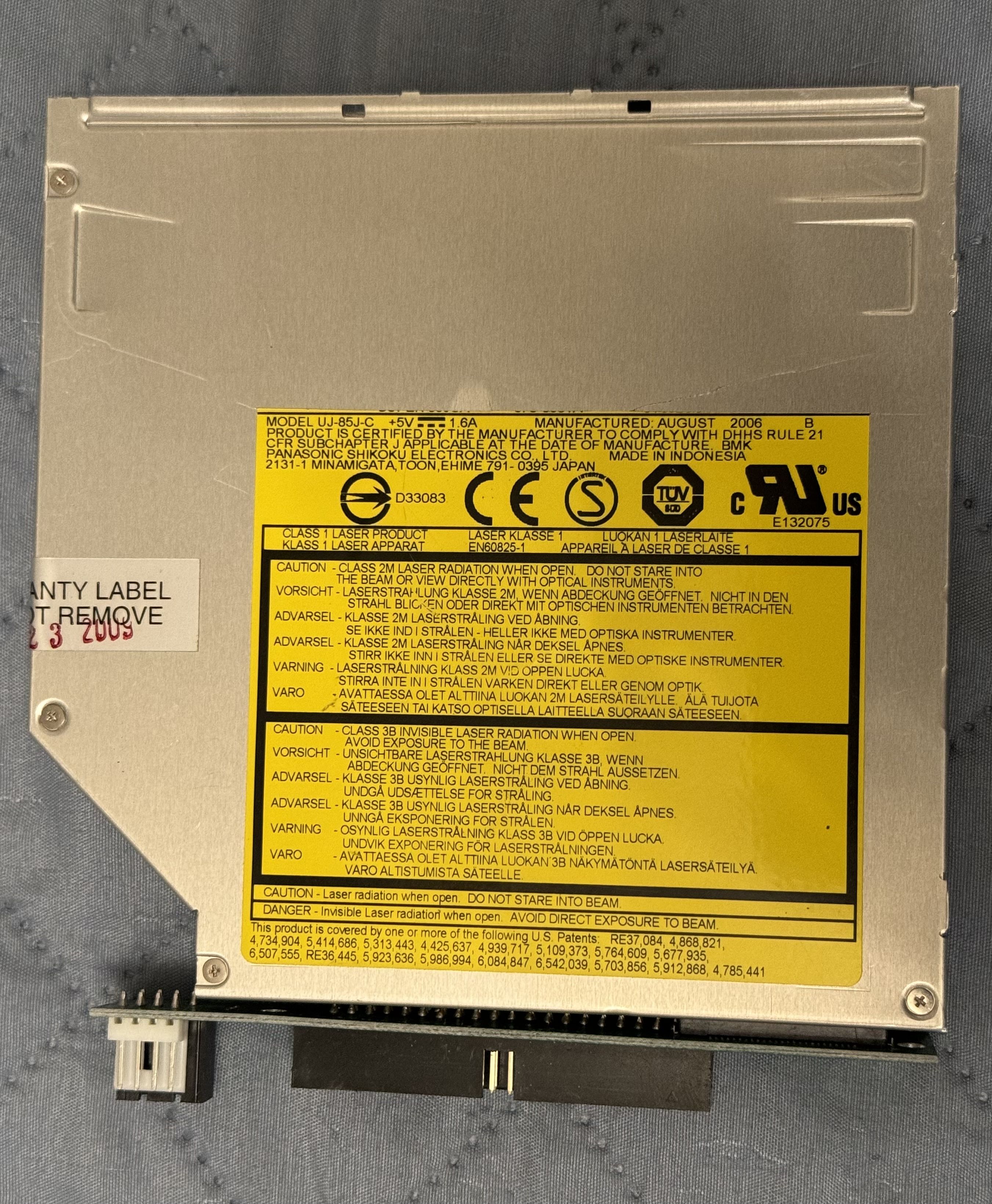

For my choice of the drive, I settled on the Panasonic UJ-85J-C. I got this model from eBay for about $16

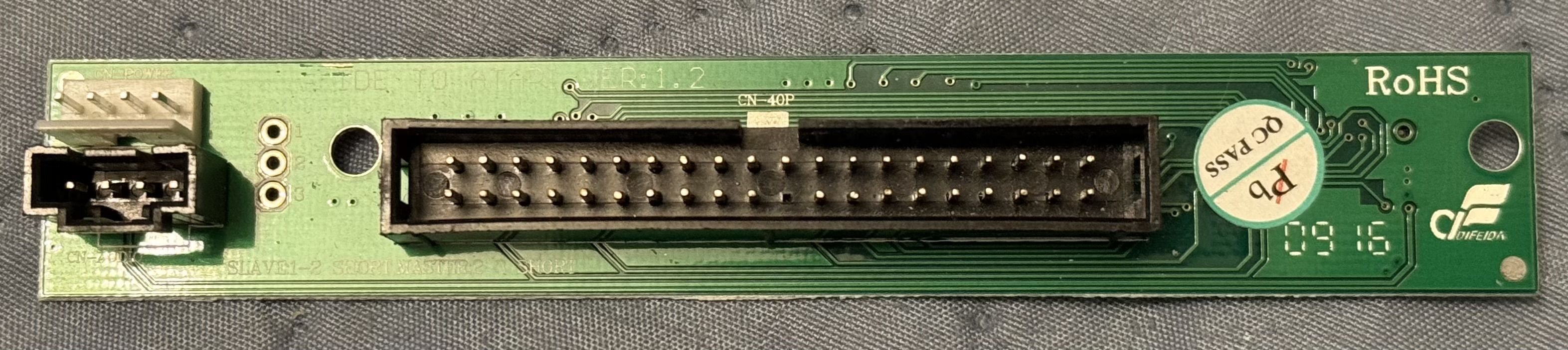

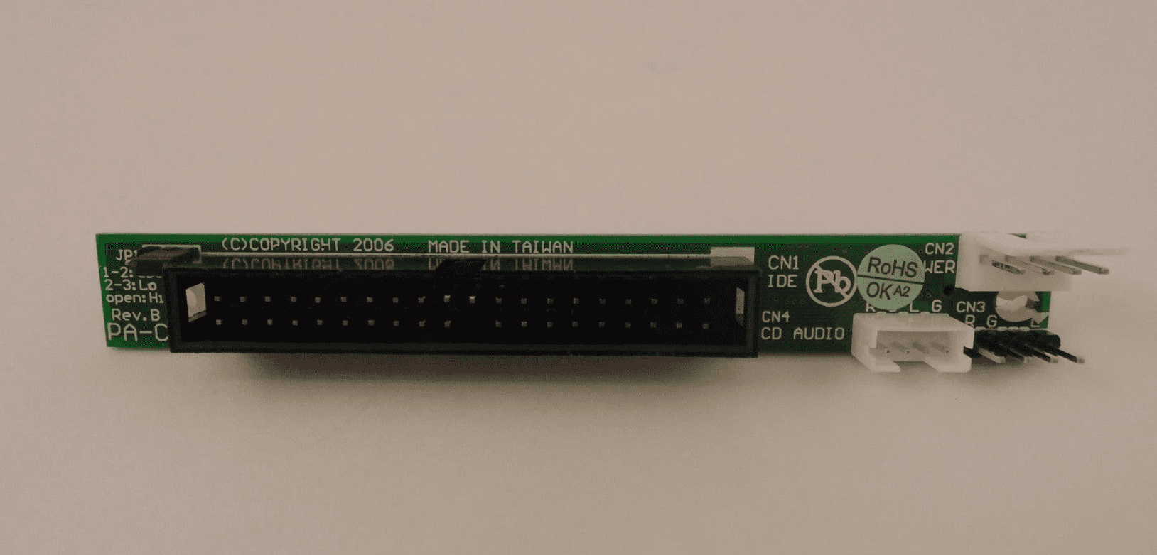

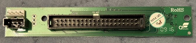

In the video, the IDE adapter he used had a connection for a laptop IDE connector and made a custom cable IDE cable. I wanted to make things a little simpler so I looked for one that offered a standard desktop IDE connector. In my search, I settled on this one that I acquired from Ebay.
Here is Ebay link for the part. Looks like the seller still has some in stock at the time I post this:
https://www.ebay.com/itm/271340030850?mkcid=16&mkevt=1&mkrid=711-127632-2357-0&ssspo=aXSId9wMThC&sssrc=4429486&ssuid=vo_lR5CuTba&var=&widget_ver=artemis&media=COPYthe
Update: This part is no longer available for purchase (at least from this vendor). A compatible part can be purchased from this EBay seller:
https://www.ebay.com/itm/142288879608
Thanks to @TJ812 for testing and letting us know!

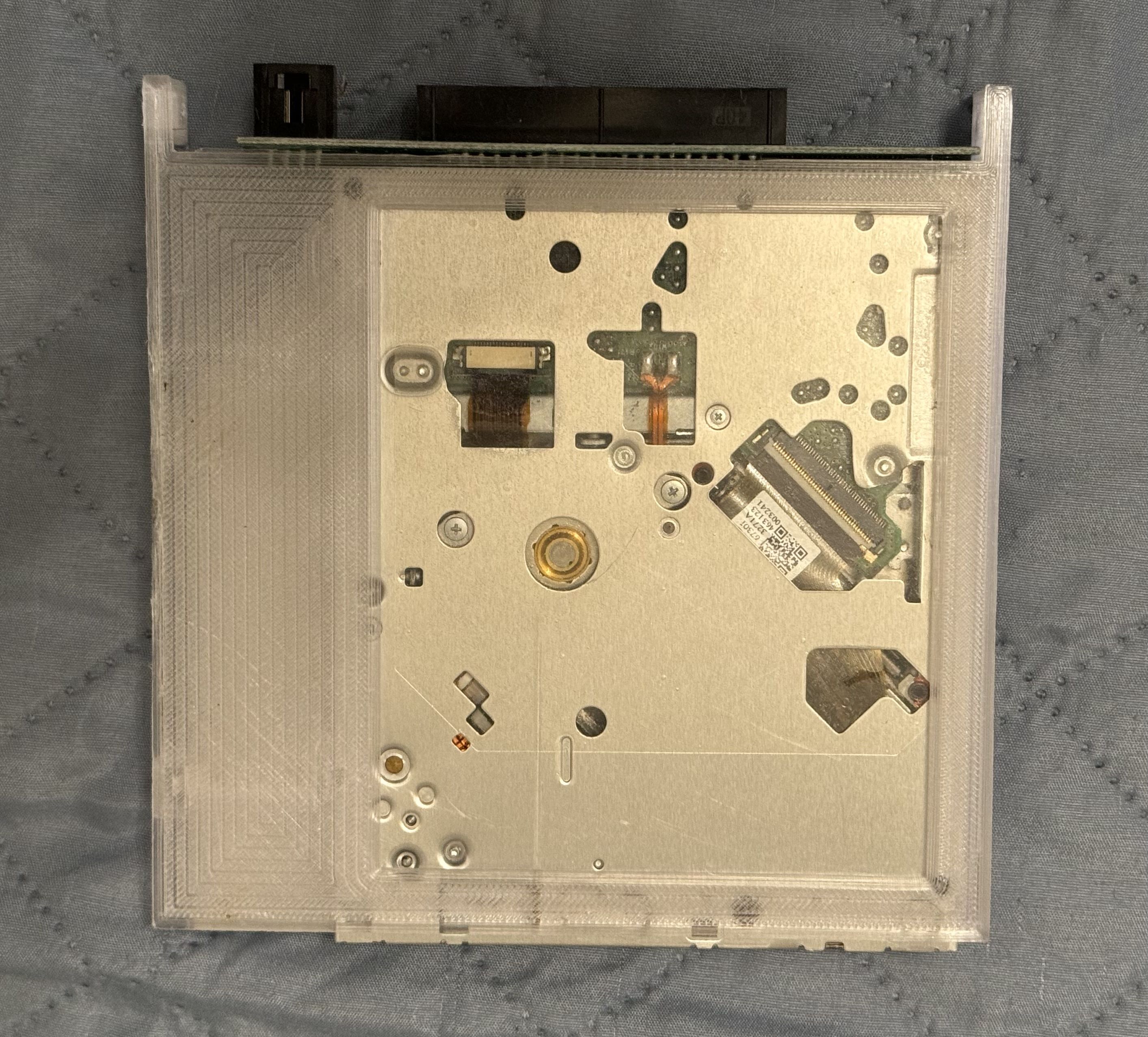

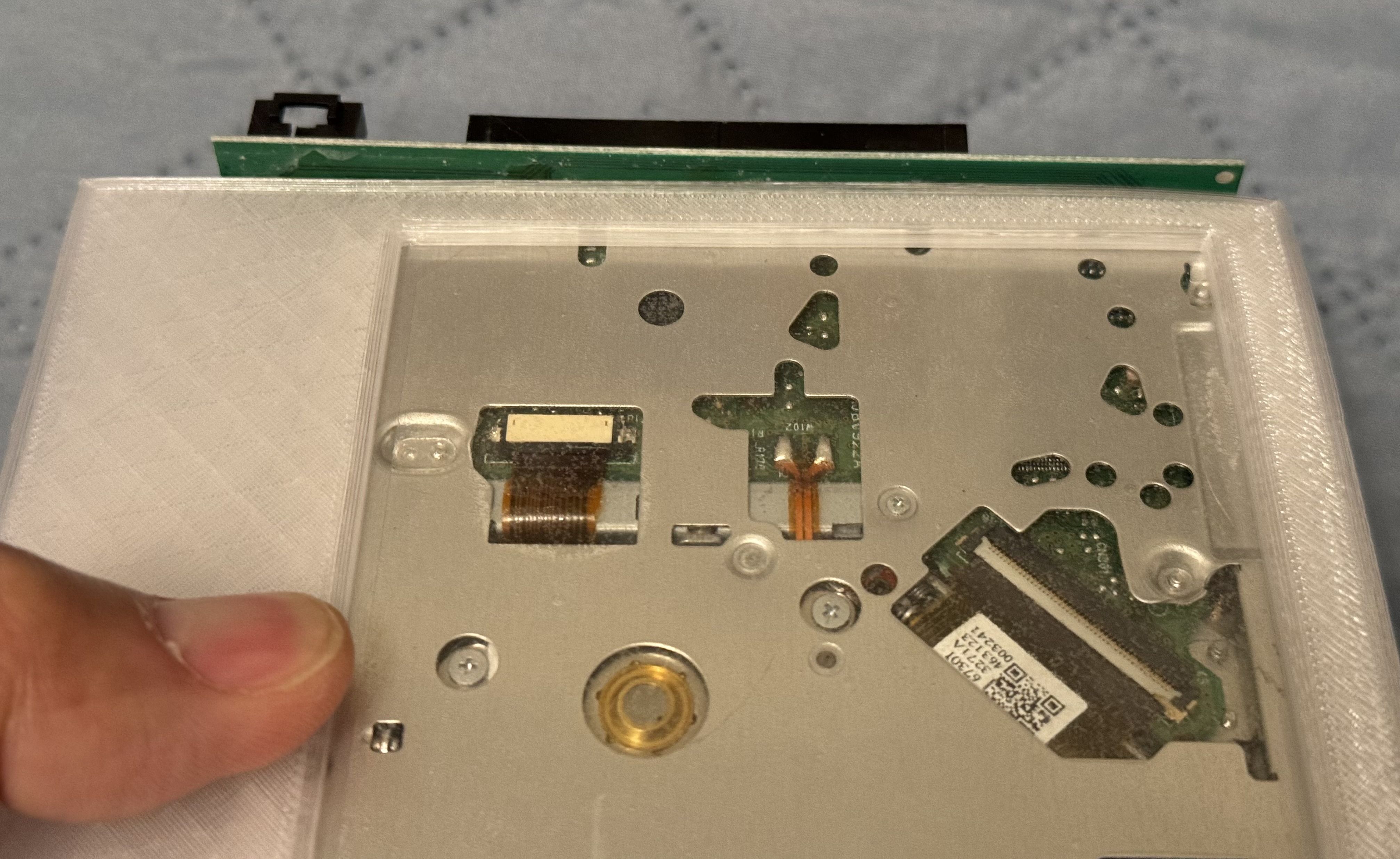

The reason I chose this one because this was the only one that I found that had the option to select the Master/Slave drive option via jumpers (more on this later). I also took a chance on this version since it was not a “slim” model and it stuck out more one one side. When I 3D printed the bracket, I soon discovered it would not fit with my choice the drive IDE adapter.
I went and remixed the model so it would fit the IDE adapter I chose.
In case anyone is interested in it, here are the links to the remixed model. Theoretically, this model should work fine with the slim versions of the IDE interface board too. If printing one, I recommend printing using either PETG or ABS. It can get quite warm inside the G4 Cube and PLA has a lower melting temperature and it is possible that it warp inside the computer.

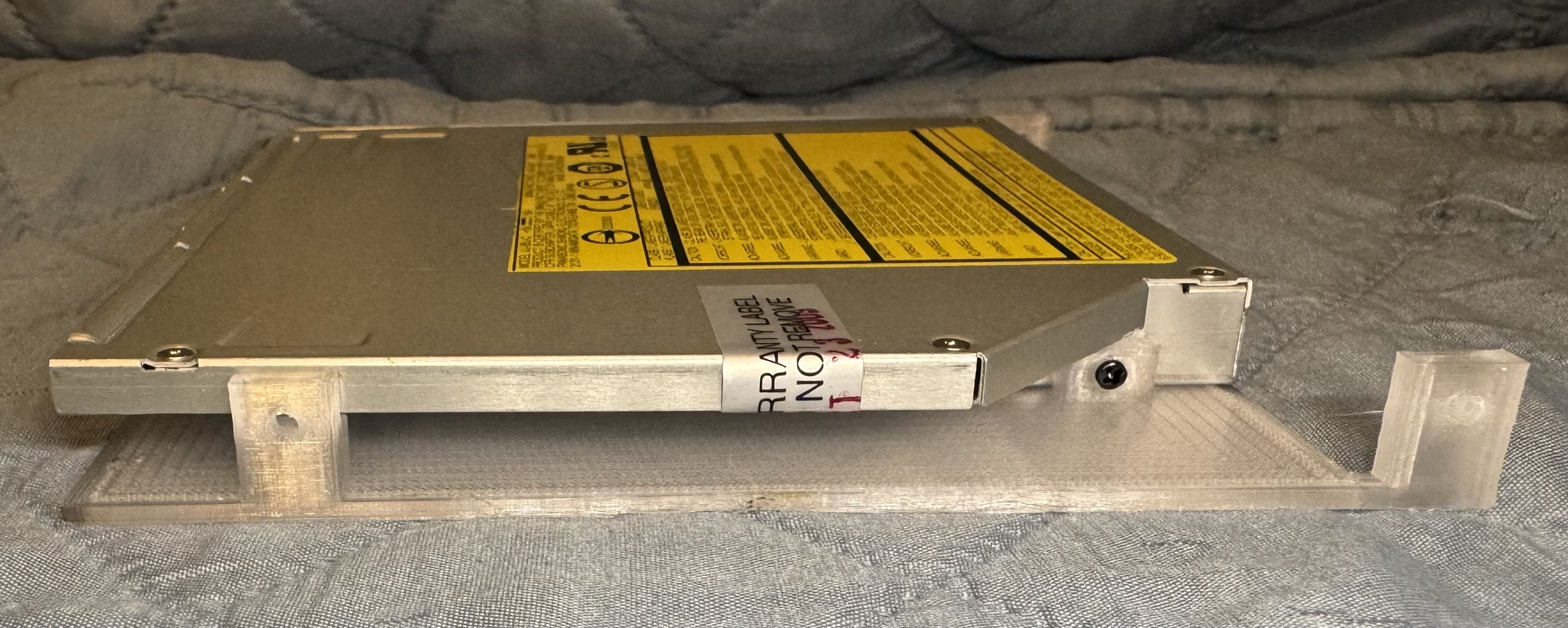

I realized that I did not have the right screws to affix the drive to the bracket. Since I do a lot of retro repair projects, I ordered a set off off Amazon. Here is the set I ordered:
https://a.co/d/4rGCYTI

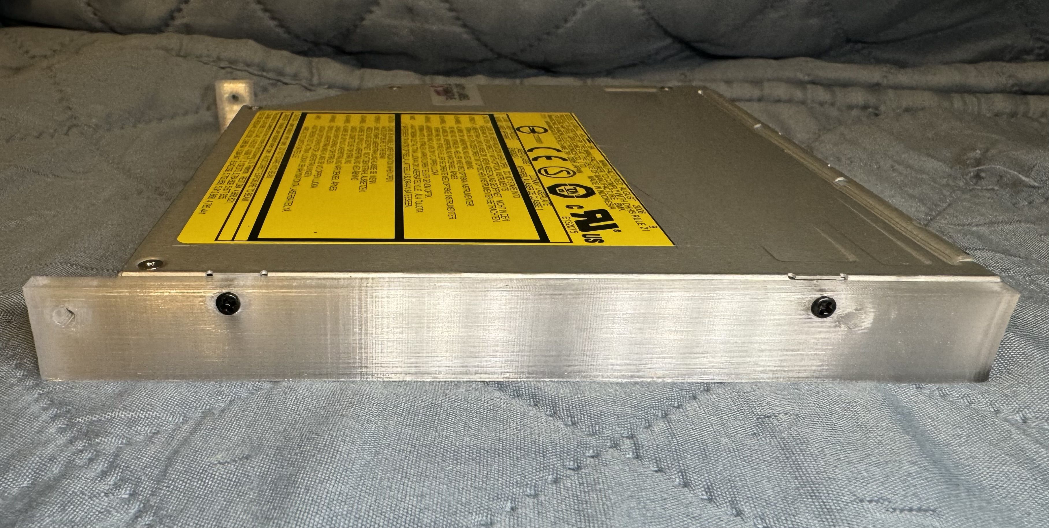

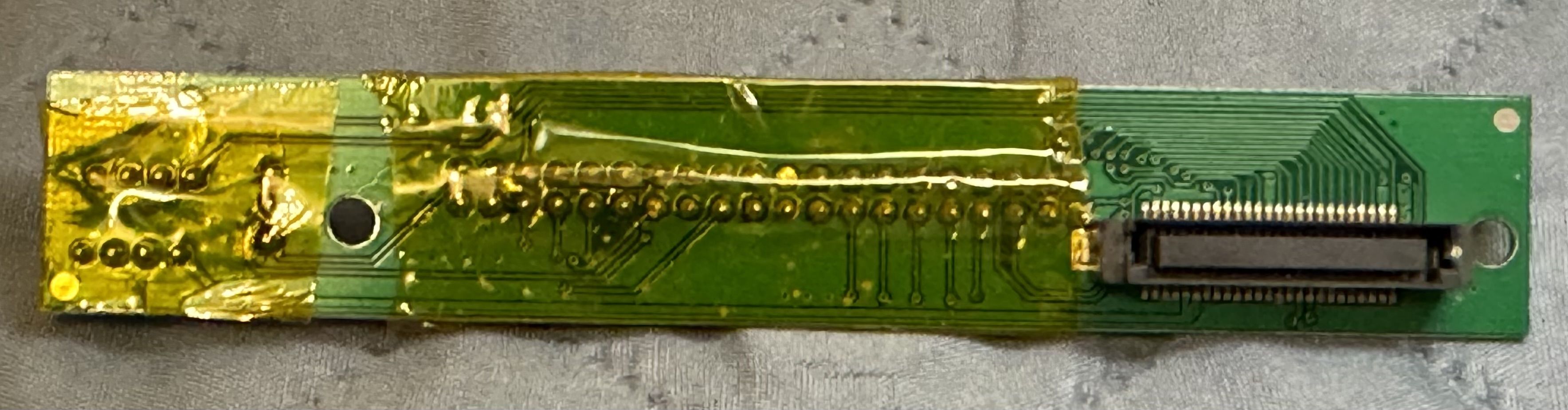

Here is the the drive screwed into bracket. I believe I used 2mm diameter laptop screws. The ones on the side were 4mm in length and 6mm in length to mount the IDE board.
As a precaution, I before I mounted the IDE board, I used kapton tape on the side with the leads to prevent any chance of an accidental short.
I needed some spacers for the IDE board, so I improvised them by cutting some PFTE tubing that I had from my parts bin for my 3D printer. This is how it looked when it was screwed in:

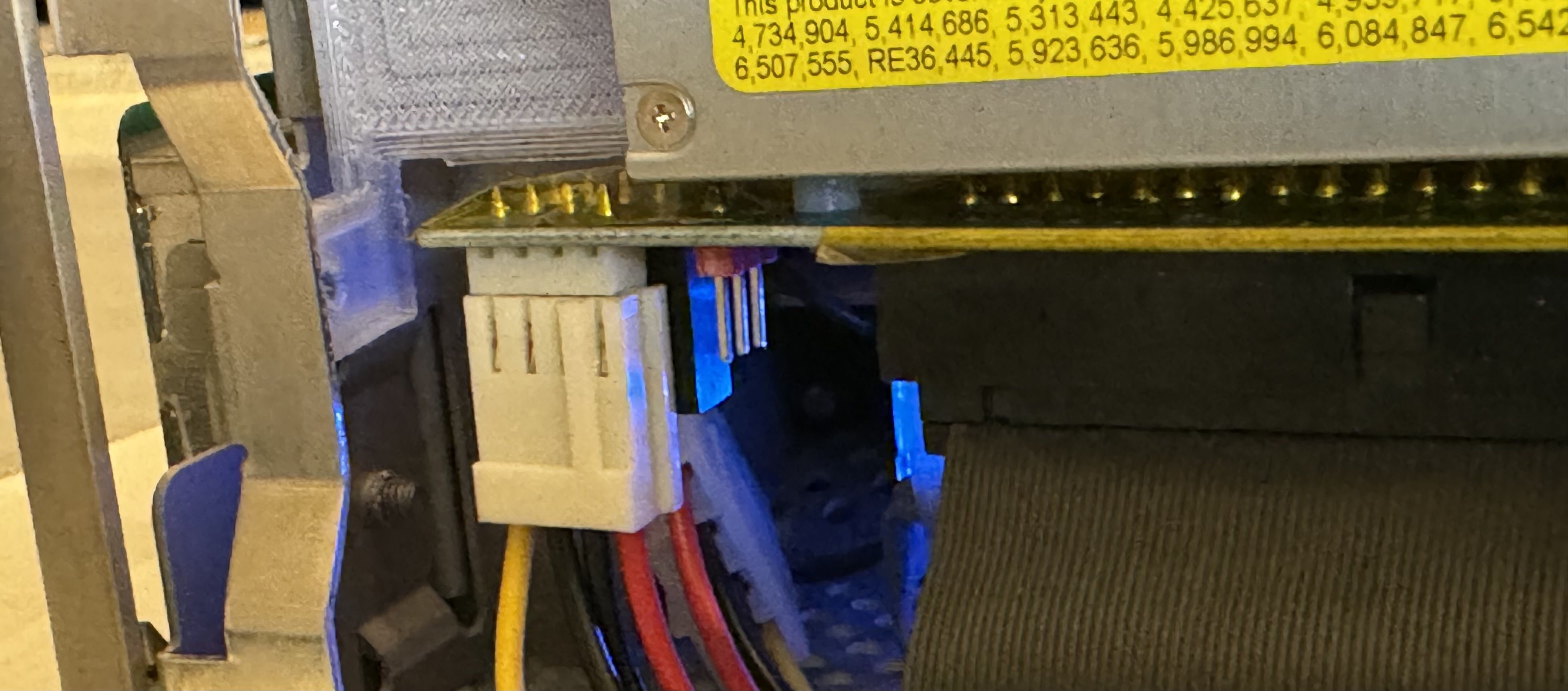

The IDE board uses a power connector that is similar to the old school floppy drives so I had to get an adapter cable to connect it to power. I ordered this part from Amazon. It was a little long, but it still worked. Here is the link to the one I used:
https://a.co/d/9OXdwLJ

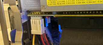

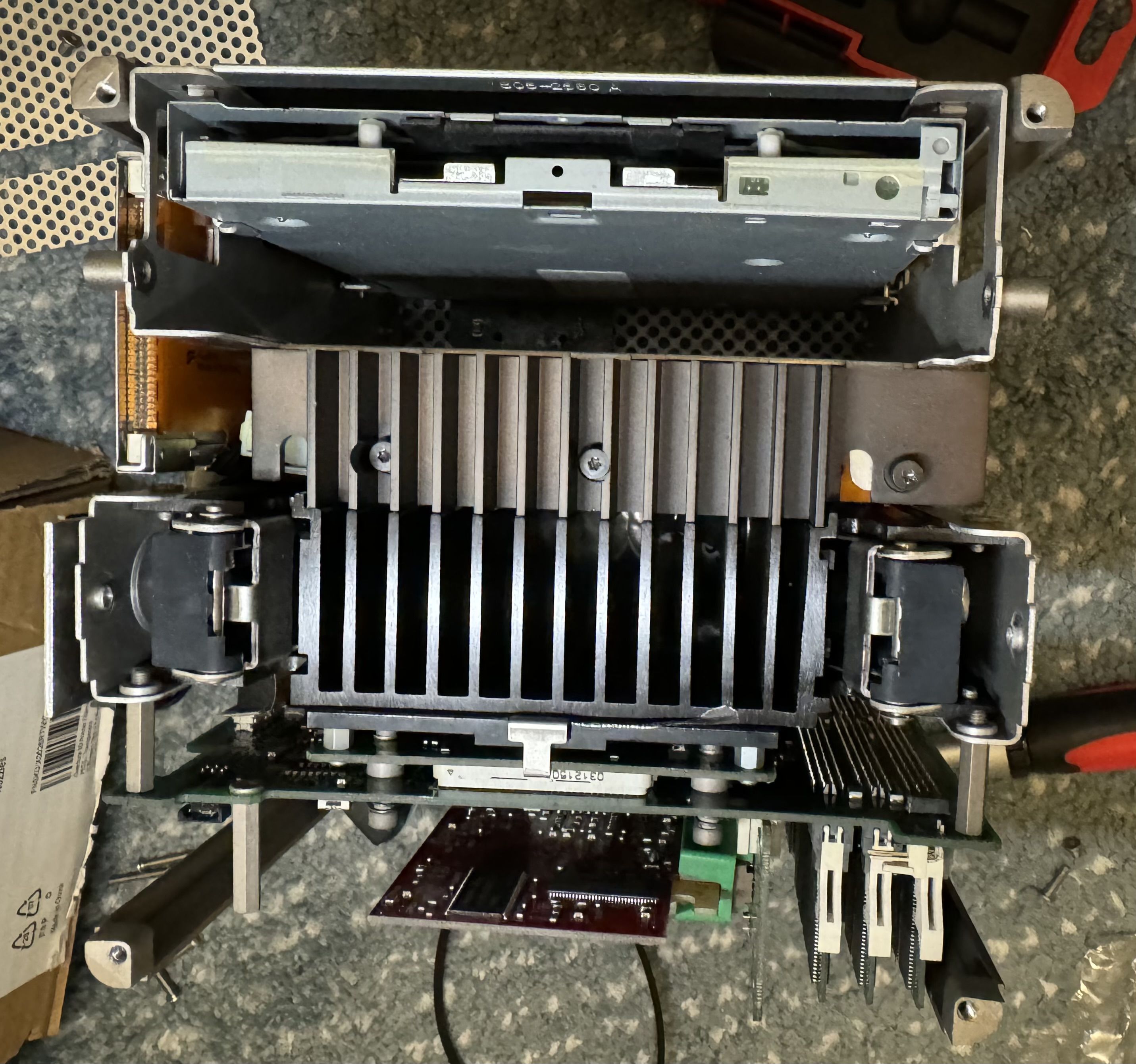

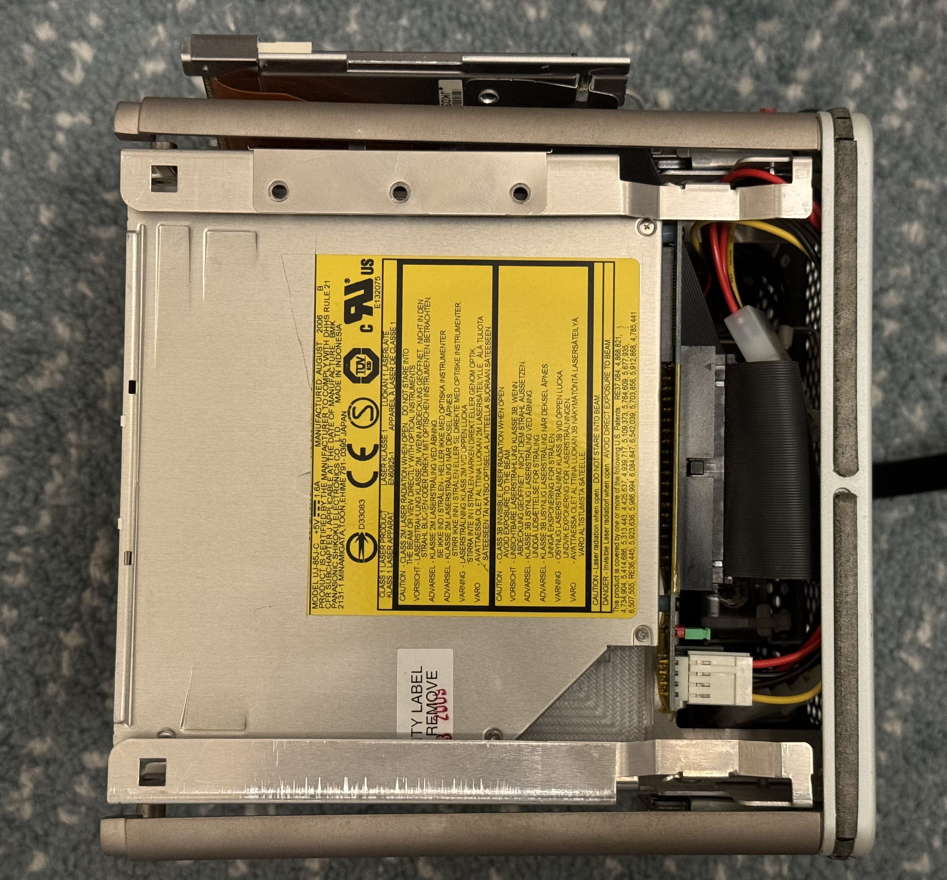

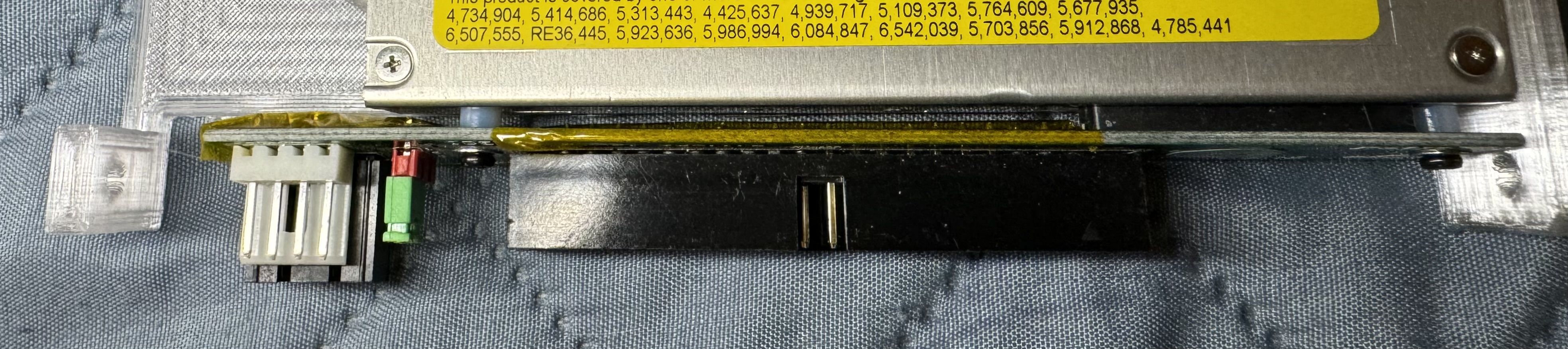

Next came to install The drive into into the computer. I have to give kudos to the original designer of the drive bracket. It fit like a glove in the G4 Cube. Here It is installed in my G4 Cube. I used the original screws from the old drive to install. I was concerned about width of the IDE board sticking out or not fitting because it was not slim, but I was relieved that it was not an issue and fit very well. Next to the power cable of the drive, is the the IDE jumper. It is the green jumper. I currently have it set to "slave".
So, next came the power on test. I power up the G4 Cube, and IT DID NOT BOOT!!! It just hung on a grey screen. So I thought a little bit. I recall that the G4 Cube IDE cable had one cables wires was cut (if you look at the cable, it looks like there is a "hole" in the cable.) I recall in the past that in some IDE setups, the drives are set to "cable select" in which the cable determines if the drive is slave or master. Remember the jumper in the beginning of this post? To test this, I went back to the jumper, and removed it.

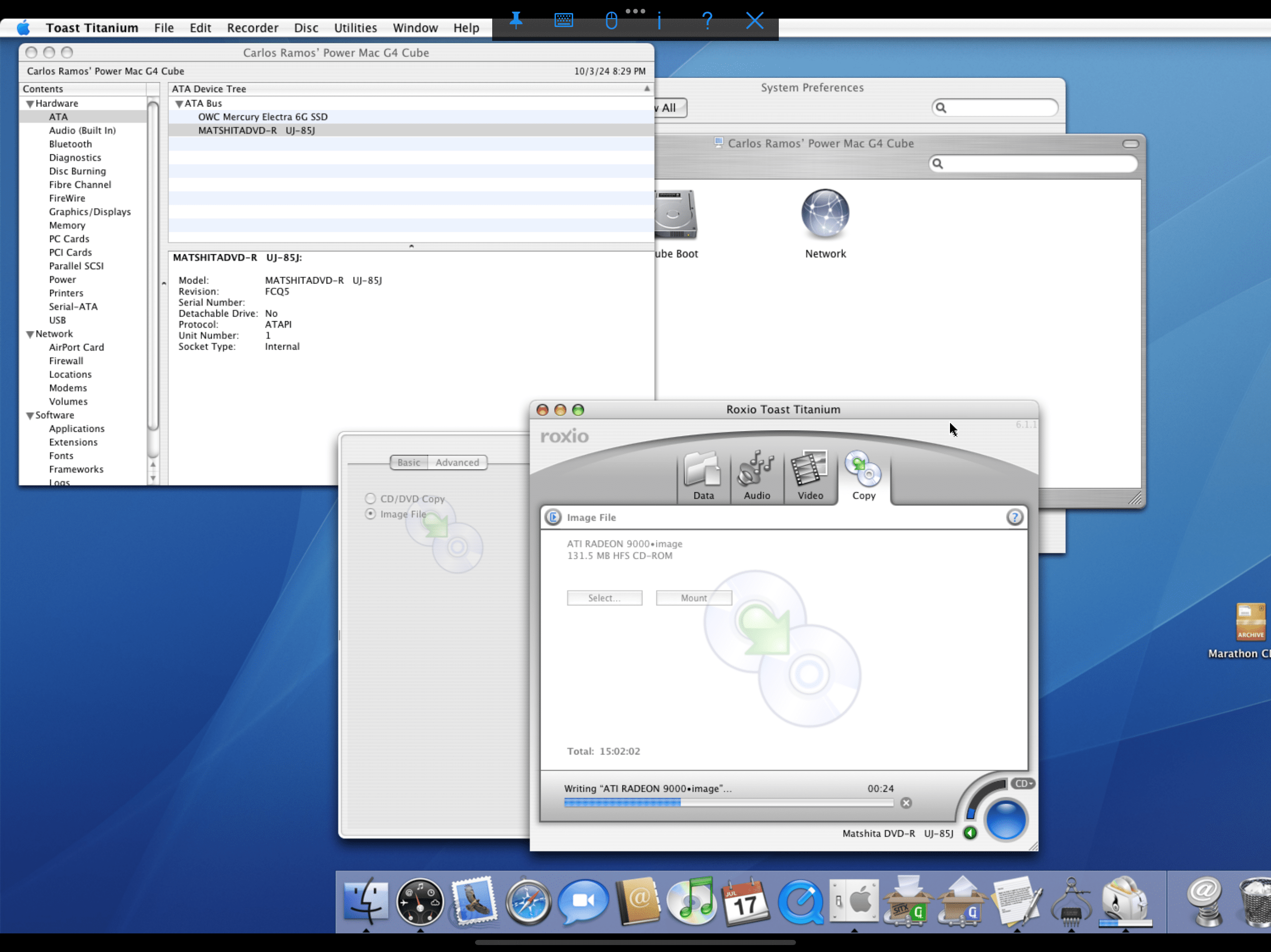

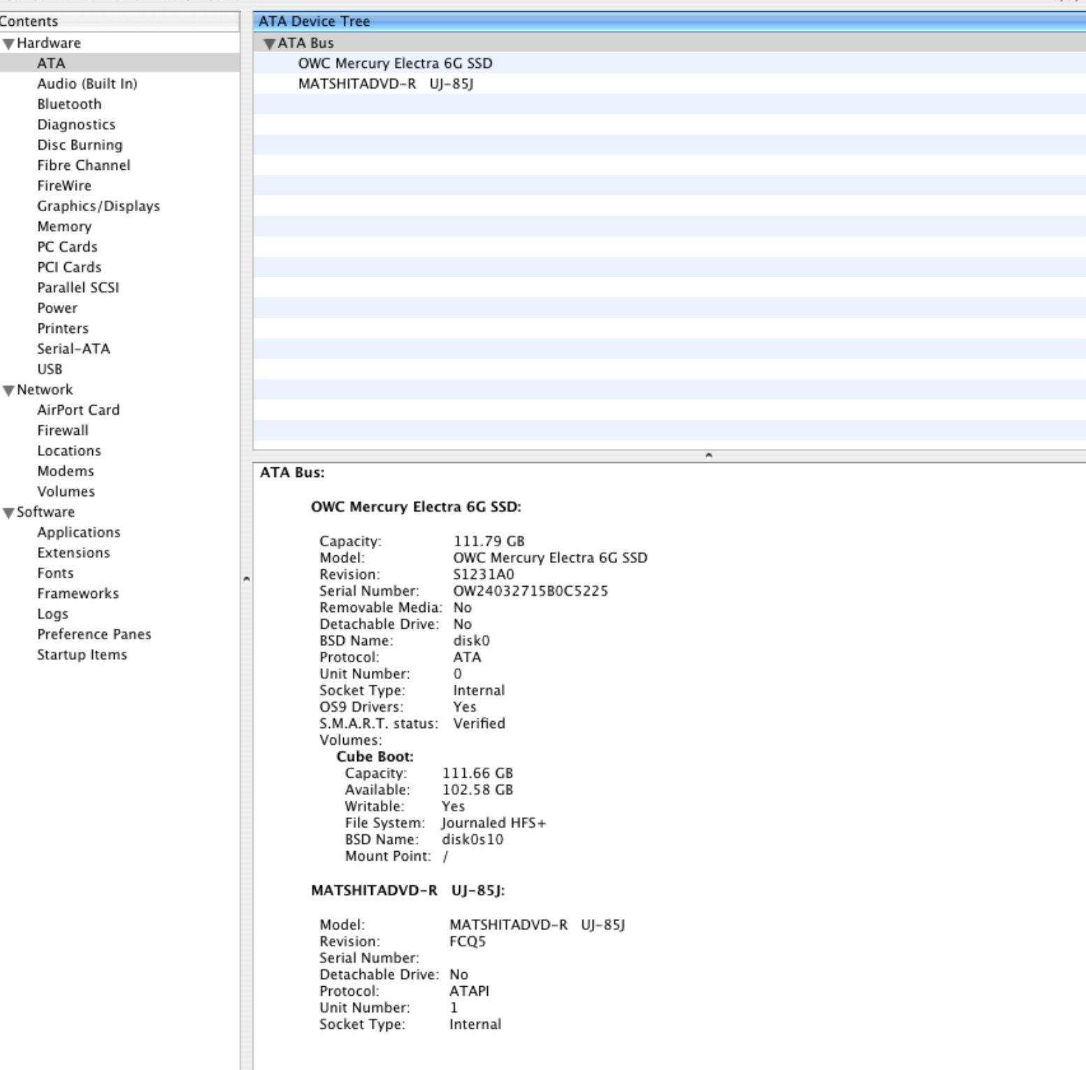

I powered up the computer and….. IT BOOTED RIGHT UP! I went into the system profiler, this what it showed up correctly with the correct ID number.

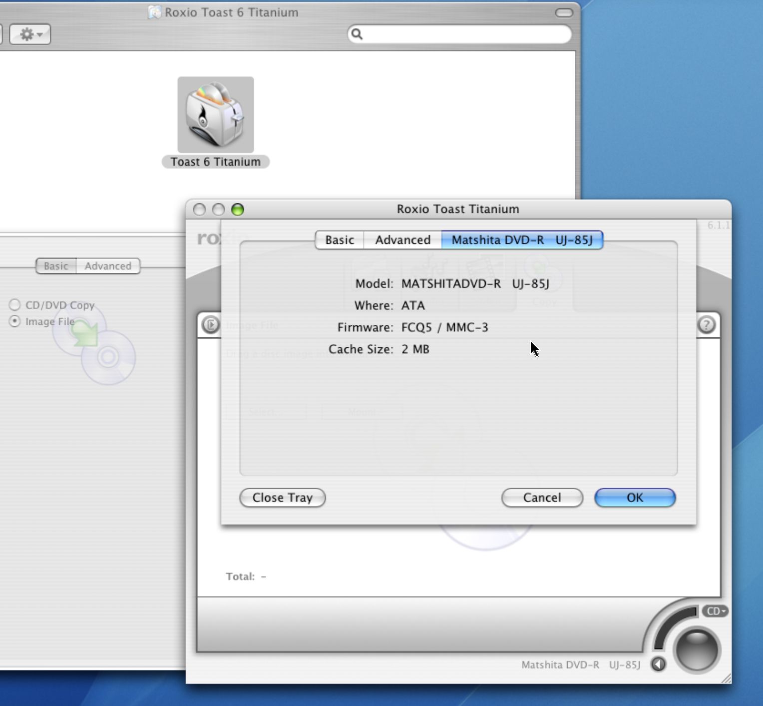

When inserting disks a couple of times, the drive needed a little effort for the discs to insert and take. But after a couple of times, it works now perfectly. It may be that the mechanism sat for a little bit. The drive now inserts and ejects the disks perfectly. I have been able to play DVD's and burn discs with out issue. I was able boot off of a CDROM/DVDROM without issue. Here is a screen shot of Toast recognizing the drive:

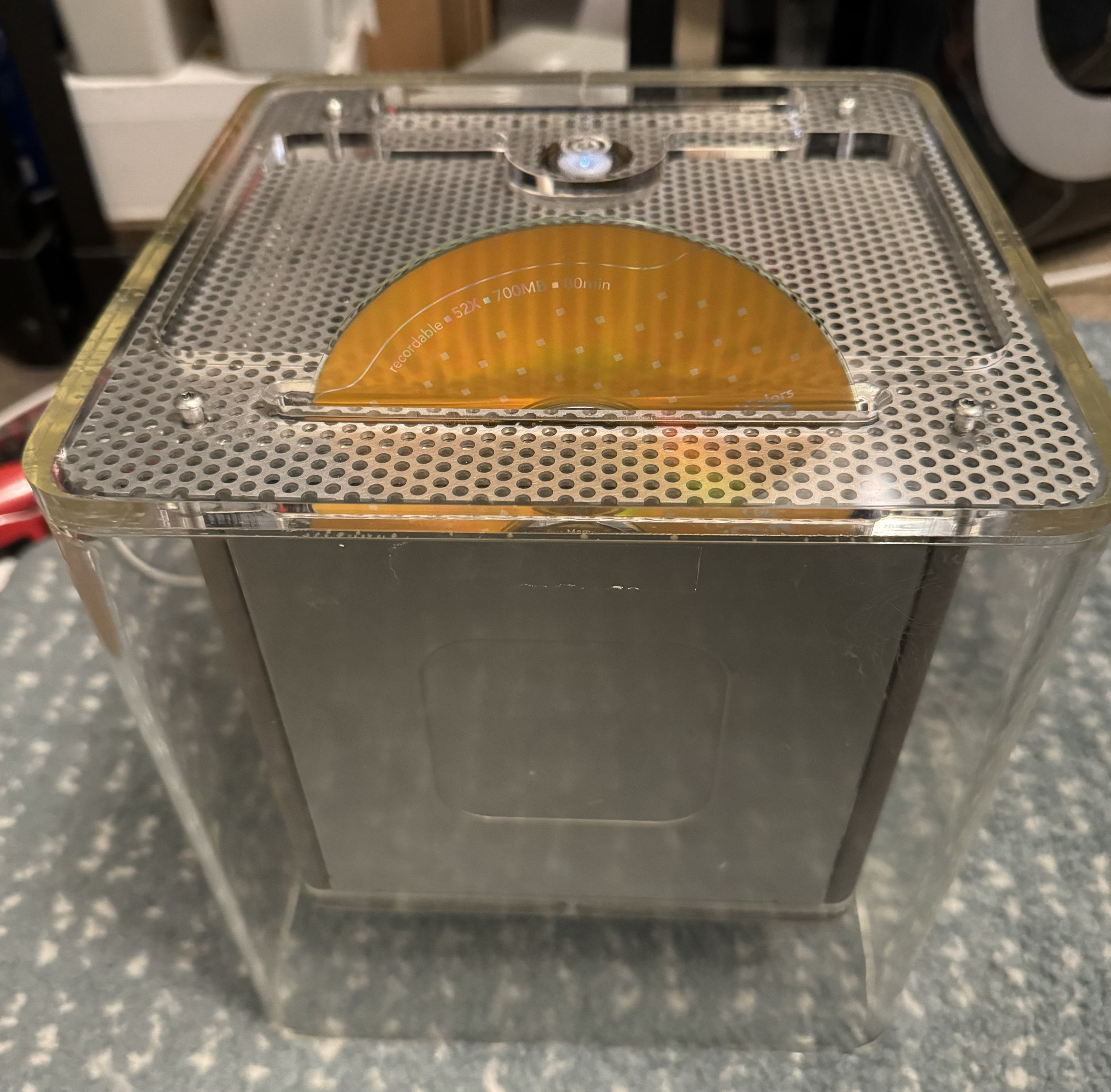

Here is my G4 Cube with it's replacement optical drive:

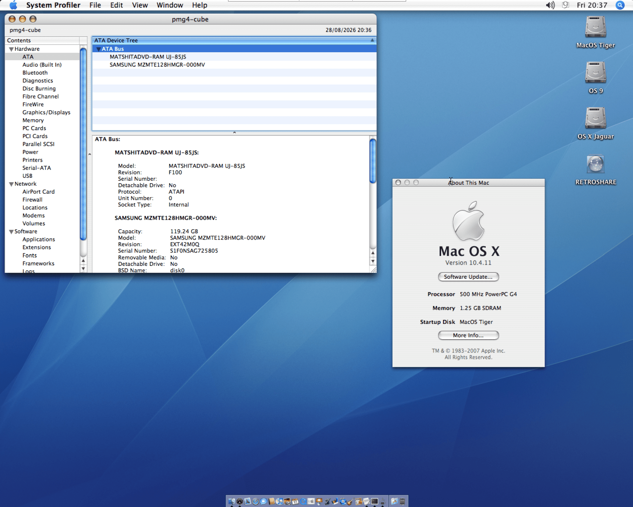

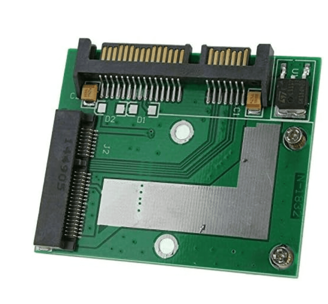

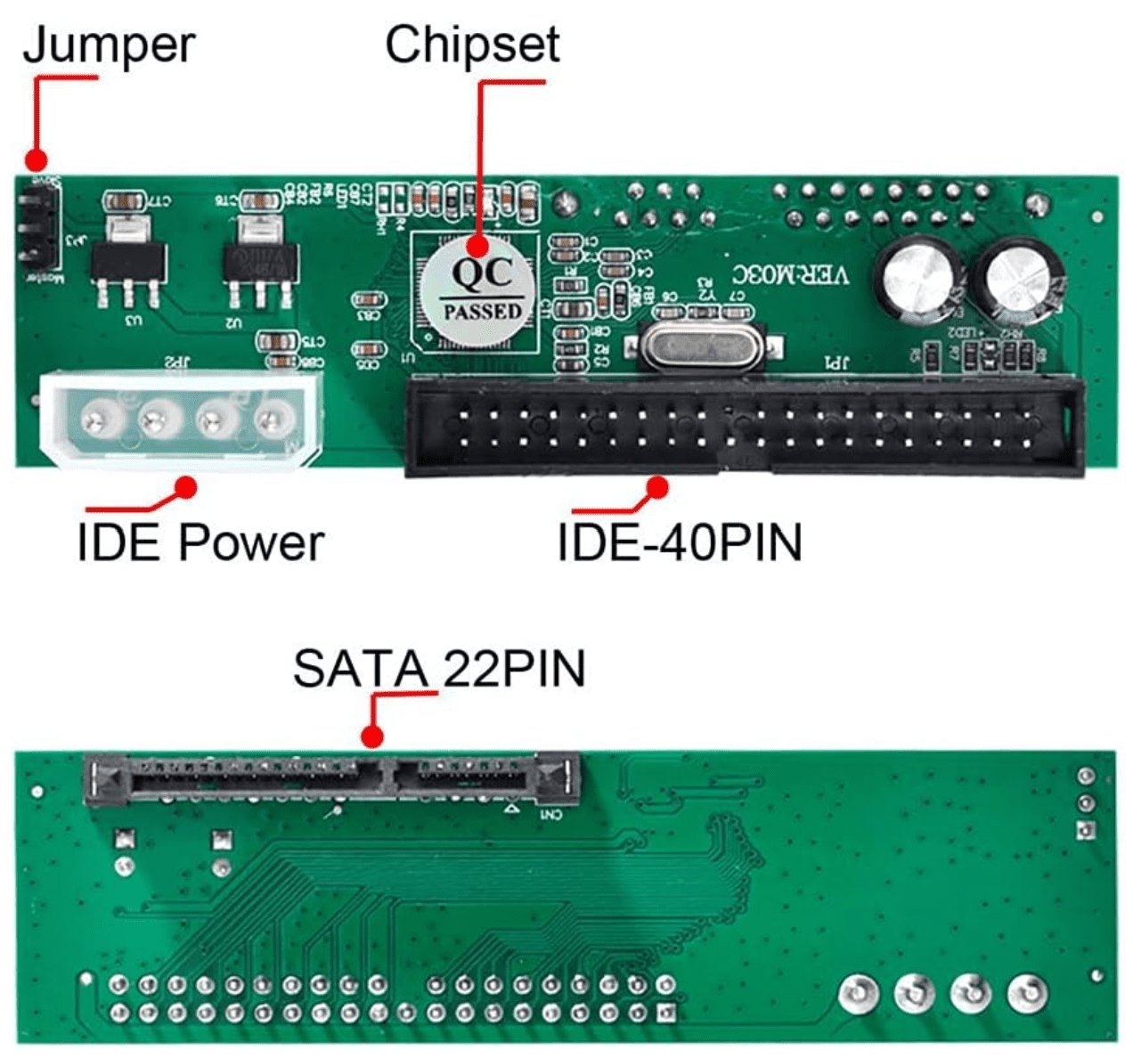

Hi, not to hijack a thread, I thought I would add my experience in case it helps anyone else - I had a load of bother retrofitting a particular drive and making it work with my SSD.
I started with a pre-existing setup of a dodgy SuperDrive and a Samsung MSATA 128GB SSD, plugged into a Startech IDE2SAT2. As soon as I introduced a Matshita UJ-85JS (seems like it came from an Acer) on a Supermicro SCD812, problems galore. I couldn't find my boot drives, no matter how much I fiddled with jumper settings. I even tried desoldering the cable select pin from the SCD812 and had no joy.
To skip to the combo that works for me, an Ablytech ATAPI-to-IDE adapter in Master, with this generic IDE-to-SATA adapter off Amazon in Slave. Works perfectly every time, survives sleep in OS9 and Tiger, and I now have a working DVD drive again.
Pics of the adapters attached (not mine - fair use applied) so folks have a visual reference of what I used...
As a point that may help some folks with thermal throttling, I added some thermal pads to the back side of the SSD to transfer heat to the mSATA-to-SSD adapter. Works well and worked fine (no throttling) when restoring a disk image (128gb) to the SSD.

Thanks for the post! It is good to hear from other people’s experiences with different gear. Especially when some parts used earlier may no longer be available and the SATA components may be easier to get.
