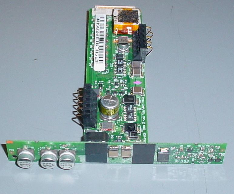

I still think the electrolytic capacitors that are on the PCB which sits between the two drive bays are too far away from the primary DC board that has the DC input jack on it (at the back of the machine). I therefore am highly skeptical if that would be "the magic fix" for this sudden power loss problem. Nevertheless, to avoid a situation where folks continue to point to finger at those caps, I will need to now buy the caps and see what happens.

I agree with recapping, even if it does not seem clear how it would fix the problem. Recapping has solved some odd malfunctions that were difficult to diagnose in some of my older Macs.
I am currently waiting for Mouser to get their act together regarding backordered items. The last backordered item won't arrive until Oct. 19th, so I will place my order then and hopefully nothing else will go out-of-stock before then.
But again, my gut tells me that recapping won't solve this problem because on that large physical distance of those caps from the main DC board at the back of the machine. Caps sit between the two drive bays to keep voltage levels from falling when drives in those bays suddenly power up (like the CD-ROM drive). The caps make sure the power to those drives remains stable. There are no electrolytic caps at the back of the machine where you connect your external power brick. Instead, that board uses tantalum and ceramic types, which have a solid electrolyte and do not need replacing.
So I am 90% sure a recap won't resolve the sudden power loss one of my PDQ machines has, nor will it likely fix the other PDQ which refuses to power on (even though a PMU reset does make the fan spin as it should).
So for the time being, let's pretend I've recapped the machines and still have the same issues. Would any of you have thoughts about the root cause in that case?

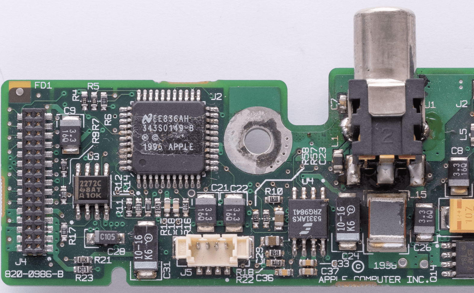

If not done already, I would evaluate for barrel plug PCB failure by exchanging the barrel plug PCB's between the two PDQ's:
- If the booting behavior follows the exchange (i.e. the non-booting PDQ now boots and the booting PDQ now doesn't boot), then the problem is the barrel plug PCB of the non-booting PDQ.
- Unlikely, but if the booting behavior AND the sudden shutdown issue follow the exchange, then there is a problem with both barrel plug PCB's.
What brought this to mind was a non-booting Lombard I obtained last month that turned out simply to have a bad barrel plug PCB.
Schematics would help, but a problem that fixes itself as you described sounds like a bad cap. Is this the board in question:
I think that board generates the different voltages used by the machine from the main battery and/or the power brick. If you carefully probe the caps on this board with the power brick attached, you should find constant 24v from the brick as well as 5v trickle/standby that goes to the cuda/PMU. If moving this board from the now-working machine fixes the still-dead one, that could help narrow the search.
Is there a 10v 100uF electrolytic next to the cuda/PMU chip? Is this near where the clock battery plugs in?

I did more voltage measurements today.
When the "semi-good" PDQ refuses to power-ON, I can still press the keyboard keys & PWR key to do a PMU reset, and as long as I hold down those keys, the fan runs at full blast. The fan is so loud it's impossible to hear the hard drive, but I confirmed today that the hard drive powers up while the fan is spinning full blast. Under that condition, I measured the following voltages (all rock solid stable while the fan is running full blast with keys pressed):
  • C31 (to the left of connector J5) on main DC board at back with the power plug: 4.99V
  • C3 on Modem: 5.05V
  • Various capacitors on the CPU card: 2.0V or 3.3V, depending on which capacitor
  • Capacitors on the RAM module attached to top of CPU card: 3.3V
But as soon as I release those keyboard keys, all power gets cut and the above voltages all drop to zero, and the HDD and fan spin down. Pressing the power button soon after that does nothing, and voltages do not rise even for an instant. Usually, if I wait 24 hours and then press the power key (with the AC Adapter connected to the wall and PDQ), then it will power ON, but for whatever reason, it refused to power on today after that waiting period.
