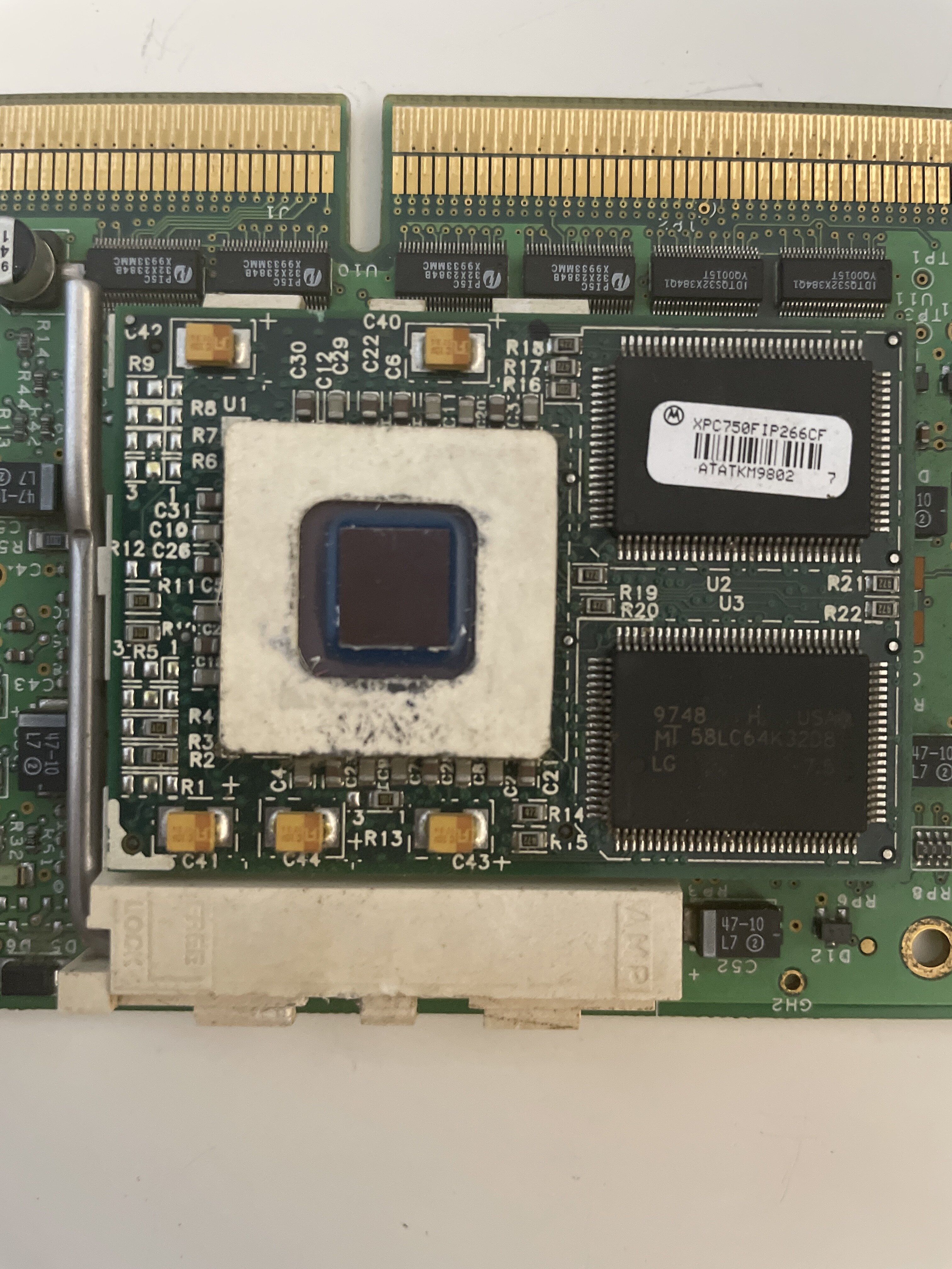

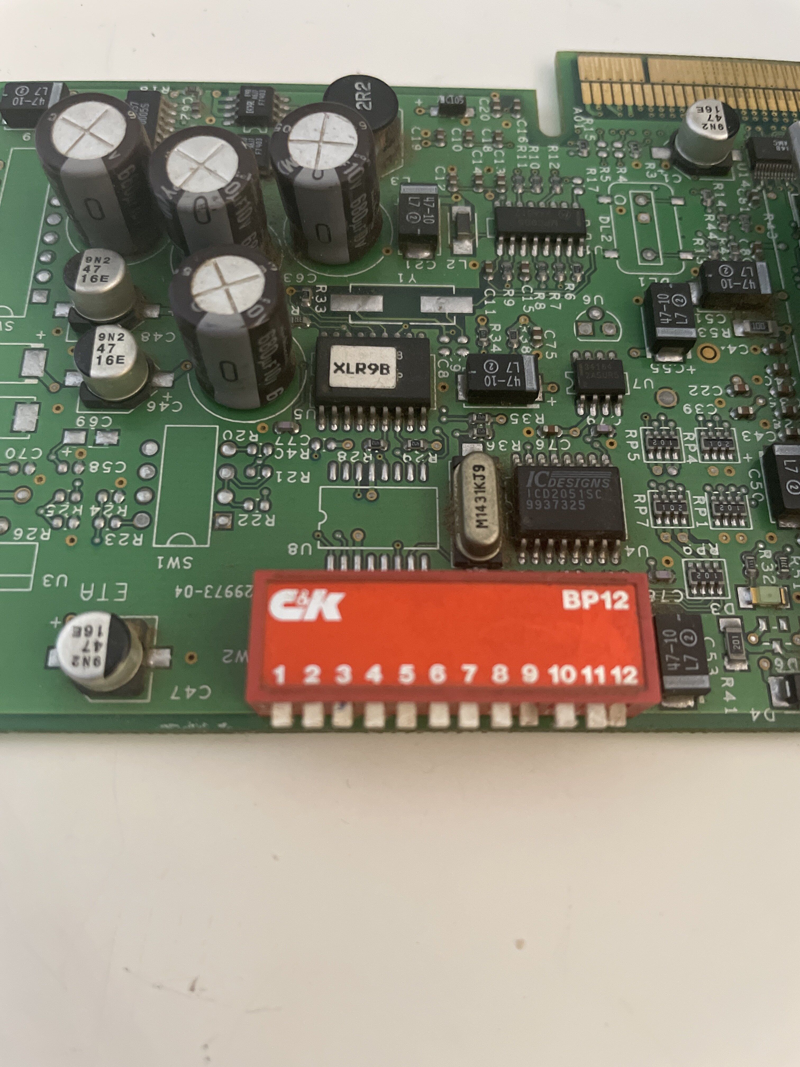

Hi all
I have a power computing 180c which has a XLR8 Mach Speed card in it with a 266mhz ZIF installed in it. For the life of me I can’t get it to boot and think it’s the jumpers which the previous owner may have changed. Can anyone lead me to a solution?

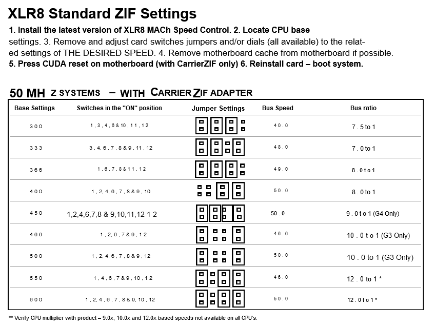

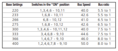

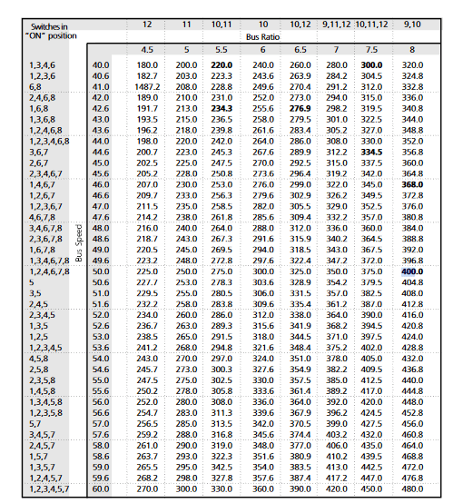

A bit late seeing this... but here are the 'base' settings...
I've also attached the full manual.
If you're trying those settings, it may be a problem with the cache. You might try disabling it in the MAChSpeed control panel - but then you need to fully boot to do so. I "think" the cache is only enabled when the XLR8 Extension is loaded, so booting with Extensions Off may make it possible to open the Control Panel and disable the cache.
