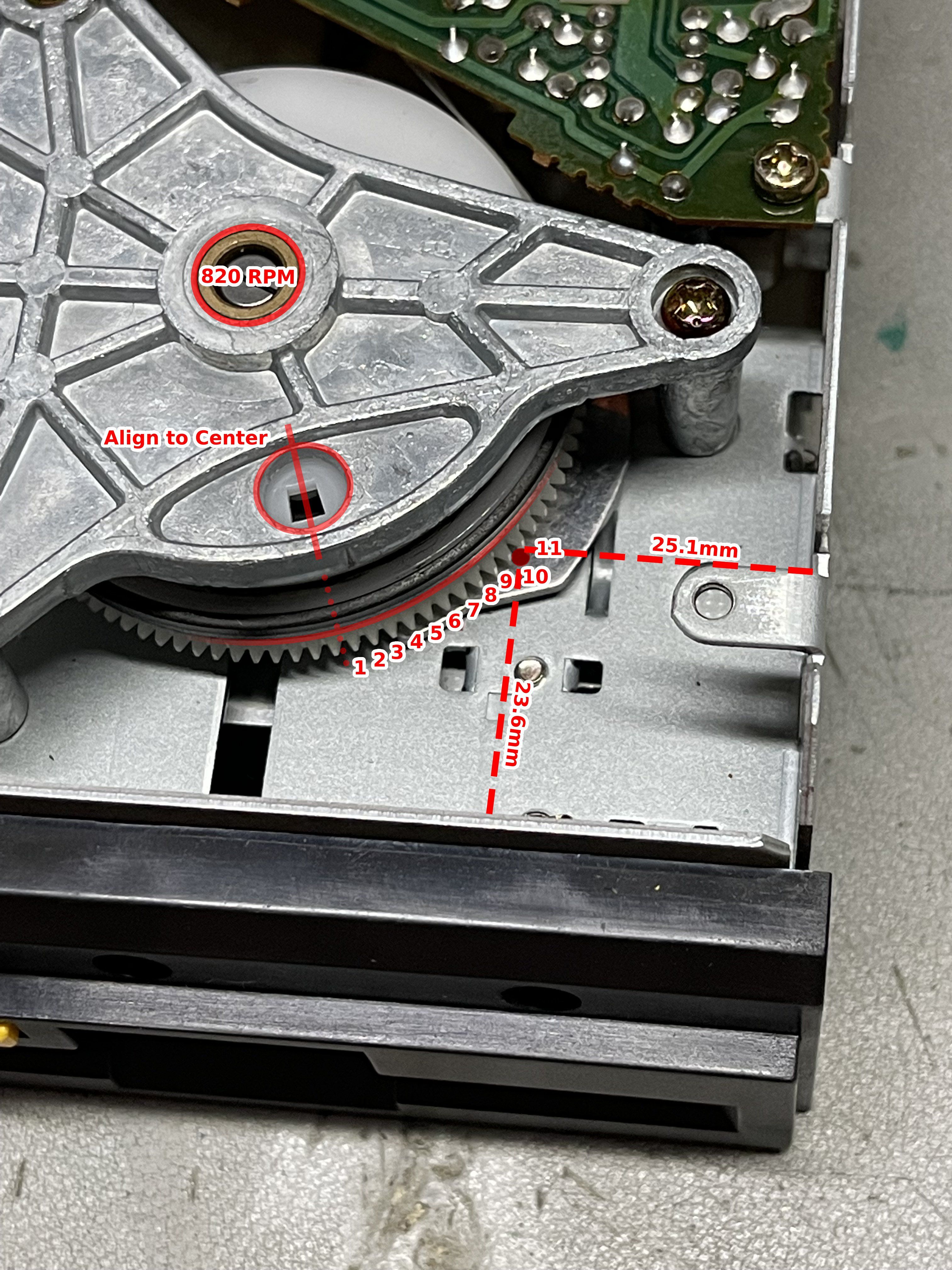

Motor RPM​
You can adjust your motor speed. Using my iPhone and a strobe light tachometer app like StrobeLight I measured functional speeds of:​
  1. 820 RPM at the spindle
  2. 1170 RPM on the motor
Gear Alignment​
Ensure the circular hole in the metal flange is:​
  1. Approx. 25.1mm from the right edge of the enclosure on the x axis
  2. Approx. 23.6mm from the bottom edge of the enclosure on y axis
  3. in the 8/9 tooth or 9/10 tooth position.

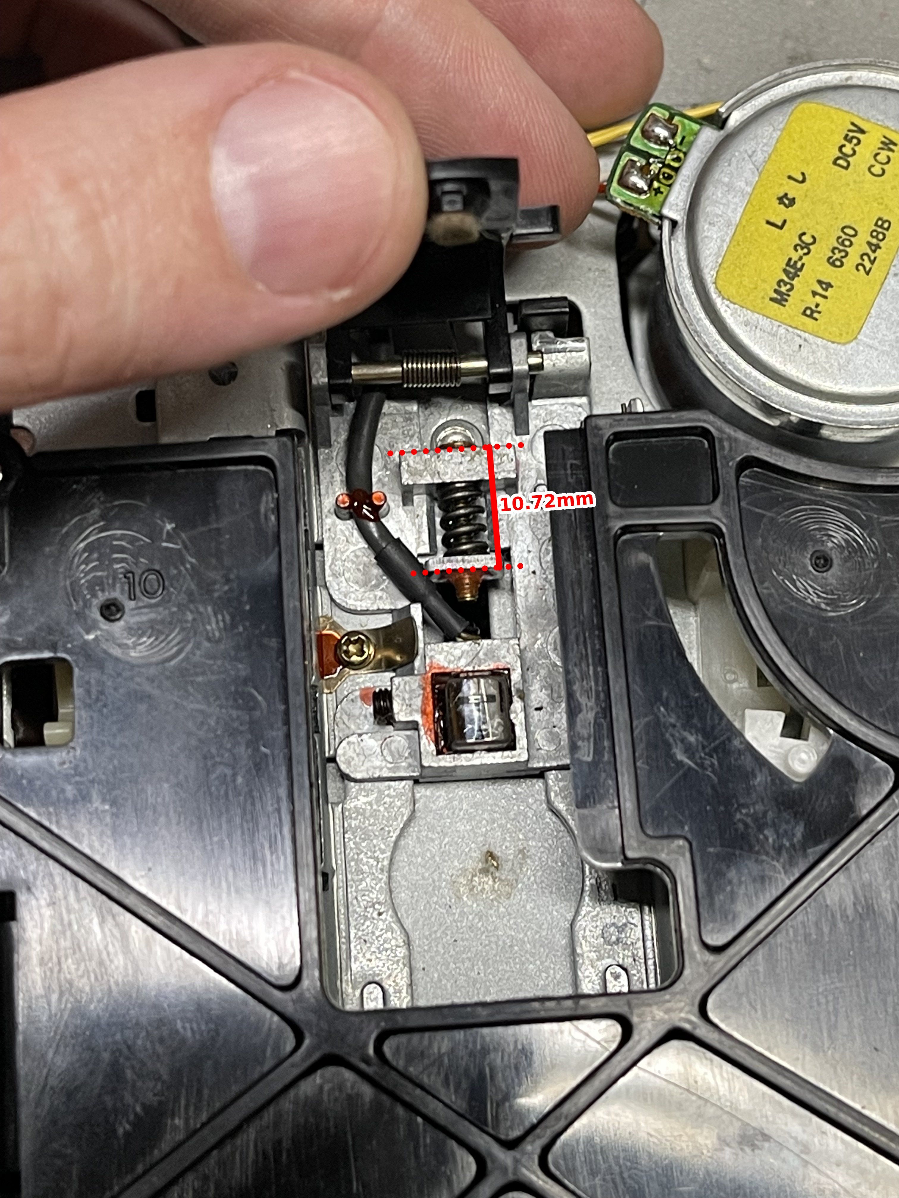

Head Alignment​
Ensure the head is aligned to 10.72mm. You have approximately +/- 0.05mm of wiggle room here so be precise.​

#2 Read head Spacing reference

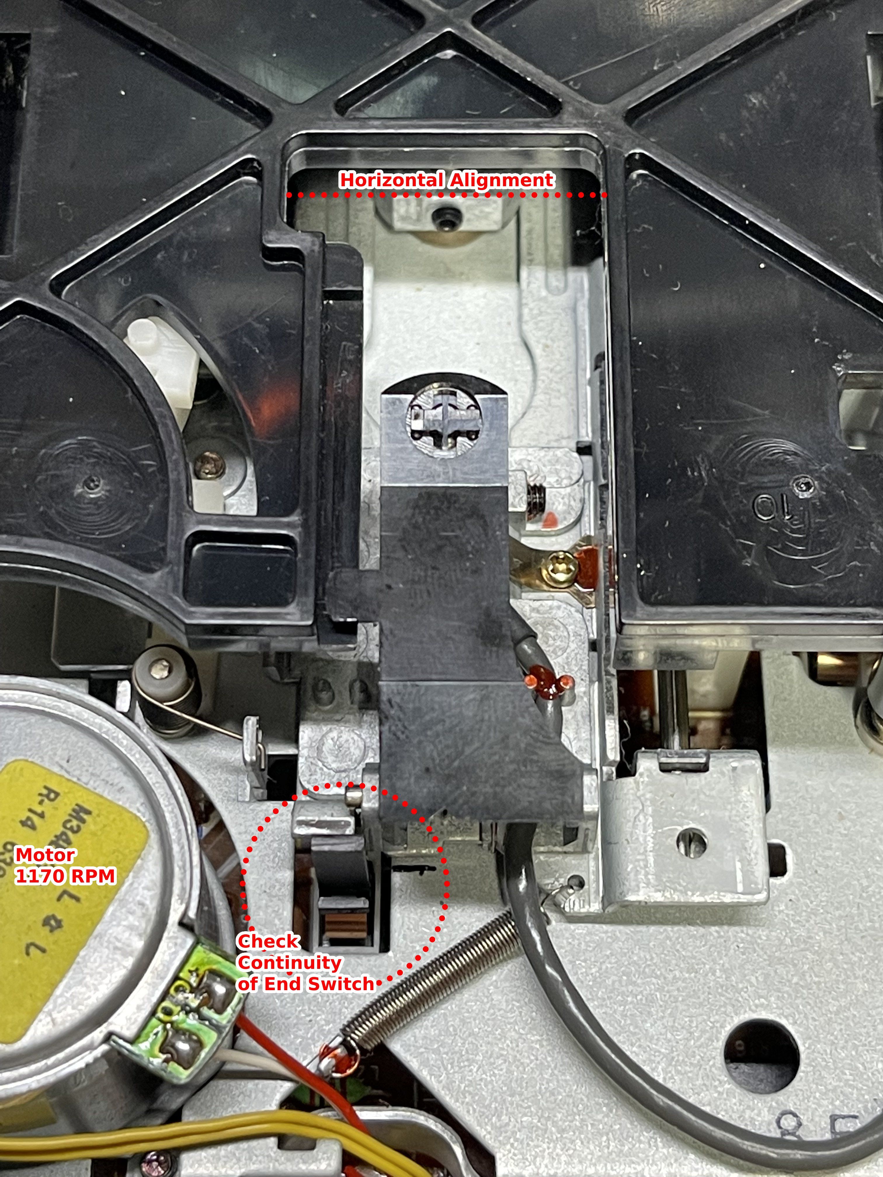

#3 Spindle & End Stop alignment reference
It's not visible in this image, but my end stop (the black line, which represents the end of travel for the read head sled) measured 2.68mm from the gap immediately above it, not visible in this photo.
Persistent Errors
If you continue to experience errors (e.g., Error 21) then I would recommend focusing on the head alignment if you are 100% confident that your gear alignment is consistent with my specs.
  1. Adjust the read head spacing by 1/8th turns (~0.05mm of travel) in a consistent direction (e.g., ccw) until you start to get error 22.
  2. Then proceed in the opposite direction.
  3. You will return Error 21. Continue in the opposite direction of step #1
  4. You should either enter into Error 22 or resolve the read issue.
  5. If you return Error 22 while traveling in the opposite direction of step #1 then you must revisit your head calibration.
  6. If you're 100% confident that your gear alignment is accurate then you should visit your RPM and ensure it's accurate.
