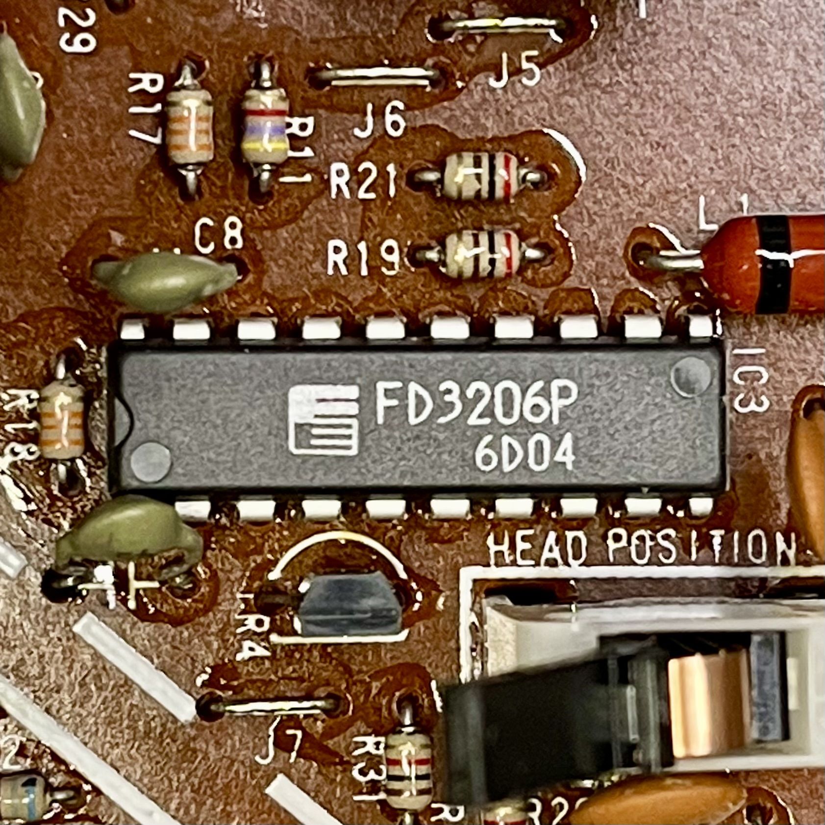

As this piracy started to eat more and more of Nintendo's "pie" they tasked their drive manufacturer Mitsumi to provide some sort of qualified write protection for disks through the creation of the FD3206 disk controller chip. In addition to the changes made by Mitsumi to the disk drive itself, Nintendo also devised a means of blocking data outside of specific ranges through the incoming data port (before the data made it to the disk drive).

Okay, so we already learned about the FD3206 — a chip inside the disk drive which controls read / write. And we know Nintendo made modifications to the intermediary external to internal data connections.

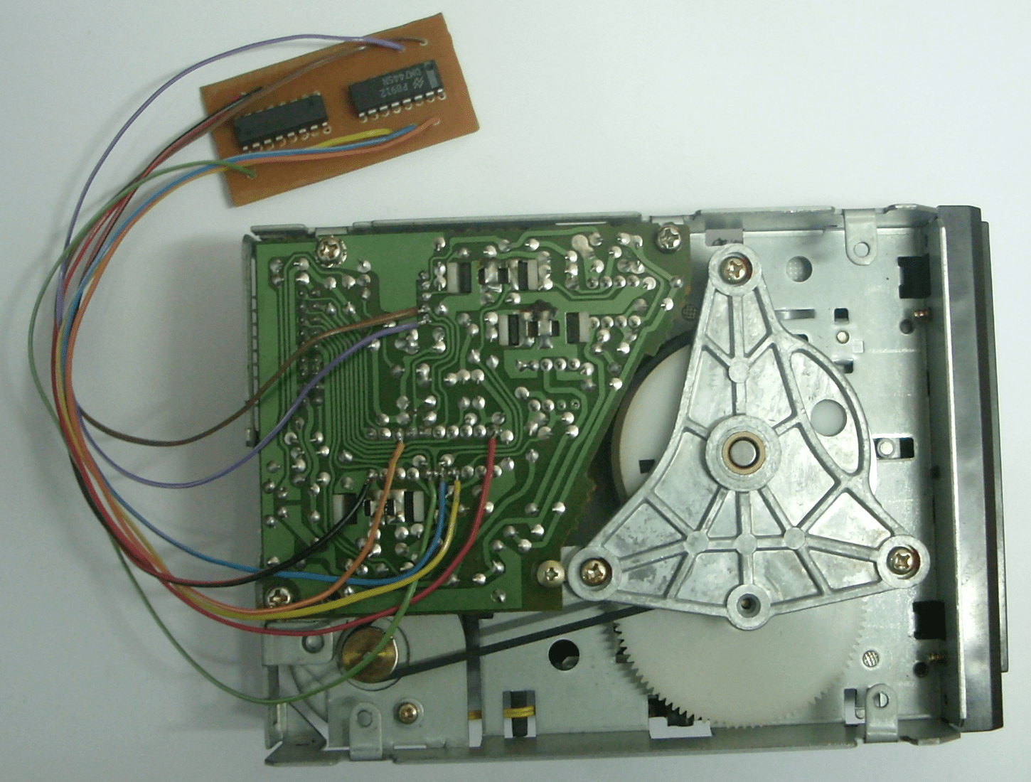

For probably more than a decade there has been an open source circuit available which allow users to bypass the FD3206 disk controller limitations. I believe this was designed by Brad Taylor, but I encourage corrections if I mistaken!
There has also been excellent bypass mods available to purchase from Tototek (link). The most recent including this brilliant "no wire" modification:

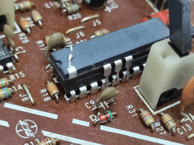

If you're only here for the chips and dip then this is probably the section you're most interested in. Thanks to the generous contributions of knowledge by members of the broader community @LIV2 (twitter) and @Zane Kaminski, I am pleased to present an open source alternative (GitHub).
I'm calling it the FD3206 No-Wire Open Source FDS Mod (rolls off the tongue, right?). It's an ATF16V8 GAL PLD with pins cut off to make soldering dead simple.
How to Make It Yourself
Making one of these for yourself is somewhat straightforward with a few big caveats. First, you're going to need a chip programmer that supports ATF16V8. If you have the ever-popular TL866 series of programmers then you have already overcome a big hurdle.
I am preparing an instructables article which describes the generic ATF16V8A programming process. This will be a very handy reference for this mod once the article is completed.
