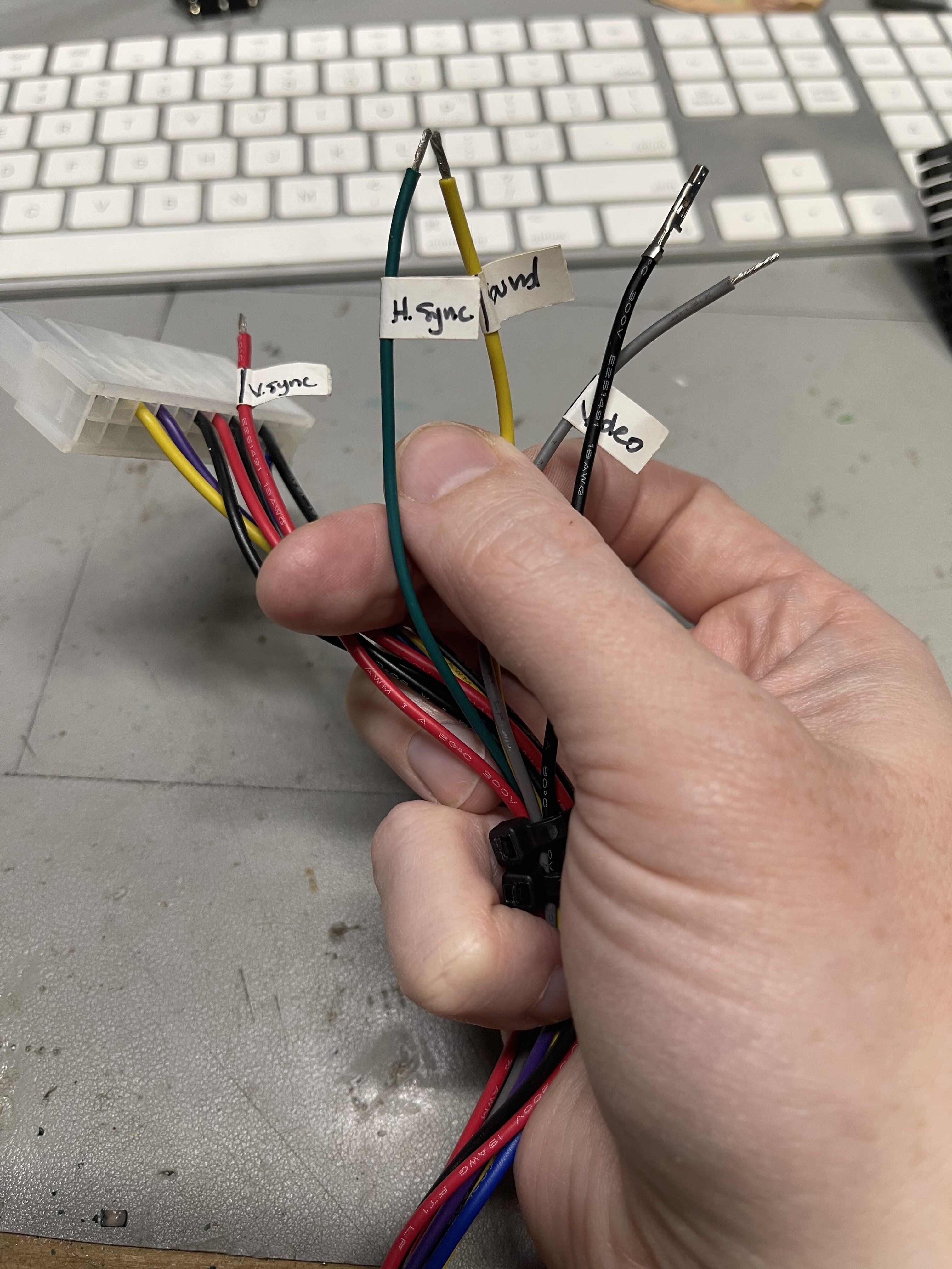

I do a little bit of work on compact mac logic boards and found I needed a convenient way to power them up and get video without fussing with a case, so I made this adapter which allows me to use an ATX power supply and an RGBtoHDMI.

When it comes to parts, I only needed the following:
Of course, if you don't own a compact mac or ATX power supply none of this is helpful. The RGBtoHDMI is a big help, but you could also use something whacky like a Power R adapter.

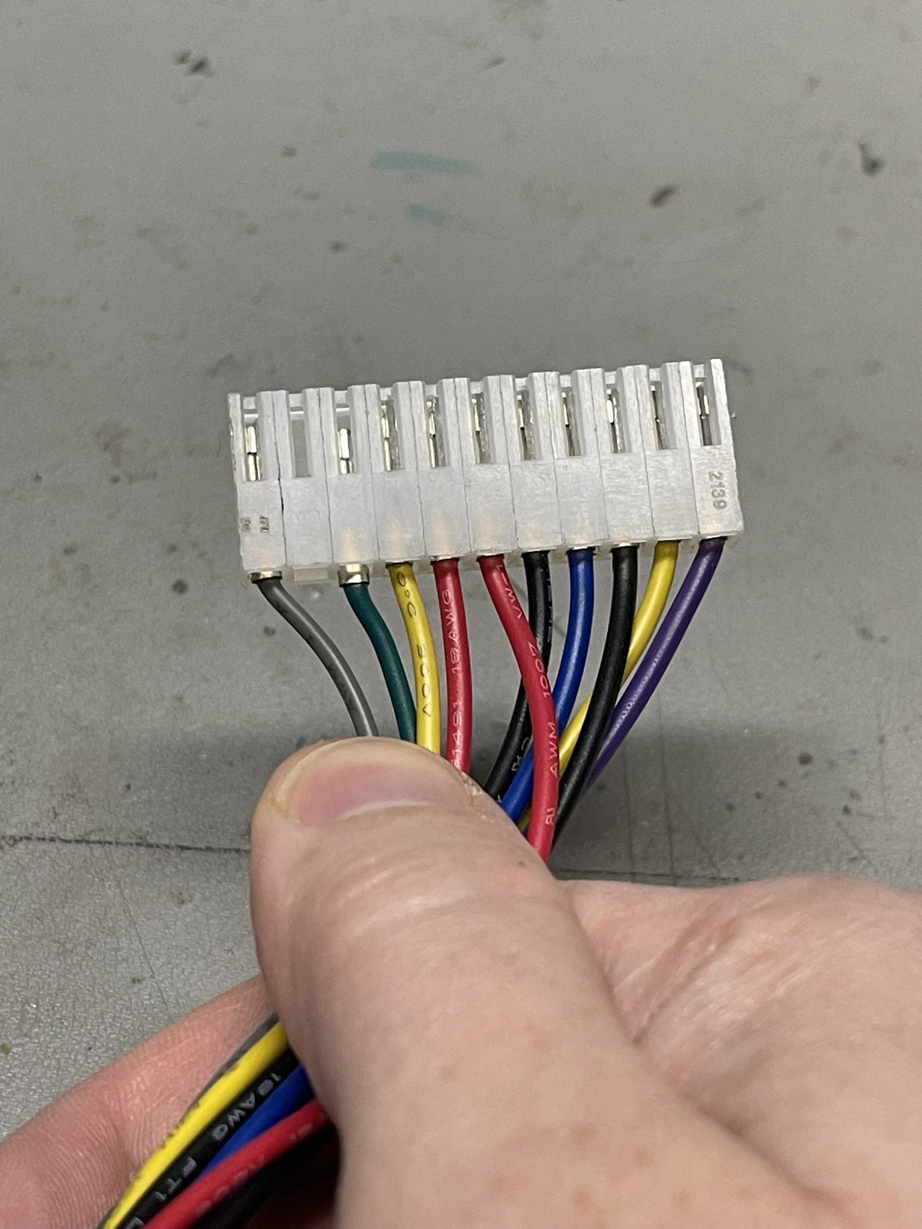

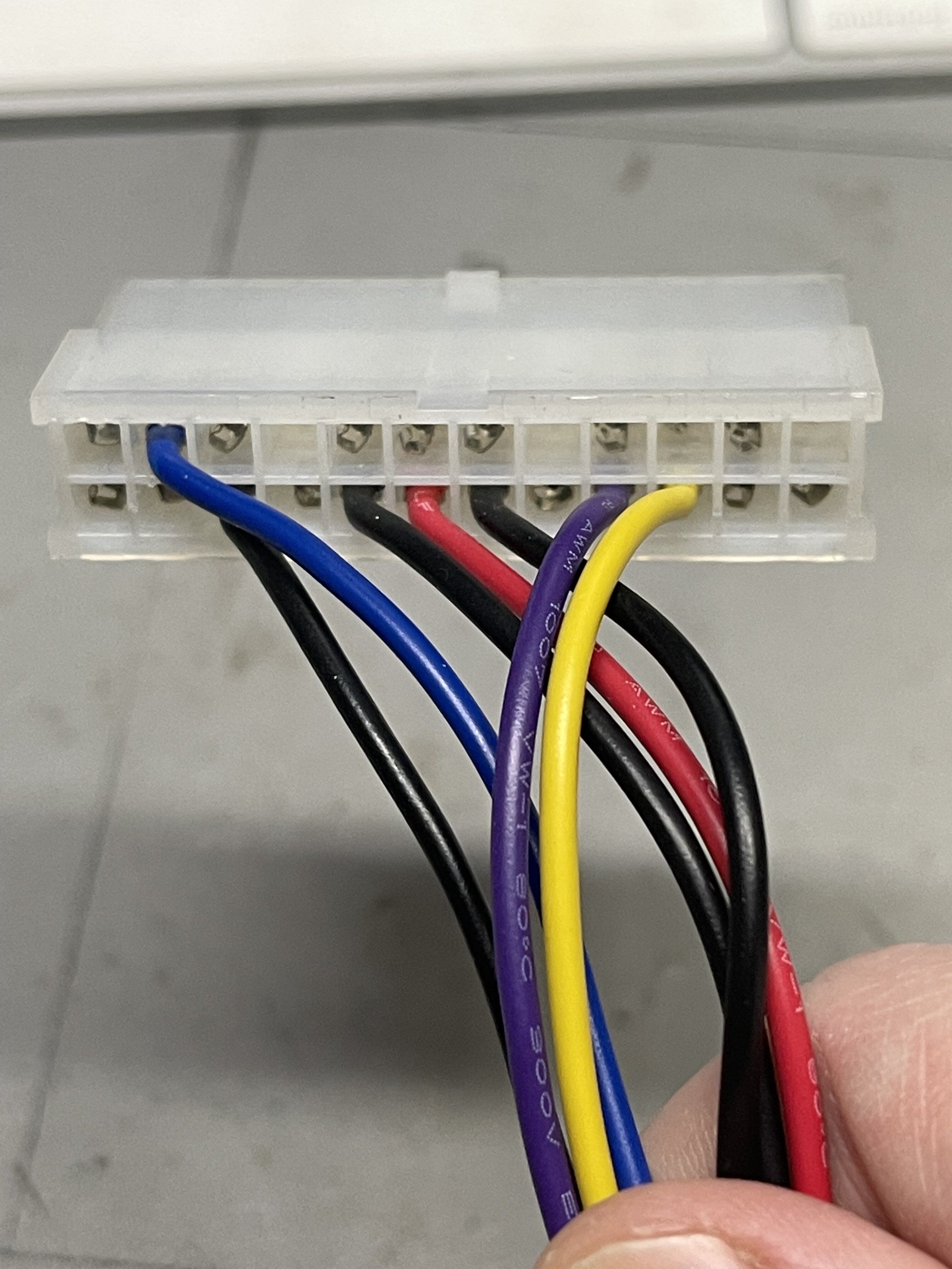

You can either get a fancy-pants tool to remove the connector clips from the plastic housing on the ATX connector or use a staple (tutorial). Either way, I was able to shove the ATX wires directly into the molex connector and they stay in snugly (win!).

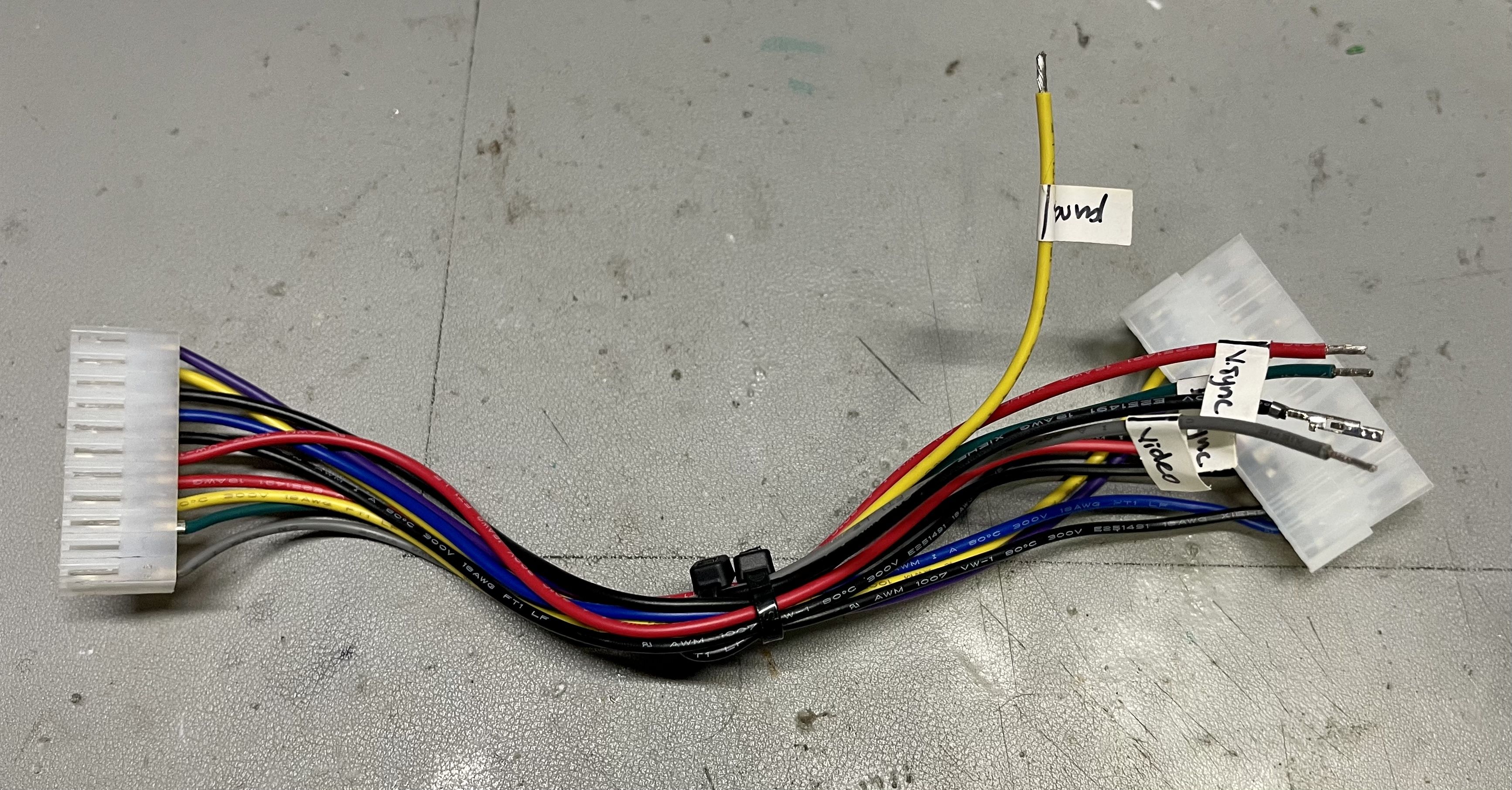

After all of that I end up with a cable with a "female" ATX connect and a "female" molex for the mac logic board.
