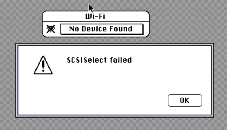

Has anyone run into an issue where the BlusSCSIv2 external drive (running the latest DynaPORT firmware) stops booting and the SD card itself is corrupted? I was able to repair the SD card in MacOs Ventura's Disk Utility and also backed up all the files. It just happened all of the sudden after shutting down my SE/30. I noticed there was a delay to get to the shut down screen before this happened and also a couple times before that.

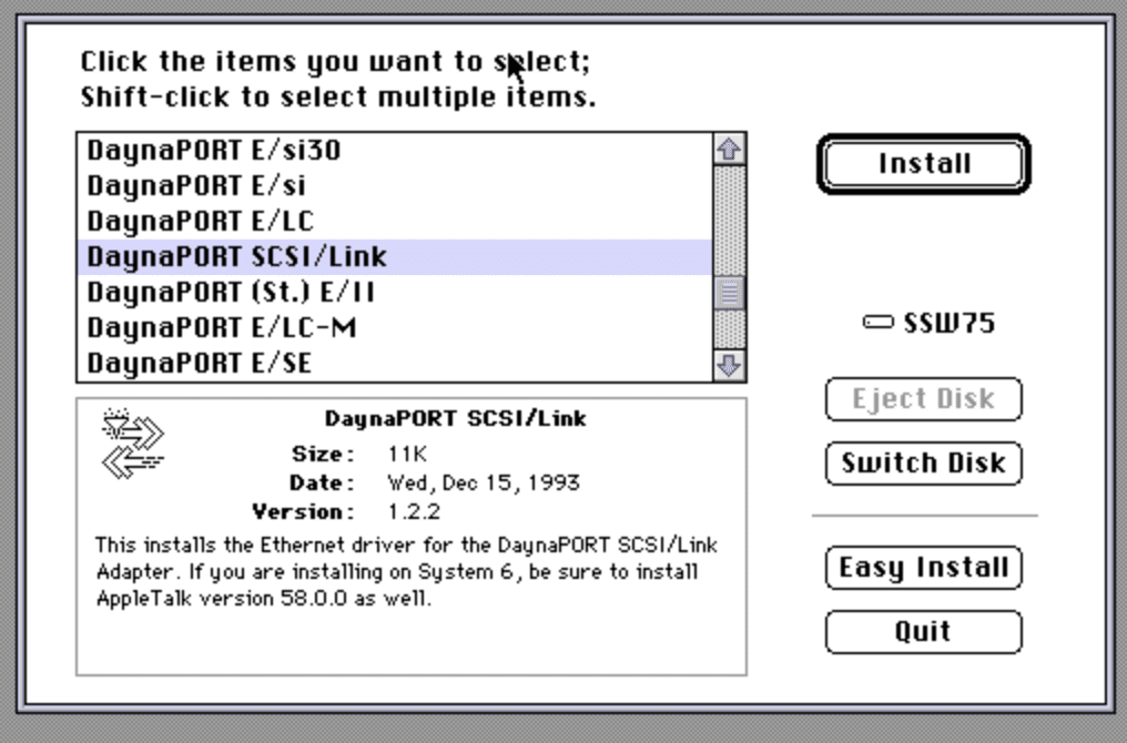

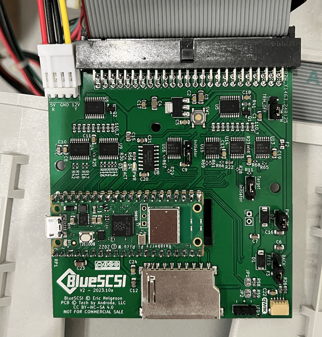

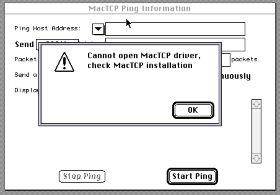

Today I got BlueSCSIv2 with Pico W (2023.10a) and I immediately wanted to try it on the PM8100.
Created a NE6.hda file, Installed SSW7.5.5, MacTCP, Dyana SCSI/Link Driver, I rebooted my Mac, set up MacTCP, but I'm apparently missing something.
MacTCP Ping Doesn't work.

I don't have an AAUI to Ethernet adapter or nubus Ethernet card yet, so Wi-Fi in BlueSCSI is the only way to connect to the network.
What am I missing? How to make it work?

The network starts working immediately after I start the "MacTCP Ping" application. Great!
I think it was this parameter "Type = 0" that was to blame for everything.

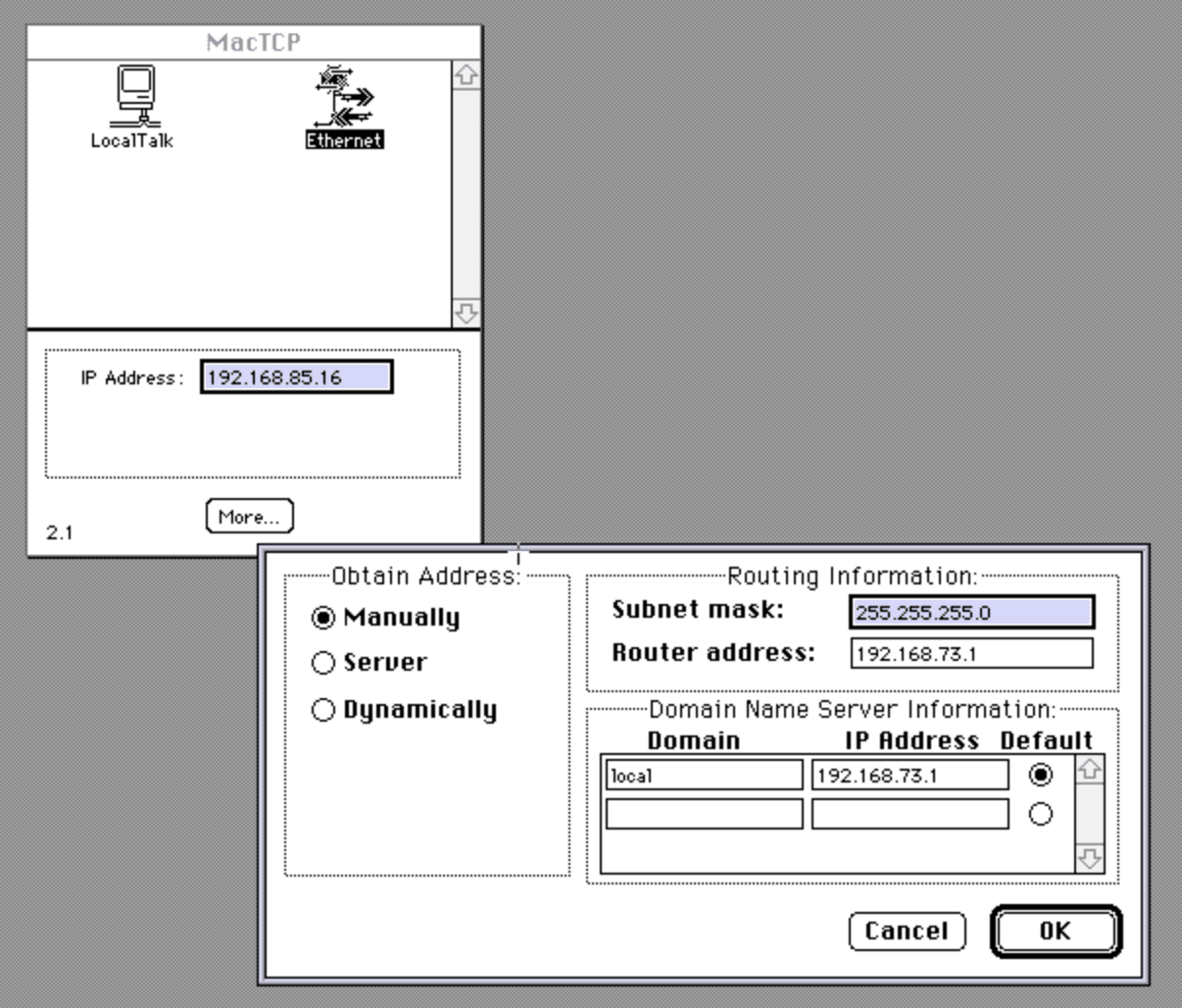

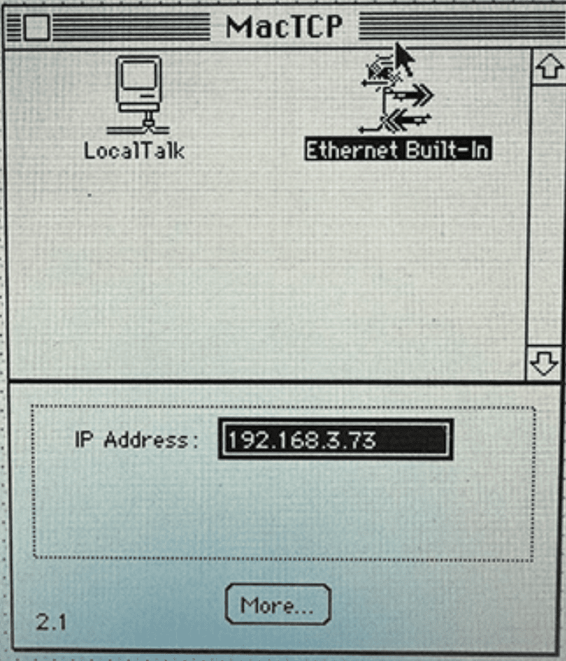

  8. The instructions then say to open MacTCP, which I did. I chose "Ethernet Built-In".
  9. Now came the part that was rather confusing because the instructions are incomplete. It indicates you should confirm your Router IP, which I did on my modern Mac by opening System Preferences > Network > Ethernet. It shows my Router to be 192.168.0.1, with DNS set to 8.8.8.8, and Subnet Mask: 255.255.255.0. Now here's where the instructions are lacking. It shows you this pic:
    Fine and well, but it needs to tell the user to do this: "Click into the IP Address field and type a number that matches the leftmost 3 segments of your Router, then type an unused number at right." In other words, in my case: 192.168.0.xxx, where xxx is for me to decide. I chose 73 because that was suggested and not used on my network. In other words: 192.167.0.73
    But yet another failure of the instructions is that they don't specifically say to click the "More..." button, but you need to do that next. I did that and then clicked the "Manually" radio button. The instructions don't specifically say that. You must assume it based on the following pic:

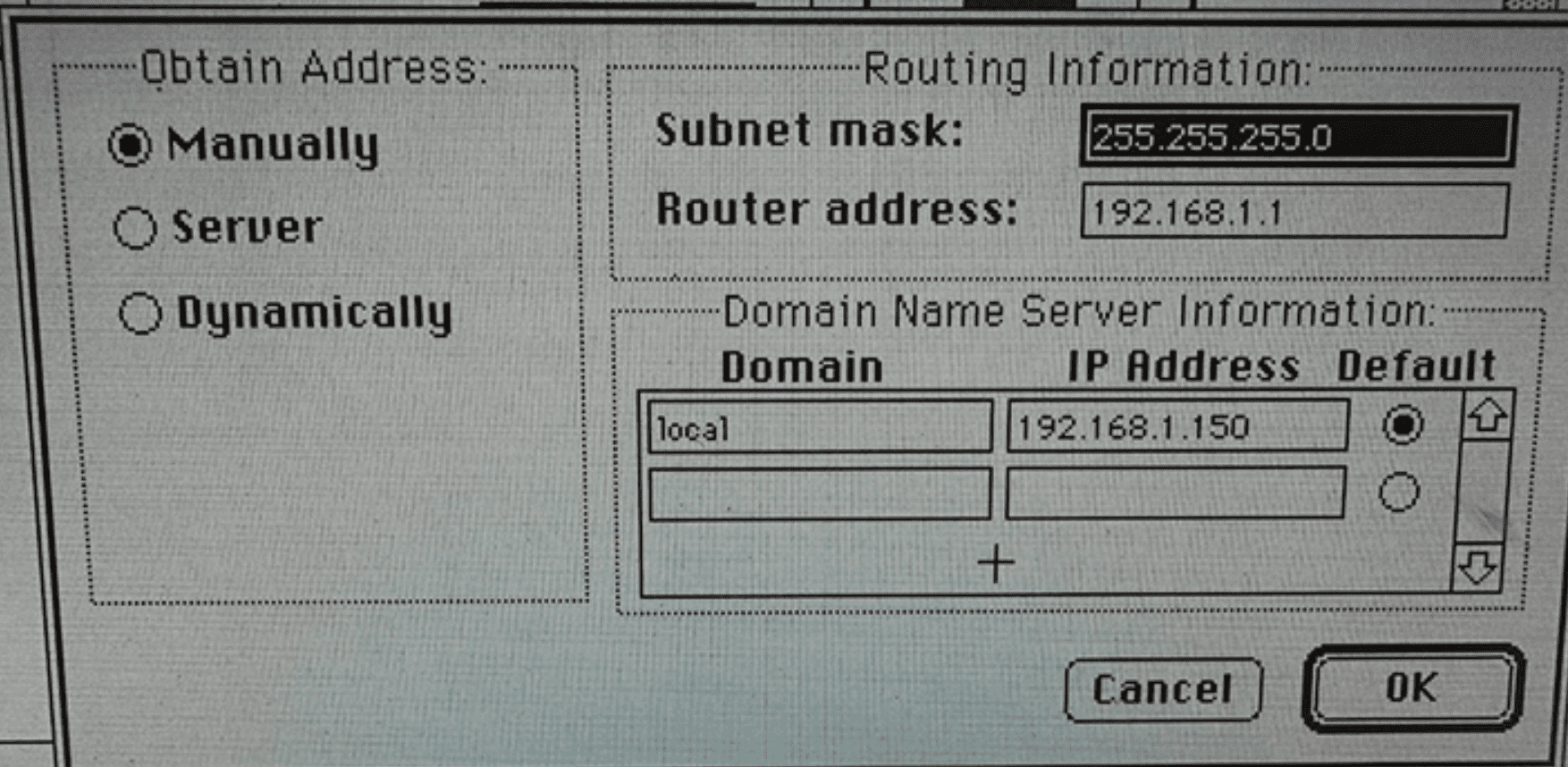

    So after clicking the "Manually" radio button at left in the above, I proceeded to fill out the Routing Information section with my ROUTER info: 255.255.255.0 & 192.168.0.1.
    After that, I didn't know what to do in the Domain Name Server Information section because the instructions make zero mention of what I ought to type into the Domain field. Must I type "local" to match the screenshot? Maybe not because the screenshot is showing an IP of 192.168.1.150 which the text instructions make no mention about! So what I did was type "Google" into the Domain field, and then I typed 8.8.8.8 into the IP Address field, and then I clicked the Default radio button, and lastly, I clicked OK.
    The instructions say I will be asked to Restart, but I wasn't. So I restarted manually.

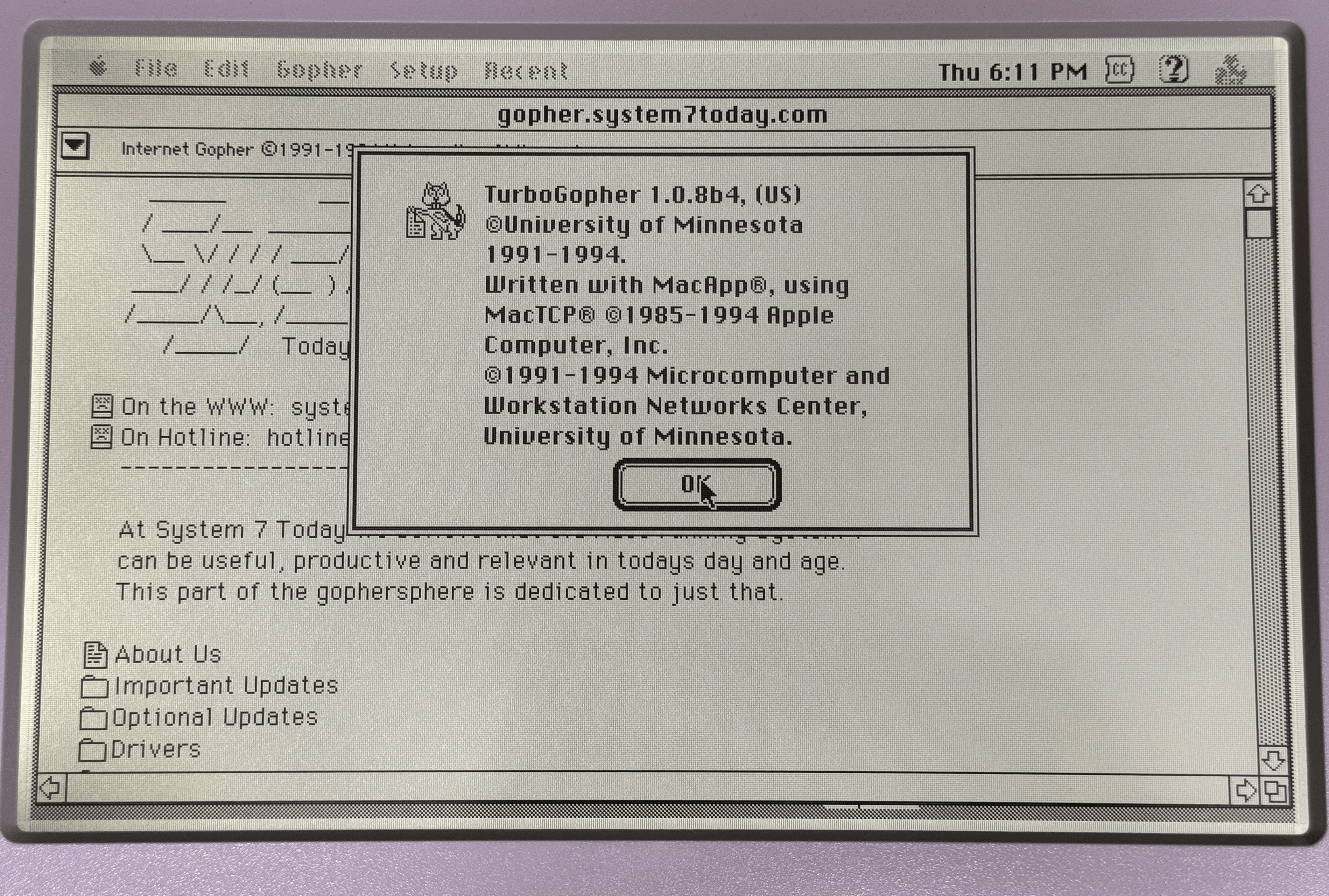

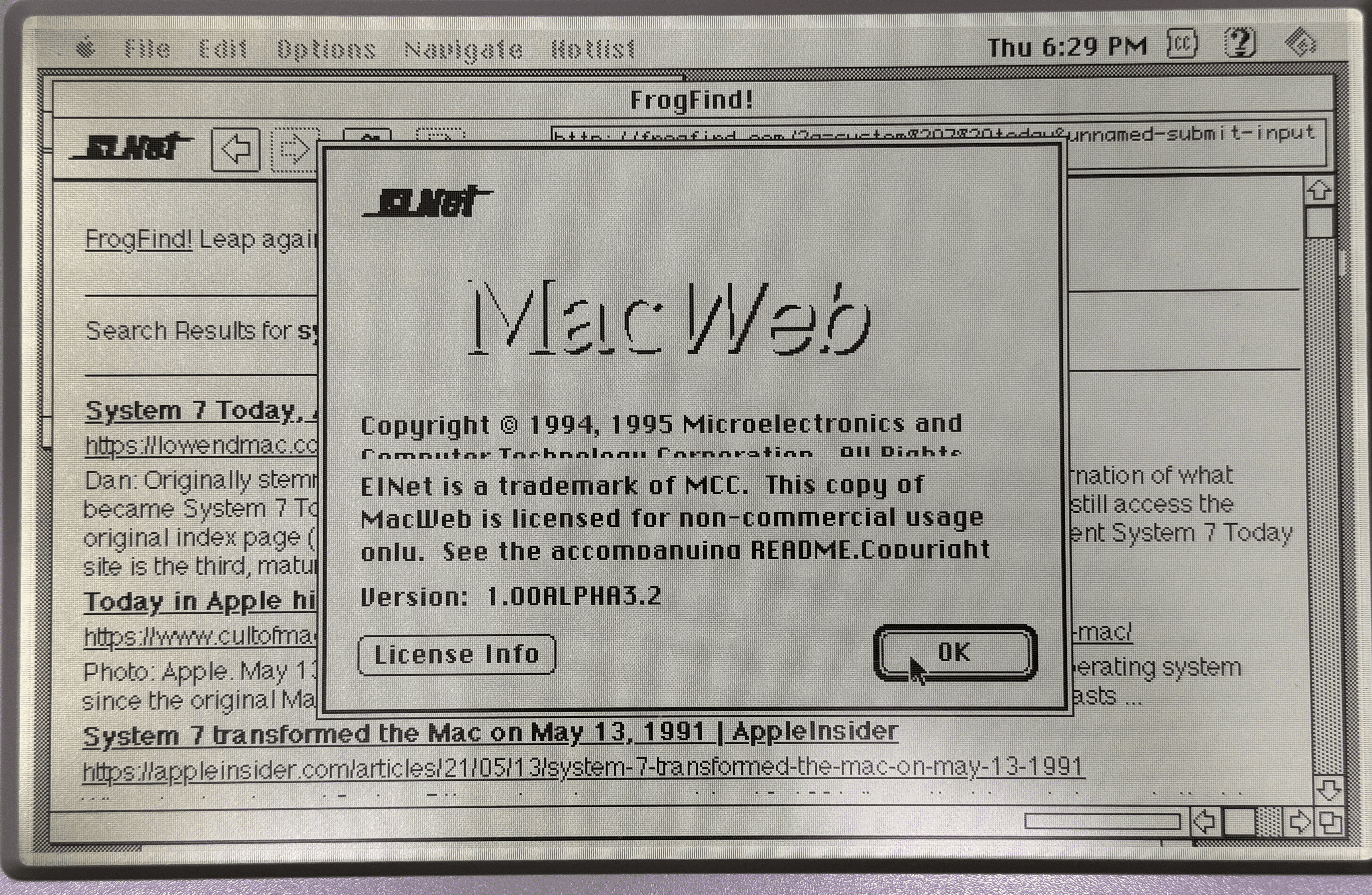

I got Turbo Gopher v1.08b4 to work, and I can access Gopher sites like System 7 today:
But despite being booted into System 7.5.5 with Thread Manager in the extensions folder, Turbo Gopher 2.0.3 (latest version) crashes. I've not tried any other versions yet.
I tried a bucketload of browsers that ought to be compatible in System 7.5.5, but all crashed (including Netscape 2.02), except for MacWeb...

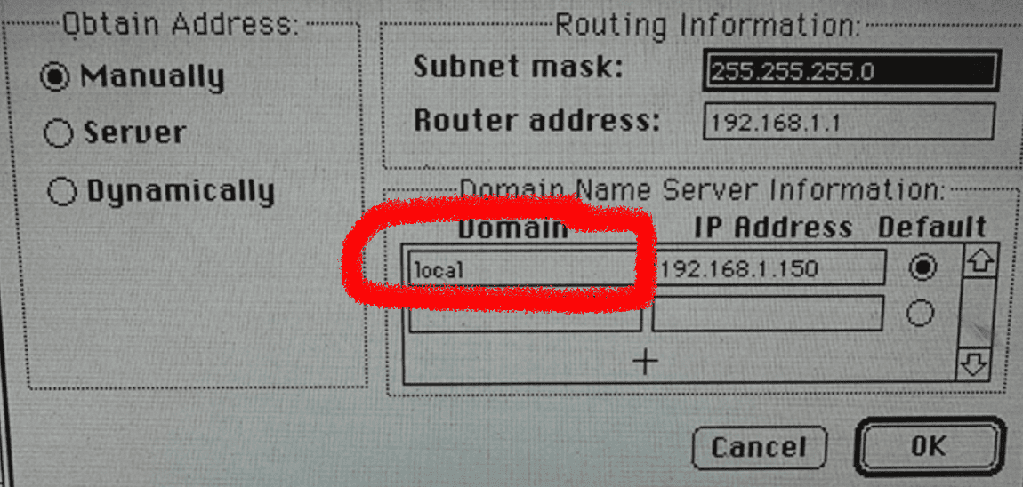

I found the following Github post by "benjamink":
He sheds light on what we should type into the field below circled in red:
He says to type a single period in the Domain field. That's it. So that is what I shall do as I continue my testing.
Hope this helps those of you following this info!
