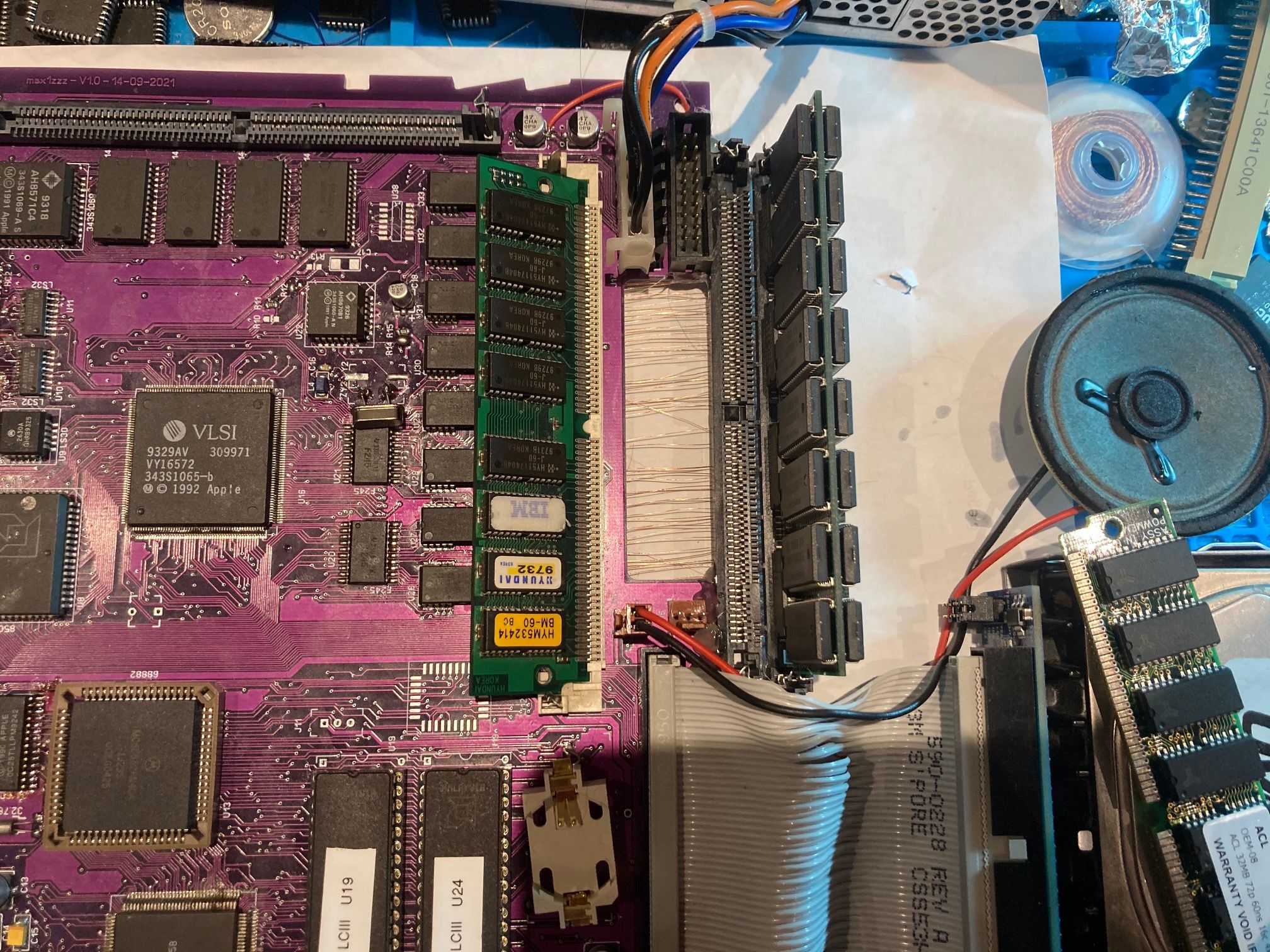

There was only one thing for it, bodge a second SIMM slot in!
All signals between the two SIMM slots are commend except the RAS signals for which the external slot is connected to the extra RAS signals I found on the board

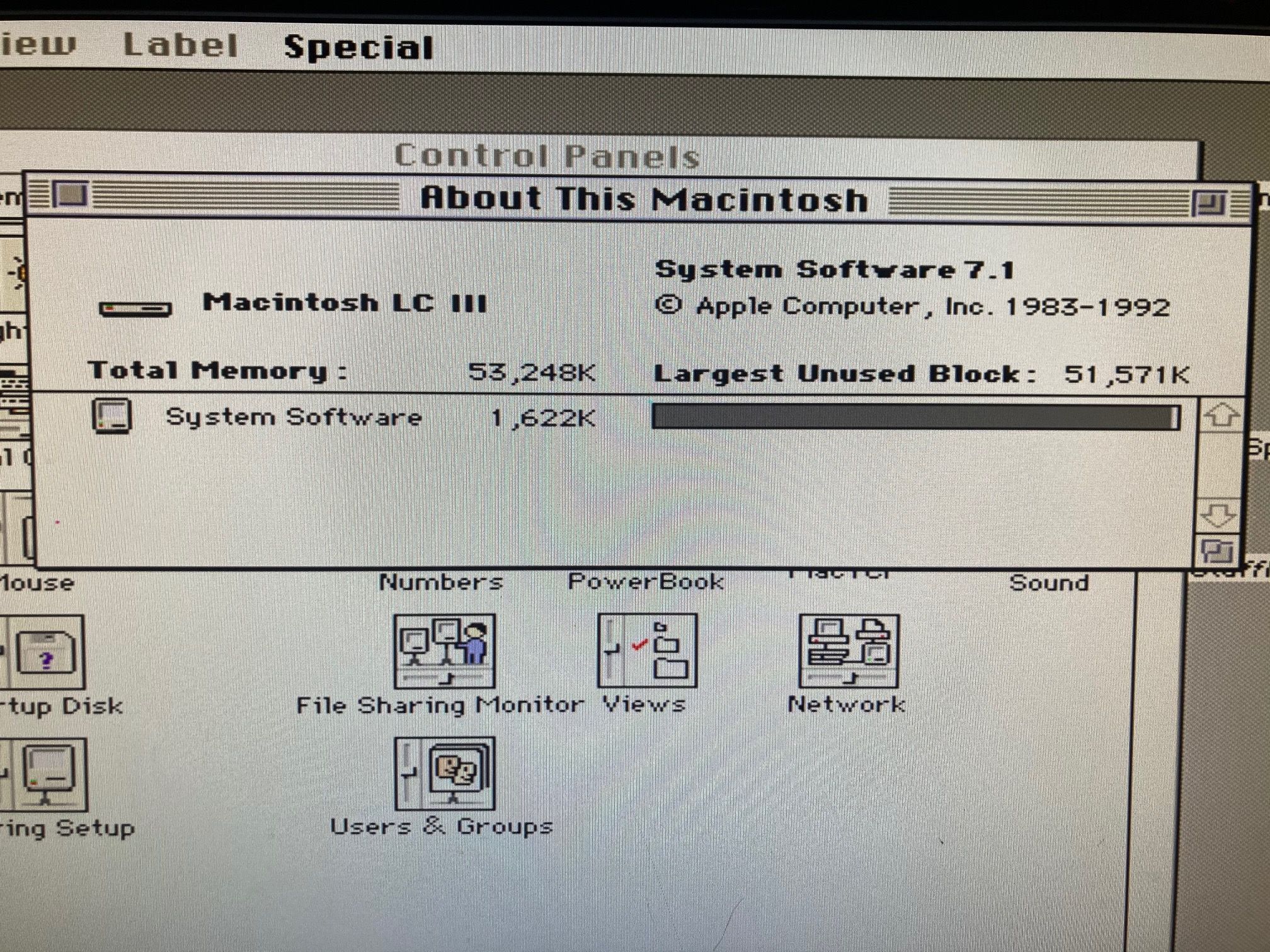

The result (after one extremely long memory check) was this:
52MB :)
Thats 4MB onboard + 16MB in one slot and 32MB in the other
Why not 2 32MB simms? I could only find one working 32Mb simm :)
I did once get a second very flaky 32MB simm to play ball for long enough the get the LCIII to boot and report 68MB total but didn't get a picture of it....

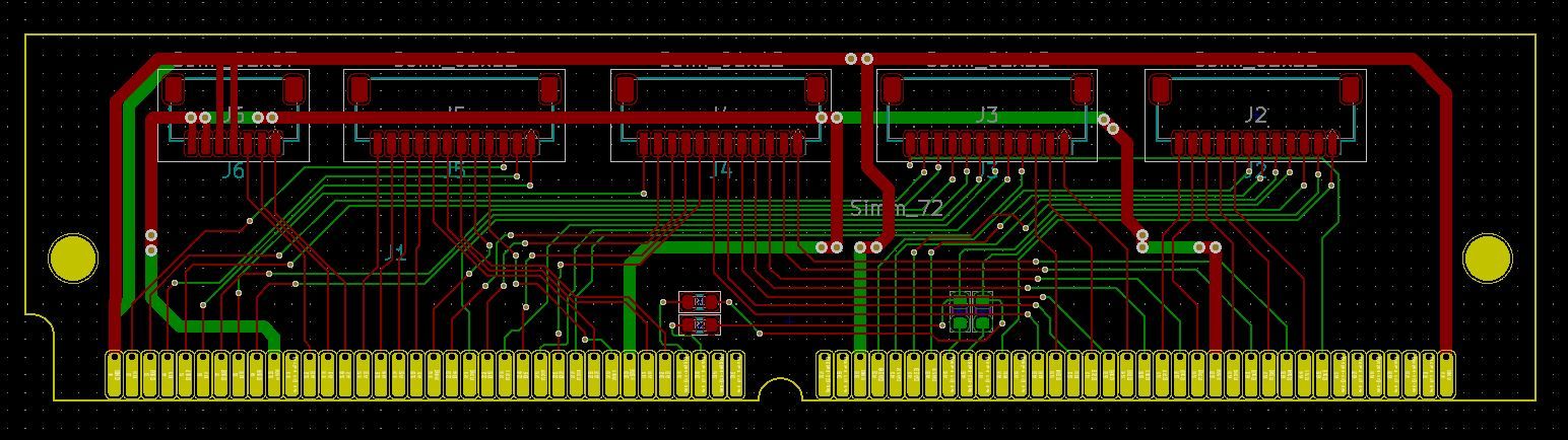

I'm taking the approach of making a breakout SIMM that has connectors that can be plugged into either a RAM card or a riser module as this allows for flexibility of exactly what is connected as well as where the expansion board is located in the chassis
This breakout SIMM to be exact:
Just need to design the RAM card and SIMM riser to go with it :)

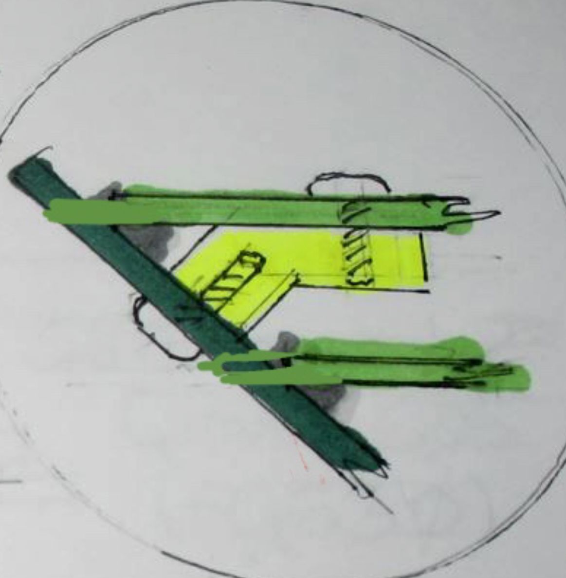

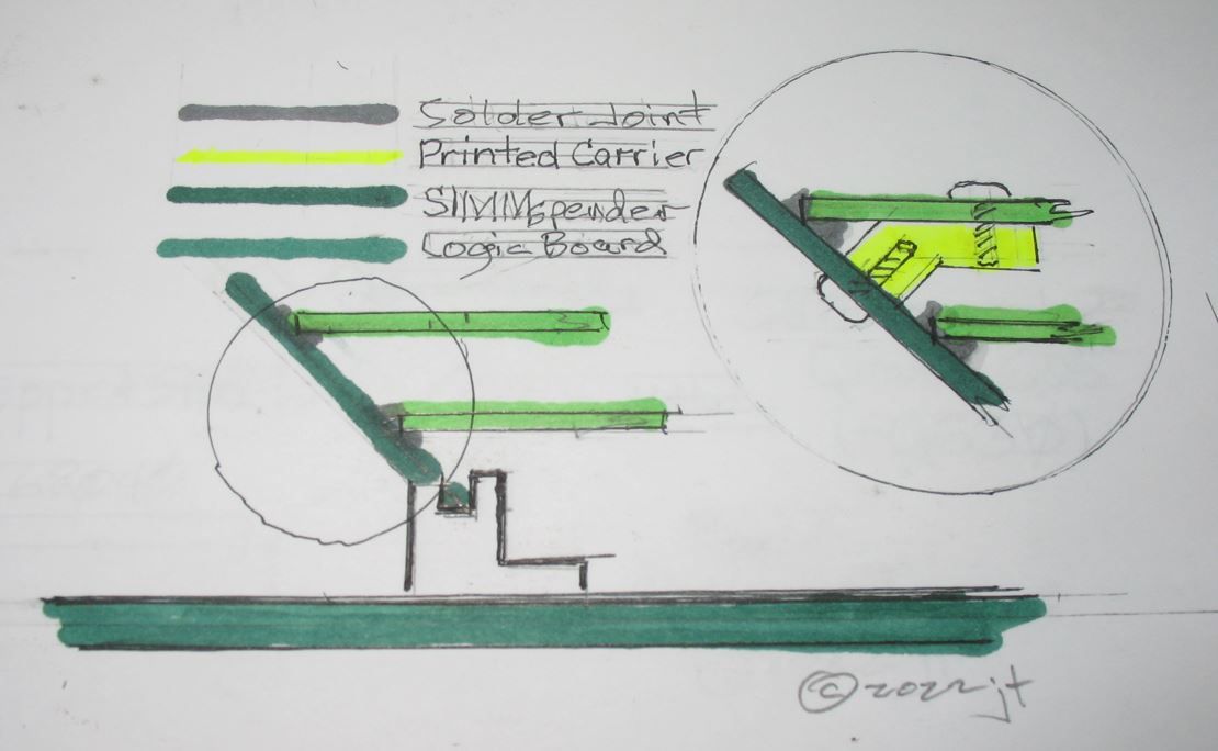

I've had some trouble describing this setup to you in words, so did a sketch this morning. Don't know if it'll fit in the LCIII, but Quadra project might be worth a look? SIMMspender is the inverse of a SIMMsaver. It consists of a passive TwinSlot implementation.
The sockets are flip-flopped, so CAS/RAS/Address traces make a turn in the opposite direction. Half of the data lines will require remapping in 16bit chunks on left and right sides of the adapter. That's a simple thing that the controller shouldn't even notice has been done. Worst case would be reversing the entire 32bit Data Bus as needs to be done to the IIci Cache Slot for PowerCache adaptation on the SE/30 PDS.
At any rate, this might work for your pair of SIMM slots? The passive SIMM adapter would remain in place if flying wires are directly soldered. Headers or sockets implemented on the adapter would support breadboard wires allowing disconnect for removal. You can always remove it for baseline system function in either case.
If this'll fit in the LCIII it should simplify things significantly? Whatcha think?

Interesting, I hadn't thought of doing it that way......
I'll need to do some measuring to be sure weather or not that would fit
I suspect the floppy and power connectors might get in the way of the backwards facing simm's but i'll need to double check that
How about 45 degree sockets so that the memory is parallel to the logic board?

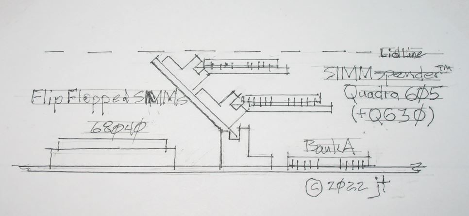

SIMMsppender can be extended to left or right using a modified 72pin form factor. ;)
OMG, I so wish I had my Quadra 630 board to do this. It should have the full memory ceiling, greater than the two SIMM Slotted DOS boards when I get done with it. 🤪
Got a pic? My LCIII is out on loan . . . forever it seems. :(
Quadra 630 project predates Section 8 AWOL MIA period and Quadra 605 riff was after I popped back in, but predates general availability of filimant printing technology. Switching the design up for SMT bodge of SIMMs/Adapter combined with printed. boltup support structure should be rock solid:
Elimination of thruhole SIMM Sockets frees up entire adapter for flip-flop trace implementation save for the two rows of 72 solder pads. It's not AI playtime, but half-assed mechanical sketching is good therapy. I'm home from work in mental health maintenance mode. Came home early yesterday with as close (not very) to a psychotic break as I've had since last trip to the hospital.

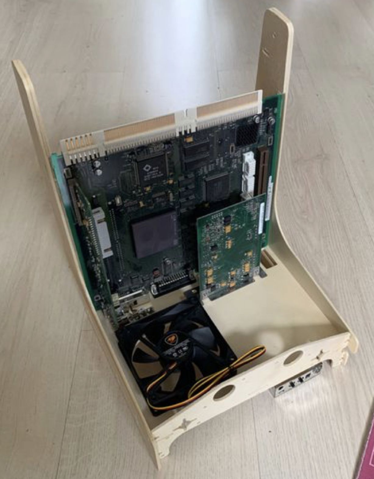

I love to try this out on my 630 (SE40) project.
Would it be possibe to cut a slot in the PCB and slide the sim in and so lock in together with the 3D printed part?
No stress on the solder joint as a result.
Thanks, it's been a long time coming! No need for slotting in config above, or maybe I don't understand your question?
I've been looking for my SIMMspender project box to no avail, but I just developed a suspicion about where it might be now that I stopped thinking about it. I have one very complex active component, four slot SIMM Saver or Expander on my desk, but it's too complex for illustrative purposes. Maybe later?
Curious, got linkage to your project?
Just a quick edit, but again thinking about this idea….it may break traces to the top sim.
As for my SE40 project, do check the pinterest link in my profile for more pictures.

No worries about breaking the solder joints, the printed supports would be installed before soldering with good contact. Mounting screws are smaller diameter than the holes in the SIMM's for finagle factor. Holes in SIMMs can be drilled out to larger diameter if necessary or advisable overall from the start? After the fact crowns of epoxy can be added to screws as well. ;)
Edges of Simms can be filed to the 45 degree profile of the adapter so top and bottom edgecard teeth make good or close contact with their SMT pads for flux and flow of solder. Bottom SIMM installed first. If reliability is an issue, the SMT pads can be elongated so it after flux and flow is accomplished, it would be very simple to reflow bent copper wires with a poke of the iron and topside excess clipped.
My soldering skill leave most everything to be desired, stone age prototyping, wire wrapping knuckle dragger here. 🤪
I'll do another rough sketch in isometric of the joint details later, should be fun! :)
Just noticed I ran the SIMMs right through the adapter in that sketch. OOPSIE! :oops:
edit: just checked, I didn't do that, did you edit it like that?
