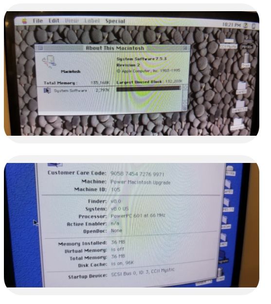

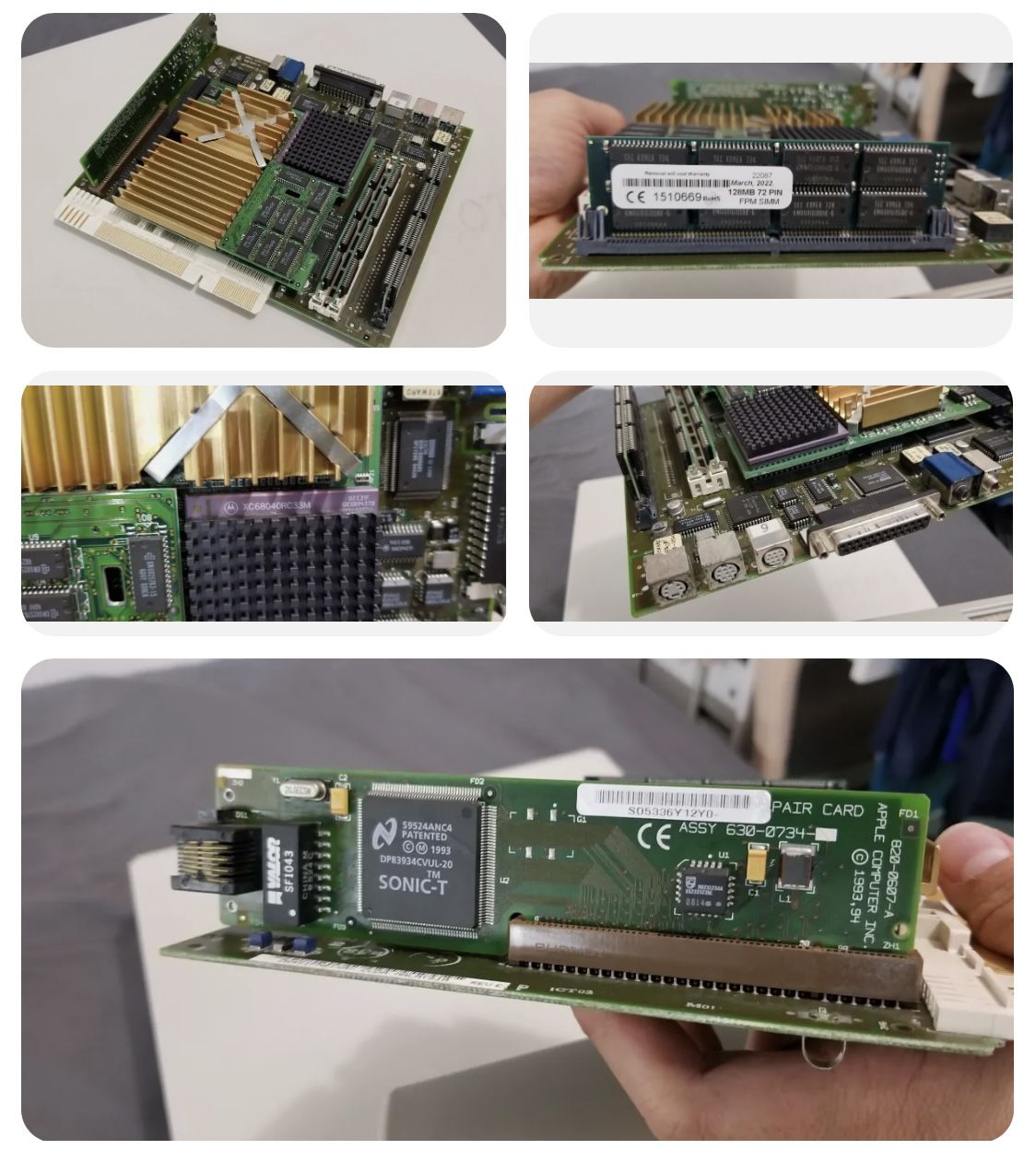

Found a ebay listing with a interesting claim.
this is supposedly a lc-575 logic board in a color classic with the power pc upgrage
here is the interesting bit.
seller says that it is 132mb which is functional under the 6040 but only 36mb is functional under the power pc processor.
