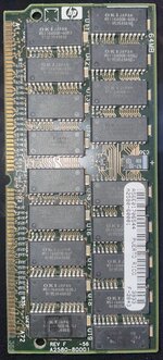

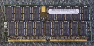

I still think converting the HP A2580 RAM module would be the easiest solution although @johnklos 's idea is probably about as simple. Makes me nervous splitting the address space like that, though it shouldn't...
I suspect the A2580 is a little cheaper than the HP D4290.
The A2580 are available on Ebay (USA) for less than $8 each from Memory Masters with free shipping.

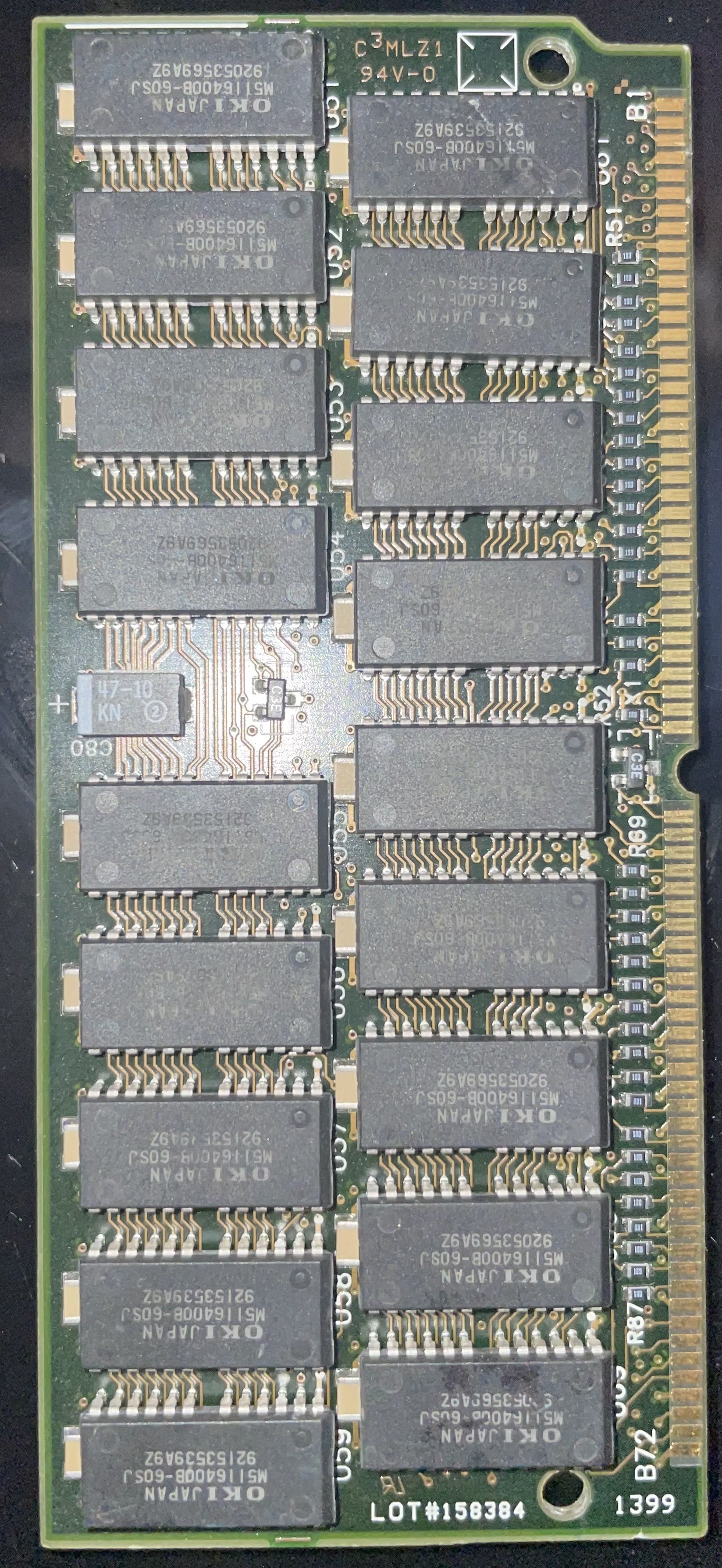

I ordered the larger module. The one you recommended.
I see the other one looks like a 16 chip config. Is that even compatible with what we are trying to do?

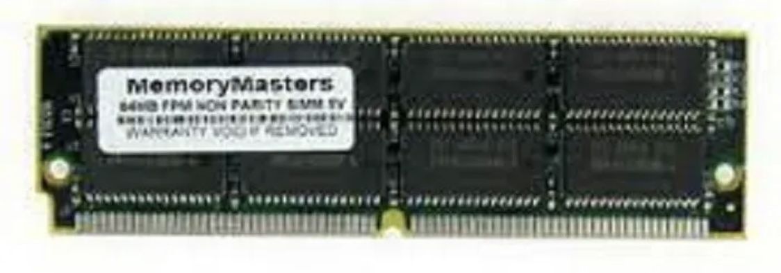

I do have some 128mb and 64mb sticks in my collection.
I worry about clearance on the large stick..?

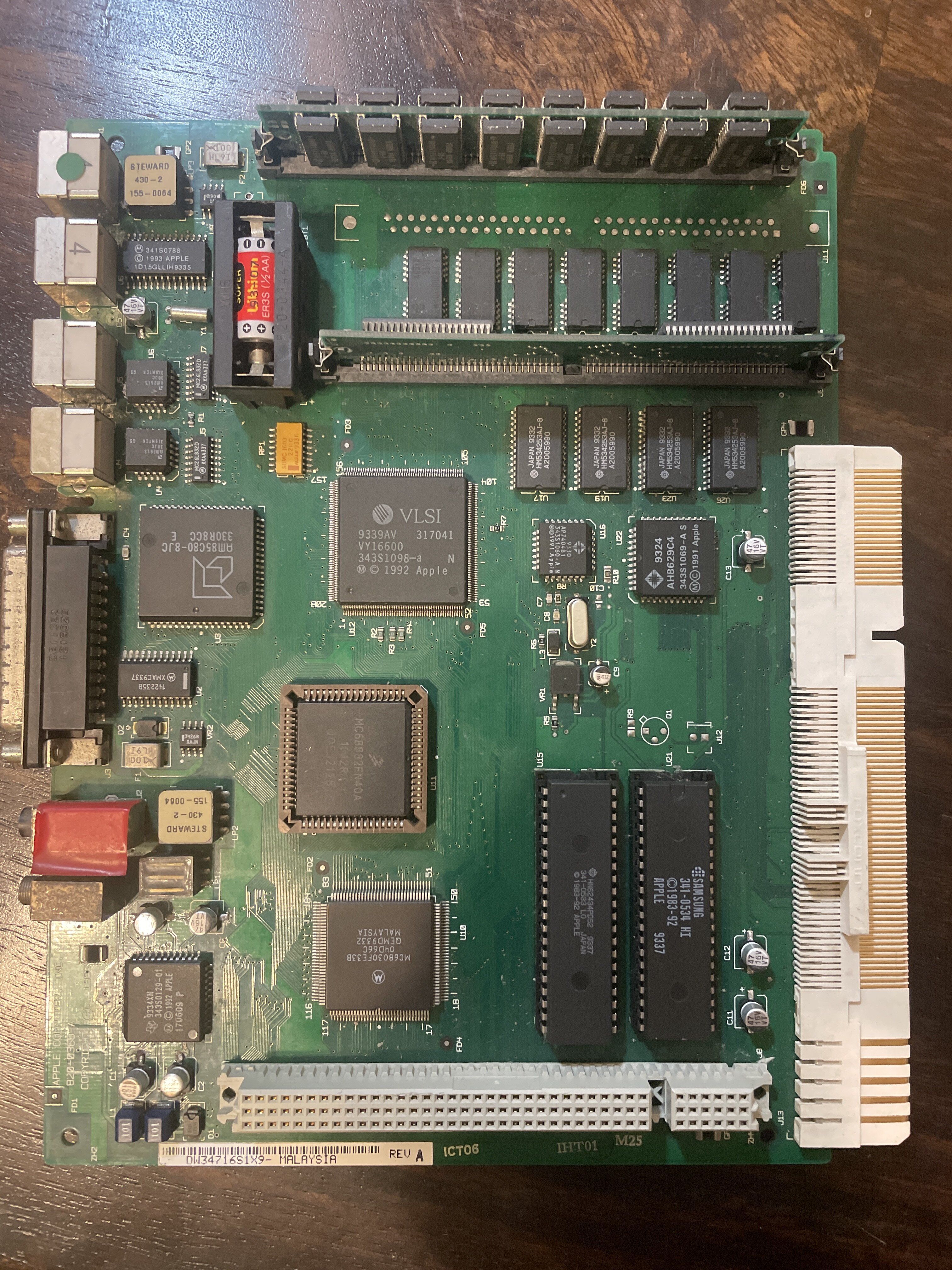

@Sphere478 first thing you need to do is verify this is actually possible on the 550 - I don't have a 550 so haven't checked. Although the 550 uses a Sonora derived ASIC there is no grantee the extra RAS signals exist on the 550's ASIC. Start by looking at pins 95 and 98 on the ASIC and see if they are connected to anything, if they are not you need to measure them with a oscilloscope and see if you see the RAS signals there, if they are connected to something you need to look at what they are connected to, if like the LCIII the connecto to a resistior that than dosen't go anywhere thay proably are extra RAS signals, if they connecto to anything else they defiantly aren't
It's also entirely possible they the extra RAS signals exist on the 550's ASIC but on different pins, 95 and 98 are the pins on the LCIII's ASIC but there is no grantee that is where they are on the 550's (if they exist on it at all) if that's the case you'll just have to go round scoping all the unconnected pins looking for the RAS signals

might be a little difficult for me to probe that board while running. I haven’t rigged up a way to power it outside the case. And the lc-550 case is rather cramped.
can I ohm between the chipset and the ram slot? Could you indicate the points? You are much more familiar with this than I‘ll do my best to catch up though :)
here are some high res of the patient.

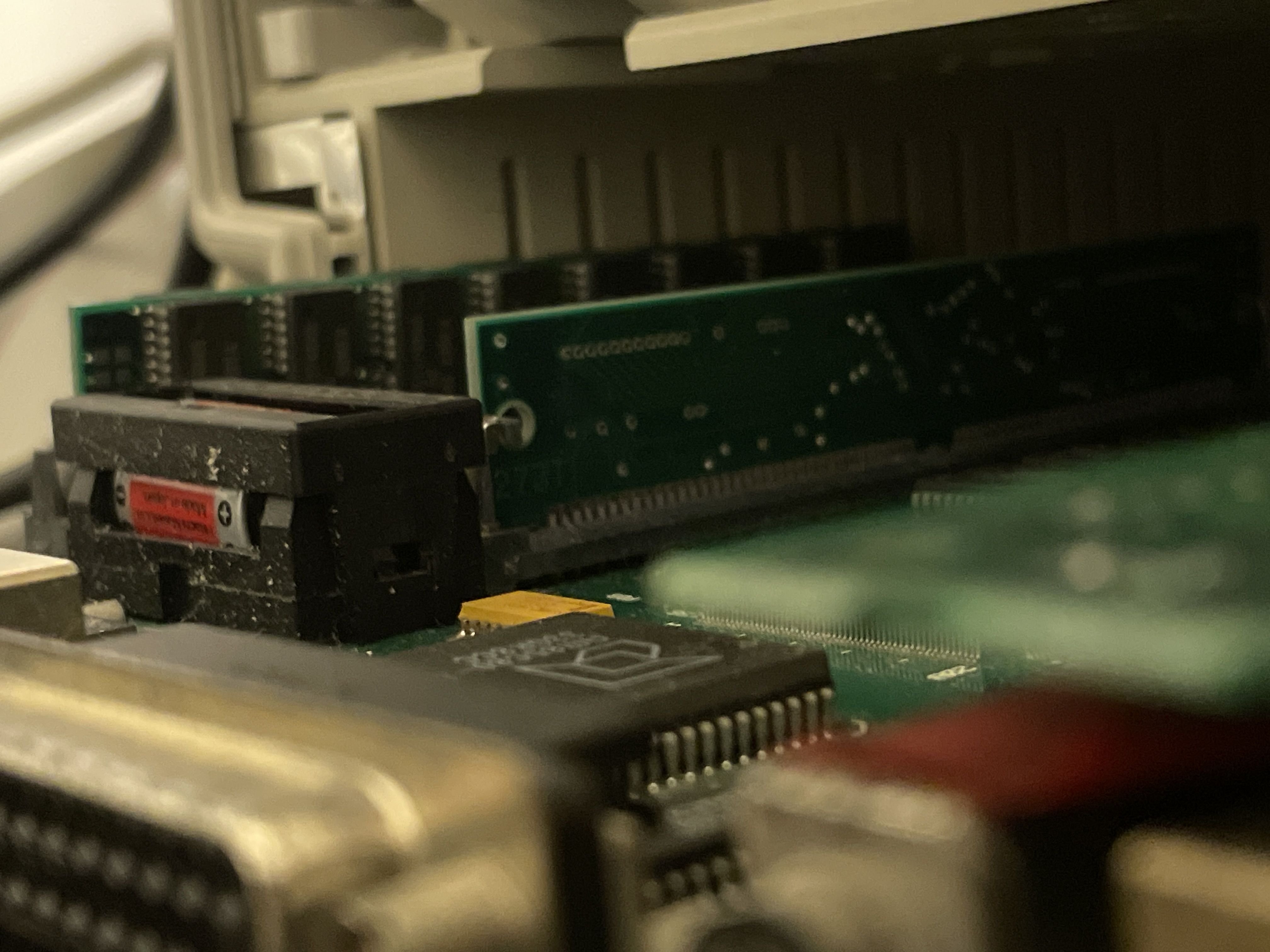

Okay! Got the stick in! It’s purdy!
but bad news…
it is too tall to use

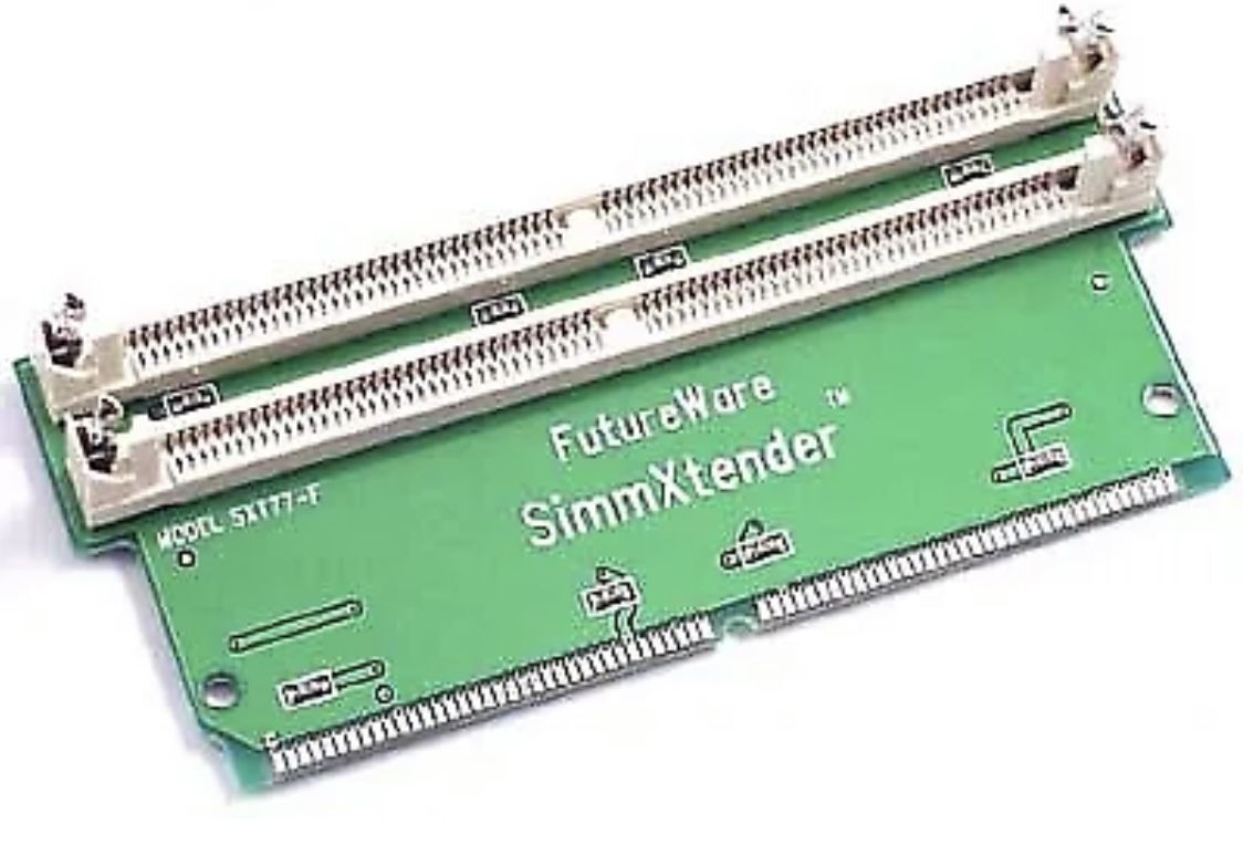

is there a simm stacker that I could use to put it at a right angle?
There were a number of ram expander cards that let you re-use smaller ram simms in a single slot by combining them together. Check eBay, there were a number of them in various shapes and sizes, both branded and un-branded. Avoid MicroMac "SimmDoubler" cards, not because they're expensive on ebay (they are), but they do something a little different from most others.
I’m not finding any that looks like they will fit. I may have to make one unless somebody else sees something out there?
