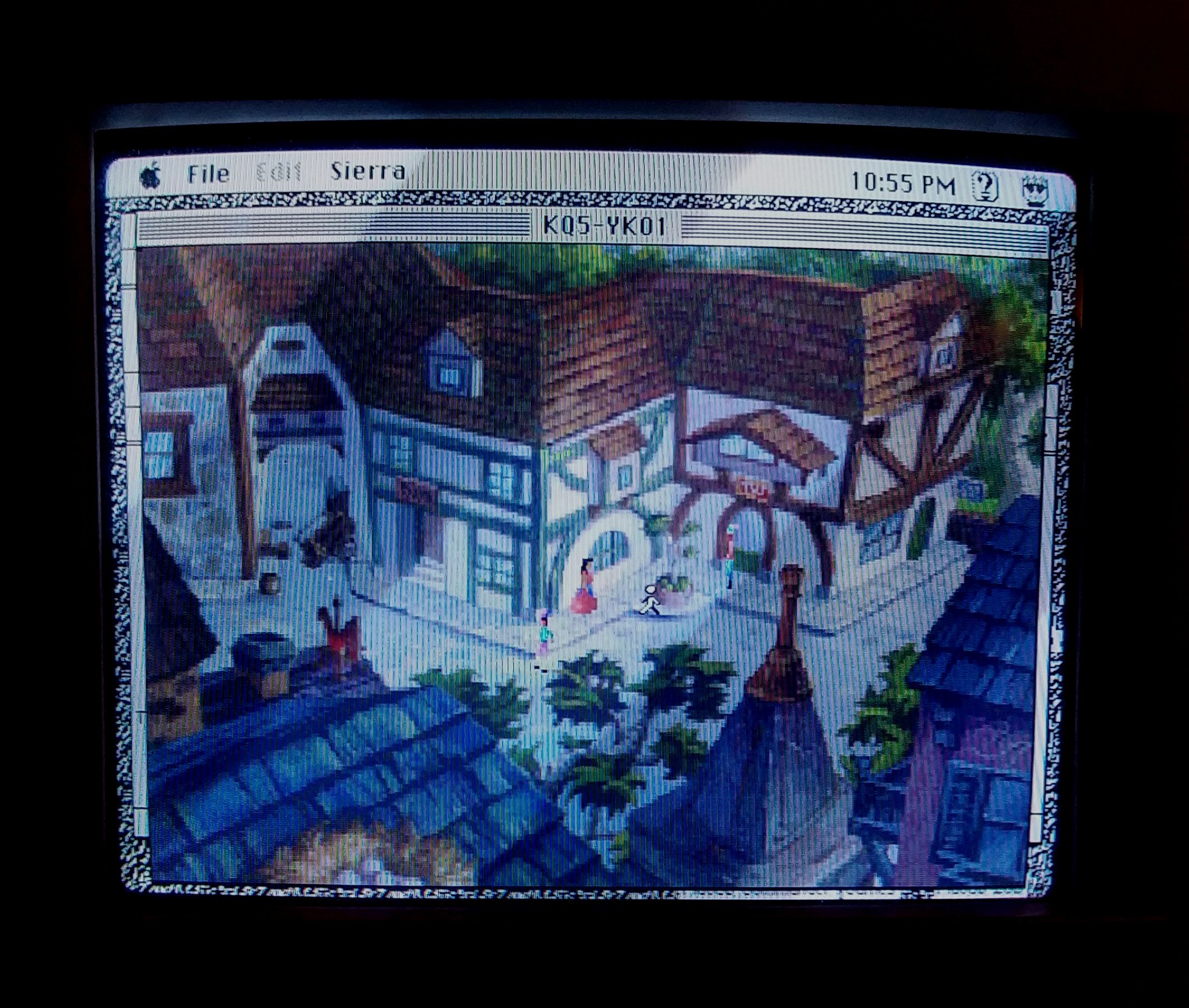

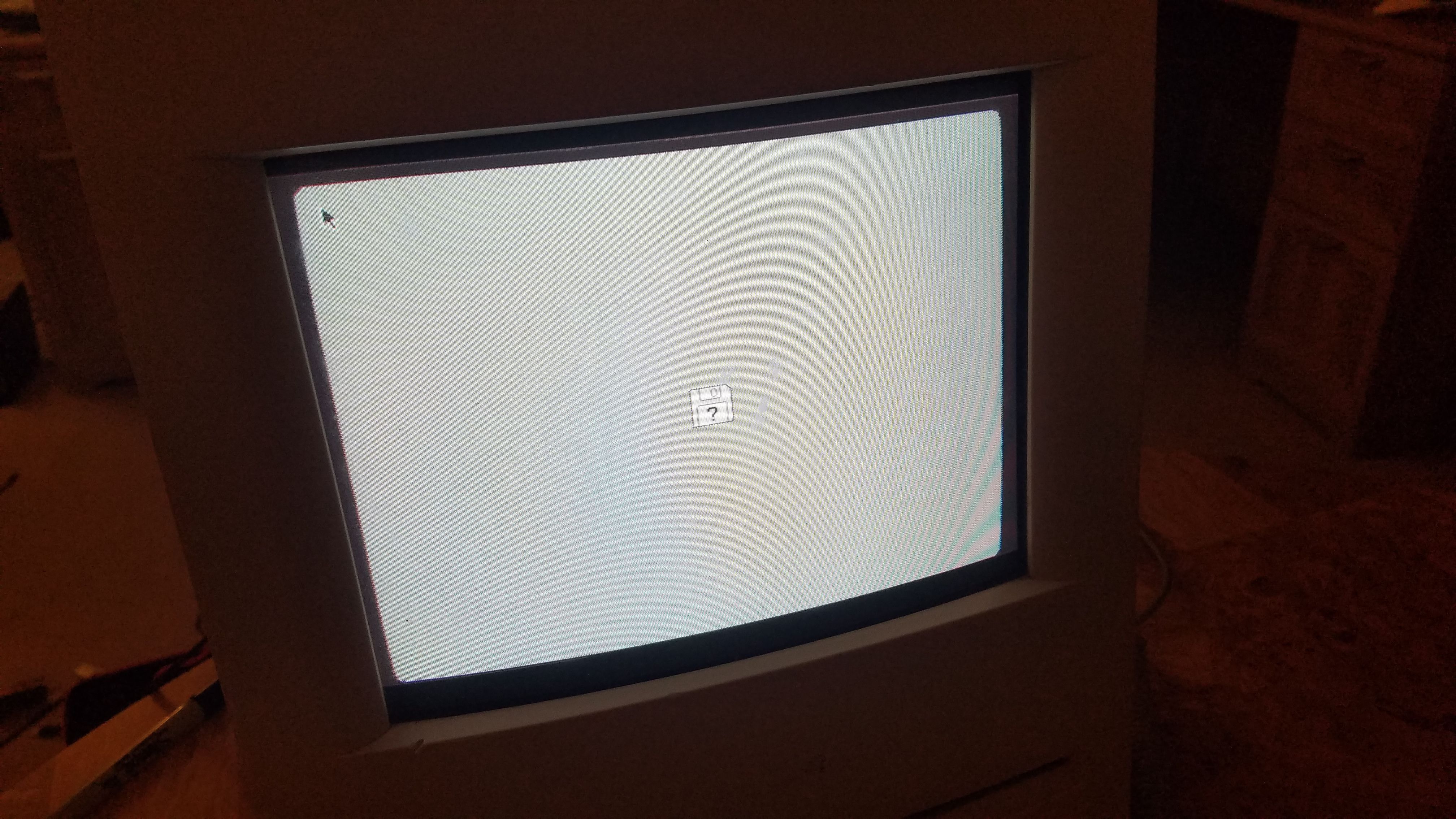

I now have soft power and a picture! :)

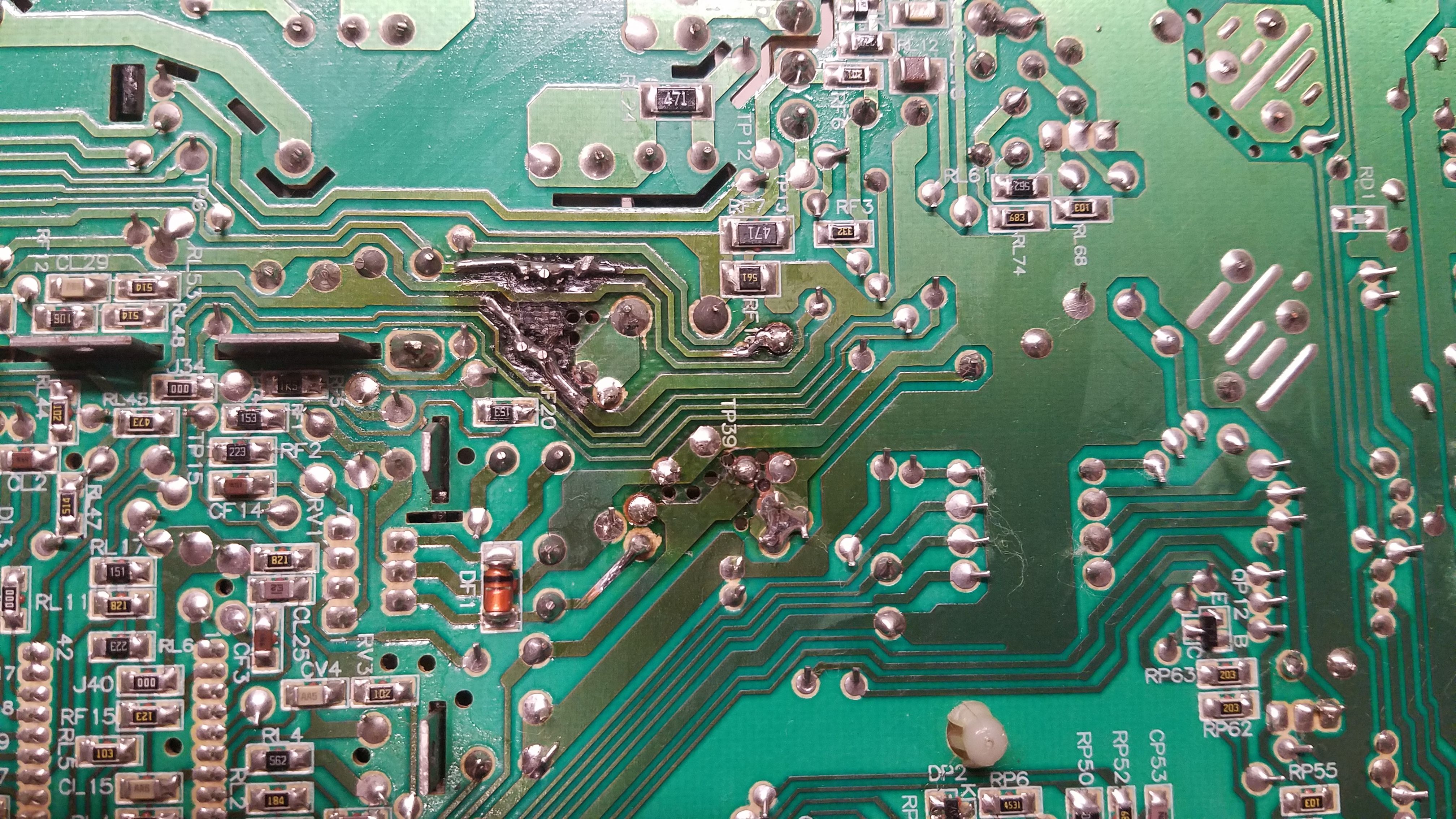

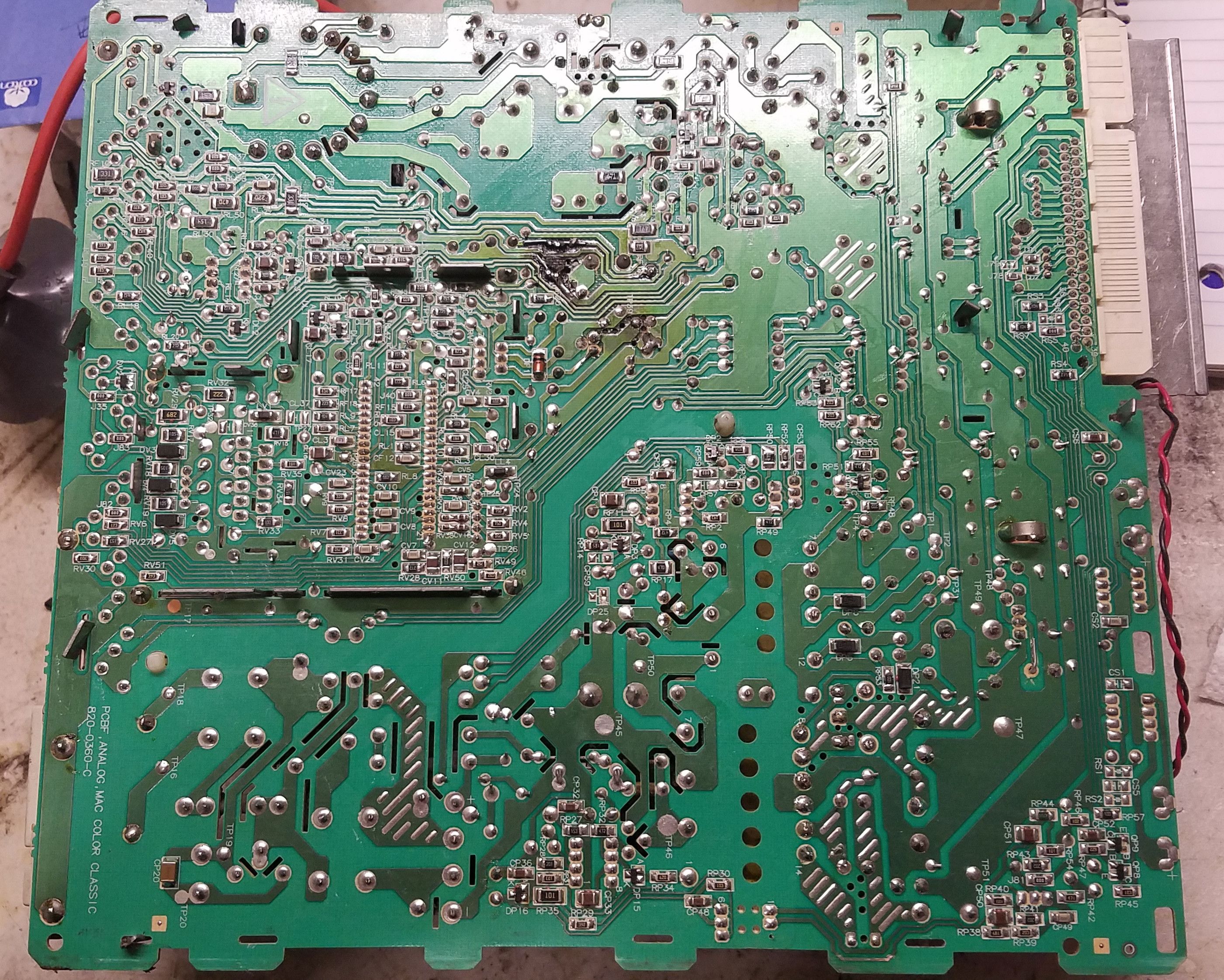

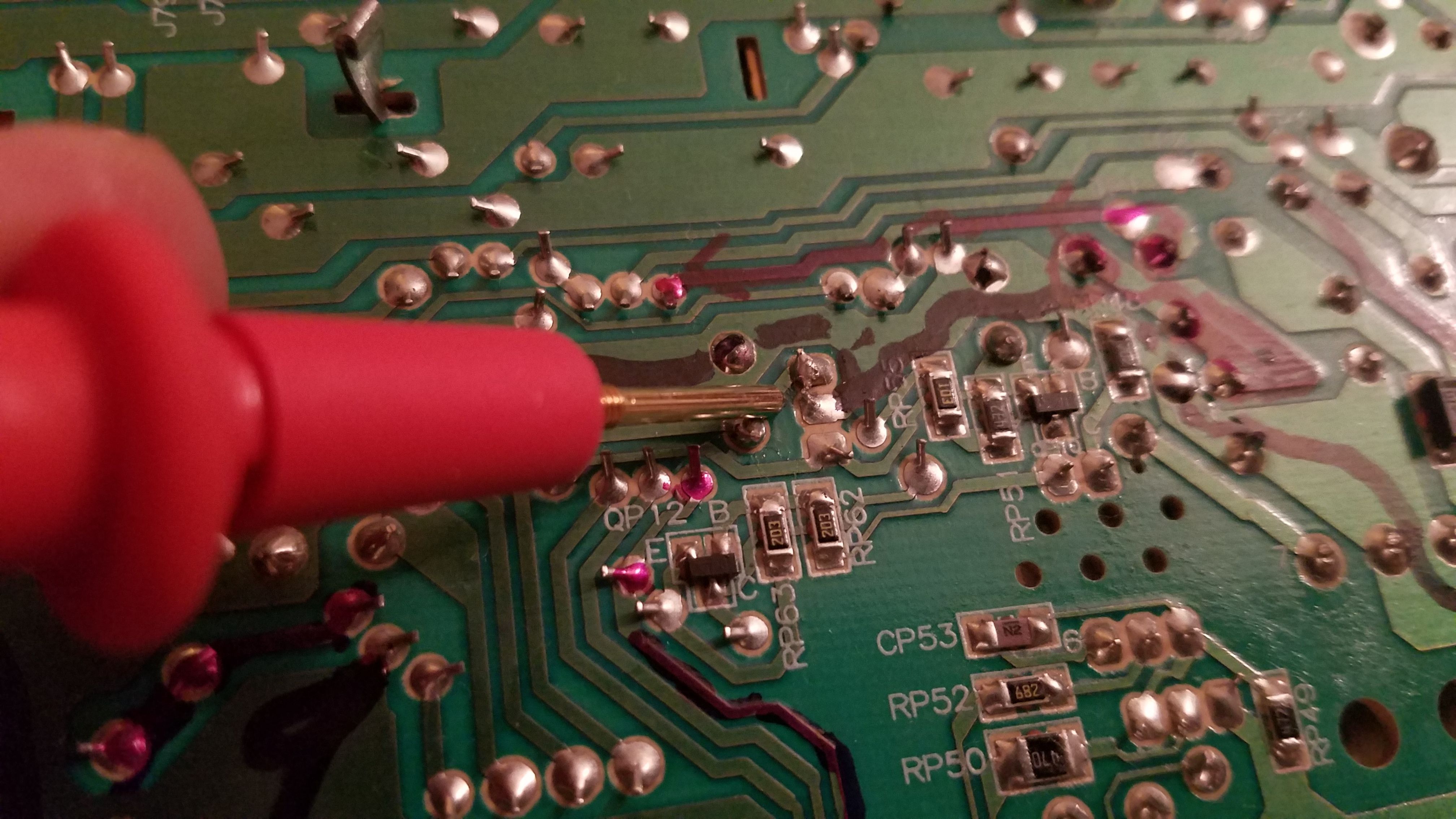

I found a tiny solder shaving bridging two pins on IP11. I don't think I reflowed it during the course of the recap but removing the shaving did the trick.
The hourglass distortion is now gone, but I noticed some occasional flickering which coincided with arcing sounds so the flyback may have problems.

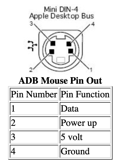

I am quite curious about Soft-power having worked originally when you got your hands on that CC, but then after recapping, you said the machine powers on immediately by the mere flip of the switch on back (which should not happen).
We know that soft-power is merely the grounding of pin-2 of the ADB connection, as per this diagram...
Something must be pulling pin-2 (normally a HI +5V logic level) to GND for the minimum required duration of what I believe is 200ms or longer. Have you probed that area of the circuit?
It turned out to be a shaving of solder bridging the pins of a transistor. After fixing that, soft power worked again and so did the display. B+ voltage increased from 45V to 60V under load.

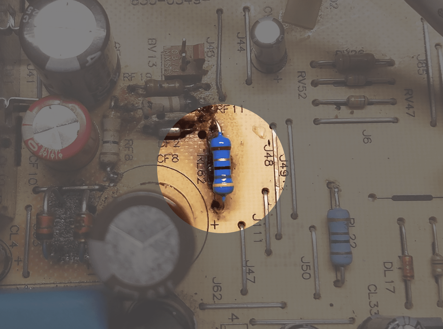

I then tried to adjust the display using the rear pots, but when I did, RL62 began smoking. I shut down power immediately and replaced the single 47Ω resistor with four in a series/parallel arrangement for increased power handling. I also swapped DL21 and DL22 with a string of 1N4001 for the same reason. That bought me enough time to properly adjust the display.
I also tried to reduce B+ voltage by adjusting the PP1 potentiometer, but it was glued to prevent tampering. I wasn't able to remove the glue without ruining the pot, so I swapped in the one from my LC575 board. That one was not glued. I'll have to order another 1K pot to replace it.
I think these parts are underrated for the power they're subjected to and having the display out of adjustment seems to stress them further. It might explain why I see the same parts burning up on other boards.
Wow! So it looks like things are working now. And all because of a tiny shaving of solder!

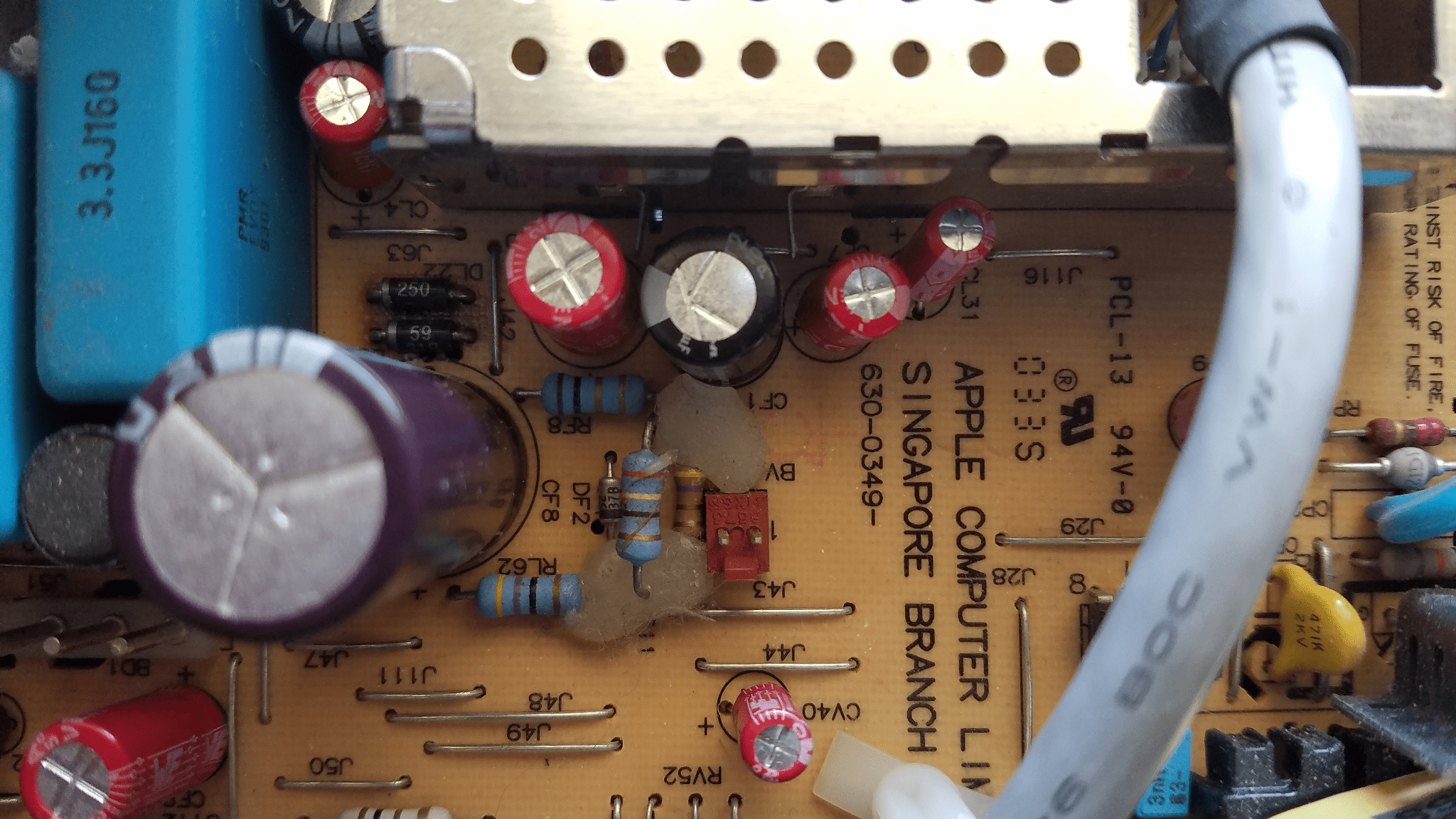

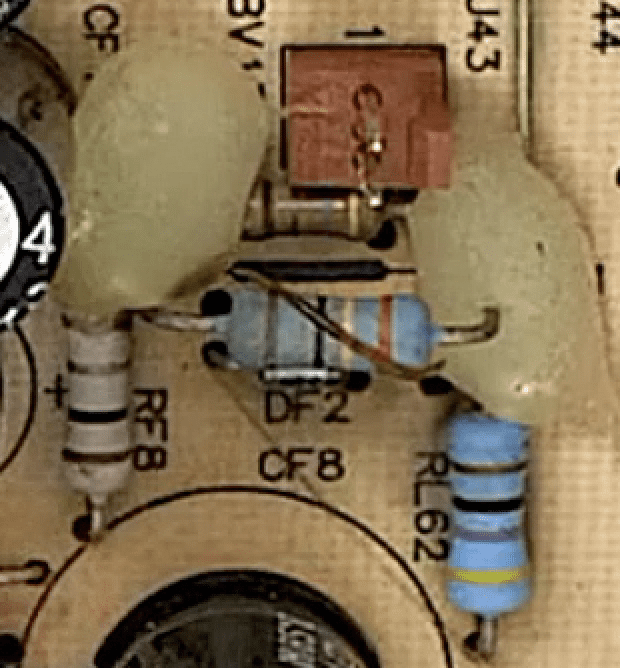

But can you show me where in your photos RL62 is located? I Googled up other CC analog board photos but can't seem to find it inside the shielded cage. (And I don't have my CC open in front of me to check.)
And when you said RL62 began smoking, that your new, metal-film replacement of the same wattage rating as the stock resistor, right?

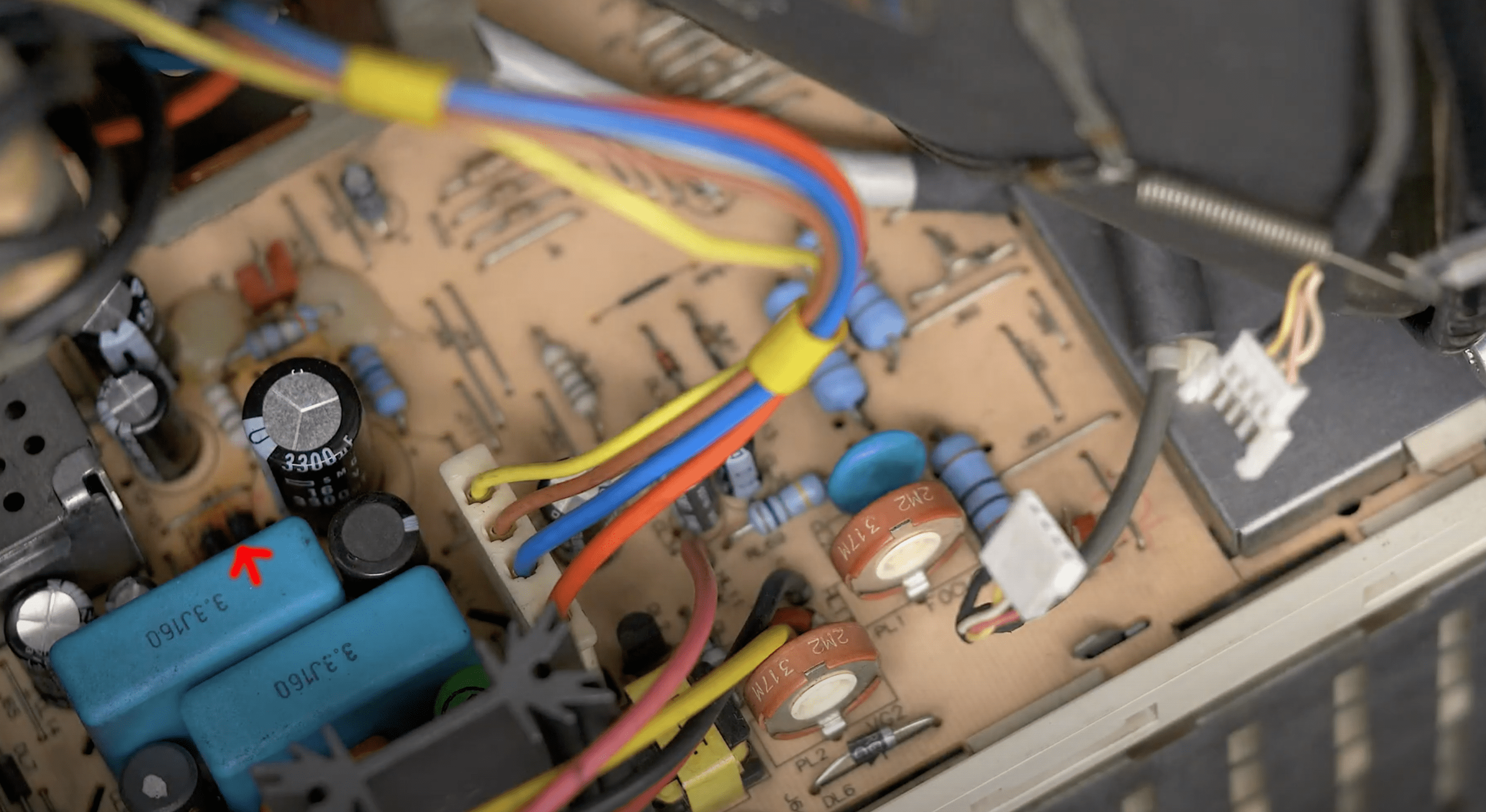

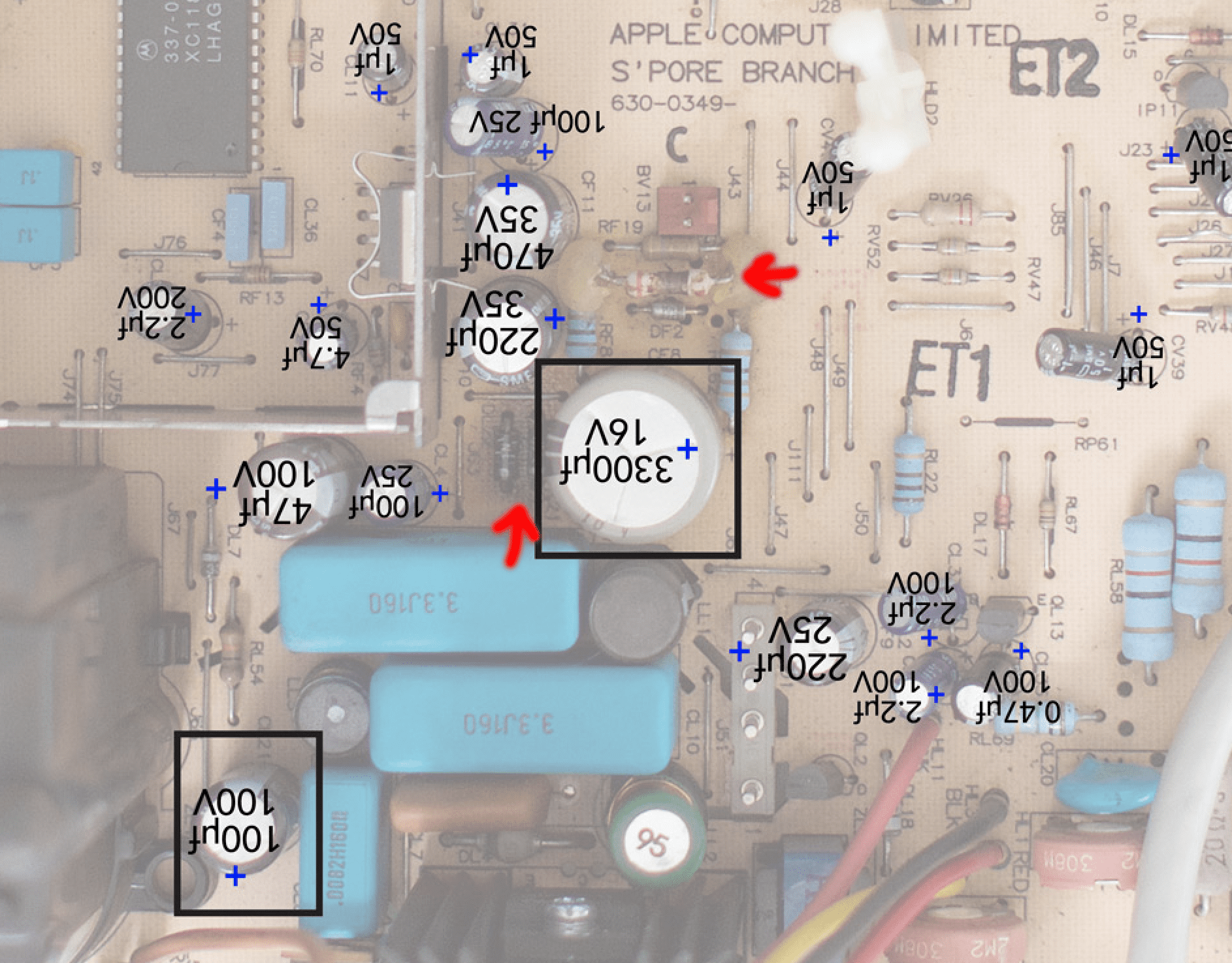

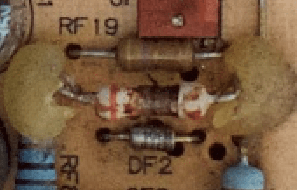

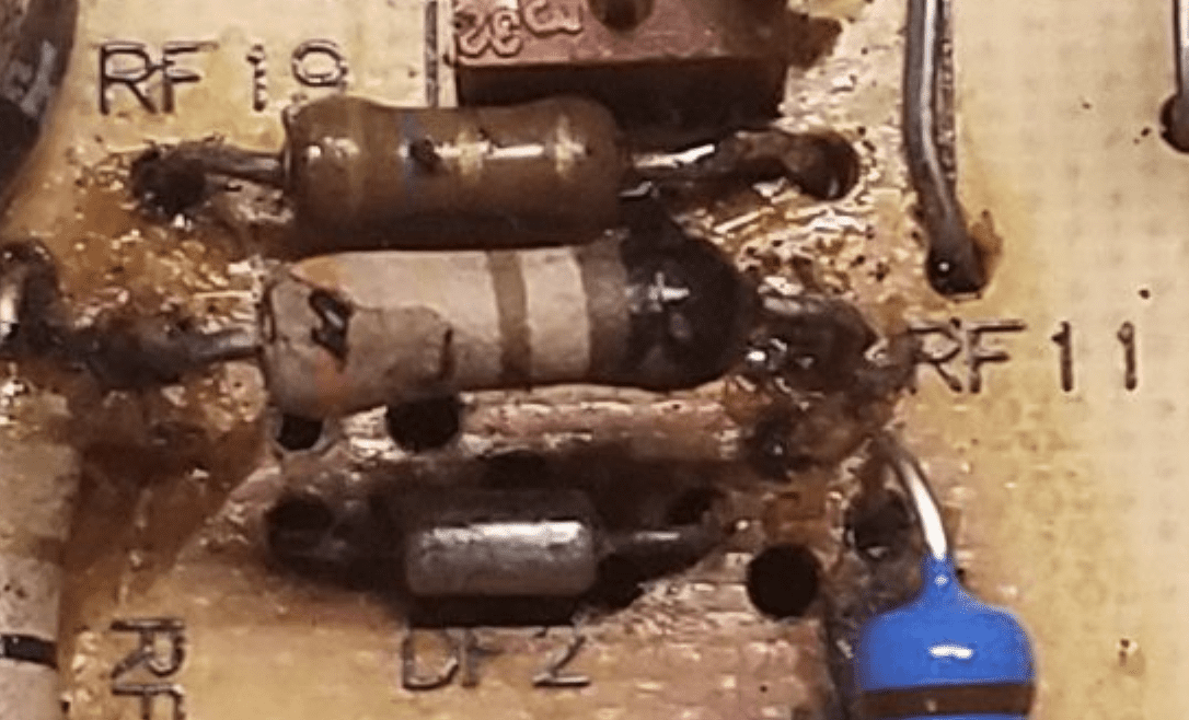

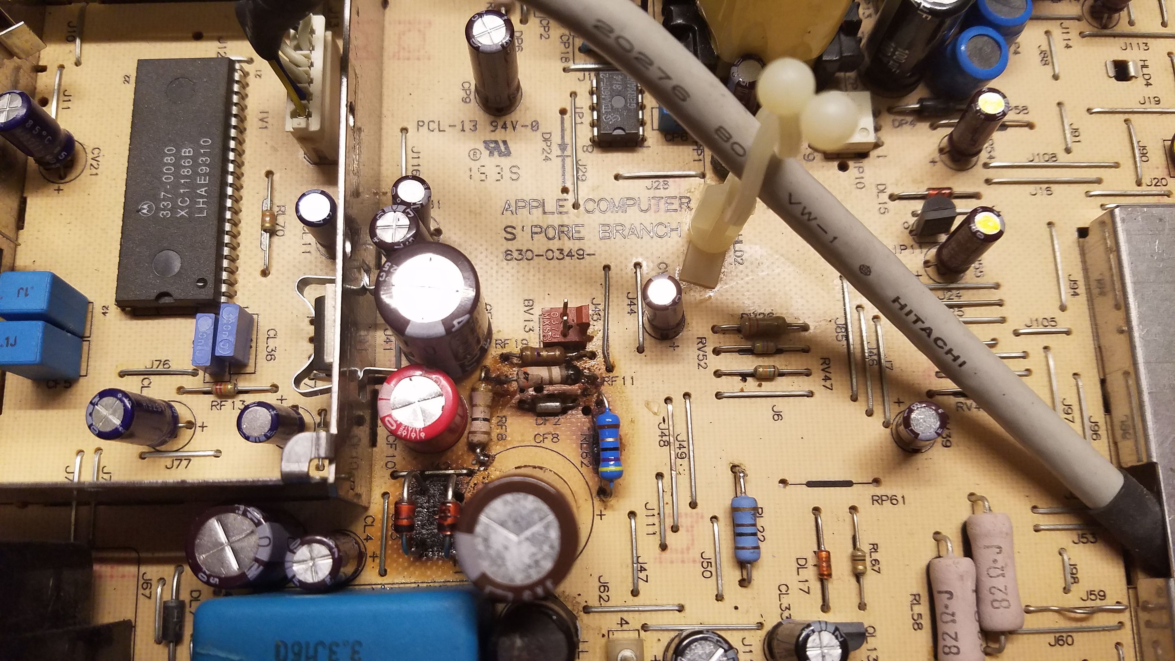

The only scorched area on my CC's analog board is the PCB under these two diodes...
Those same diodes also charred the PCB underneath in this photo by @Branchus ...
And the resistor I marked with a red arrow in his photo also seems to have overheated.

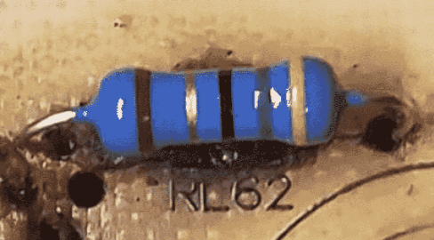

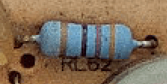

This was my RL62 before it went up in smoke. The four that replaced it are still holding up:
Thank you!
Very interesting that your blue, 1W-rated replacement also burned. So by saying "4" you mean you have the equivalent of a 4W resistor in there now?

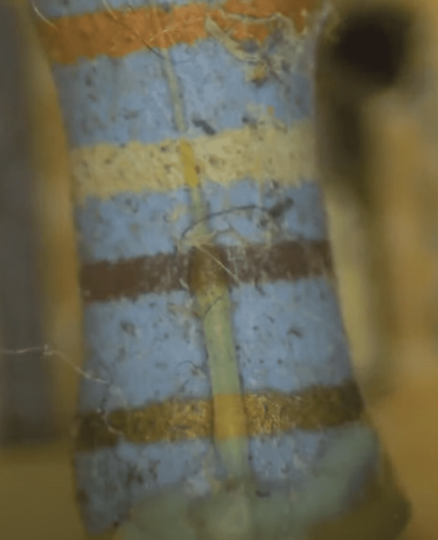

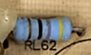

Just wanted to add further clarification to this thread, since some questions in the opening post were never answered, and people finding this thread over time may have the same questions. Yes, RL62 is 47Ω. But tolerance seems to vary.
In your photo, the stripes, from right to left, look like: YELLOW, GRAY, BLACK, GOLD, BROWN
But "GRAY" can't be right because in photos of my own board and that from Bruce, we see that "gray" stripe is in fact "purple," which means it is a 47Ω resistor. But even if GRAY was right on your board, that would make it 48Ω, which is only 1Ω higher than the resistor on my board and that of Bruce.
Even so, your RL62 has 5 stripes which means it is a 47Ω 1% resistor (assuming that GRAY looking stripe to be PURPLE), but the resistors from my board and that of Bruce have a 5% tolerance as per the fact there are 4 stripes and the 4th is gold.
It's hard to find 1% tolerance high wattage resistors, but I think 5% should be fine, in which case, this 3W resistor might be a suitable replacement, for people who don't want to solder 4pcs of a 1W 47Ω in there:

The original RL62 on my board was burned beyond recognition, so I replaced it with this (as pictured), then later four of them:
I got that p/n from my order history, so I'll have to find the bag to confirm the stripe colors.

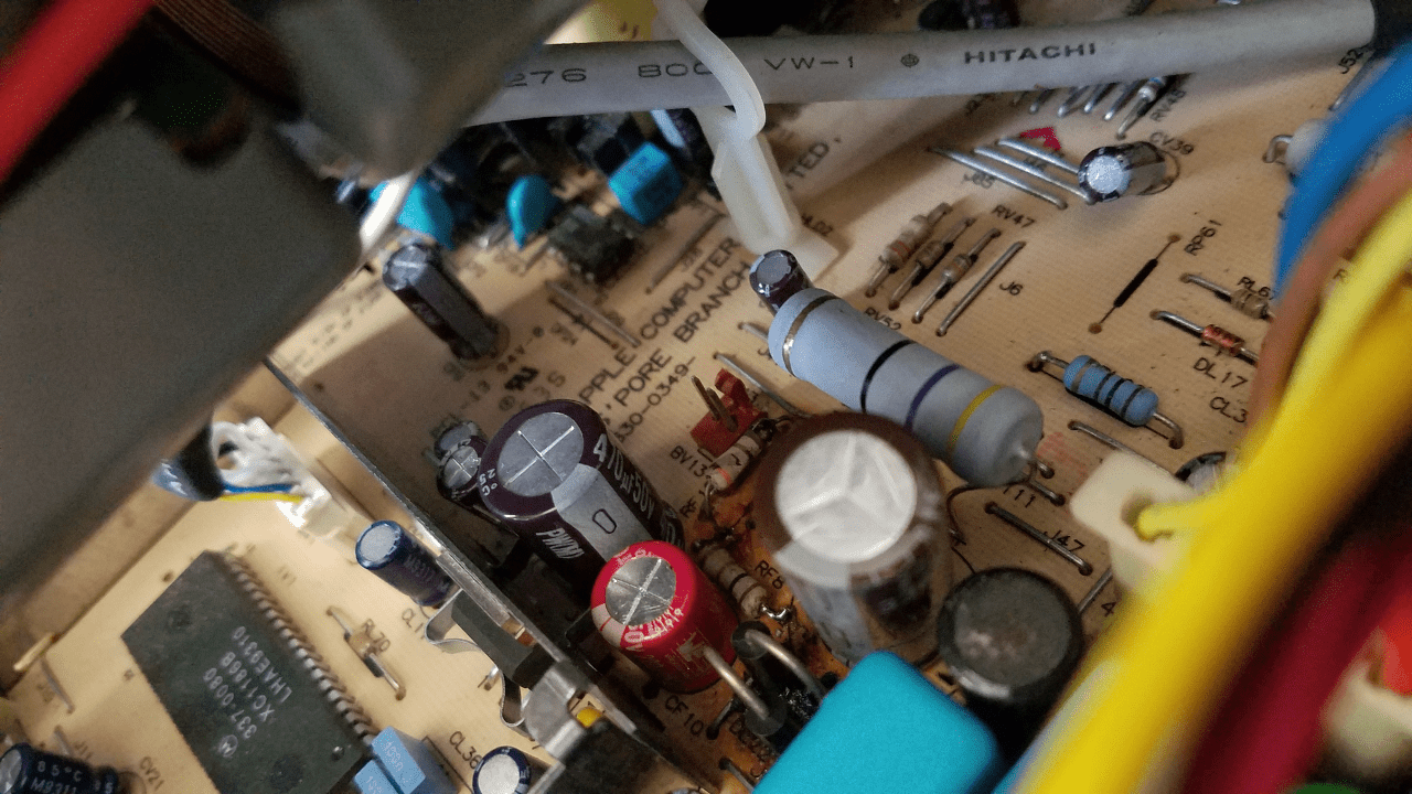

I later swapped in this 5W resistor: https://www.amazon.com/dp/B0BN85F42S
and replaced the two Zeners with one of these 5W parts (1N5355): https://www.amazon.com/dp/B09NSQ3PD2
Both replacements are holding up well.

I assume you swapped out your burned RF11 as well, because it looks quite burned indeed...
On my board it looks like this...
Looks like RED, YEL, BLK, BRN, but BRN must be GOLD. But RED, YEL, BLK, GLD = 24Ω, which can't be right.
If we say it is ORG, YEL, BLK, GLD, that is only 34Ω, which can't be right.
ORG, WHT, BLK, GLD = 39Ω, which can't be right
ORG, YEL, BRN, GLD = 340Ω, which could be right.
ORG, WHT, BRN, GLD = 390Ω, which sounds right based on what I found below.
On this video by @Branchus , Bruce says it is 390Ω...
But what befuddles me is what looks to be a wire wrapped right across the resistor in my photo above. And I can sort of see that in the photo by @Branchus too, wrapped across the right side leg anyway...
Not sure what that is because I don't have my CC torn apart in front of me.
Anyway, I assume you used a 5W 390Ω replacement for RF11?

Another thing that has me baffled is why there is hot-glue only on that RF11 resistor. There are a number of raised resistors on the board, but they don't have hot glue on them. What is so special about RF11 that necessitated hot glue? Hmmm...
I left RF11 alone for now because it measured 363Ω. The discoloration looks like it may have come from the outside.

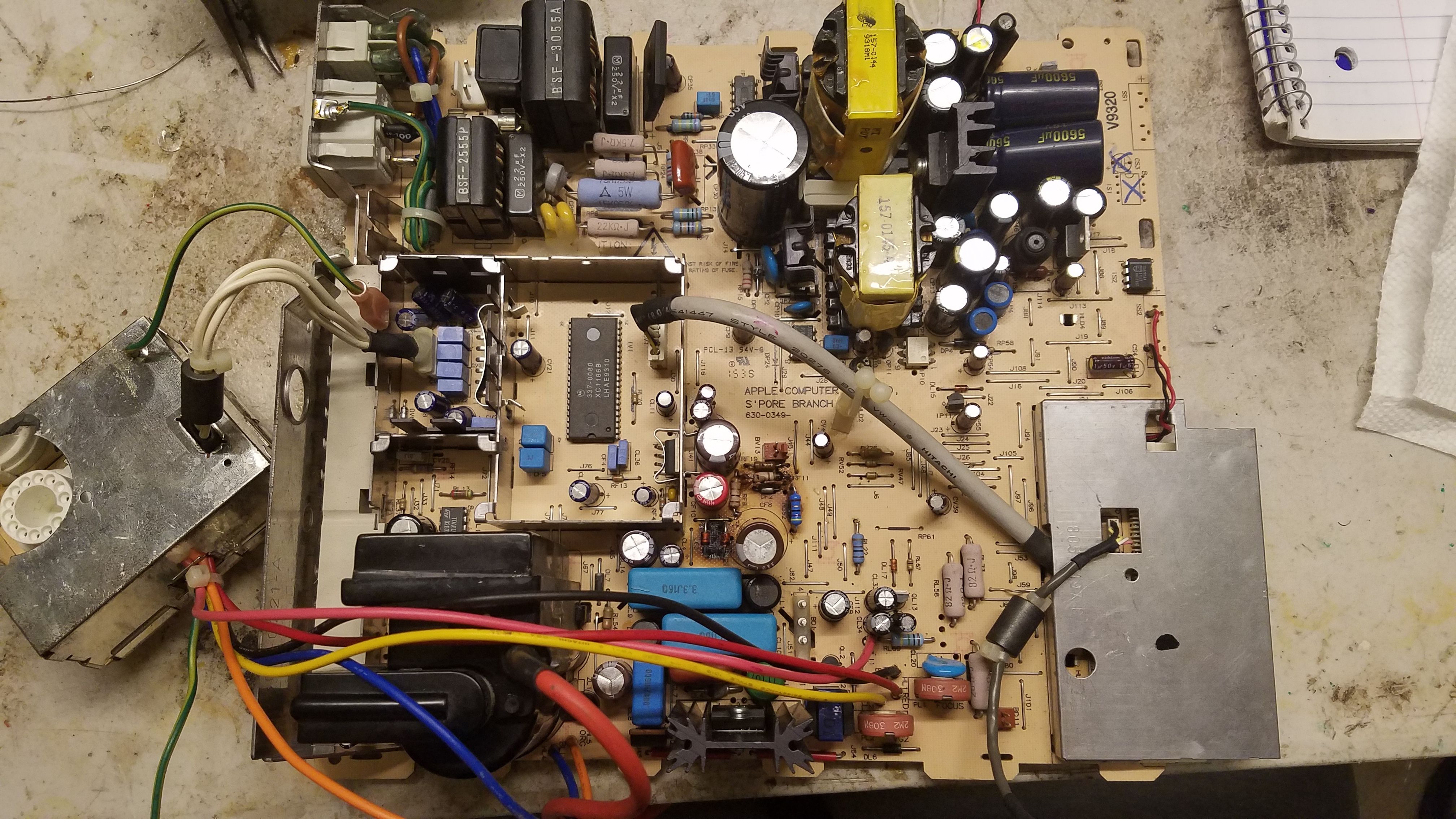

I've picked up another CC AB in better condition. You can see the diodes are in better shape, but still scorching the board:
I can now identify DF2 (1N5237B), which was not present in the parts list I posted above.
This board also has (part of) the "wire" wrapping the resistor you mentioned, but it doesn't seem to be conductive. Maybe it's some remnant of the packaging?

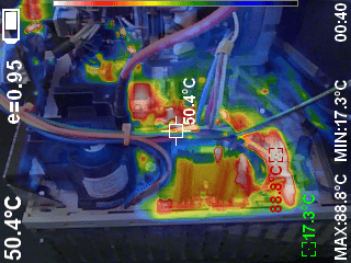

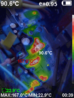

If I had a Flir or similar, it would use my iPhone to check the heat of all the components when the standard VGA mod is running. One can then take an educated guess on which of those hottest components would be even hotter with the 84V VGA mod, and then consider how best to cool them. It could be that a fan mounted on the analog board and blowing across components would be all that is needed.
I do have one of those...
The oversize RL62 isn't too hot, but the stock RL22 at 167C might be an upgrade candidate as well.
Fortunately, these flybacks don't seem to run as hot as the monochrome compacts:
I will probably upgrade the horizontal output heatsinks on both boards whether I attempt 84V or not. Here, it's running 640x480 at 71.9V.
