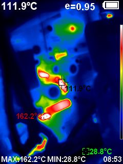

The 1N5237B (DF2) seems to be a 1/2W 8.2V Zener. And from your Flir hot-spot test, I see that DF2 is getting quite hot, along with RF11.
Also is interesting to see that your massive 5W RL62 replacement still rises to 90.6°C. I agree that RL22 (100Ω) should be swapped out with a 5W and raised up on its legs if it is really 167°C. Yikes!
I’d be extremely cautious at taking the flir values as absolute ones. Those cameras work magic, but my professional experience is telling me that there are so many variables affecting each reading… Anyhow, surely they highlight extremely high temperature for the hot components, the charred board speaks clearly (mine, too, I also have raised them for allowing some more venting… Or maybe flush mounting allows the board to act a a big heat sink?).
A type-K temperature sensor attached to a multi meter would be able to verify the temperature measurements made by the Flir. The metal tip on the wire of the temperature sensor with need to be strapped onto the resistor using a wire tie.
Although circuit boards are used as heatsinks all the time, that’s only true in the case of surface mount components which directly solder onto large areas of copper. In the case of this analog board though, the components are merely resting on the circuit board where there is no copper, and that area winds up scorched or even burned with a partial hole in it.
The best “heat sink“ for those resistors is a physically larger resistor that stood up on its legs for better airflow around it.

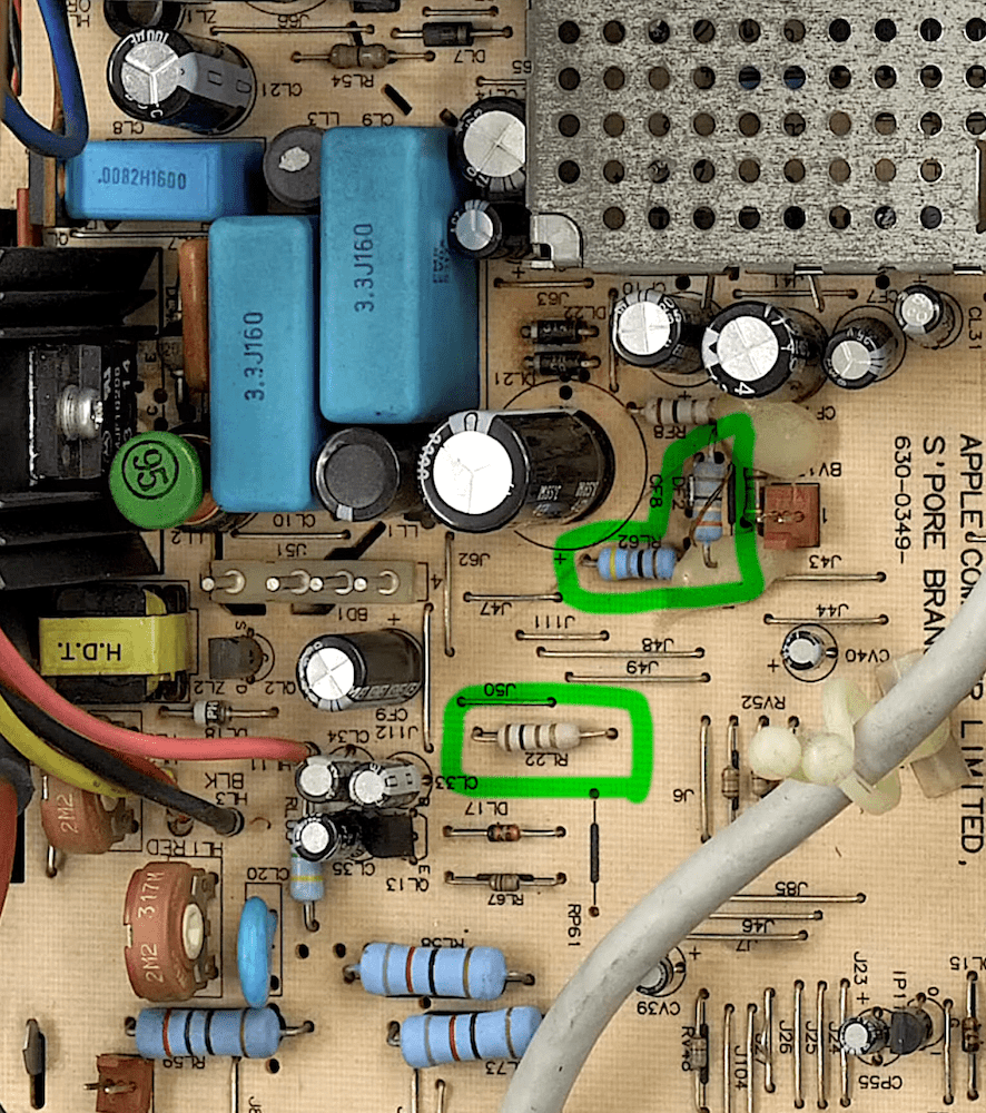

For CC owners who want to upgrade their own Analog Boards...
Replacement Parts List
  • RL62: 47Ω 5W 5% Axial Metal Oxide Resistor — DigiKey | Mouser
  • DL21/22: Remove 2 stock parts and replace with 1pc of 1N5355B 5W 18V Zener — DigiKey | Mouser
  • RL22: 100Ω 5W 5% Axial Metal Oxide Resistor — DigiKey | Mouser
  • RF11: 390Ω 5W 5% Axial Metal Oxide Resistor — DigiKey | Mouser

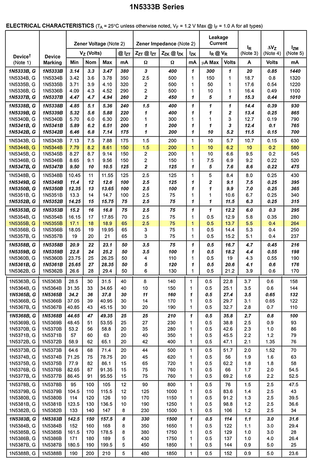

  • DF2: 8.2V Zener (stock part: 500mW 1N5237BZener, Izt=20mA). Consider these two choices:
    • 1.3W (Izt=25mA): BZV85-C8V2,113 — DigiKey | Mouser (I did not buy this one)
    • 5W (Izt=150mA): 1N5344B-TP — DigiKey | Mouser (I later bought this one)
All of these parts get hot, so they should be stood up on their legs with the body rising above the PCB (not in contact with the PCB), for better airflow and cooling.
If this ends up being a problem, there's also the 1N5345B (8.7V@150mA). I'll order some just in case.
Also, there are indeed two DL21/DL22 Zeners in the photo I uploaded, but I had removed one and can confirm this has no effect on the picture.
There's no harm in using two if you'd like.

The 1N5344B works well for DF2, no picture adjustments needed.
I've used the full lead length and stood it up off the board.
Shown here, at 111.9°C:

Just to confirm, how long did you have your CC switch on before you took the Flir temperature measurements? And were you running anything processor intensive or just letting it sit idle?
After three hours of idling at the desktop with the cover off, 109°C was the highest I measured today.
