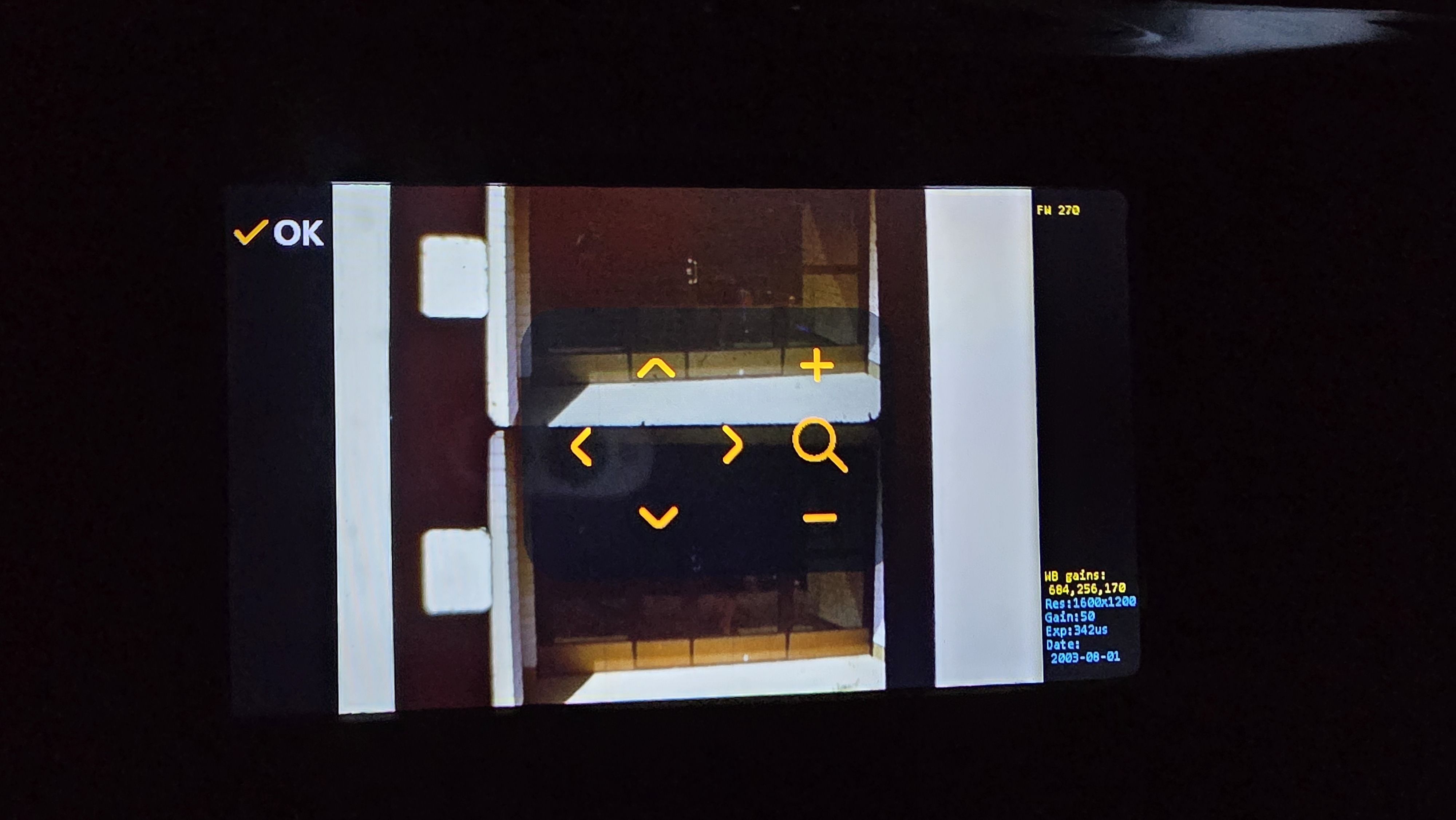

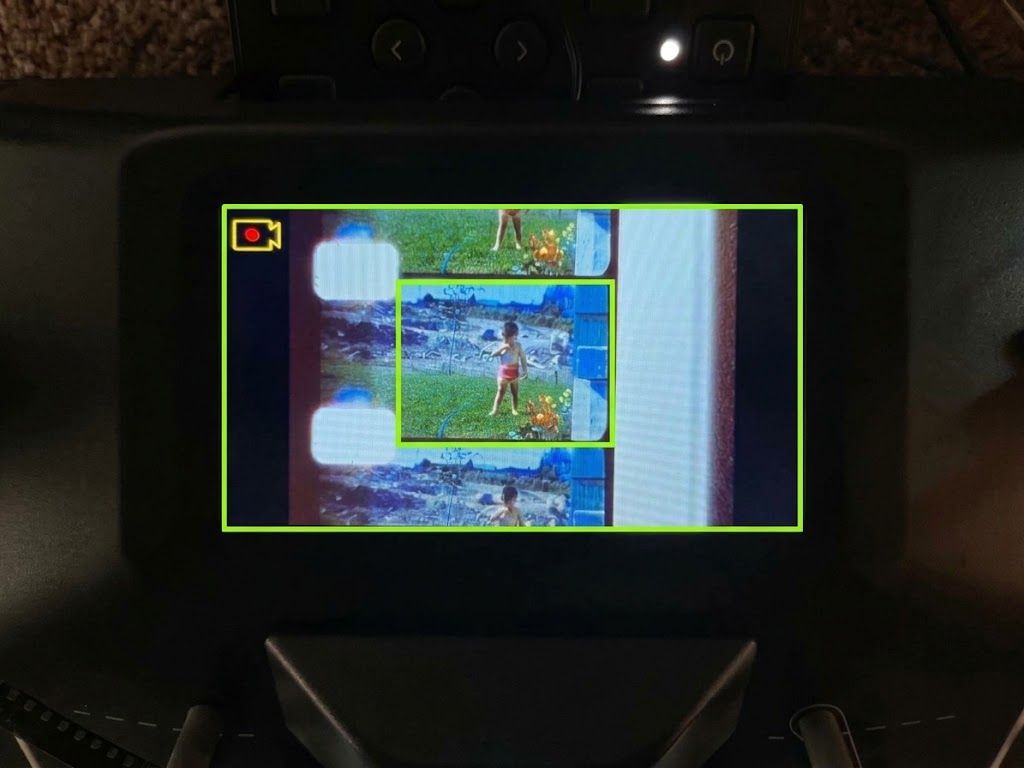

I tried on both 8mm and Super, and the adjustments have no effect. The arrows on screen blink, but no changes occur. It's like it's sitting and locked at full zoom out.

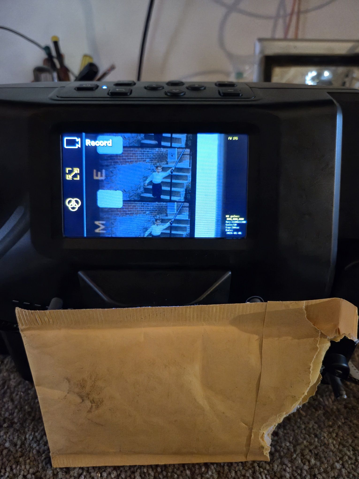

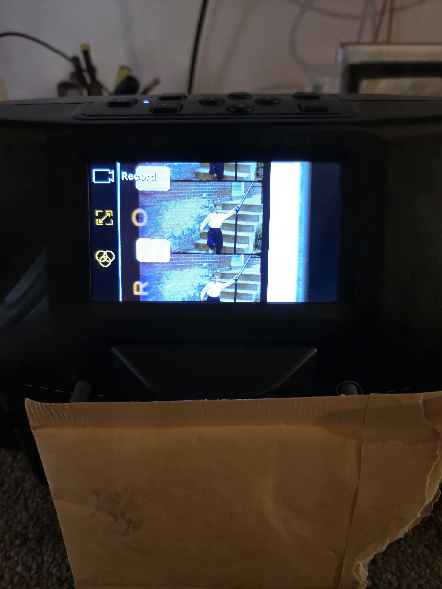

Here is what I'm getting. I highlighted in green the LCD screen and the scan frame I'm getting. Assuming that there is no mechanical zoom, doesn't that mean that the quarter of the image that actually contains the pictures is being blown up with software and the other **3/4 of the CMOS sensor is not being used?
**EDIT: giving this more thought, the fact that these old frames are 4X3 and camera imagers are 16X9, these could never use 100 percent of the CMOS surface, so I'm going to revise this to 1/3 of the imager used..
SECOND EDIT: The build date of the camera module is 7/2025 which means my Reels could have been built even this year. Any possibility I have a version later than D and that the previous owner tried flashing the modified D, lost functionality of the frame and zoom, then tried installing stock D?

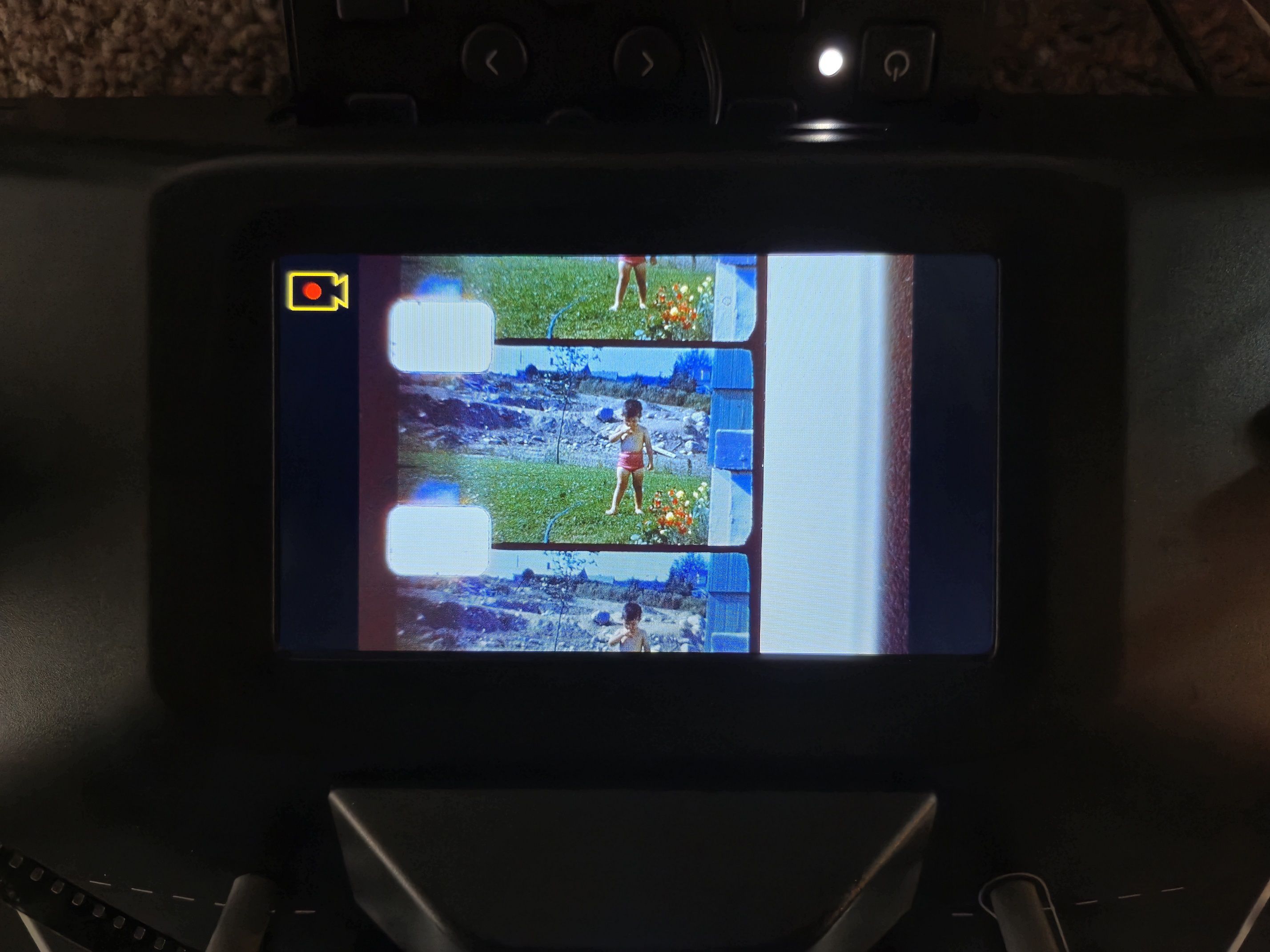

I compared with my own unit: fully zoomed out, mine looks very similar to yours (see attached picture). So your optics are fine, and that is simply the full zoom-out view. Sorry for the confusion earlier!
So the only real problem is that zoom and position don't respond. The buttons clearly work (the arrows blink), and zoom/position are done in software, so I don't think this is hardware. Since it happens on stock firmware too, my guess is a saved setting stuck in a bad state. Settings are stored separately from the firmware and survive reflashing, possibly left there by the previous owner. Could you try Settings → Factory reset, then test zoom and position again? The option is in the stock firmware too.

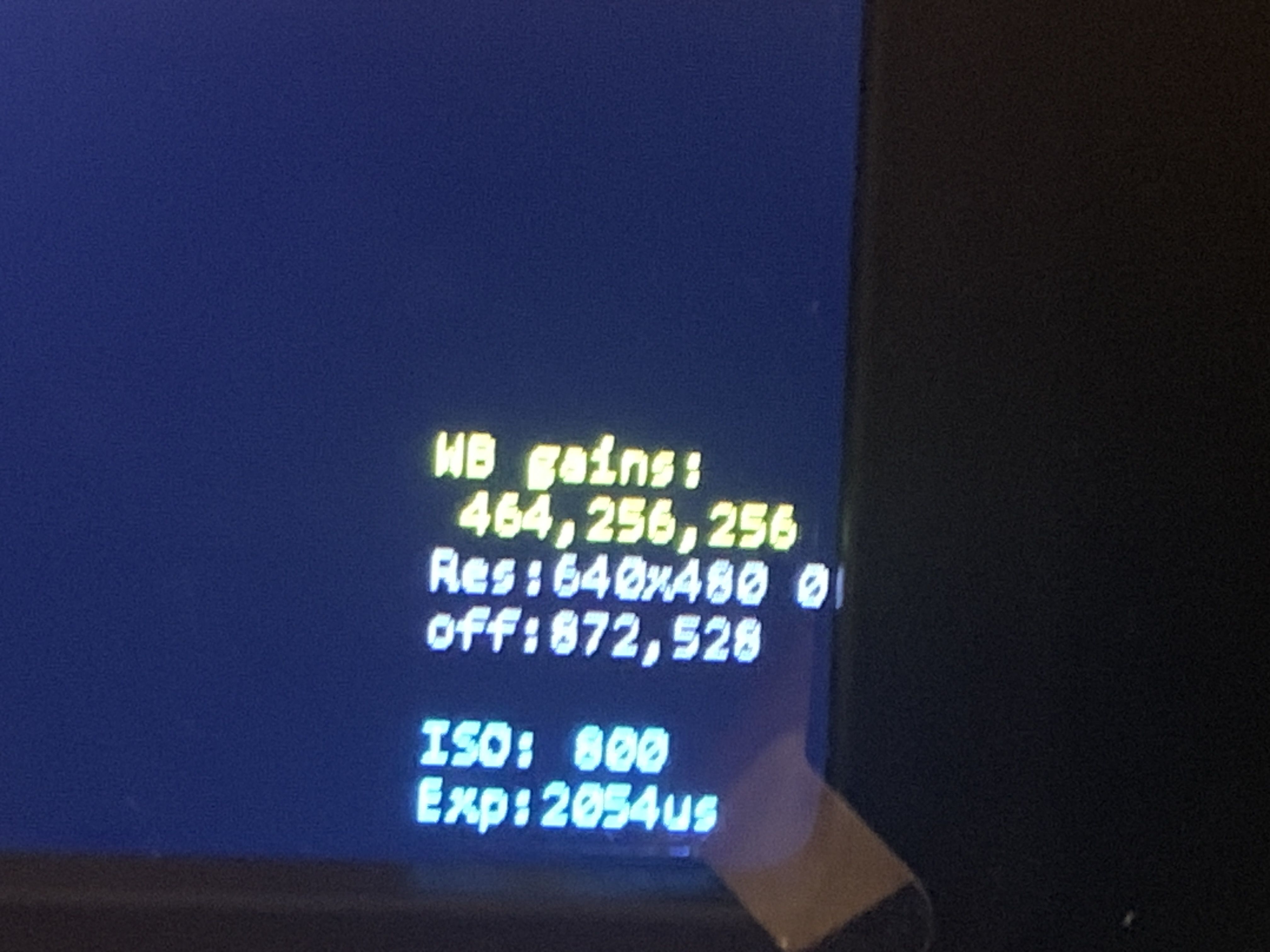

First-time flash, D-type.
I flashed the FW from post #734. The first screen said "Type D - WIP," but everything else looks no different from factory FW: no OSD.
Then I flashed from #731 and the OSD is there.
Same - my reflash also says "Type D- WIP" but it's otherwise identical to the original firmware.
I just tried the file in #731 and it flashed and now I have the OSD. But I took a second scan and it's a lot darker than my first try on the same film. I put the exposure up as far as it would go without blooming but it's dull and lifeless where the first scan on the factory firm was bright and colorful. Odd.

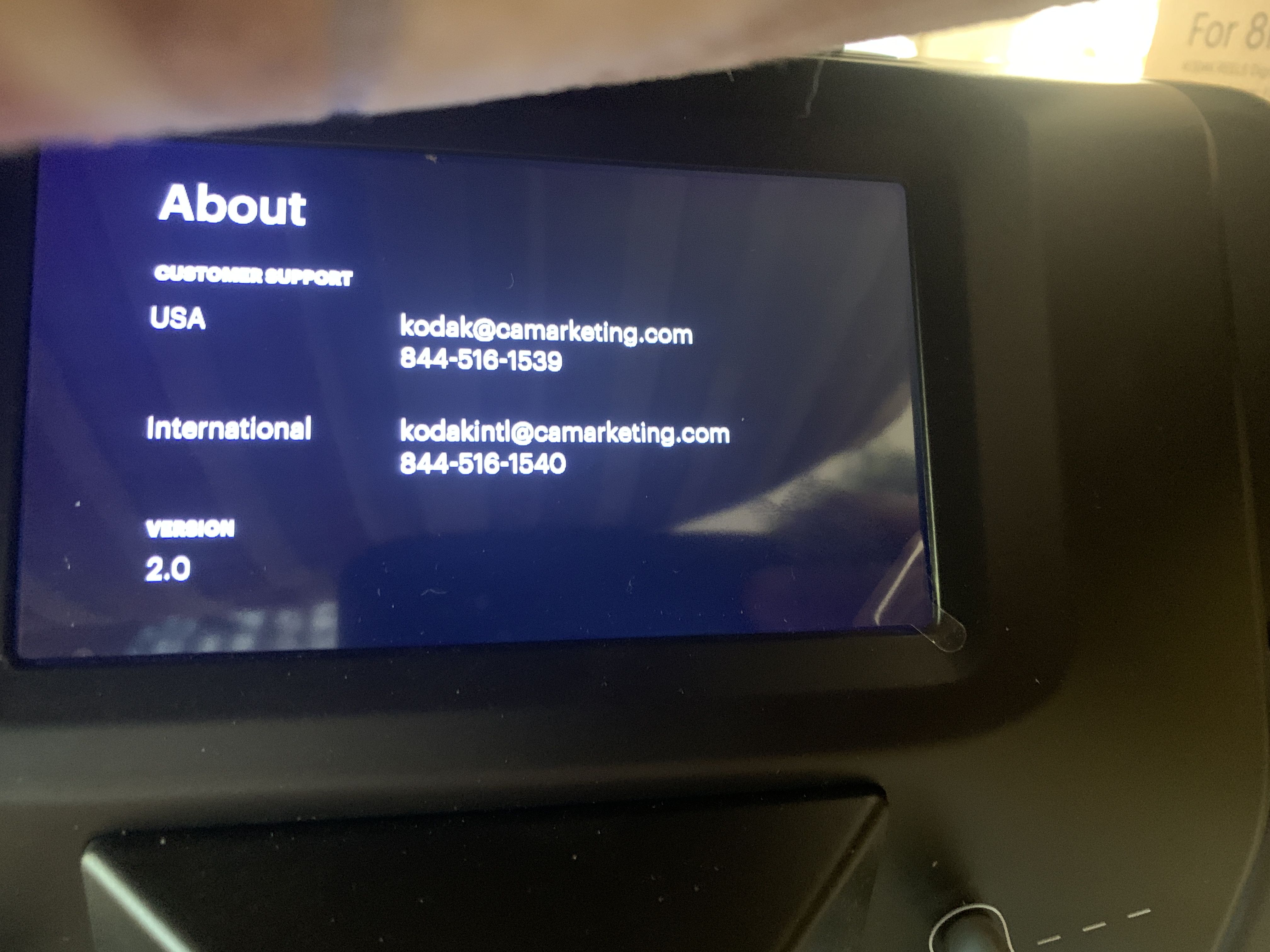

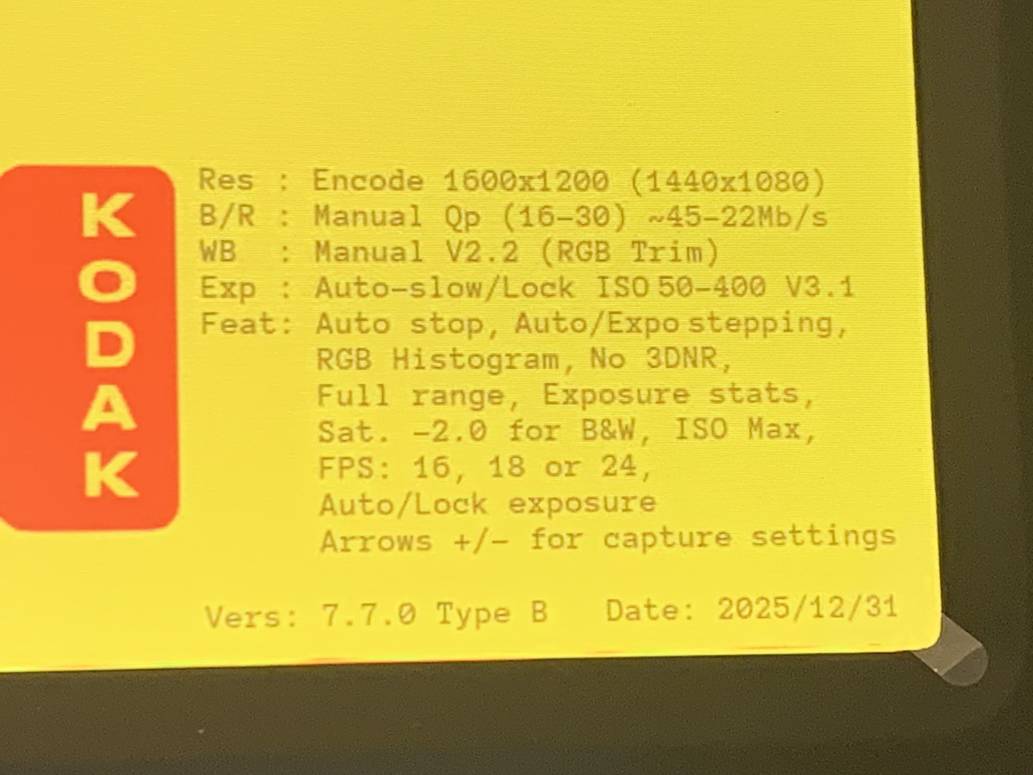

FIRST TOPIC - Response to Question on BIOS
The original version said 2.0. I am attaching a photo. I loaded the version "B" from the post 143. The screen and the buttons worked. I am attaching a photo of the startup screen.
What Worked:
1. Screen appeared to work.
2. Buttons appeared to work.
3. Conversion recorded with higher clarity that the off-the-shelf BIOS.
What Did Not Work:
1. If you clicked the "Play" button, it would freeze up.
2. It did not save the movie when I had a 64 Gig SD card in. It did save when I had an 8 Gig SD Card in.
Original BIOS allowed me to save to 64 Gig SD. Is there a max file file size it will support for the SD Card under the modified BIOS?

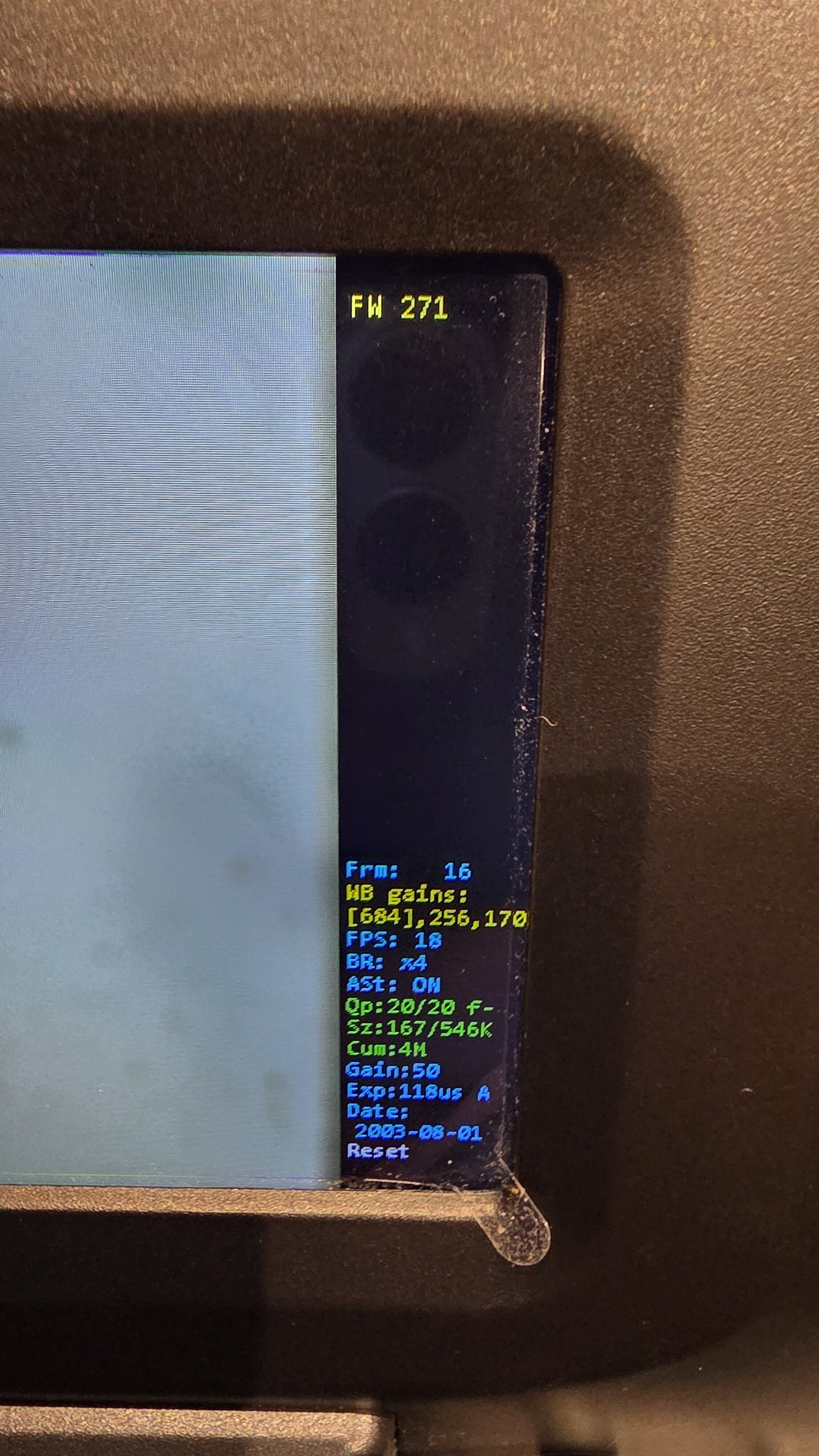

Thanks for reporting!
On my unit, "FW 270" in yellow at the top right is visible all the time, so if nothing appeared at all, I'd like to understand why. Could you try once more?
  1. Flash FW 270 again.
  2. Power the unit off and on once after the flash.
  3. Check whether anything appears on the start screen, then in the live preview, and then while recording.
A photo of the screen in preview would help a lot. If 270 still shows nothing where 265 does, it's a bug in 270 and I'll look into it. 265 is fine to use in the meantime: the freeze fix is the same, and 270 only adds the flicker fix and shorter stall timings.
John
Ok, that's another report on the same topic. Let me share a new build that prints the firmware version also in the splash screen to be 100% sure what happens here!
For the dark colors, could you try Reset in the OSD recording menu? Thinking, is it possible that the WB settings are somehow messed up?

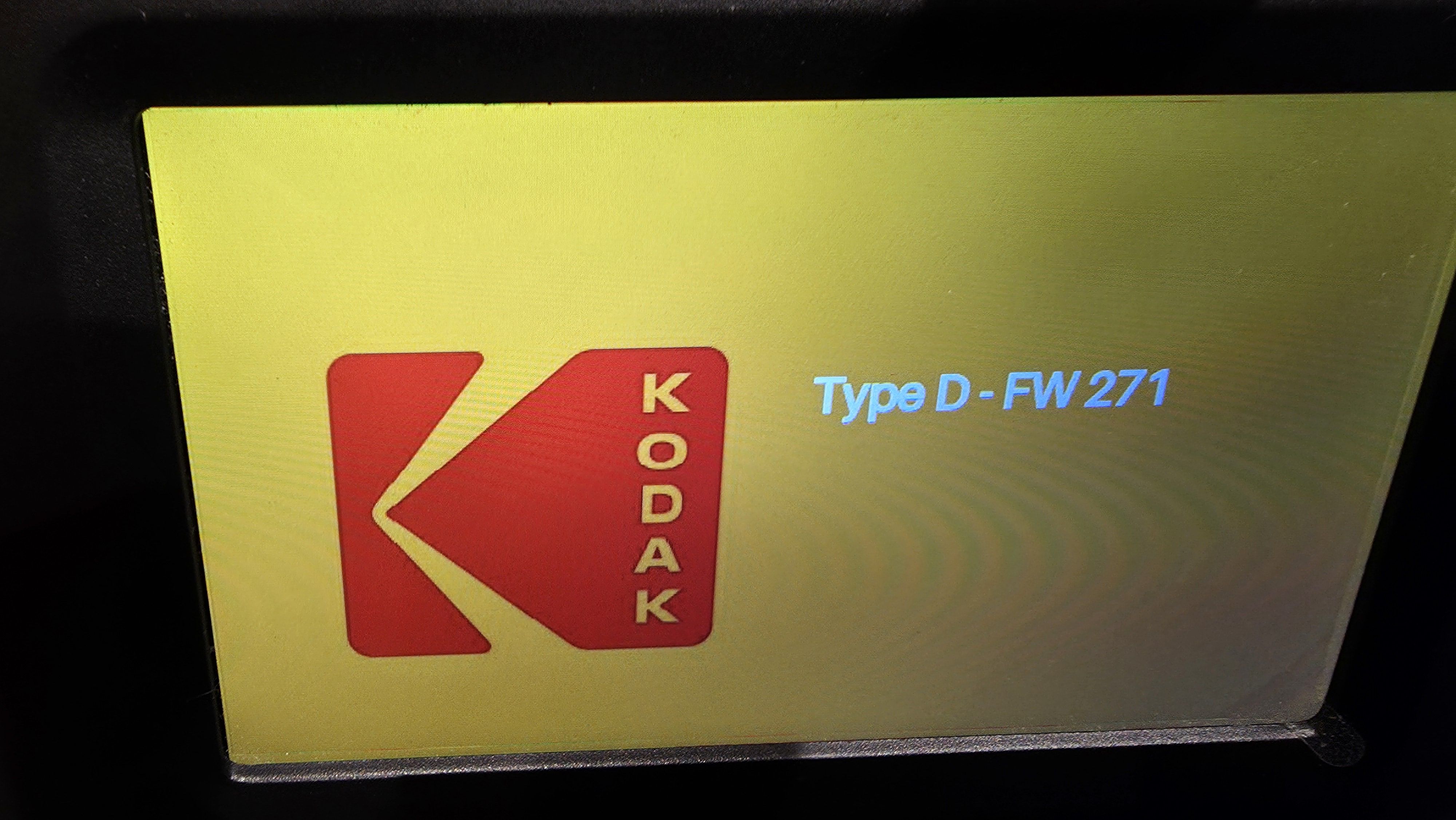

Type D — FW 271: build number on the start-up screen
  • Firmware version added to start-up screen ("Type-D - FW 271")
  • No other changes since the previous build.
@lrdgreen89 @JohnCT Could you try flashing this version and tell me what the start-up screen says, and whether the OSD appears? Attaching reference photos on what I see on my Type D device.

Yes, when I flash with the latest version you posted in #775, I get the OSD and I also now get "FW271" in the upper right side of the screen just like the pic you posted in the same message which says the latest firmware took.
Unfortunately, I also still have the dark scans with the new firmware as I did with the previous D upgrade. I did the factory reset and the previews and scans are still dark.
I then reinstalled the Stock D firmware and the OSD went away as expected, but I was pleased to discover that the scans returned to the bright and colorful scans I was getting before. Attached are the two photos of each firmware. The one on the left is the original stock D firmware and the one on the right is the updated 271. Note that I left my camera on auto iris and it actually brightened the darker of the two scans (you can tell by the manilla envelope I used to block the source LED from my camera being subtly lighter), but you can still see the new firmware makes the scans much darker than the stock firmware does. The darker scans are also color shifted to the blue. When trying to adjust the exposure in the menu with the upgraded D firmware, the whites "bloom". So for now, I'm leaving in the Stock D firmware.
Thanks for sharing the screenshots. Now I see the issue: WB gains are reset to 000,000,000 - which are minimum accepted values for Red, Green and Blue. On my device the defaults are 689,256,218 - More Red compared to Green and Blue, for natural colors on most reels. But good default values could be device specific and the colors on the reel may also affect what's a good setting.
Could you try, while in the recording mode, navigate in the OSD menu to [Reset], press right or '+' and see if you get sensible defaults for WB gains? If not, you can always hand edit them, but it could be bit tedious. Pressing Left/right gives you +16/-16 and +/- for fine-tuning +1/-1. Once you're able to match the WB gains to the defaults, the image brightness should be comparable to the stock firmware.

OK, I reinstalled the latest D firmware (FW271), and I'm still in the same boat - very dark scans (and still no frame or zoom but that's my machine apparently). I'm interested in improving the performance, so I'd love to get an updated firmware to work for me.
In the Capture menu, I navigated to Picture and then clicked on "Reset to Default". Not only was there no change in the picture or the gain settings but I'm not sure the software understood the request because there was no type of acknowledgement that the request was made. When on the Reset function, I tried the OK, tried the right button, right button then OK, etc. I can't find any combination of buttons where the machine didn't ignore the command. Maybe it does but doesn't acknowledge it?
I then tried going to the Settings menu and doing the Factory Reset. That command is followed and I get an on screen acknowledgement that the factory reset was successful, but I'm still sitting on OOO for all three color gains.
You said changing the color gains manually was doable, but I can't see any way of making these changes. If you're saying it's adjustable in that little information box that now appears in the lower right hand side, I don't know how to access it. The red gain has a [ ] around the OOO as if it's selected to be adjusted, but no combinations of buttons I've tried has either changed the value in the brackets or moved the brackets over to the green or blue. There's a "reset" in white at the bottom, but I can't navigate to it.
I don't know if I'm doing something wrong or if there's a deeper issue with my particular machine beyond the lack of frame or zoom adjustments.
John
John
The instructions for the modded firmware say, "The menu only works while recording. In preview the stock firmware owns the buttons, so the mod can't use them there. The easy way: start a short throwaway recording, set everything up, stop, then capture for real. Settings are saved and survive a power cycle.."
Are you perhaps attempting to change things while not in recording mode?
