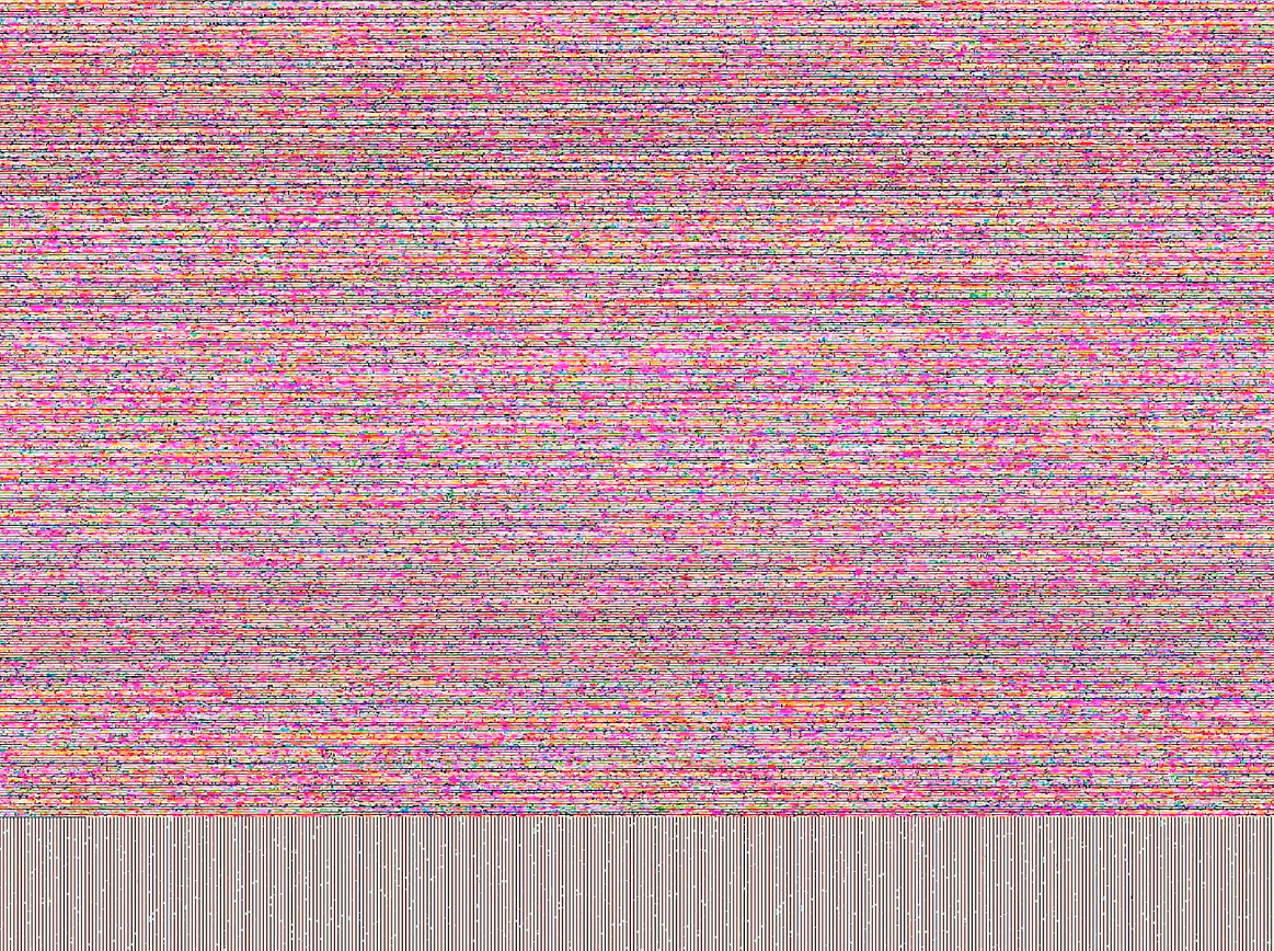

Hi
I have a problem with my scanner
I have a C type with firmware 7.7.1, 32 gb sd card fat32 formatted.
Now it is not possible to get a single scan that is watchable. The image jumps like crazy. On every scan.
See:
This is what it looks like.
Does anyone know if this is software related or mechanical related?

The bottom of the frame seems to jump more than the top which seems mechanical to me... if I'm off base on this, feel free to yell at me.. but any chance you didn't get the film under all four of the locating tabs before closing the door? I literally use my Opti-Visors when threading the film.

I have the same experience, and in my opinion, the issue lies with the film itself. It’s too dry and slightly shrunken. It skips because the mechanism can’t handle it. I’ve mentioned this here before. Try carefully opening the film gate door slightly while scanning. If the skipping improves, then the problem is the film and the excessive pressure.
I tried placing a film reel—wrapped in a paper towel—in the vegetable drawer of my refrigerator for 24 hours. The film absorbed some moisture, and the scanning process went much better.
I also removed one spring from the gate door—specifically on the left side, where the start of the film is inserted (the one closer to you). This reduced the excessive pressure on the film, giving the mechanism more power to advance it. That helped as well.
The truth is that the dampening didn't have much of an effect on the color film, but the removal of the spring did.

This issue seen here has been widely discussed in the thread(s) previously.
To excerpt from the 0dan0 firmware user guide (for A,B,C units)...
Frame Instability (aka Jitter). In some situations, captured files show a distorted or warped image (compressed or expanded at the top or bottom of the frame) when compared to adjacent frames (see bottom of frame in this sample footage). This relates to the film being in motion as the imager is scanning the film frame over the course of time. This issue can last the entire duration of the capture, or can increase/decrease in severity over time. Re-scanning those segments often results in no issue. This issue continues to be evaluated and discussed. Reference posts #390, #471 and #846 and many others.
I'll add that there hasn't been a definitive solution to this problem yet, although as the recent follow-ups have suggested, lessening the tension may have an impact.
Also, I believe this issue may manifest more frequently (or more noticeably) with Super8 footage, and also for those who have done lens modification (both due to using the edges of the sensor, whereas smaller 8mm footage and/or the stock lens uses more of the center of the sensor.

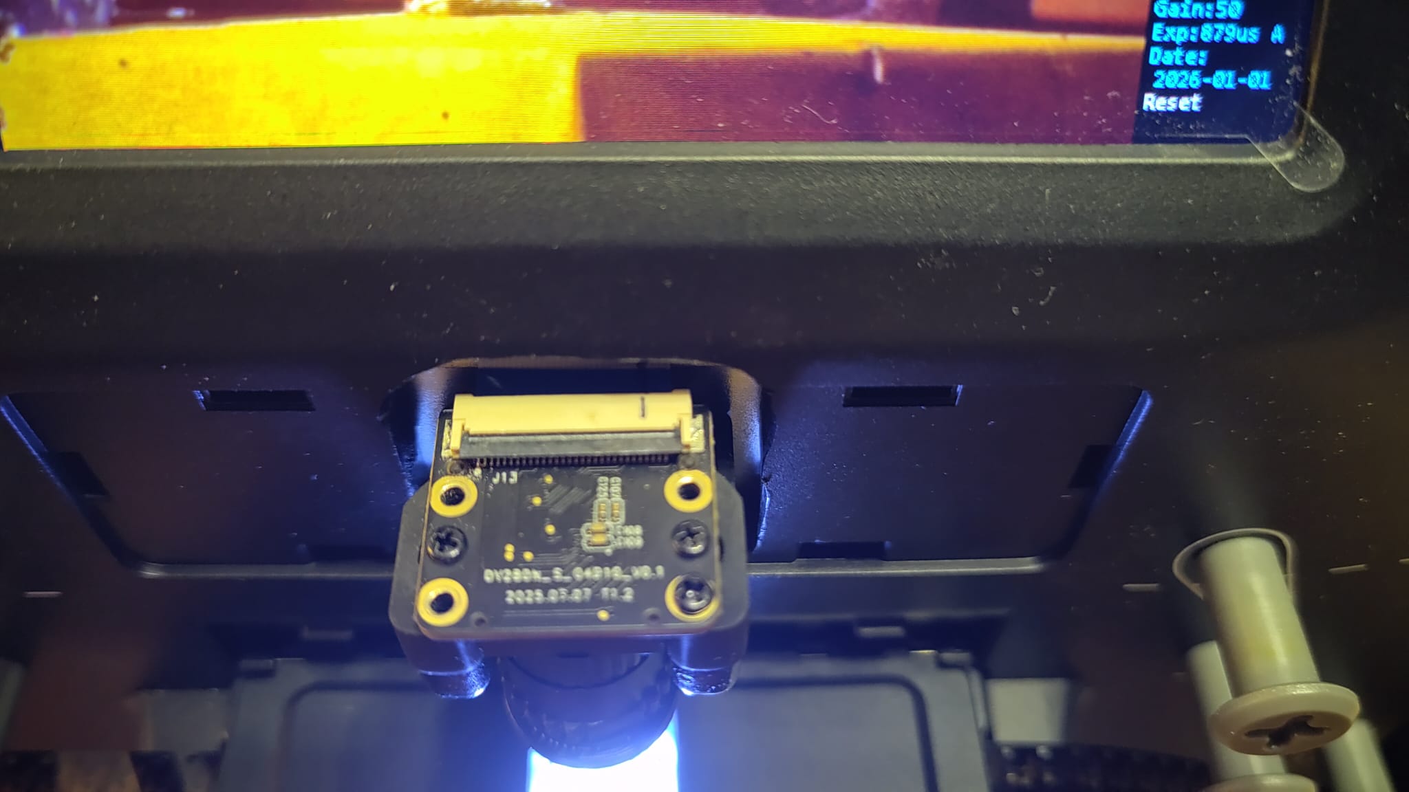

I hardware modded a Type D.
Balto1986 and me made the observation that now the max zoom out still is too far in, resulting in a crop.
I scaled Deano's 7mm to 8mm and 9mm spacers but it won't get sharp on the D hardware, it's too far out already.
A thing to remember I struggled to put in the thread prolongation and I might have inserted it skewed. I assumed it's due to applying too much heat during removal of the lens, but Balto1986 also had shredding when forcing the adapter all the way in. So maybe the new thread has a different pitch? My stock lens has no markings, so I couldn't tell. I melted it's thread so I can't try it in the adapter.
Aside the crop, I dislike the most that the best area I can navigate to, still has film wrap on the top (maybe indicating a skewed lens). Not being able to use my higher spacers (I might retry with 7.2 mm 7.4 mm and such in the future) I just asymmetrically put some tape at my 7 mm spacer, just went with one screw rather then all four and then by forcefully pulling on the assembly I can get the picture frame to be all film (still cropped of course).
It's not perfect, but now good enough for me to start scanning again.
In case you are interested in the taller spacers I included them as download.
(PS the "not starting" issue stopped after dropping the unit accidentally once and spilling all the guts and reassembling it. Pull down resistors still all in place.)

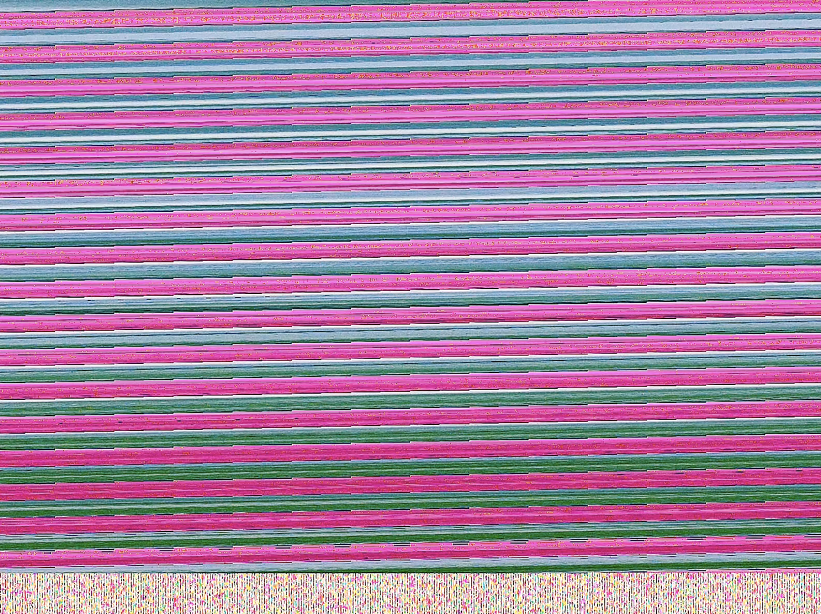

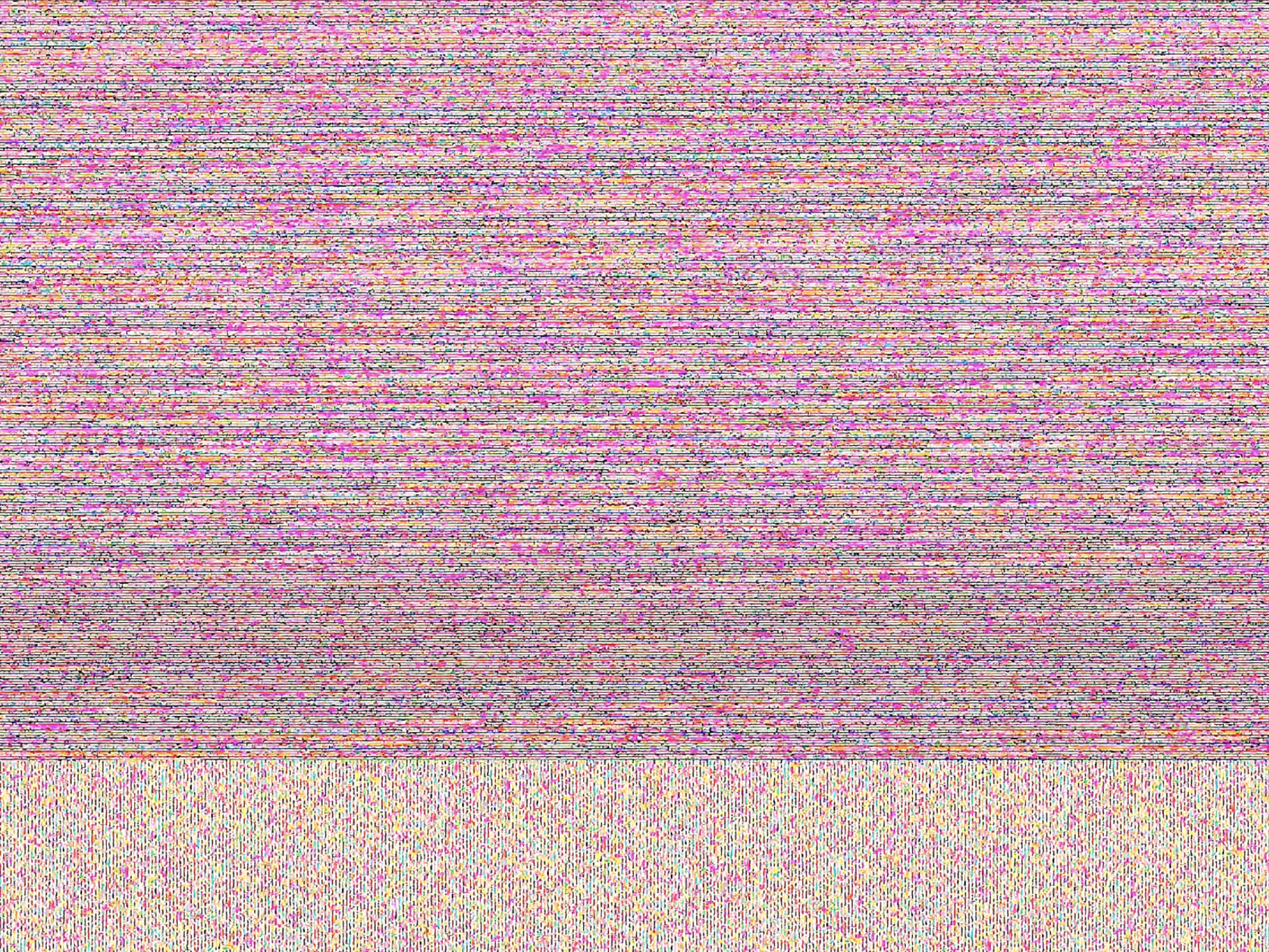

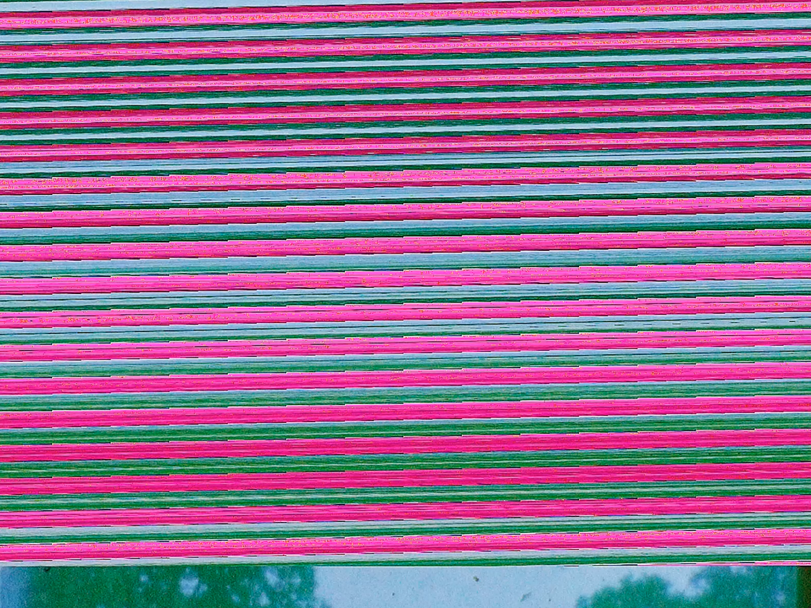

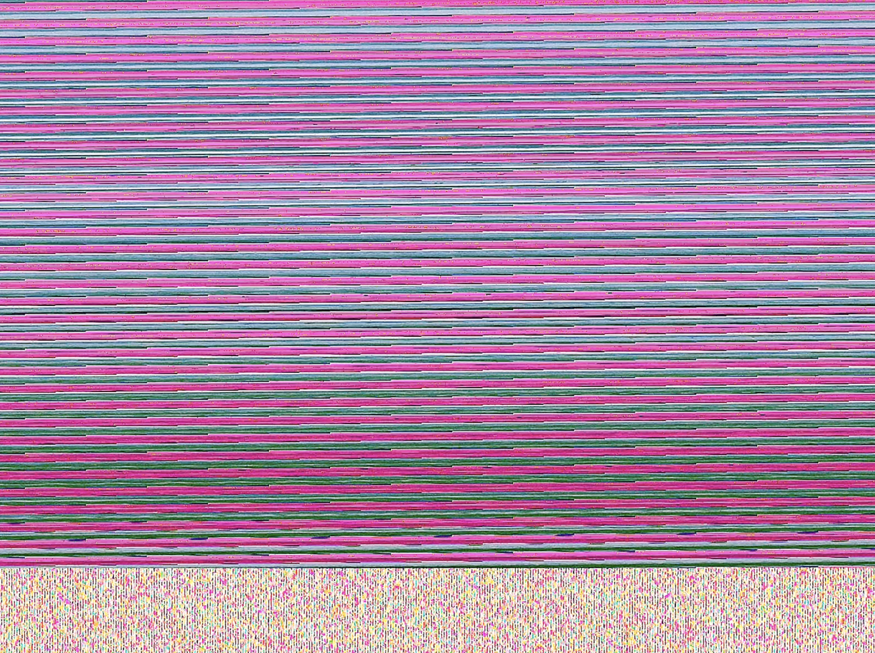

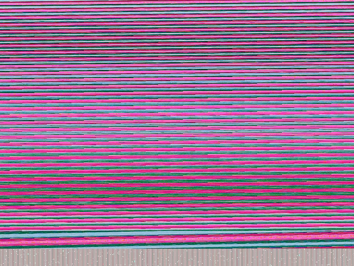

I've completed both mods—Deano's lens mod and melw 's FW—on my Type D unit. I'm so grateful to melw for the Type-D FW work, and to 0dan0, Deano, and everyone who's contributed.
I have a couple of issues, and report.
#1. The farthest zoom-out settings give colored bars. (I'm calling the furthest-out setting Zoom 1.) Attached are the three furthest-out zoom settings for FW p695 and FW 272 (with film loaded). The next setting (Zoom 4) is normal, for both FW.
#2. I tried flashing 0dan0's D-Type stock FW to see if this still happened, but it wouldn't flash. It powered on with whatever custom FW I had last flashed.
I want to achieve full zoom-out if possible, because there are images between the sprocket holes I want to capture, and the 12mm lens is excluding some of it already.
