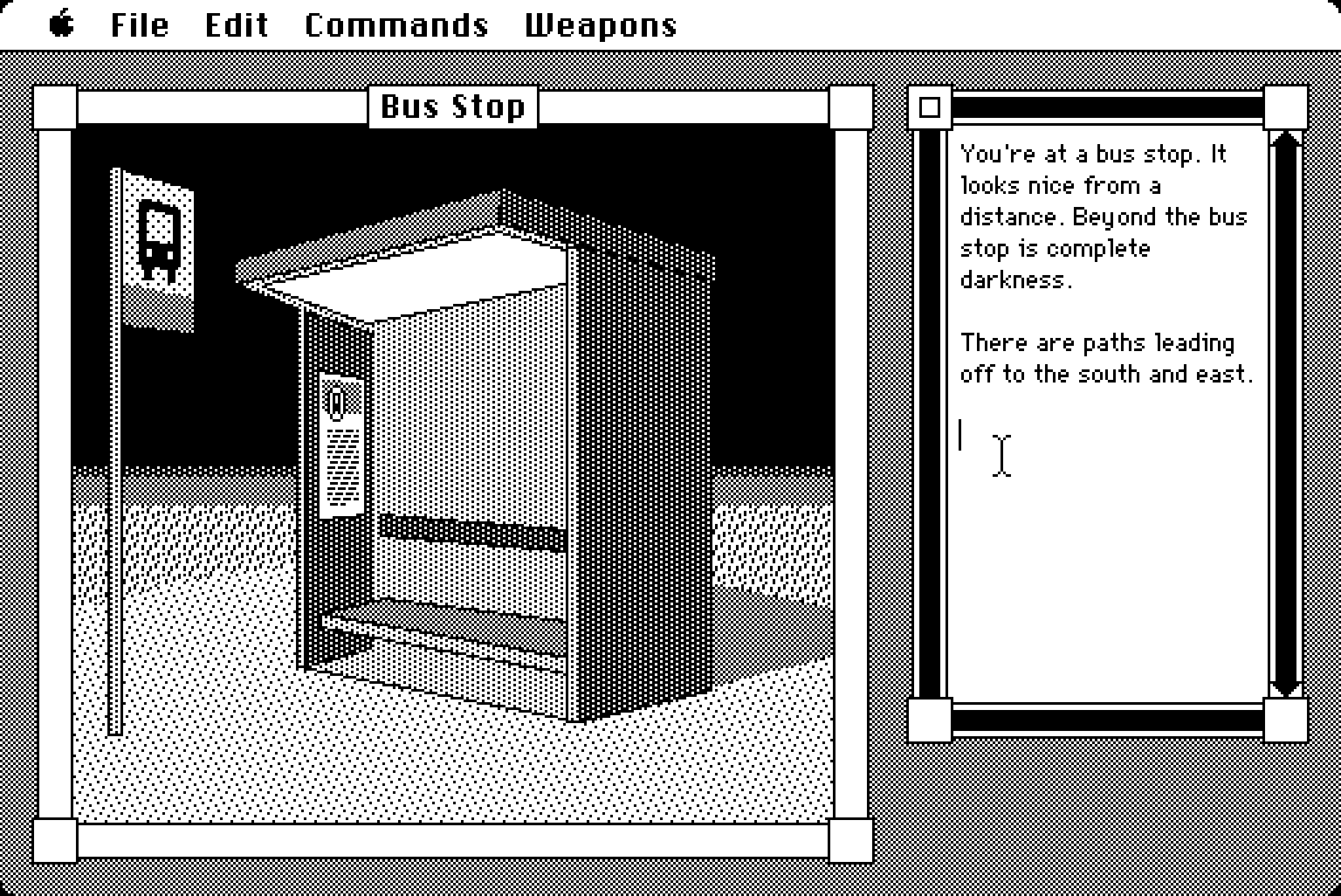

New World Builder game
Reactions: europlus

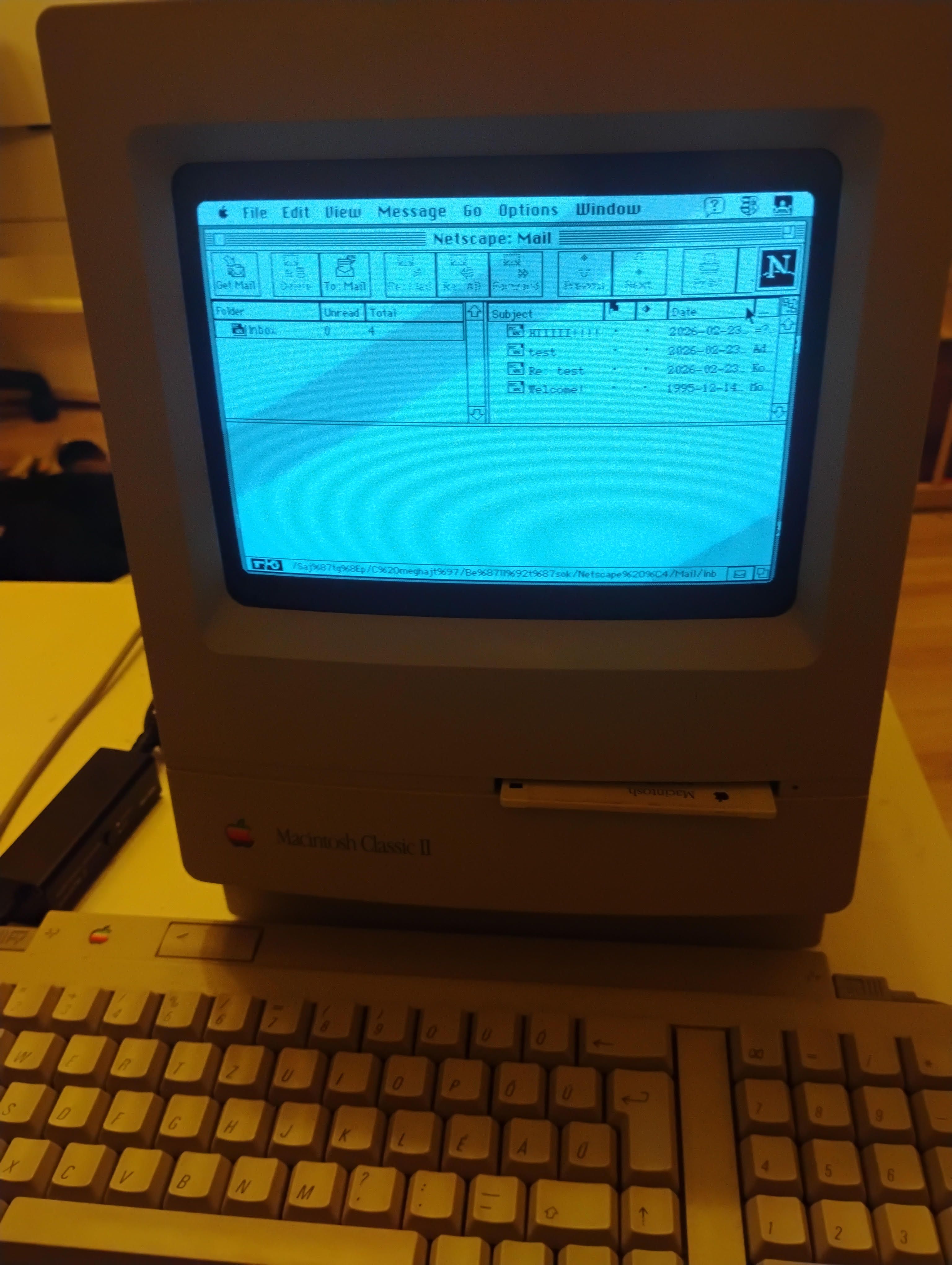

Just so I get to participate for the first time, I got wireless postscript printing working on my Classic II.
I also managed to get Netscape Navigator 2.0's e-mail management function to work, both send and receive, albeit that was back in late February.

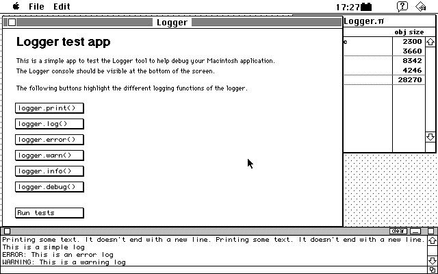

It is late in March but it's not too late for sharing my Marchintosh project! I have made a small lib that pops up a console window to log any data from your C code. It can be very useful for quickly debugging without having to open the debugger.
You will find more info in this other post.
You can see the console at the bottom of the screenshot.

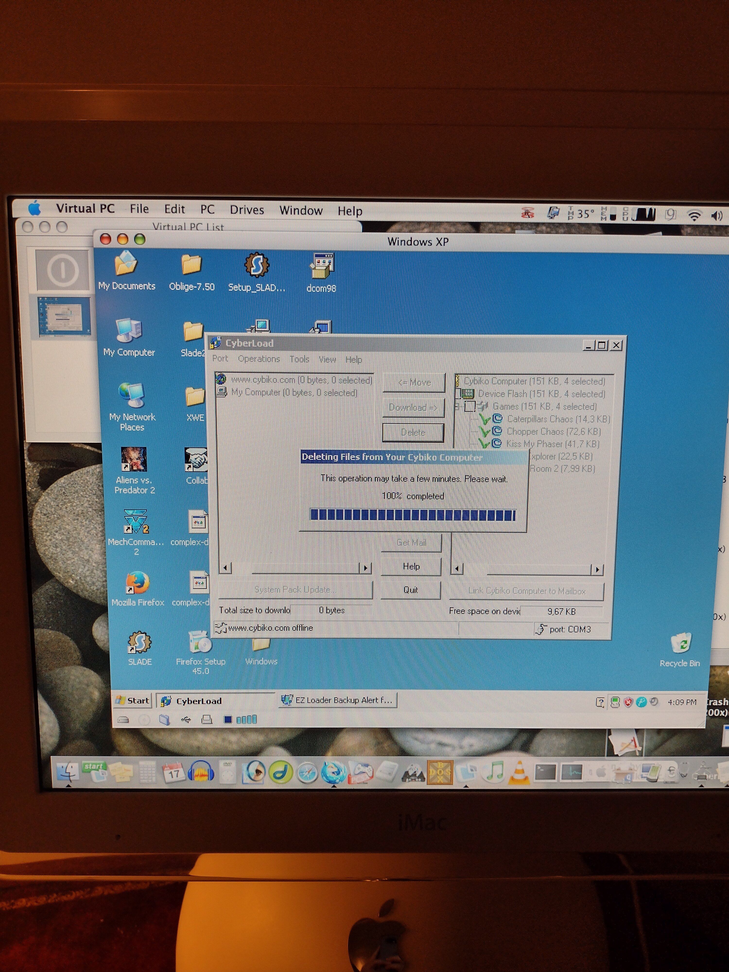

I've managed to sync an old Cybiko to an old Mac using a virtual machine.
I'm surprised this actually worked. Windows XP running on a 1Ghz G4 is a dreadful experience, but it eventually worked. I used an old USB-to-Serial cable that used a prolific chip, which was kinda hard to track a driver down. Installed the drive run the virtualmchine, told the Mac to pipe the USB function to the VM, and it just... Kinda worked. I was pretty sure there was going to be some kind of hardware abstraction issue somewhere, but not at all.
I could have used any other computer in my house to do this, but this sounded like the most fun. Now I can play all of these old and amazing Cybiko games.IMG_20260327_180931408_HDR.jpg

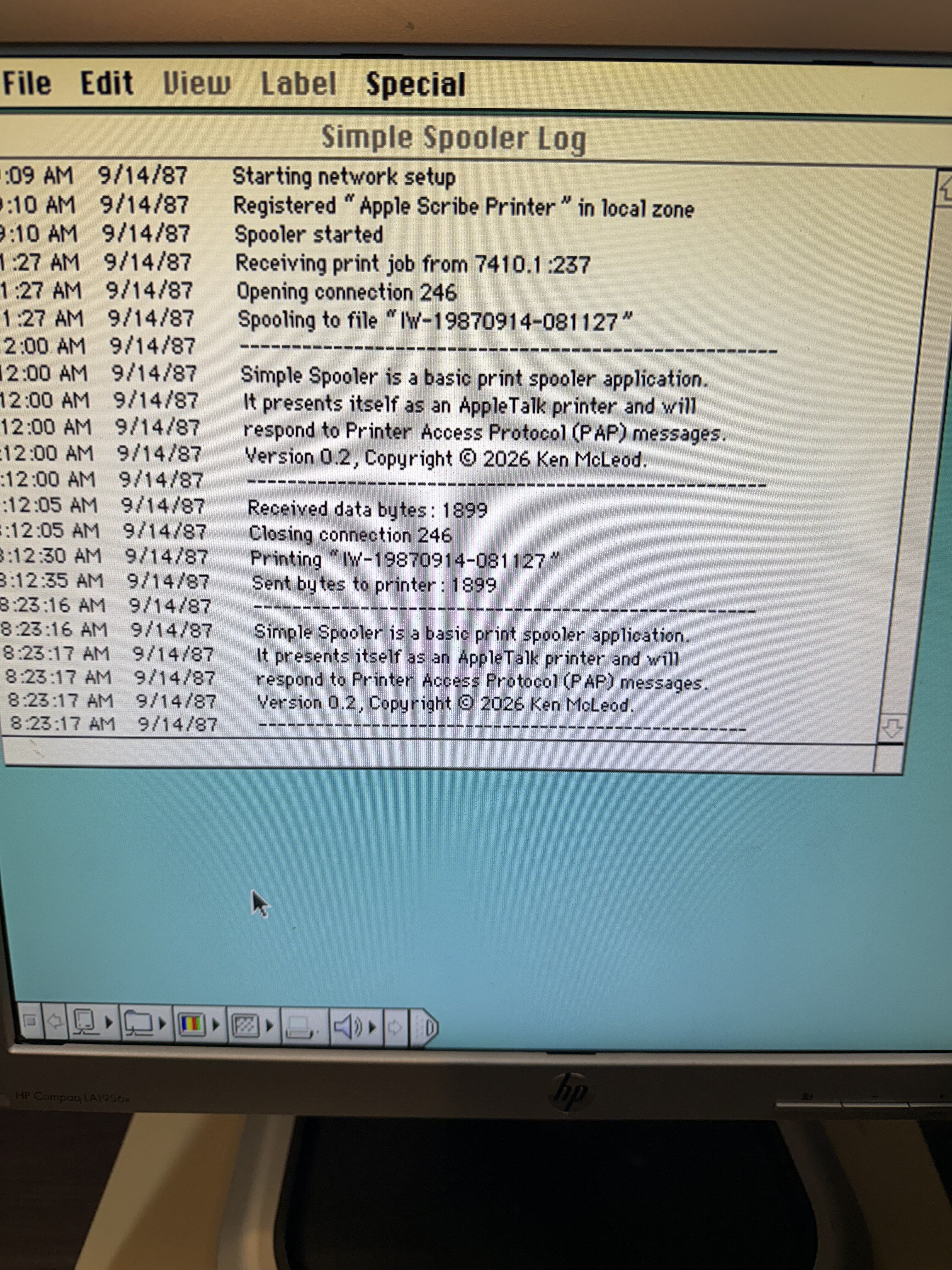

My #MARCHintosh project this year is called Simple Spooler -- think of it as the Simple Text of print spoolers. It's an application that runs on old Macs (System 6.0 up to 9.2.2) and lets you share your serial ImageWriter printer over the network, without needing an AppleTalk Option Card.
Currently it's working for printing to both the ImageWriter I and II, and should also work with an LQ though it's not yet been tested with a real one.
LaserWriter spooling support is partially done and working only with a specific version of the LW driver; will be striving to have it working well with all driver versions in March.
You can grab a pre-release copy on #GlobalTalk, from Puppet Head:Ken's Stuff:Simple Spooler 0.2: in the Cloudbusting zone.
Five Stars!!! This is the last piece of what i was hoping to accomplish with my 2026 Marchintosh - with this tool i was able to share out my Apple Scribe Printer (a thermal printer mainly for appleIIc) but connected to my PowerMac6100/66av. It is now able to be printed to directly on my Localtalk network - and thus also to members of GlobalTalk . Thank you so much! (The zone is YUL_GLOBALTALK)
This is good to hear. Glad it worked for you! I didn't realize that the Apple Scribe essentially uses the same commands and can be treated as if it were an ImageWriter printer. The Apple Scribe reference manual seems to have a complete list of its supported commands so I'll go through them and see if there are any differences between it and the ImageWriter II. (Note there is an ImageWriter I mode checkbox in Simple Spooler, because the ImageWriter I doesn't support several newer commands that the ImageWriter II driver can send.)
