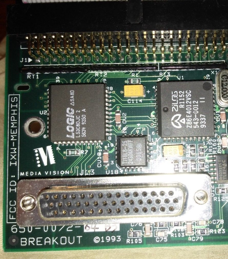

In that post, OP does link to some photos they took/posted on Amazon, so the preliminary info I have here is taken from cross referencing the ICs, their respective datasheets, and the visible/clear traces between them and the DB45 connector that goes to the ISA card.
Credit where credit is due, the below info started from this (now abandoned) post on VOGONS: https://www.vogons.org/viewtopic.php?t=63199

These are the facts that I've collected thus far- The base unit has a Logic L53C80JC2 PLCC-44 SCSI Bus controller (datasheet found and attached)
- This chip helps reduce the pins required to map back to the ISA card and allow the onboard play/pause/skip/previous/stop buttons to function for audio CD "sans PC" controls
- The base unit has a Zilog Z86E4012VSC PLCC-44 Micro controller (datasheet found and attached)
- Further implies "onboard" logic and control of CD audio playback functions without a PC and without requiring a special SCSI CD-ROM drive
- The base unit has a Texas Instruments TI16L8-25 PLCC-30 PAL (datasheet found and attached)
- First potential "gotcha" found on reverse engineering this. Chip will have to be removed to read/dump...
