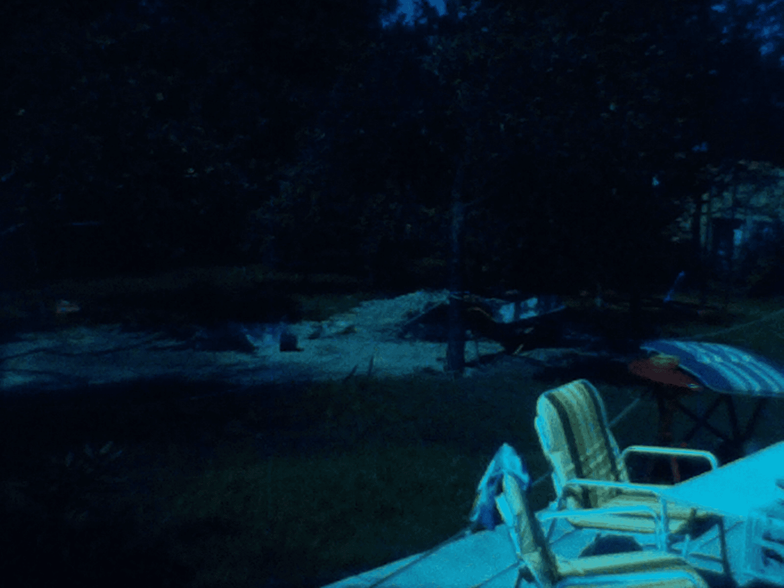

The last two days I made scannings with only one reel to see the differences in the various RGB settings.
What I recognized was, that the scannings are very dark. That means, that I had to correct this in vegas, in addition to finalize the color.
I'm a complete hobbiest in filming and processing films. I only want to make my memories available for my family. I'm not sure, if all the information is in the digitalized file of the darker digitalized versions with your software 6.8.
Do I have a chance to get the output brighter ?

Can you show me how dark your images are, compared to where you would like them? The exposure is both trying to avoid constant changes, as well as preserving highlights. Unfortunately the logic is very simple. There is EV bias added in 6.8, I just hadn't mentioned it as it is untested. Up and Down buttons will increase or decrease the brightness in small steps.
>you wrote that I could change the "green" with the left/right keys if the scanner is in the record mode, but the result could only be seen on the scanned film, not on the display screen. Is that correct ?
No. It is showing on the screen too, it is just that our eyes are always compensating, this is why I added the RGB histogram. When use the screen alone I would get the white balance wrong, the screen is very blue.

I can not recognize changes in green on the display, if I press the keys. I'm in record mode. The Histogram isn't showing the change either.
I don't want to open the unit. I'm no technician. So I don't want to attach a serial port.

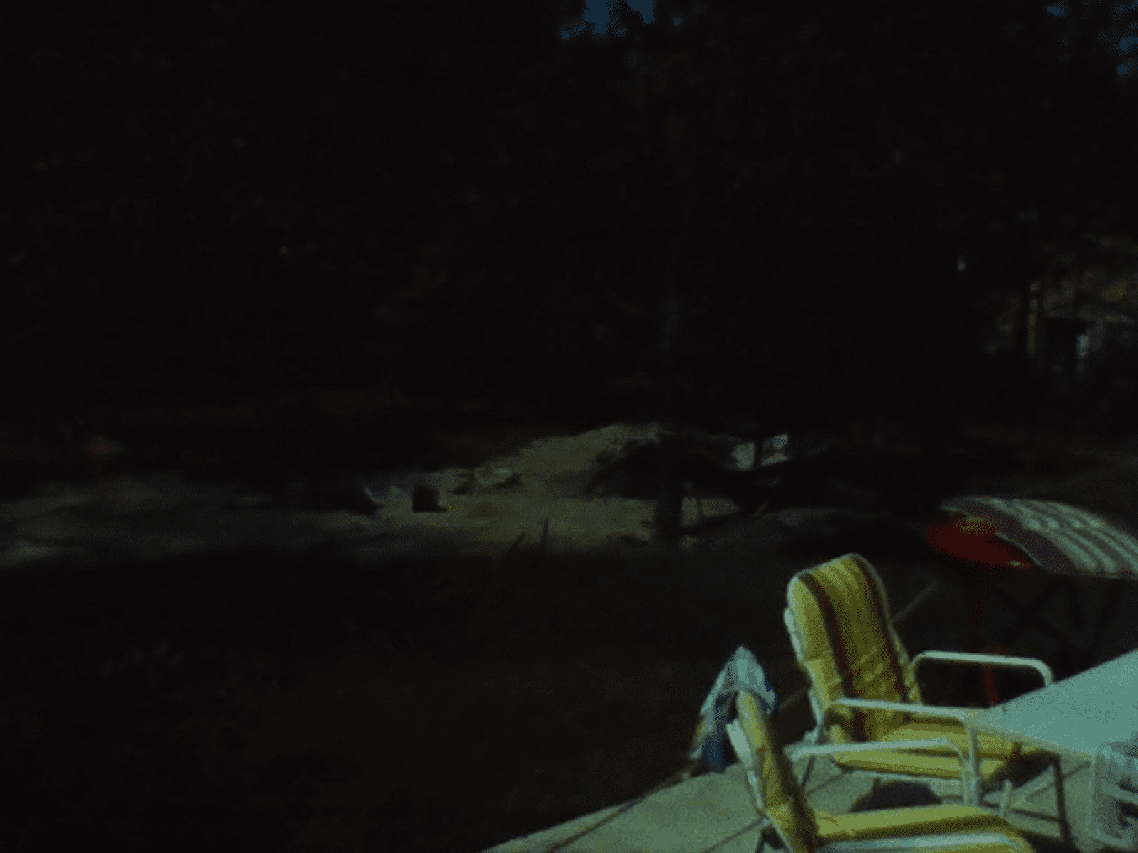

I only have pictures of the scanning of @Mac84 and new scannings with in this case Exp -1,5 Sharpness -1,5 Tint 0 of version 6.8. The color is not in this case I would love it. It has to be changed after scanning .... . But this is not the case. Which ISO @Mac84 has emulated ? I would like this much.
If I recognize the stop, I have some seconds to press "close" and after that the unit acts normal on keys pressed. That means if a timer has expired some 35 seconds after a stop the unit goes nuts.

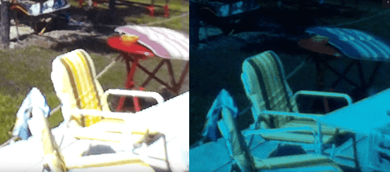

These a long presses, at about one second, I was trying to avoid accidental white balance change.
The new 6.6 / 6.8 firmware doesn't have Exp, but now have White Balance, and -1.5 for White balance is very blue shifted. Make sure you set the Red-Blue white balance correctly, as you same image has the wrong WB.
See the Histogram peak are aligning up.
In you samples the exposure of the default image is also not correct, as any detail in the bottom right is clipped to white at 255,255,255. The reason the second is so dark is the incorrect WB, as the white table is now at 5,182,217. The autoexposure is making sure the highest value, the blue, less than 255. Get the WB correct, and the exposure will greatly improve.

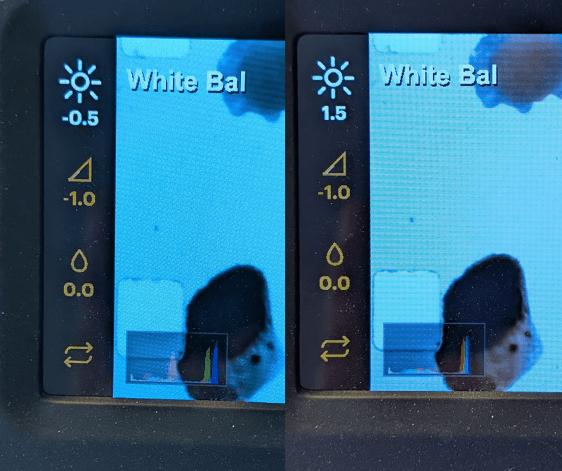

i use language german and in this "white Bal" is told "exposure". I put the pictures for White Bal +2 and +1,5 as attachment here. Tomorrow I will scan with this again, but I think it will be nearly as dark as before. Tomorrow.
For correcting the green : We are talking abaout the left/right Keys, correct ? And we are talking about "if the scanner is in the capture position" ?
I also tested ist in the "white balance change" selection and I pressed the keys longer than one second - nothing happened.
I believe it is not working correctly with model B.

Is working on TypeB as that is what I did the development on. I will have to try German to see if that breaks it.
P.S. Green WB control is working in German also, tested on Type B.

I tested it again. The language setting „german“ does not affect the behaviour. If it starts working with left/right, it behaves so in „english“ and in „german“.
But I recognized, that the histogram first has to „work“ before left/right is working.
It means on „white bal“ I have first to change it until I can see movement of red in the histogram. After that in some cases left/right is working also.
Here is my test
I did the following key pressing, every row shows a new pressing of a key
Capture
White bal
Left/right => nothing
White bal
Down ( it was at +2.0 ) => +1.5
White bal
Down ( it was at +1.5 ) => +1.0
Left/right => working
Up/down is further working
After some time left/right is no more working. I have to press „white bal“ again and have to change
something with up/down. My opinion is, that I have to press up twice or down twice in white bal, then left/right
starts working.
And : not every time pressing white bal plus up and down starts green balancing. I have to try several times.
But after I could see a shift of red in the histogram due to change white bal up or down, the green could be changed with left/right.
I will make further scans with correct white bal and green to show, that the picture for me seems to dark ....

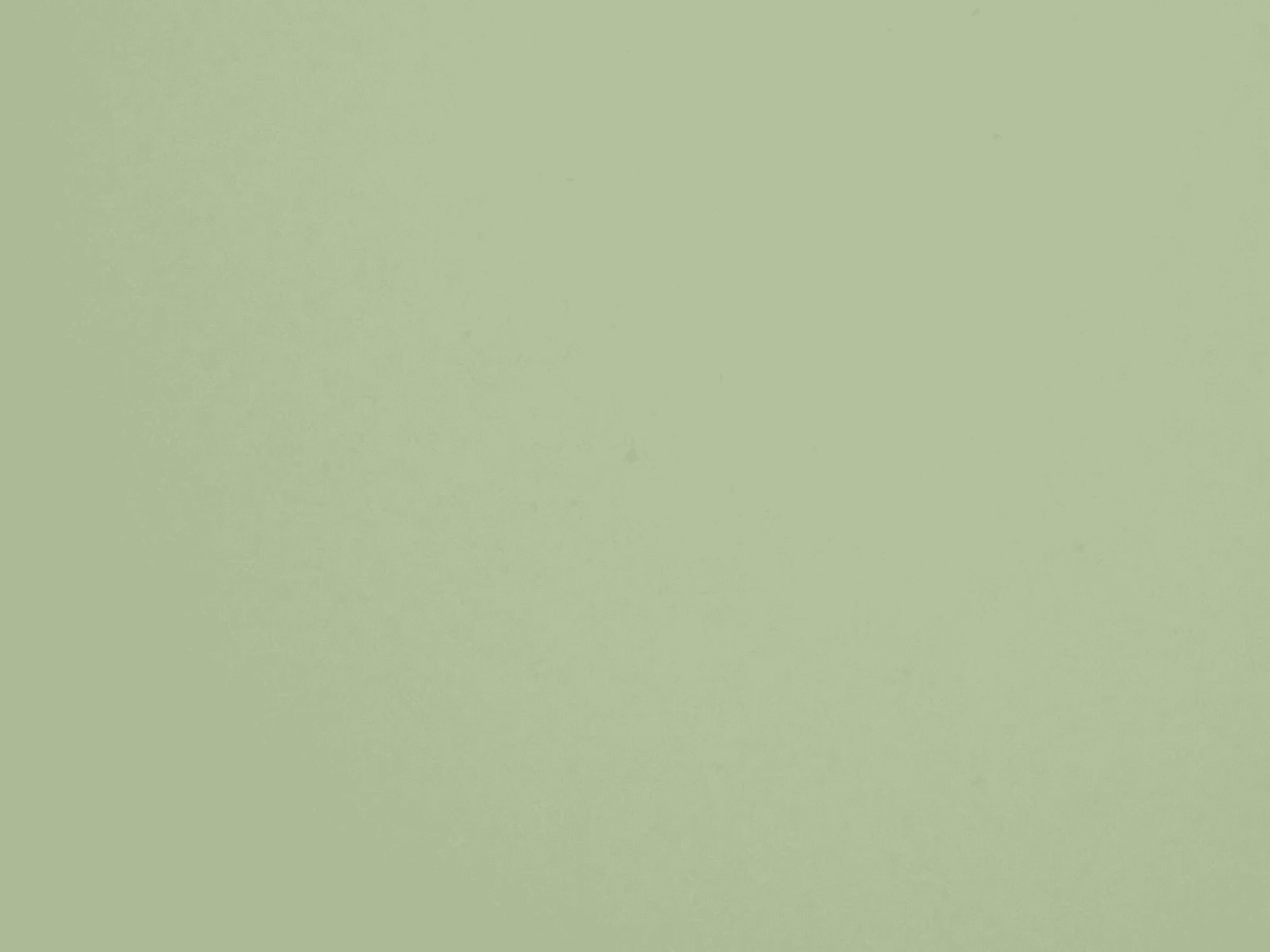

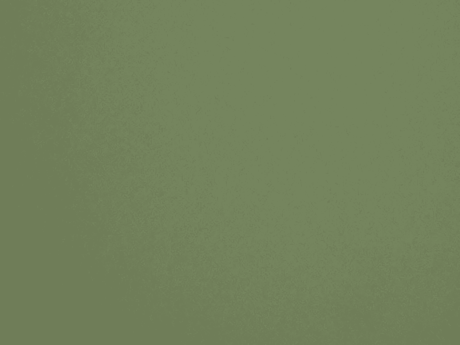

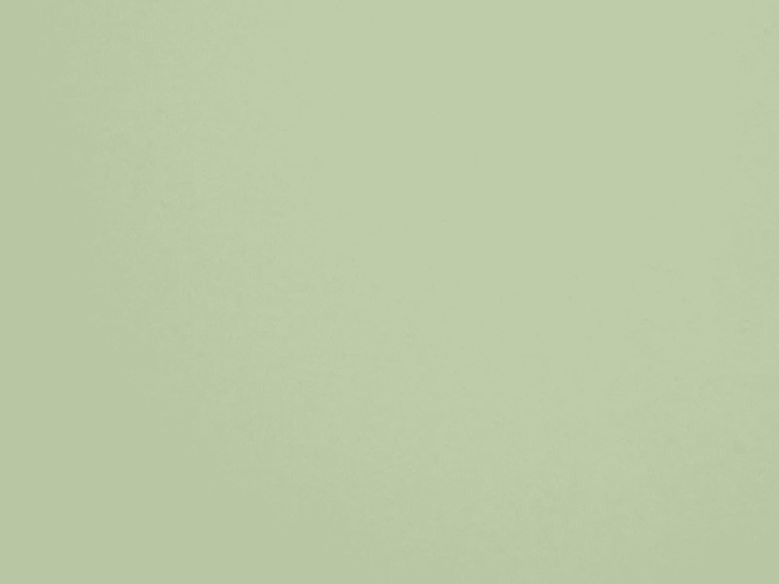

Another Test with darkness. I took pictures from the scanning of the version of @Mac84 and mine White Bal = 2, Sharpness -1,5, Tint -1, green matching on the red/blue at a non exposed developed part.
Additional following 5 pictures from the start of a scanning. I always start at the white band from the beginning coming original from Kodak development. You can see, that the brightness decreases within 5 pictures and stays at this level for the whole scanning.
Are you scanning 8mm or Super8? I'm wonder if the socket is effecting the exposure. More worrying if the exposure is crashing, but that needs a serial port to know. Anything else seeing this?
Super 8
On which peace of film you are start scanning ?
How difficult it was to attach a serial ? Soldering ?
What do you mean with "anything else seeing this" ? Do you mean anybody ?
Anybody else seeing this? Particularly anyone with a serial port. Adding the serial port is not easy.
The behavior is not the same here, so not much I can do until it can be repeated.
