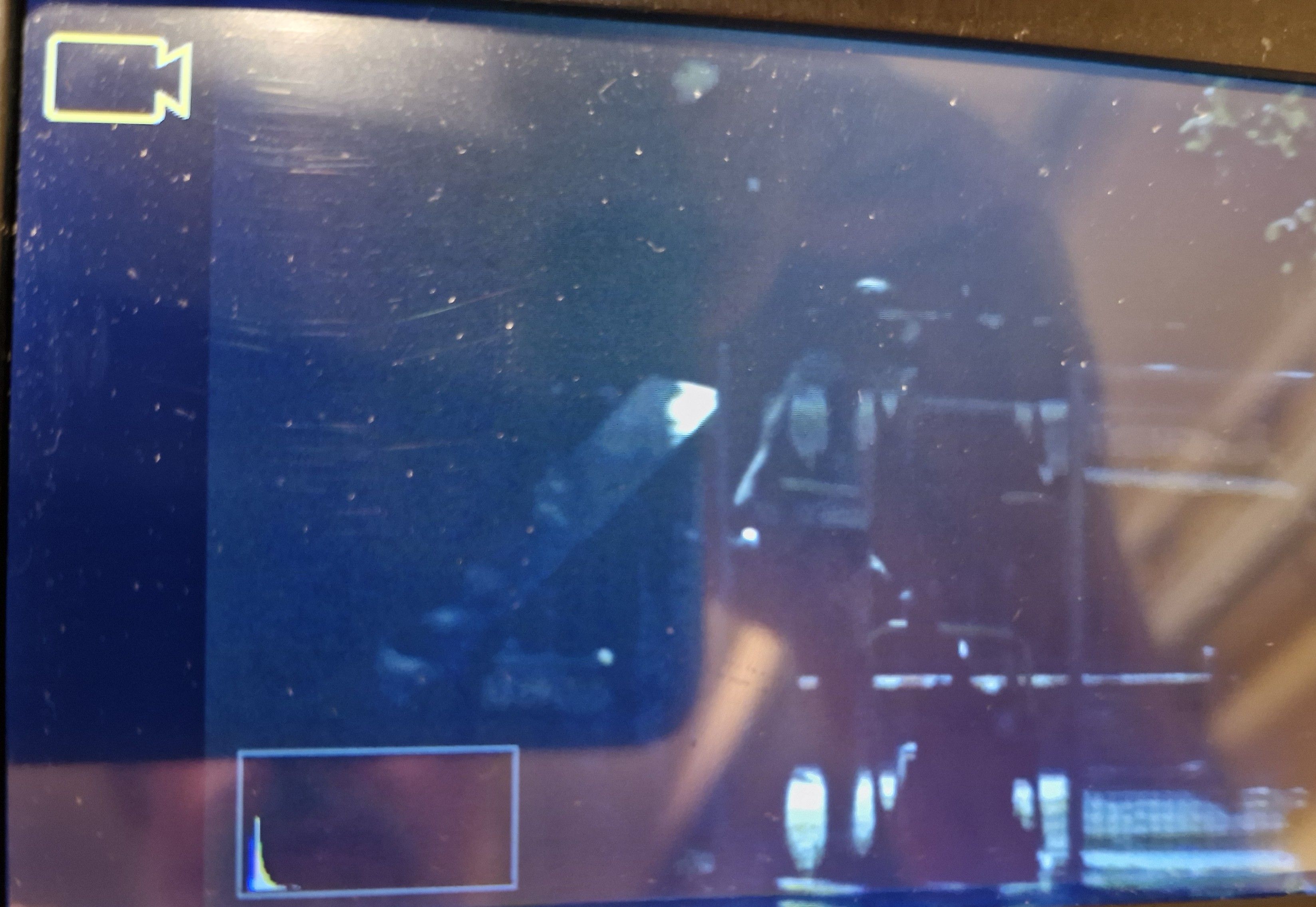

When there are dark, what does the histogram show? It is also dark?
I think you will have to run different firmware until I can display the settings on screen, as right now only the histogram is the feedback, and it drives the exposure.
V 6.8
I would suggest the histogram is dark also ...

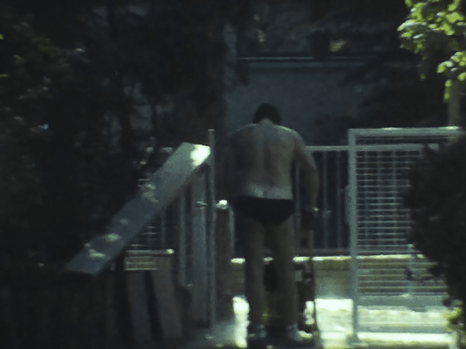

Another Test with darkness. I took pictures from the scanning of the version of @Mac84 and mine White Bal = 2, Sharpness -1,5, Tint -1, green matching on the red/blue at a non exposed developed part.
Additional following 5 pictures from the start of a scanning. I always start at the white band from the beginning coming original from Kodak development. You can see, that the brightness decreases within 5 pictures and stays at this level for the whole scanning.
The darkness appears with V6.8 from @0dan0
Is anybody out there with a Reels Model B and an attached serial port who can verify with @0dan0 s V6.8. Software, that scan starts and decreases brightness at start within 5 or 6 frames and then stays darker ? I think @0dan0 would like to see something using the interaction with the serial port.
The behavior of this version on my Reels stops me of scanning further films, because I love the manual white balance and so don't want to switch back to older versions.

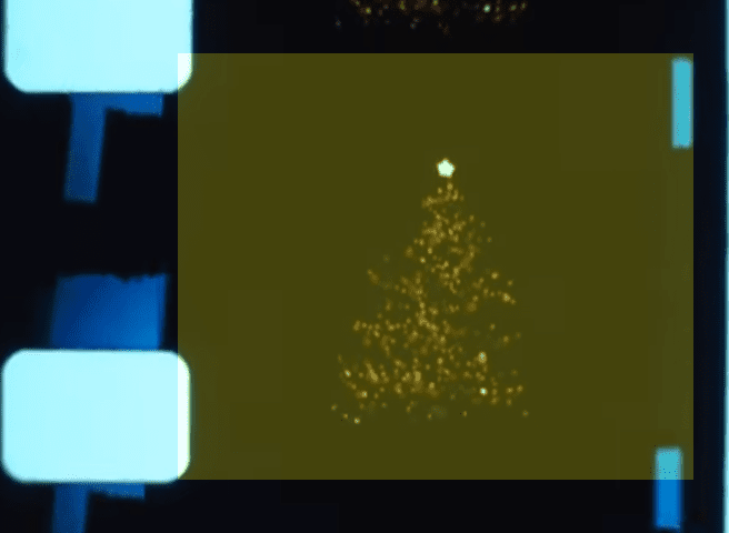

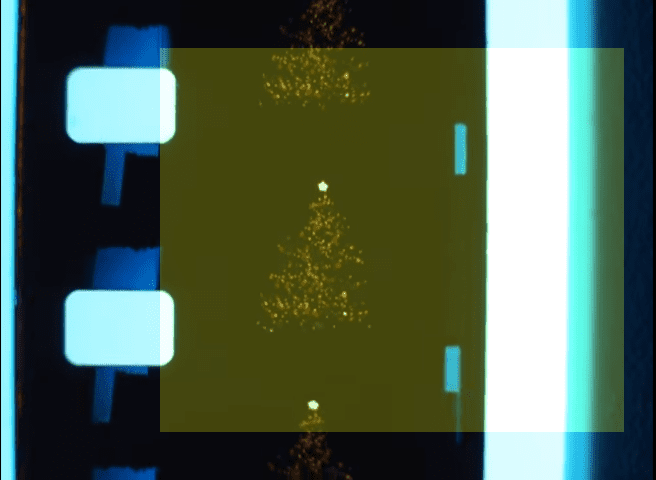

so I got everything set up and did my first capture which went well, it was only a minute long. However my second capture also went dark after about the 1:50 mark. I'm running v 6.6 on model C.
I tried to stop and start the capture but within 5 frames or so it would transition back to dark. Also is the color super washed out? This is my first time dealing with film so i don't know what to expect.
Here is a short video where you can quickly see the transition. I power cycled the unit and retried the scan, and it did the same around the 1:50 mark
It happens in the first second, may need to slow playback to see
It is the film not, the scanner or firmware, that is getting dark, as the scanner exposure is not changing. The exposure is not changing as the weights are sampled from these pixels in yellow:
So it is sampling pixel to the right of the film, preventing a change the re-expose. This far out view, is intended out for the replacement lens, and should not be used for the stock lens.
If you frame it like so, the image is mostly sampled, improving your exposure.
I do need to move the sampling window further to the right to avoid the large 8mm sprockets.
Reactions: eyeidea
I tested the change due to scan a white prelude tape. And like posted in #657 you can may be see the change
Thanks so much for the reply @0dan0 and I think you're right. My first capture i ran cropped in quite a way, and that film did not go dark. I ran the second reel zoomed out because thats what I was seeing on this forum. My Mistake! The results look fantastic though, so thank you for all your hard work, my family will love seeing these. Do you have a venmo I can donate to?
