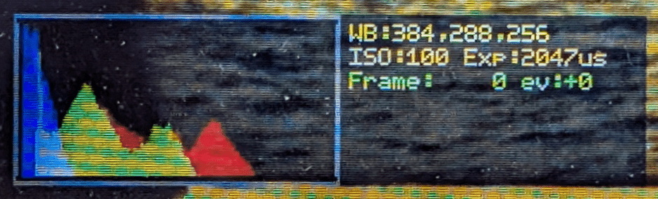

@0dan0 I was able to get the capture to work without the darkening that I experienced in the last version. I was able to adjust white balance to get peaks to line up, and then while capturing, adjusted the EV up to 0 as the default was at -7. It brightened it up! While I am no color expert, I feel like the capture looks flat. Can you tell me what you see in these two test clips? You should be able to download them.
Thank you again for your efforts on this!
Two test 8MM captures
The default of -7 explains why some units went dark. Now that we can see the EV level it is easier to fix. I will find a way to reset any out of range value in the next build.
Those two clips look great, and well exposed. There is not flat or log curves in the Reels scanner, this is likely a standard 2.2 gamma curve. I have yet to find any way to modify the curves. The clips look a tad desaturated, I'm not sure if that is the film stock/age, or you have a negative tint setting.
So I've disappeared for a few days as i was busy scanning some reels, but I want to say that some of the results i've gotten are fantastic! Very happy with the quality and colors I have been able to get. Thank you so much @0dan0 for all your work with this!
I also would like to report that I think I may have found a bug and am now in the weeds with my scanner. I was a little confused by the functionality of the green tint but was using it a lot and it was very helpful. If i understood the post correctly it says you can adjust the tint 9 clicks in either direction from center or default. At some point I lost track of where I was so I figure I will just go all the way to one side and then click back 9 clicks to be back at default. What wound up happening was I clicked around 30 clicks to one side and the histogram kept moving so i assumed changes were happening. At one point the color within 3 clicks went from heavy blue, to heavy purple, back to normal. The buttons to control the tint are now non functional and it is stuck in a weird place. I was looking for a way to reset the value and hopes that pressing both the left and right buttons would have that effect but wishful thinking i suppose.
I then just tried to get the picture as close as i could to "correct" and noticed that the image on the LCD during preview was much brighter than when the actual recording starts. It seems to get darker once recording starts. I have taken video of all of this and will get it uploaded shortly

@jackmonte1987 This is all addressed in the V6.9 build I posted yesterday. Only for Type B, as I wanted a few testers, but I will create Type A and C builds shortly.
Thank you so much @0dan0 . I would not have the confidence to do any of this without your enhancements. I never used a histogram before in my life until now and it's been very helpful. Although I am finding A lot of my footage the color has severely faded and almost looks B+W now.
Added EV Bias control + / - key during record only.
Still v6.9 Type B only.

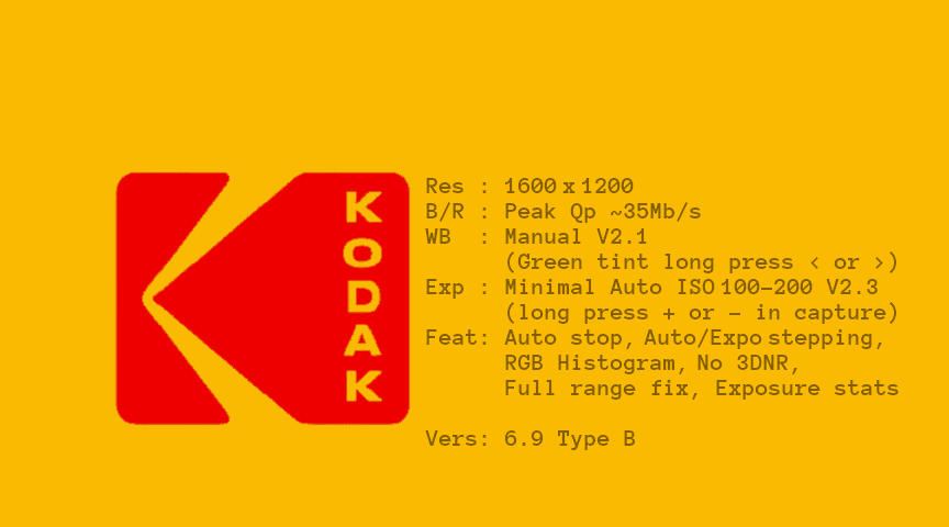

All updated to V6.9, types A, B and C.
I reduced the EV range to be more subtle, so larger values might be required. I was reacting to this comment "EV1 is a little to dark, ev 2 is too bright". EV +2 now more is like the last EV +1. This does not make the scan brighter or darker directly, instead it biases the input to the auto exposure. As the exposure logic tries to limit unnecessary brightness changes, it is more intended for a scene change, some EV values may no appear to change the brightness, this is normal. You can trick the unit into thinking there is a scene change by temporarily placing your finger between the camera and film.
Thank you so much @0dan0 , Now I get back to scanning. I just want to clarify, when you say EV you are talking about the green tint using the left and right arrows correct? Would 0 be considered default or "untouched". Also will this fw update fix my stuck setting? I know you had said that the settings will remain even despite a fw change.
No, green tint for white balance is < and > buttons, EV (exposure bias) is new, and use + and - buttons, but only during capture. These are explained (so briefly) on the boot screen. There is no correct setting, just what looks good to you.
