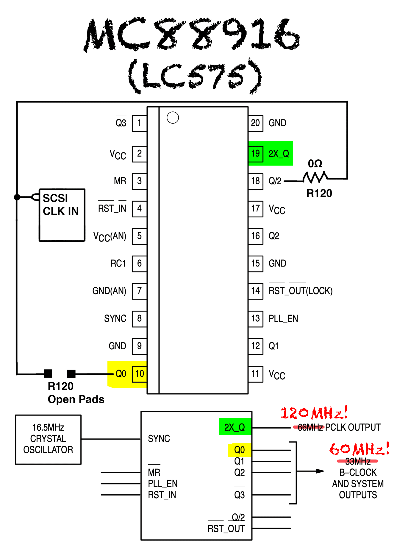

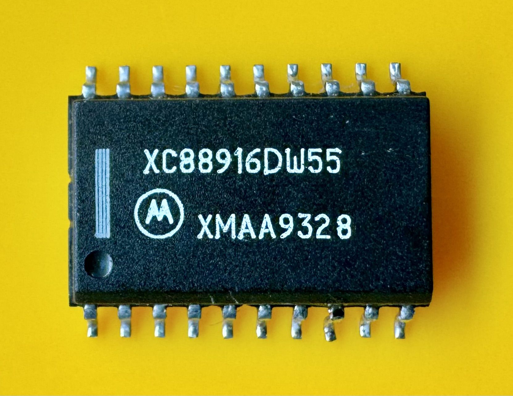

My DW55 chip should theoretically only handle up to 55MHz on the 2X output. Meaning, there's also a 1X output. For example, if you run an 040 CPU at 25MHz (1x output) you must also feed it a double speed clock of 50MHz. A DW55 would accommodate that just fine, because again, it's rated for up to 55MHz on the 2X output.
In my case, I had been driving the DW55's 1X output at up to 50MHz, which means the 2X output was 100MHz. It handled that just fine until I used my Fluke 8845A to make 2X4W (4 wire, using 2 probes) resistance measurements, then the chip suddenly started outputting 2X on the 1X output, and 4x on the 2X output. All the outputs are now twice as fast as they should be, which is driving me insane because I don't know why. You'd think if you'd fried the chip, it would stop working. Well, in my case, the DW55 chip is working twice as fast as before. I have no idea why. And even when I remove Spicy and use the motherboard's stock 33MHz speed, the DW55 chip is outputting 66MHz on the 1x output and 120 MHz on the 2X output. And I think that when you overclock the CPU too high, it won't chime and the screen remains dark, which are the symptoms I have now. Even so, I don't know if the DW55 chip is the ONLY problem.
But I must start replacing something, and since I know the outputs are twice what they out to be, I need to change the DW55 chip. But because I can clocking the chip to 40MHz and higher, using a DW80 chip (which has a 2X output that is confirmed by the manufacturer to work at 80MHz) is prudent. Overclocking the 040 beyond 40MHz would put the DW80 beyond spec, but like I said, I've been doing that with the DW55 chip, and it's been working fine for about 2 years.
I removed the XC88916DW55 chip this evening. It's all ready for a replacement. And I do hope that is the fix. Even so, I won't know until I try a chip swap.
I spent a little time reading the datasheet for the 88916 and didn't see anything that should cause that behavior. I was thinking there might be a pin that sets a mode or some such. Admittedly, I did some skimming and didn't read everything in detail. There's some complication there with the reset in and reset out pins.
My thinking was that maybe you somehow caused one of the control pins to be shorted or open or some such. I can't figure out what the MR pin even does though. Not without more attention.

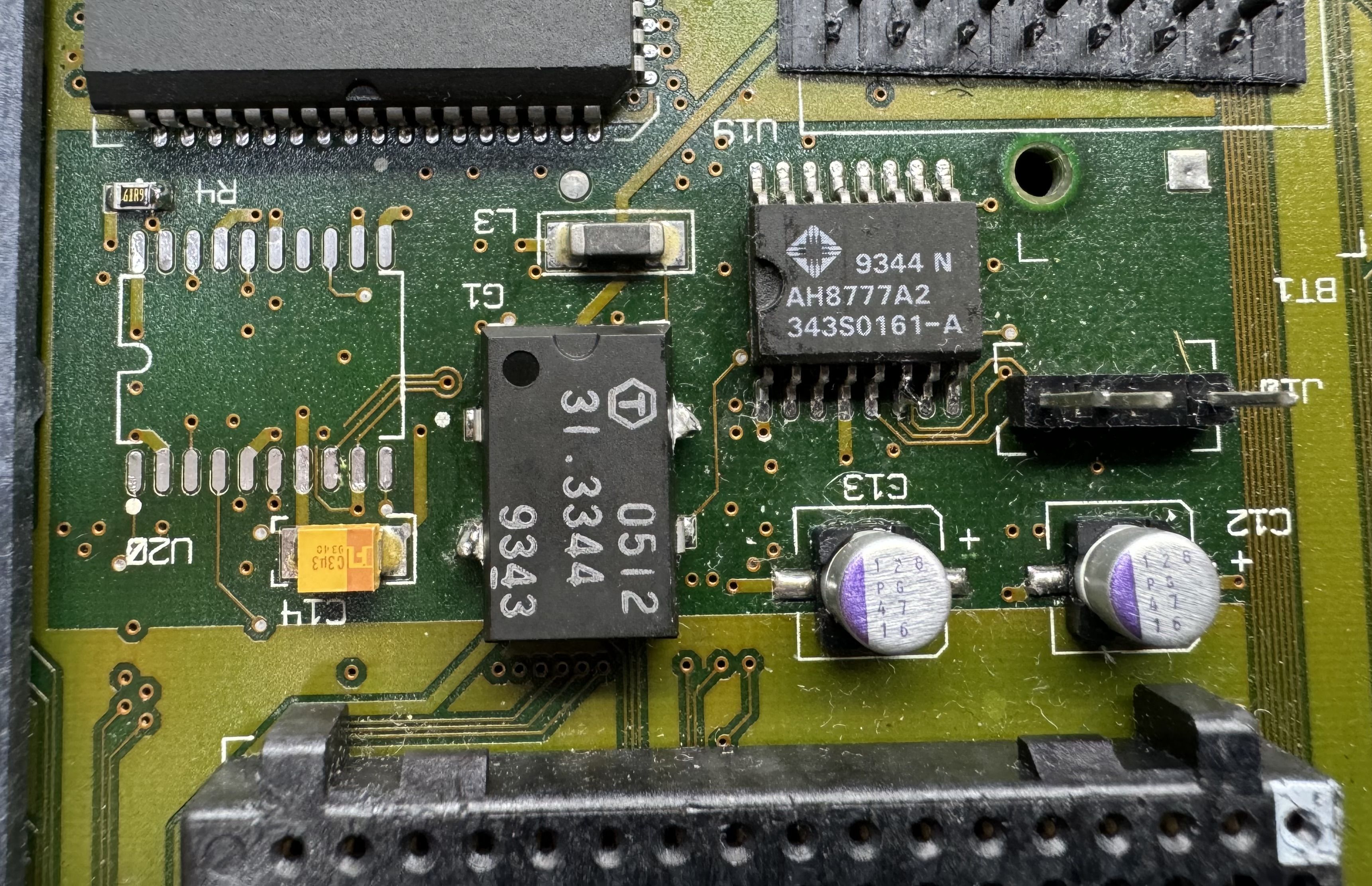

I notice there's a 31.44 oscillator near the 88916. Is it possible that something shorted a trace so htat the Sync input is getting the 31.44 signal instead of the 16.667 or whatever it is supposed to get?

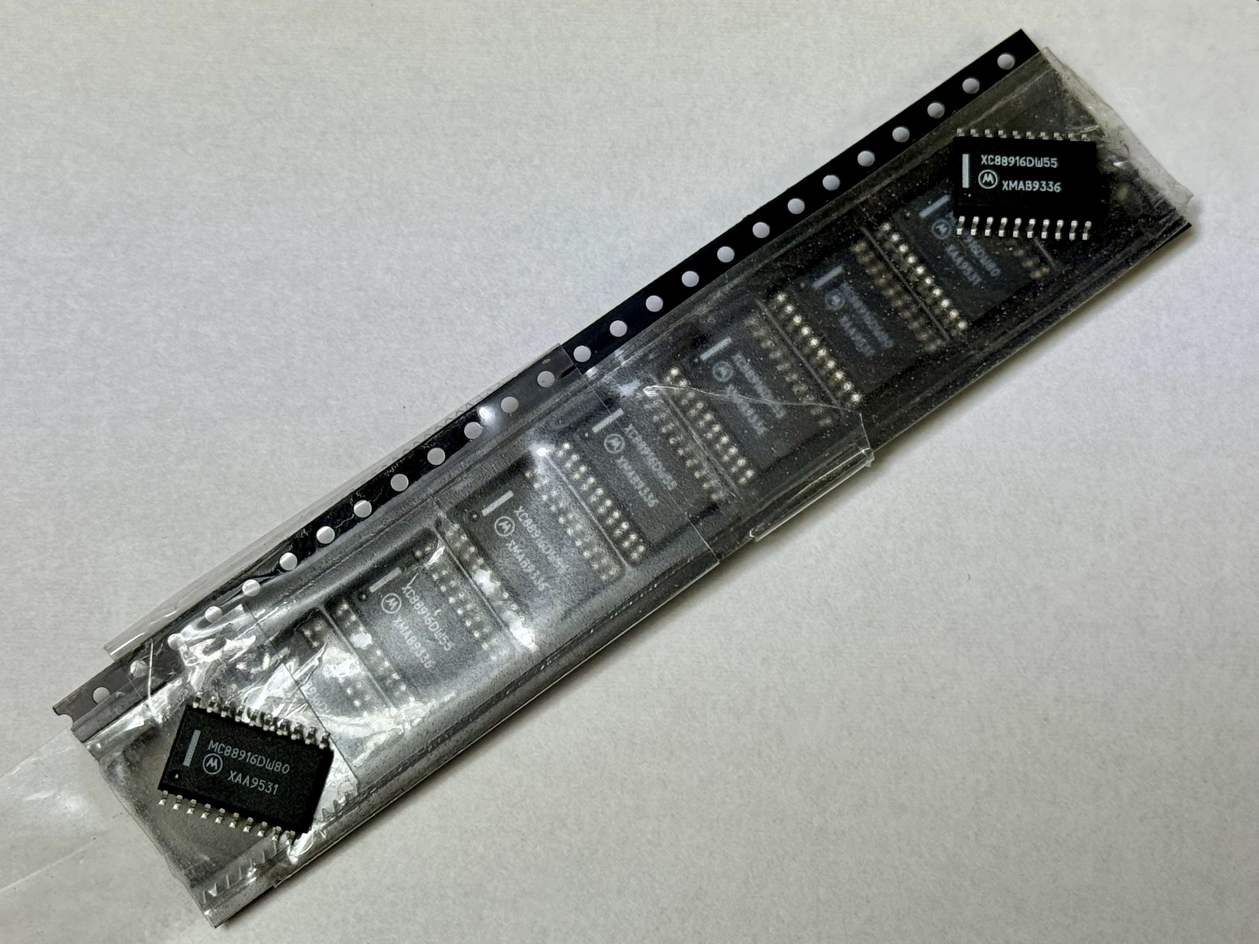

I would like to once again humbly thank @trag for having so kindly shipped me some MC88916DW80 and DW55 chips. They arrived today and I was able to put a few to the test in my test jig.

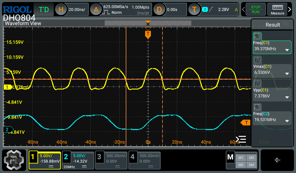

Do you have an oscilloscope? I am wondering what kind of comparison you would see on your test jig between the DW55 and DW80 chips as you increase the input frequency.
Oh, but remembering earlier posts, I guess the limiting factor is the input (sync) frequencies available to you.
I apologize for my delayed reply. I've been extremely busy lately, and on top of that, I've been feeling rather terrible all month. No time to visit the doctor until early March. :sick: It is also the reason I've not had a single moment of time to do any video work for my YouTube channel.
I did not have time to solder the DW80 chip into the motherboard. Sadly, I doubt I will have time tonight either.
But in answer to your question, @trag , below are the screenshots made on my Rigol DHO804 (hacked to 100MHz bandwidth, with 150MHz rated probes, done with short "ground spring", but done on a breadboard which causes waveforms to look a bit funky)...
YEL trace: Q_DIV_2 (pin 18) — should match freq. of SYNC, and it does!
BLU trace: SYNC IN (pin 8)
YEL trace: Q0 (pin 10) — should be twice the freq. of SYNC, and it is!
YEL trace: 2X_Q (pin 19) — should be 4x SYNC, and it is!
Again, this was a breadboard test, which is not ideal, so waveforms aren't shaped perfectly. I did not put any termination resistors on 2X_Q either. I measured everything straight out of the chip.
The above waveforms are the DW55, but I found the DW80 to look pretty much the same. It's just that I measured the DW55 chip to draw 75mA, while the DW80 draws only 67mA under the same test conditions.
The real test will come when I get the DW80 chip solder onto the LC575 motherboard.

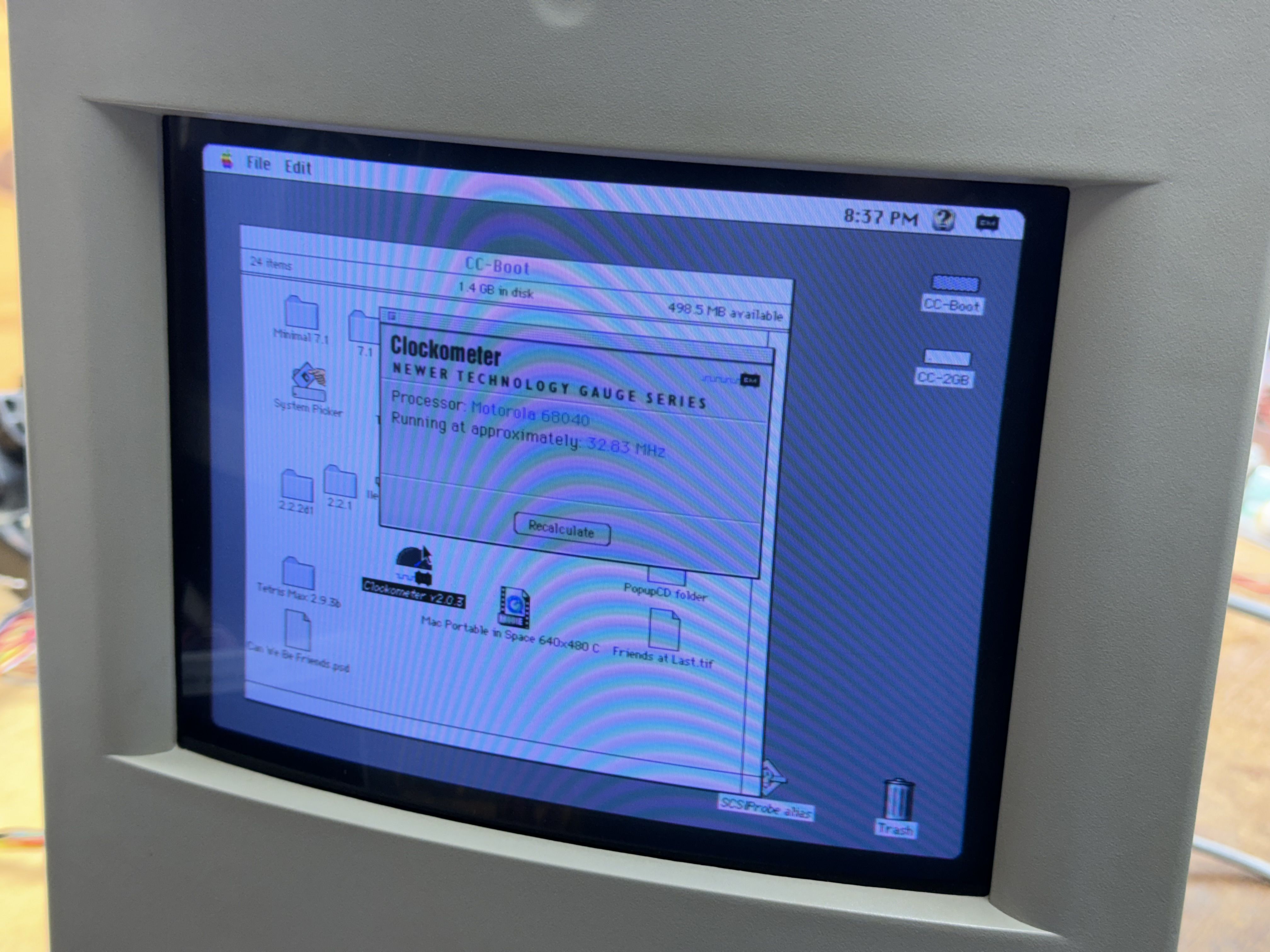

Spicy is disconnected, no card is installed, and I've not tested external SCSI booting yet, but those tests will come tomorrow night after work.
I cannot tell you folks what a TREMENDOUS RELIEF this is!
⚠️ I also can emphatically say that you should NEVER do 2x4W resistance measurements on your LC575 board! ⚠️
That is what killed the stock DW55 chip. Hopefully further testing will show nothing else was damaged. But oh, what a fabulous relief it was to hear the bong after soldering in that DW80 chip. Wow!
A MILLION THANKS, @trag !
I am happy to report that I was able to boot into the following OS's, both from my internal spinning platter HDD and an externally connected BlueSCSI v1:

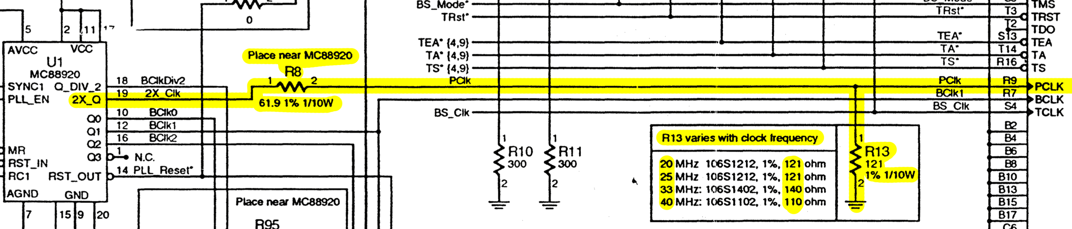

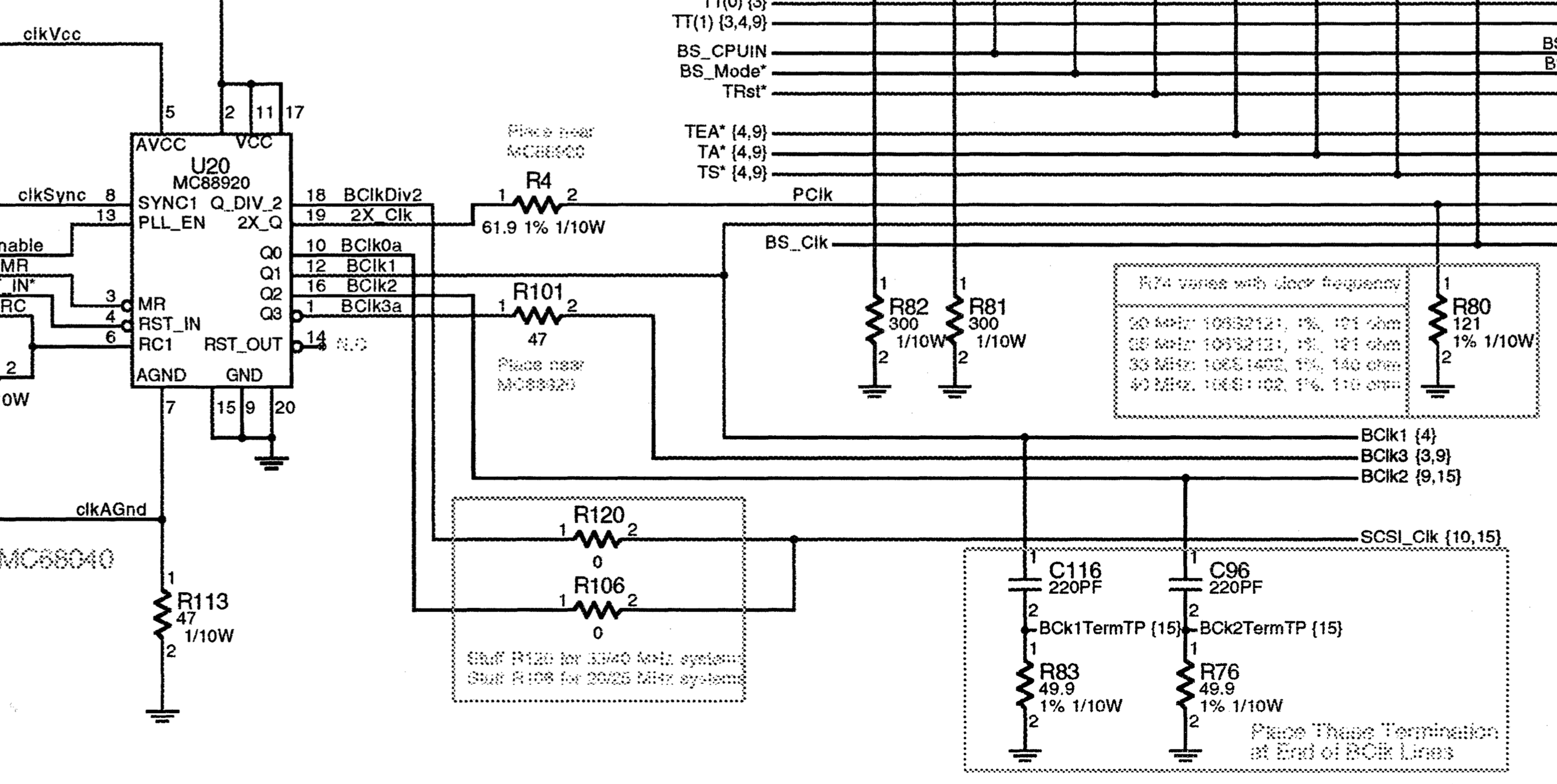

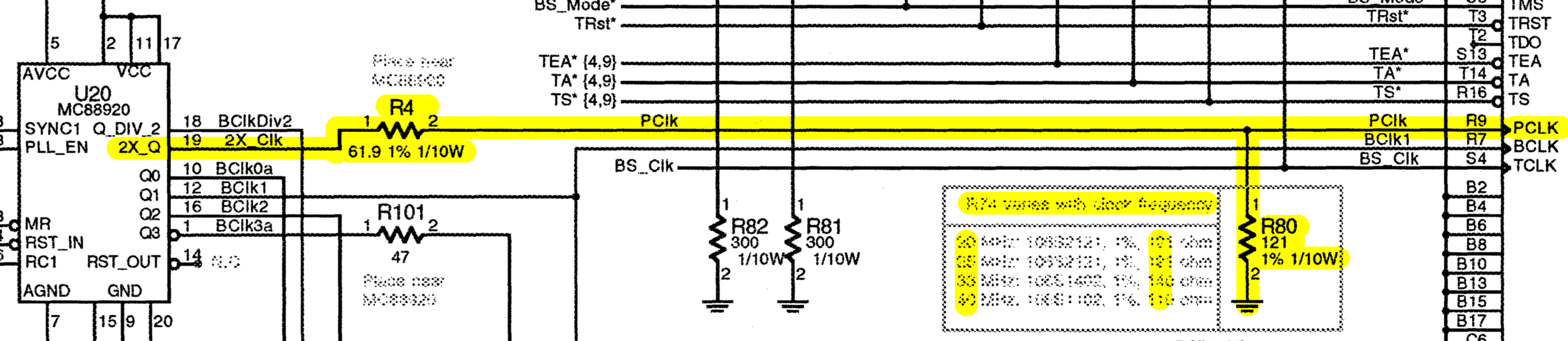

As I mentioned earlier in this thread, there are TERMINATION RESISTORS used on the 2X_Q output of the 88916DW chip, which leads to PCLK on the 68040 CPU. So for example, when the CPU clock speed is 33MHz, PCLK will be twice that at 66MHz. And that is really the reason the 88916 chip is used -- to provide multiple clocks.
But I can't quite figure out Apple's termination scheme.
This is from the LC575 schematic (gray parts are VERY HARD TO READ):
And this is from the Quadra 605 schematic (much easier to read):
So except for the Resistor number, the info in that little box toward the right seems to be the same for both motherboards.
Now the data sheet for the MC88920 is exactly the same as the datasheet for the MC88916 when it comes to the FORMULA that let's you calculate the two resistances...
So if we examine those LC575 & Q605 schematics, we see the following:
Rs = 61.9Ω 1%
= Zo-7Ω (as per the datasheet)
And for a 33MHz CPU clock, we see this:
Rp = 140Ω 1%
= 1.5xZo (from datasheet)
So, what is Zo?
Using Rp=140Ω...
Zo = 140 / 1.5 = 93.33Ω
Therefore, Rs = 93.33-7 = 86.33Ω
But Rs = 61.9Ω!!!
Using Rp=110Ω...
110 / 1.5 = 73.33Ω
Therefore, Rs = 73.33-7 = 66.33Ω
But Rs = 61.9Ω!!!
Rs is a fixed 61.9Ω value.
And we know Zo=Rs+7Ω.
So Zo=61.9+7 = 68.9Ω
Therefore Rp=1.5Zo=103.35Ω
But that cannot be right because Zo will change according to the 2X_Q output clock frequency!
So the question is, what should Rp be for clock speeds higher than 40MHz?

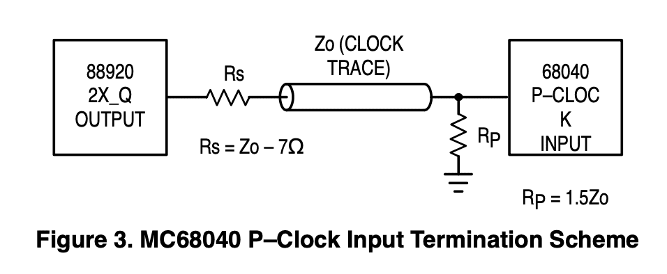

The 88920 datasheet has this Application Note pertaining to Termination of the 2X_Q output:
Two specs (tRISE/FALL and tPULSE Width 2X_Q output,
see AC Specifications) guarantee that the MC88920
meets the 20MHz and 25MHz 68040 P–Clock input
specification (at 40MHz and 50MHz). For these two specs
to be guaranteed by Motorola, the termination scheme
shown in Figure 3 must be used. For applications which
require 1.5V thresholds, but do not require a tight duty
cycle the Rp resistor can be ignored.
Bear in mind the 88920 chip is only rated for 25MHz CPU operation (50MHz on the 2X_Q output).

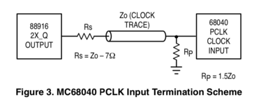

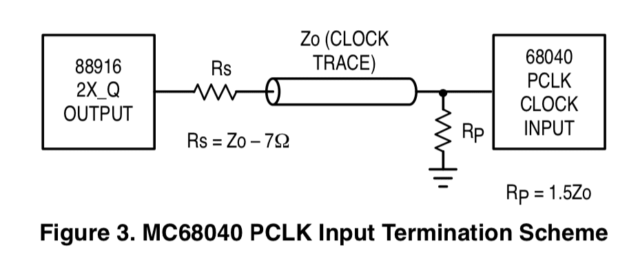

The 88916 datasheet has this Application Note pertaining to Termination of the 2X_Q output:
The pulse width spec for the Q and 2Q_X outputs is
referenced to a VCC/2 threshold. To translate this down
to a 1.5V reference with the same pulse width tolerance,
the termination scheme pictured in Figure 3 must be
used. This termination scheme is required to drive the
PCLK input of the 68040 microprocessor with the 88916
outputs.
The 88916DW80 allows for a CPU clock speed of 40MHz, which means 80MHz on the 2X_Q output.
