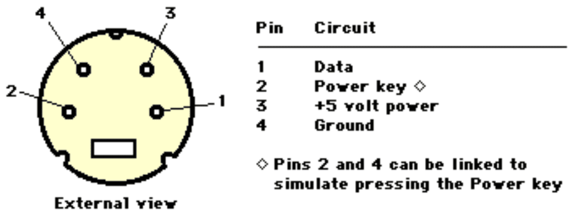

If you don't want to disconnect a cable, you can power on the CC by shorting the ADB power pin (not 5V) to GND.
I haven't observed any lockups by pulling an ADB cable. The worst I've seen is the mouse going to its slowest setting.
I am seeing some incorrect info posted on the internet when it comes to ADB pin-outs, but it would appear the following should be correct (I think) when looking at the back of the LC575 motherboard.
When I touched my multi-meter's Black/GND probe to one of the motherboard connector bolt holes (which should be GND), and then press the RED probe against a jumper wire inserted into "3" above (which should be +5v), I get nothing with the machine powered off, which is correct. And when I put a wire into "2" above and press that wire against the same connector bolt hole (effectively Grounding pin-2), the machine won't power on, but I then am able to measure 4.835v on "3" above. I touched "2" to the bolt-hole GND for a short duration and a long duration, but that won't power the machine on, despite the fact it theoretically should.
If I disconnect my jumper wires and then plug in my keyboard and press the PowerKey, then the machine powers on. And if I put my meter into beeper mode (to check continuity) and if I put one probe on "2" and the other probe on "4" (on the ADB cable coming from the keyboard, not the motherboard connector, mind you), I get no beep when I press the power key.
Going under the assumption that the bolt hole isn't a good enough GND, I used by jumper wire (with male pins at both ends) to connect "2" & "4". To my delight, that powers on the machine. I then had my meter's RED probe on "3" and quickly put the BLK probe on "4". I measure 4.925v initially. Then when MacSD or BlueSCSIv2 stops working (the point at which the machine freezes), the voltage measures 4.930v.

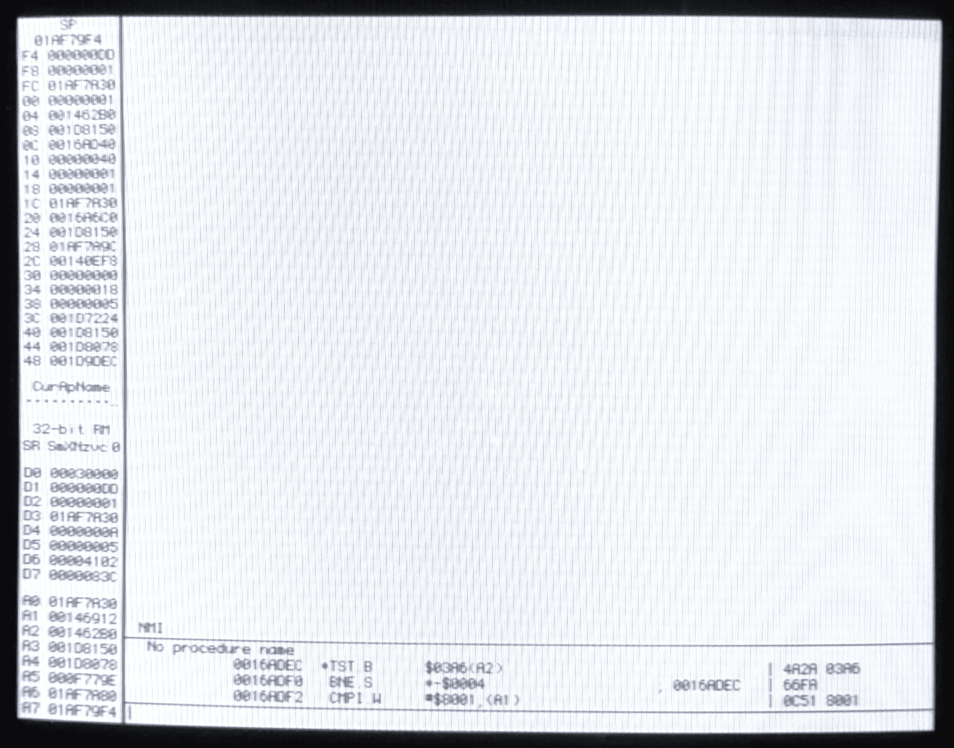

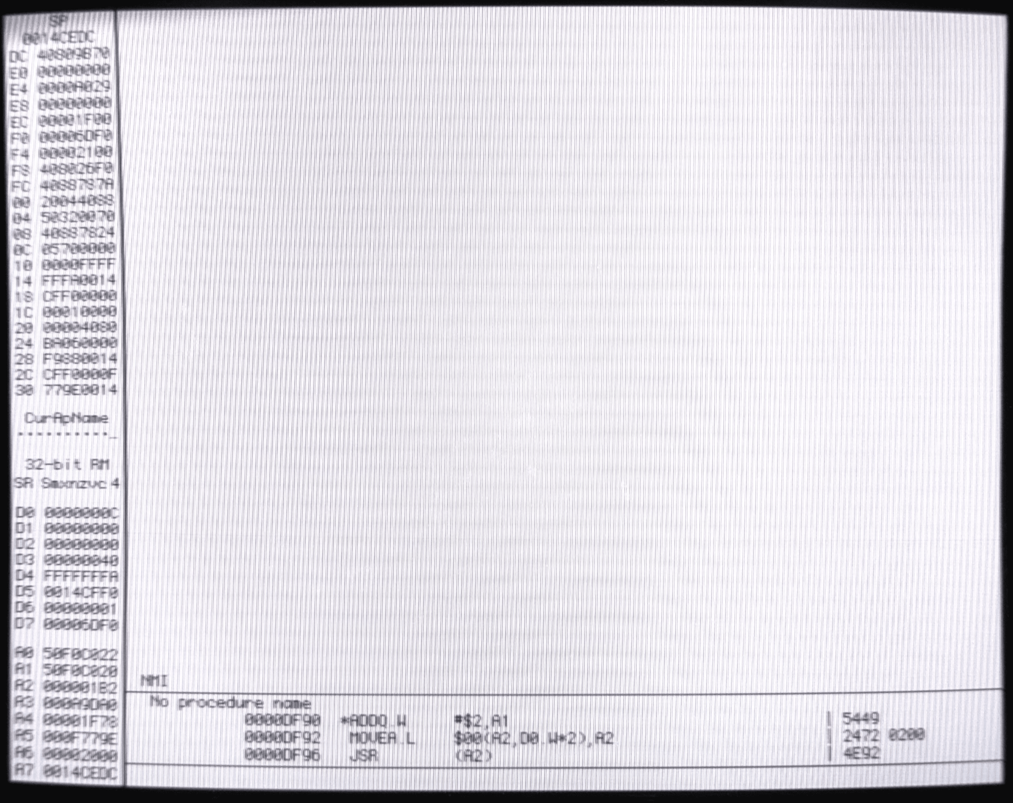

I've also been talking to @eric via PM, and he asked me to install Macsbug and then enter the debugger by pressing CMD & PowerKey at the time of the lockup. When I do that, I see the following (two different screenshots because I tried it multiple times):
To escape out of the debugger, I type "ES" and press RETURN. Most of the time, that triggers a total machine freeze, and the arrow pointer no longer moves when I move the mouse. But there are those rare times when I type "ES" and press RETURN, only to find the machine then boot to the Desktop. So the sheer act of jumping into and then out of the debugger can sometimes cause the machine to boot into 7.6.1.
