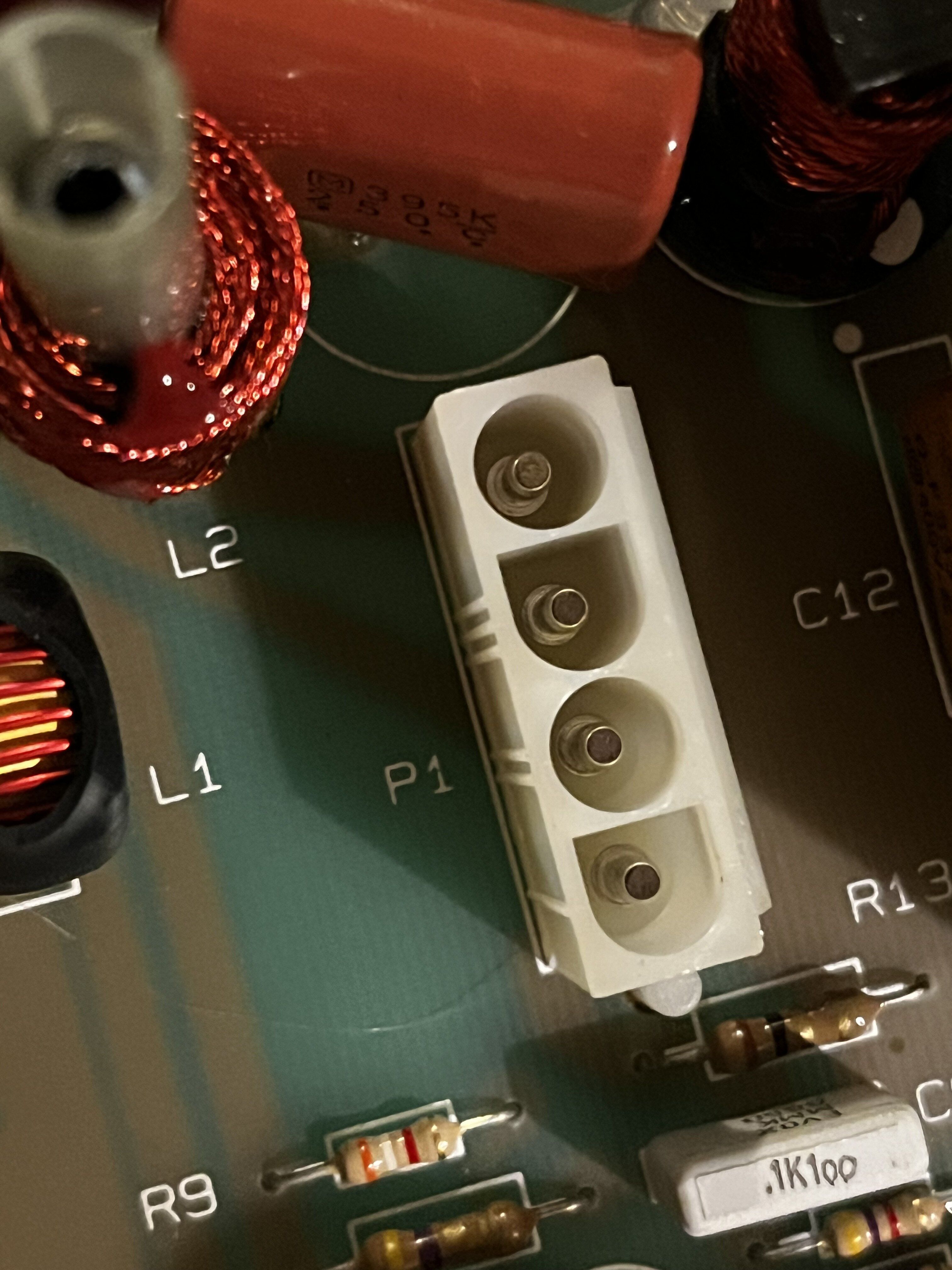

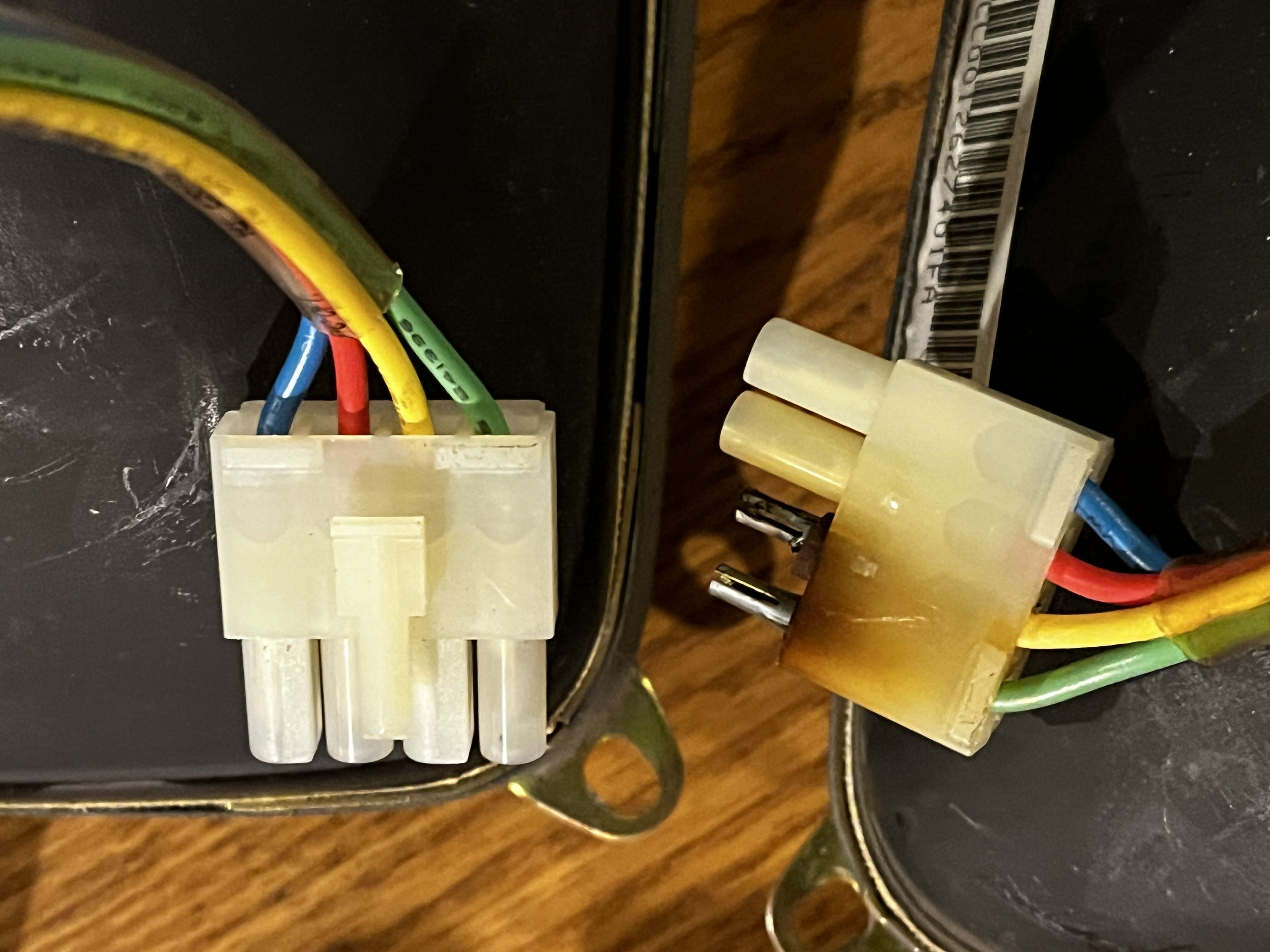

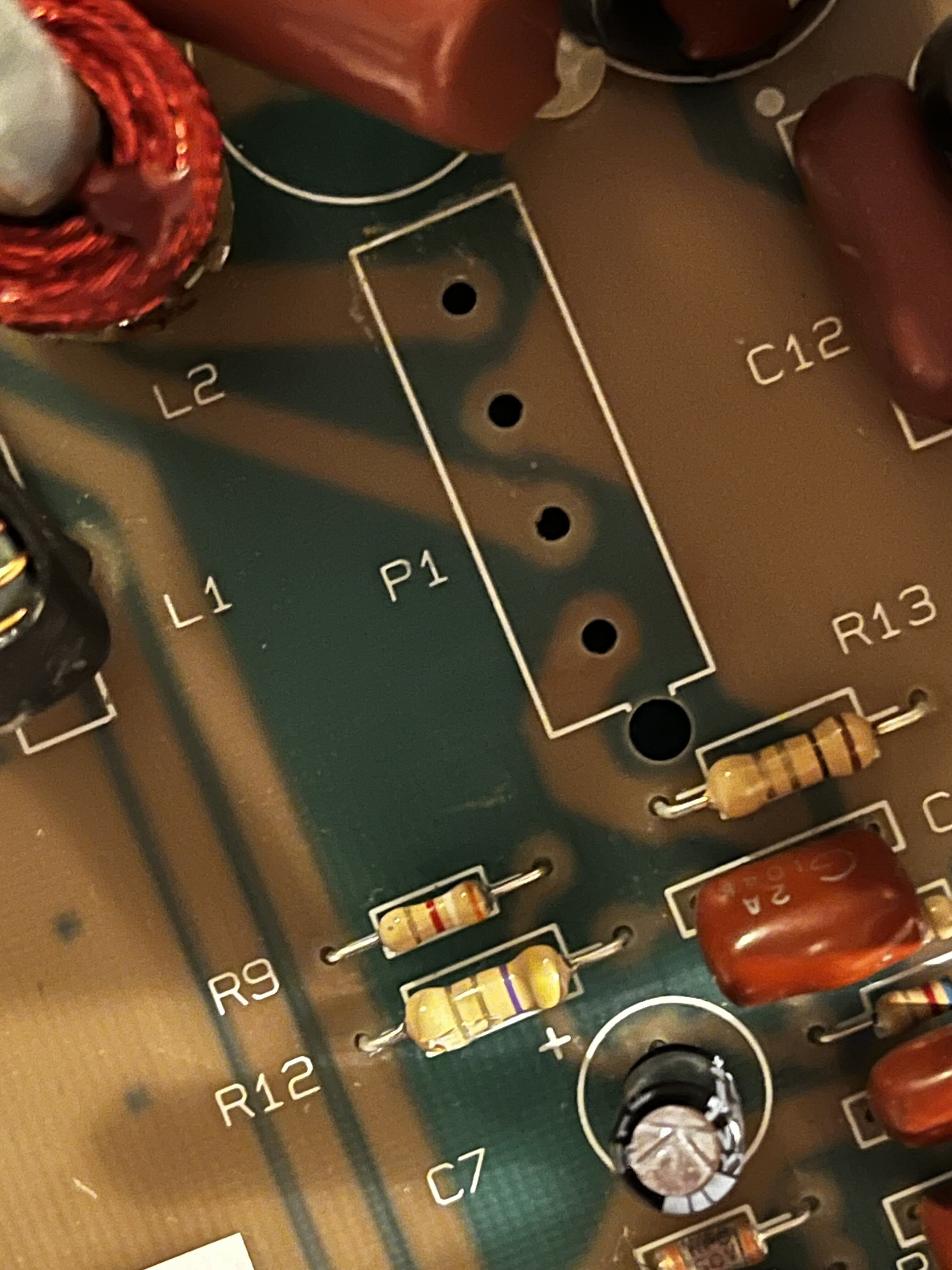

I received an SE with a burnt Molex P1 connector to the Analog board (the yoke cable).
I was able to remove it from the board.
I'd like to replace the part on both ends: the Female connection on the board and the Male plug on the CRT.
What are these part names?

P1 on the analog board is Molex part number 15311046, and the shell for the CRT cable side is 19091049. Both are available from Mouser/Digi-Key if you'd rather order them that way.
