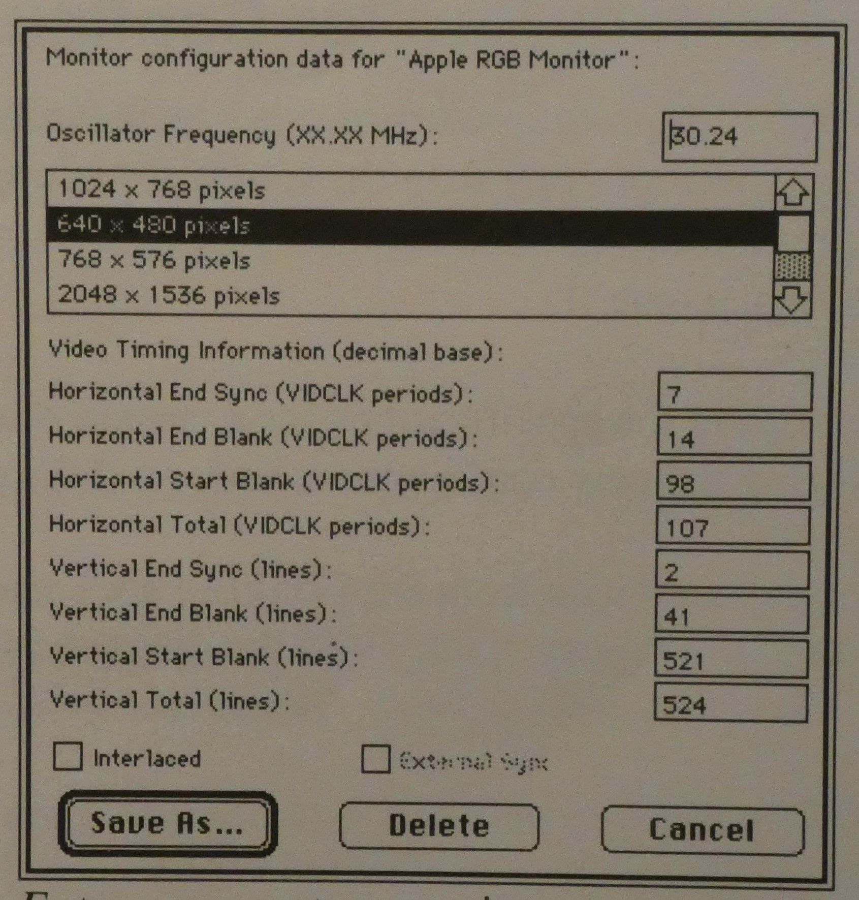

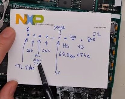

It must be horizontal according to the timing info posted at
https://68kmla.org/bb/threads/page-...t-baby-step-to-cloning-card.52646/post-594899

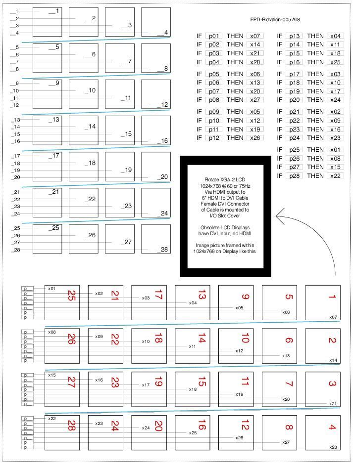

57.283 MHz = 17.4571862 ns
68.85 kHz = 14524.3282 ns
75 Hz = 13333333.3 ns
width = 14524.3282 / 17.4571862 = 832 pixels. (less than the active vertical height of 864 lines so this must be horizontal)
height = 13333333.3 / 14524.3282 = 918 lines.

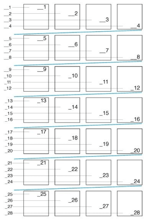

The image scans as I've illustrated it.
from start, scans across 640 pixels, doubles back, drops one row . . . repeats 800+ times.
RGBtoHDMI centers the output mid-screen just as does my Extron Scaler. Neither setup supports rotation to get practical use of FPD 640x800+ output.
832 pixels wide = Front Porch (x pixels) - 640 Pixels - Back Porch (y pixels)
918 Lines = Vertical Start Blank (x lines) - 864 Lines - Vertical End Blank (y lines)
21:45 "It's literally outputting scanlines less wide than they are tall."
Poor choice of words in that sentence, he's describing the scan line in table above overall, check 24:00.
Image is built up exactly the same way a 640x480 is built, just the aspect ratio is higher than wider. It's done in hardware in both cases..

Rotation of a ~70KB frame buffer is trivial for even the slowest of PIs, but it's awkward to do in hardware. 1-bit graphics, VRAM serial data and monitor rasters are all row (not column) oriented.
No, I've been saying all along that the card performs no rotation at all. It builds a standard horizontal scan 640x864 image that needs to be rotated to be useful on the target displays.
At present, there are no solutions for rotating the image outside of very high end systems. cloning with built-in rotation is the only option.
Ok, so what you want to build is not a faithful reproduction of the original card, but a replacement that will drive modern displays?
If so, then forget about the VRAMs, which are bound to generating raster output in one orientation.

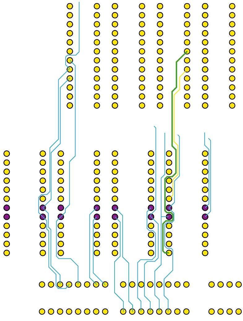

Currently buzzing the board for schematic capture as I'm wire wrapping a prototype. That'll need to be done eventually for cloning the card. At this point I'm hoping output from the four GALs would be the place to do screen capture. I'm concentrating on VRAM to GAL connections. If all I need is output from four GALs aligned with VRAM, so much the better. I could move the carrier board topside and plug it into the GAL sockets, moving them onto the carrier.
So far so good. View is solder side, need to square up ground pins.Note the curious ground line connection (Green) between VRAM and GAL. Best WAG for that would be grounding the sense line on the video connector, testing monitor connected case? Dunno . . . it's a mystery.
edit: No mystery there hadn't mirrored the pinout. The green trace is from pin 1, not ground. OOPSIE. :oops:

Hence, the rotation transform mostly filling a DVI display at 1024x768, rotated to portrait orientation.

Worked out the rotation transform, that's what kicked off the current edition of the project. Undoubtedly requires more horsepower than any available SBC. All I need is page buffer data capture in the top left frame.
