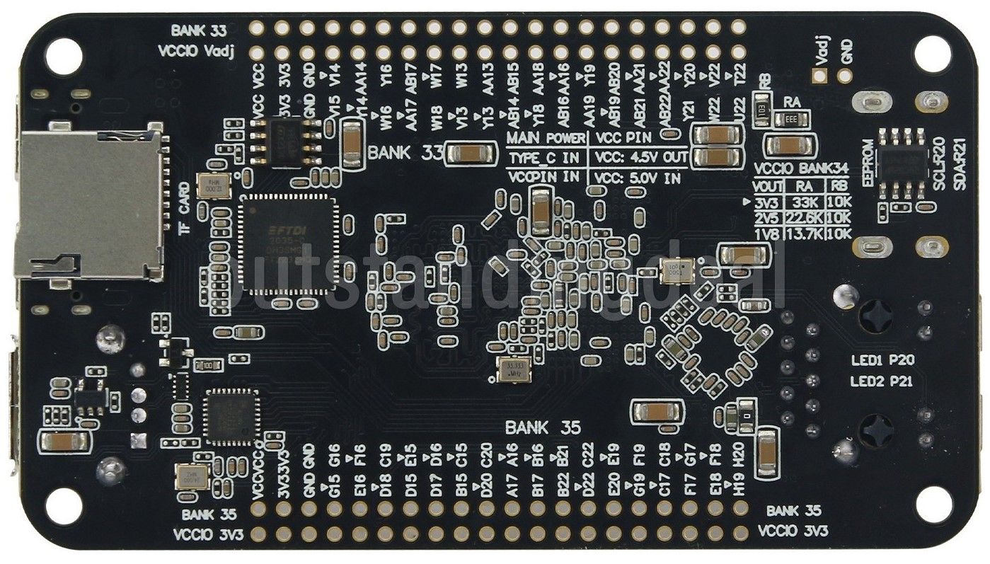

We know from the video that RGB2HDMI can handle the pixel clock. Only the rotation transform is missing and not sure even Pi5 can pull that off. Some inexpensive FPGA Dev Boards cost less than Pi5 anyway and they too have HDMI out.
