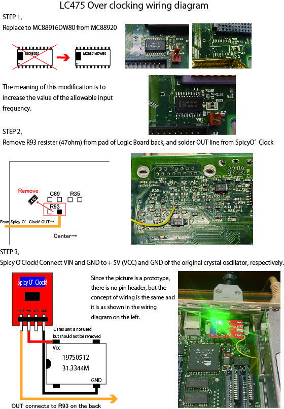

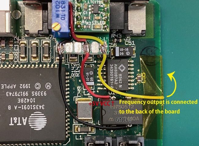

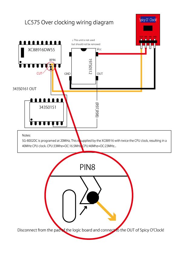

The LC475 and LC575 methods are slightly different, but cut the pin input of the clock driver to interrupt this LC oscillator. The clock driver has a function other than generating the CPU clock, so it cannot be removed.

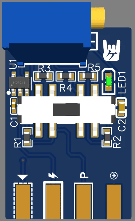

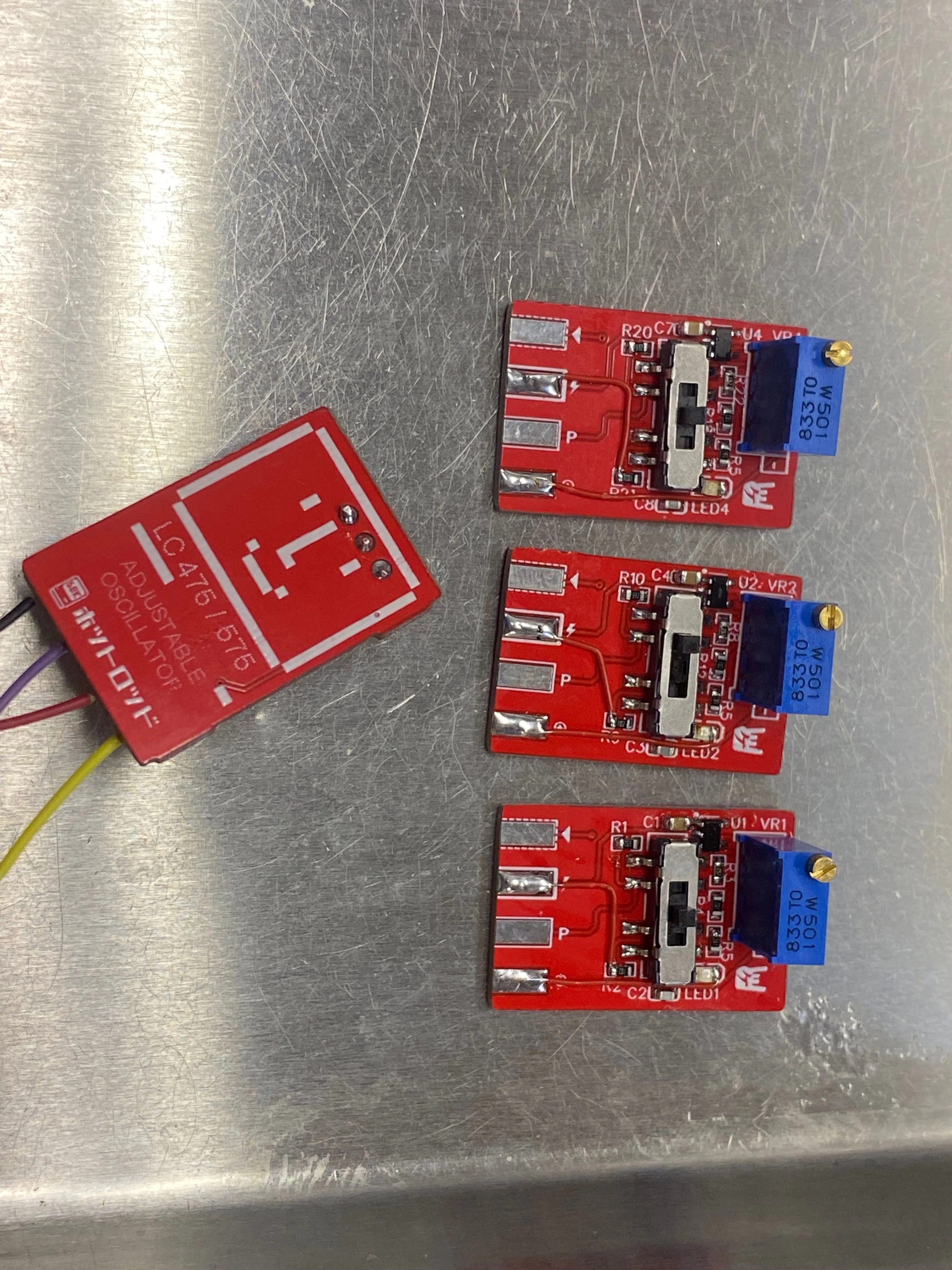

Just a prototype has been made. Make a change a little from here...There were two trace errors.

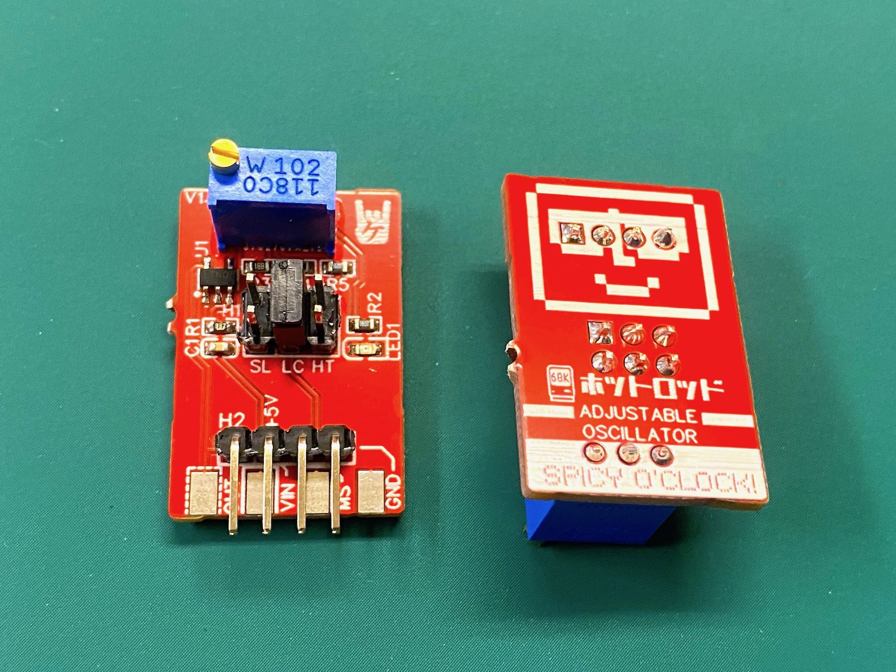

The prototype has a slide-switch, but we will replace the pin header and the jumper pin.
Test with LC475
Test with Centris650 (Wombat board)

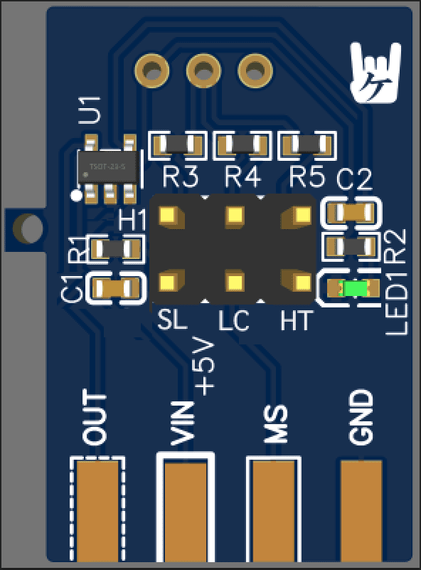

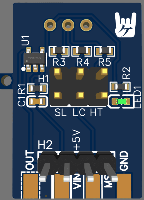

I've created an overlap to make it easier to use.
1: SL Mode 37.96MHz to 41.76MHz
2: LC Mode 41.79MHz to 46.48MHz
3: HT Mode 45.9MHz to 51.49MHz
In the actual product, the switch is abolished and replaced with a header pin and a jumper pin. This means less deterioration over time and less chance of failure.
The variable resistance trimmer can be set to any frequency by simply setting the resistance measurement mode of the multimeter and measuring the number of ohms without using a frequency measuring instrument.

We have updated some.The Ver1.2 PCB has already been ordered and will arrive at us in about a week.
Some will be distributed to testers and then the product will be released.
- The switch has been replaced with a pin header. It will not break down, so you can use it with confidence for decades.
- Added 4-pin headers in addition to the pads for each output. The user can choose which way to connect.
- Removed one unnecessary capacitor.

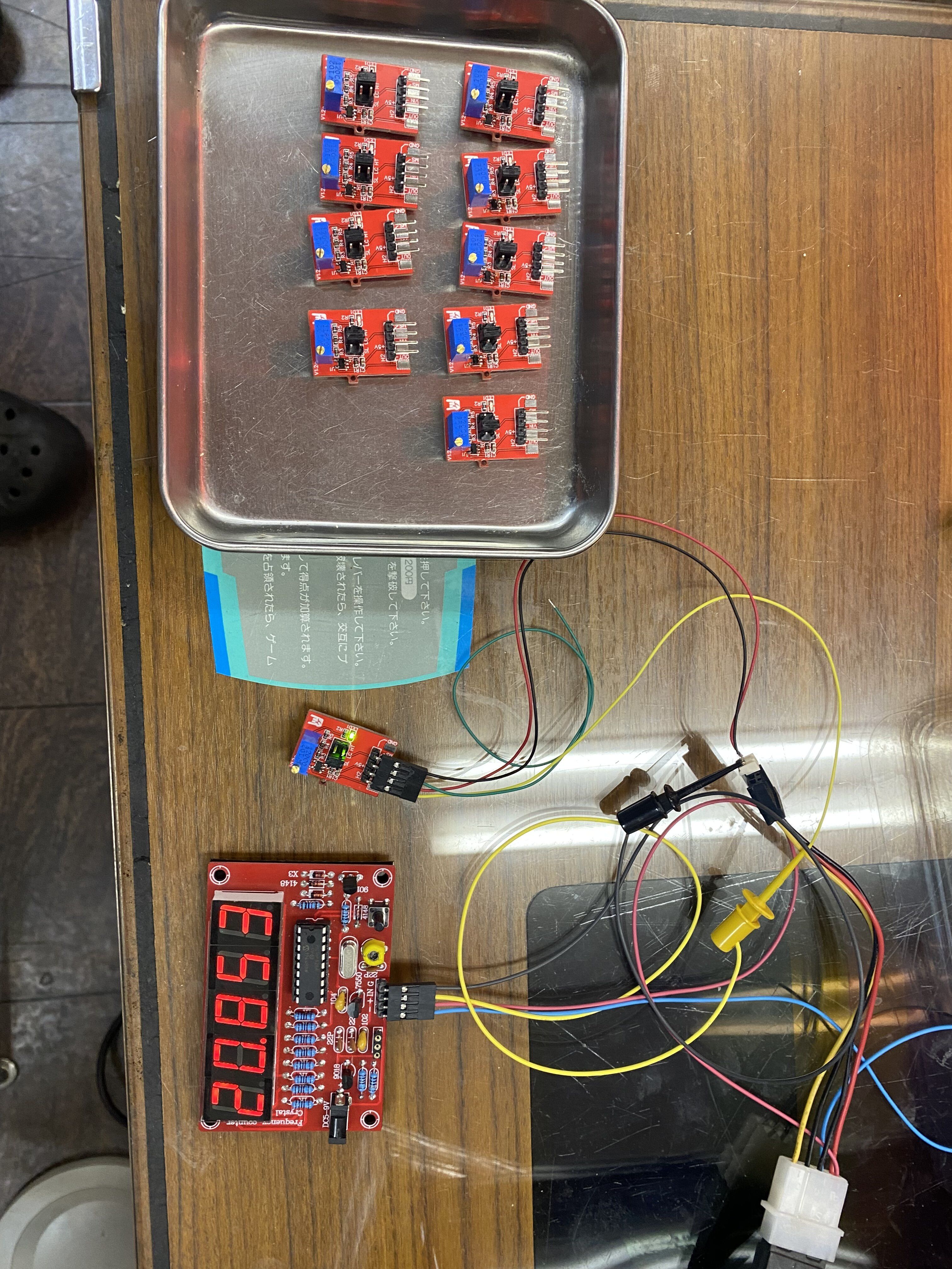

Hi folks, The Spicy O’Clock! V1.2a PCB modifications were perfect and I made 10 spicy oclocks yesterday, they works like a jet! We plan to sell 20 in the first batch. However, the production of the manual has not caught up. I'm writing a manual now, so please wait for a while.

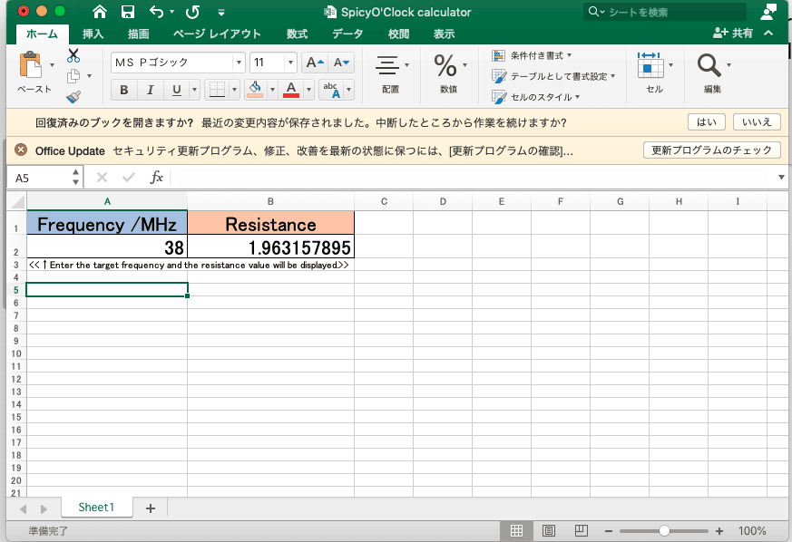

Spicy O’Clock! Calculator web version
Spicy O’Clock! Can obtain the target frequency by measuring the resistance value of the probe point (between VIN <> MS).
I made an Excel macro with the formula I made above, but Stephen Arsenault made it a web version on his page and remade it. You can raise or lower it with the slider, so please try it.
This formula is a theoretical value. Please note that the values may vary depending on the usage conditions and individual differences. We also know that if your Mac has a high clock, the resistance will shift in the lower direction. A frequency counter is recommended if you want to set up for a high clock.
Hello new user here! I've been lurking on this forum for a few weeks now, after recently resurrecting a couple of vintage Macs that I used 20 or so years ago. After seeing the YouTube video by JDW on Spicy O'clock, I impulsively ordered one, without completely understanding all of the mods that would be required on my LC475, specifically the IC swap. I do see that there are MC88196DW80 available on eBay, but whether or not I could swap it out successfully is questionable at best. A question I have is, would leaving the MC88920 installed cause any damage or just make for a completely unsuccessful mod? As I watched JDW's video several times, I had already decided that ~42mhz would be my target and 40mhz would be better than the 33mhz I'm currently at, courtesy of a clip on gizmo purchased back in the day. This also as I do sometimes use a serial port joystick. I would assume that whatever course I may take, I would need to remove the clip on device...Correct?
Thanks!
