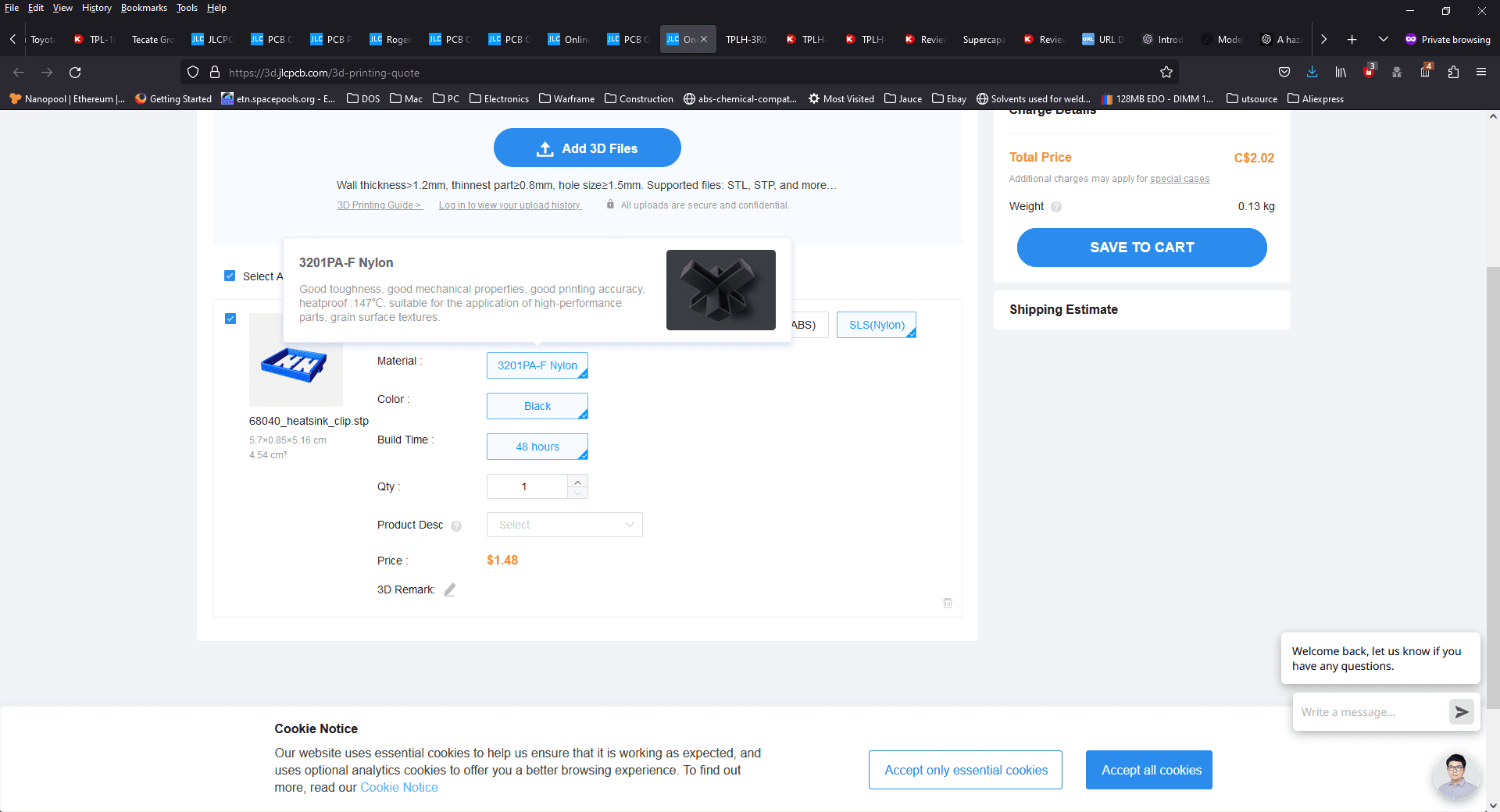

I'd probably consider getting one done using SLS and 3201PA-F Nylon. It's good up to 147C and it only costs $1.48 USD + shipping on JLCPCB for 1 clip.
I probably order one at sometime in the future just to see what the tolerances are like compared to my Prusa i3 MK3S which is a FDM type printer. It probably won't be anytime soon though since it's not a priority.

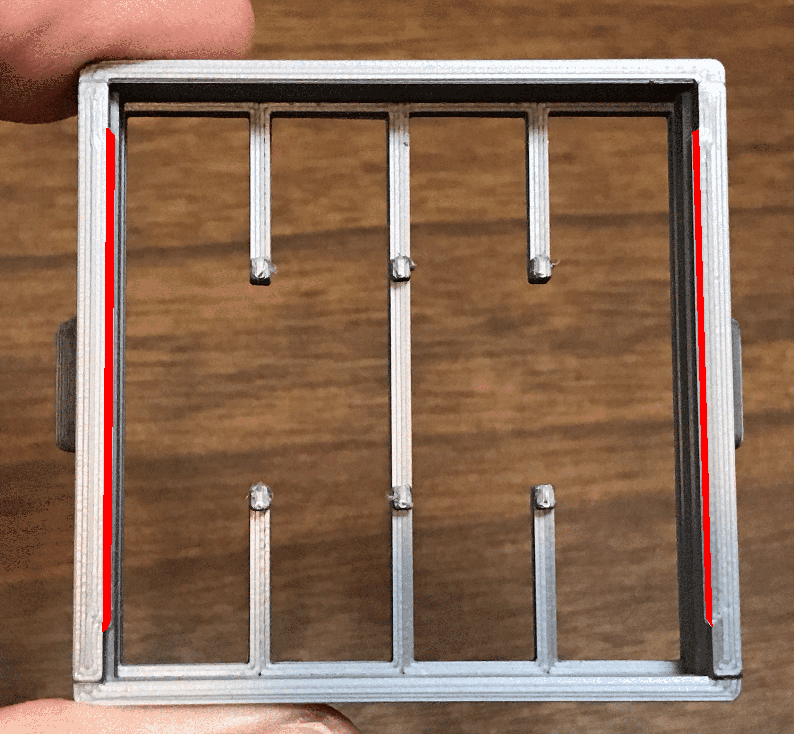

The only other thing I noticed about the PLA-printed sample I received (again, see my earlier post for photos), was that the little "lip" that I believe is supposed to go below the edges of the 040 CPU is very small. I've colored that in red below...
I've not tested anything yet, but I must assume that "lip" to be the weakest part of the entire clip. All the force of the clip used to press the heatsink down atop the CPU will rely in the integrity of those two tiny lips. With a vinyl part, I would not have any doubt it would hold well over time. With lesser plastic, I am not so sure. Again, you need a fair amount of force to press down the heatsink hard against the CPU (with thermal paste in between), plus we must consider the impact of heat coming from the heatsink, which I believe will be close to 60°C even with a fan in some cases.

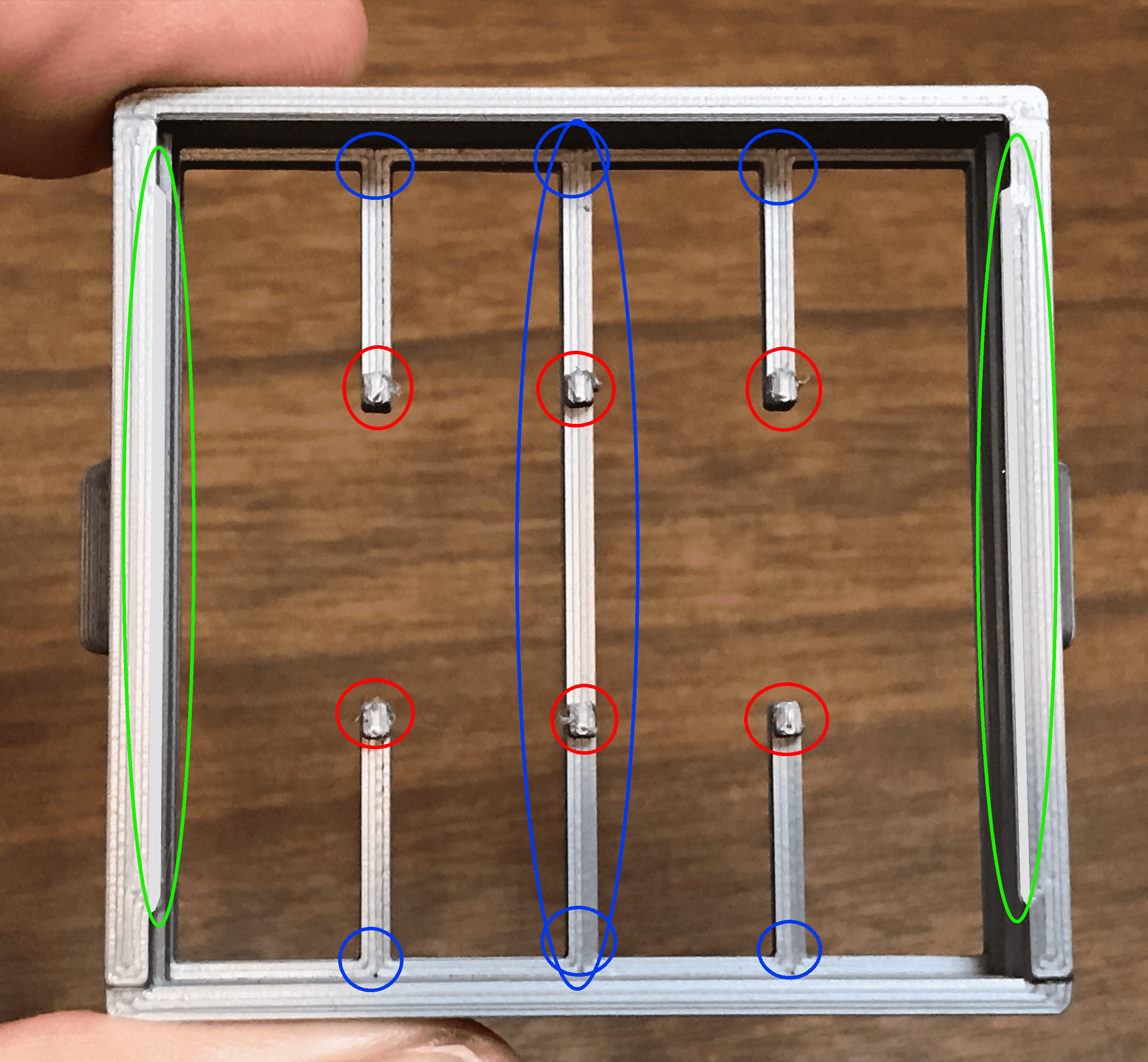

For FDM printing PETG has other properties that make it goo for the forces involved in the application of a heatsink clip. PETG has excellent strength and flexibility without breaking or deforming. When I designed the heating clip I into account. Let's take a look at this picture:
The red circles are providing downward force onto the heatsink and CPU is providing and upward force against the clips circles in green.
The torque applied to clips in the green circles don't have much leverage so are unlikely to break. The walls of the clip are also thick to prevent them from bowing (that's not the only reason they won't bow easily), which if they could, could also allow the green clips to detach from the CPU. The wall thickness of the clip also helps prevent permanent deformation of the clip when installing and removing the clip.
Now the the downward force of the red point result in torque being applied at the where these levers attach to the heatsink represented by the small blue circles. These points are the most likely to deform/break. PETG being strong and flexible will prevent this from happening as long as there's continuous strands of plastic perpendicular to the force. So the orientation of printing the part on an FDM printer is for just for ease of printing, It's maximize the strength at points of stress.
Now you have noticed that the middle has a continuous strip of plastic unlike the other 4 smaller levers. This is to provide additional downward force in the middle of the heatsink is (since the die is there) through tension along with torque resistance. This also makes it very hard to snap at the ends.
You may be asking why I didn't do continuous strips for all of them if it's superior. Well, plastic is also an insulator so I'd like to cover as little as possible of the heatsink's surface to allow better heat dissipation.
Regarding heat concerns, the hottest part of the CPU will at the center of the CPU. The points of contact there are the red dots in picture which are small to help prevent direct heat transfer. If 60C is the max temperature when overclocking with a fan it should be fine.
I wouldn't consider those clips marked in red as the weakest point. If it's PLA I'd be more worried about the little arms pushing down on the heatsink snapping off.
Regarding installation, you're not meant to forcefully snap on the clip with no tools. You're supposed to clip on one edge of the clip to the cpu and then bow outward the other with a screw driver so it can clip on the other edge. This is similar to how those old metal heatsink clips used to be installed. If the clip is made of PETG then it shouldn't deform the clip. PLA is more brittle but I did make the plastic pretty thick so maybe you'll have no problem bending it without breaking. You may mark the slot for the screw drive but that's cosmetic.
Now, will you be able to install and remove the clip hundreds of times without damaging it? Probably not, but these types of plastic clips aren't meant to be installed and removed that much.

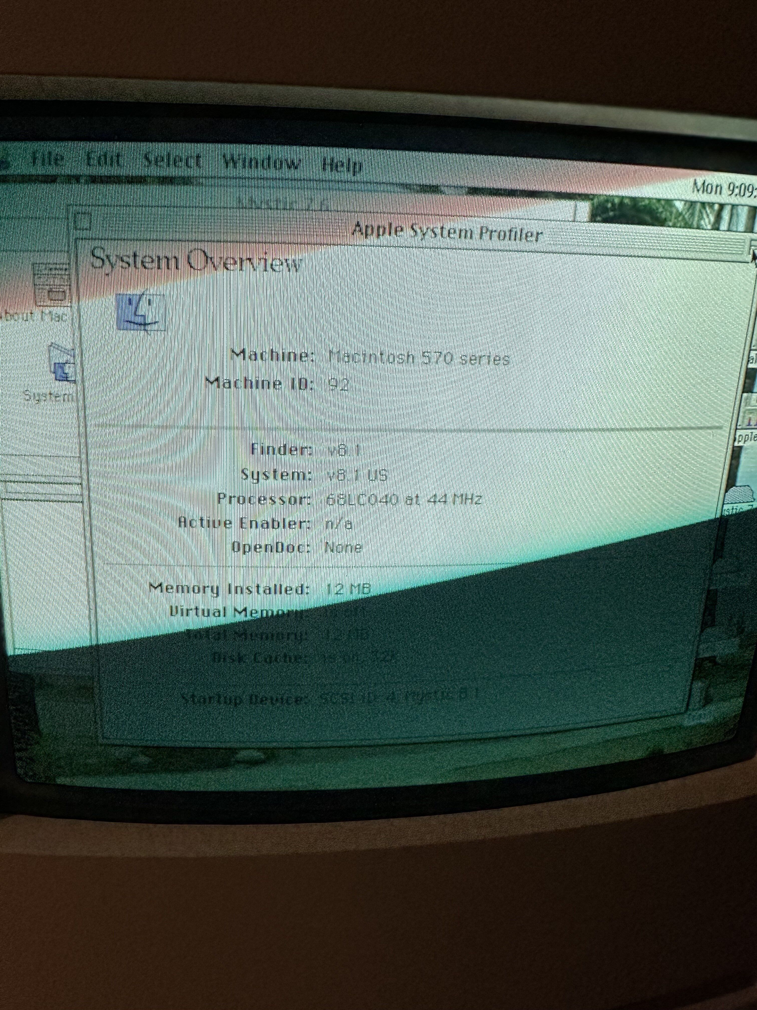

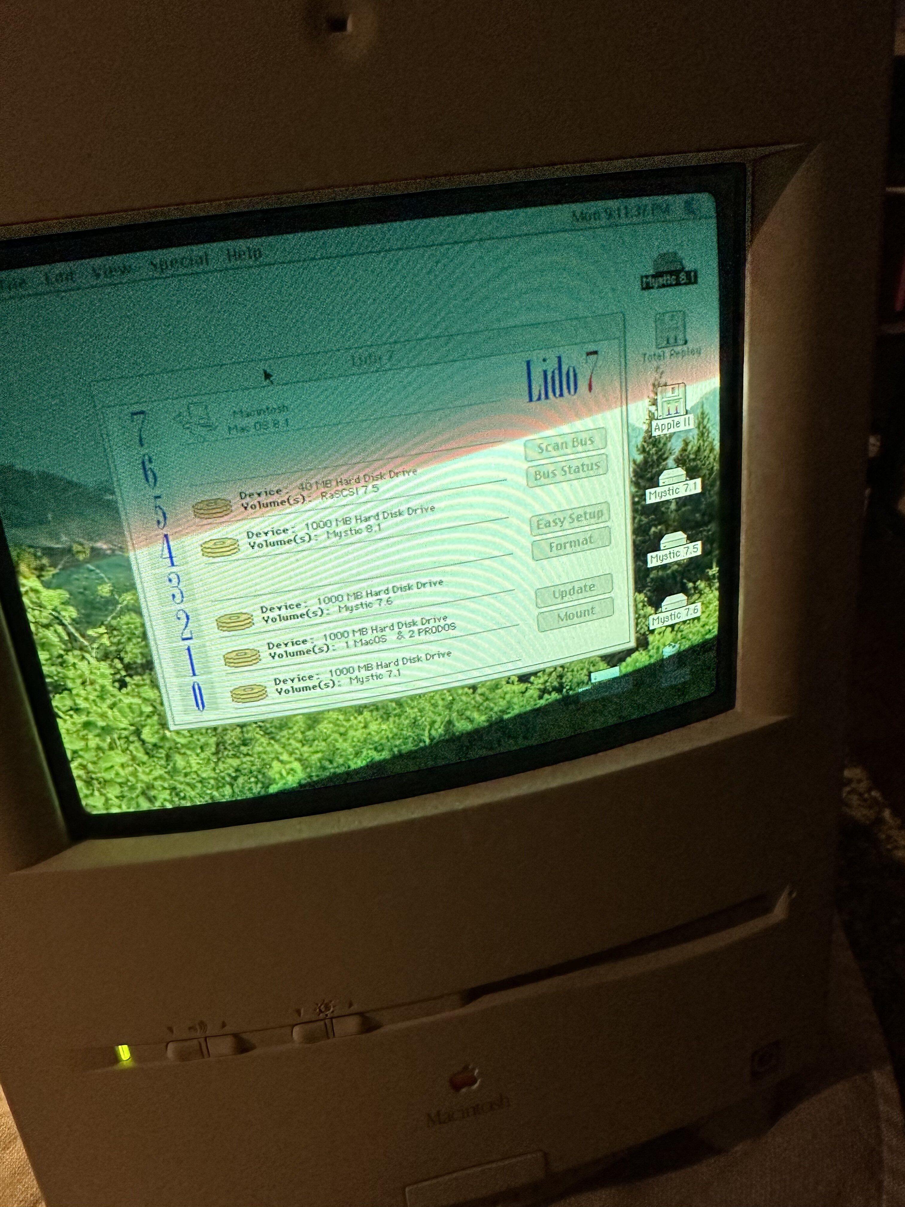

Hey, just wanted to send shoutouts to @Kay K.M.Mods , @Drake @jcm-1 and @mrfahrenheit. I had Drake install OS Cons on my 575 board, Joe installed the Spicy and I’m running the 60ns VRAM. I have a heat sink and fan, running steady at 44 Mhz. Apple IIe card installed, Total Replay, BlueSCSI with 7.1, 7.5.5, 7.6.1 and 8.1 partitions. Prior to the OS-Cons and some cleanup, the machine would overheat and lock up after 30 minutes. I’ve been beating up on this for several hours and it’s rock solid. Will check serial ports/MIDI and floppy reliability shortly. I really liked @Action Retro ’s PPC card video. Very curious if you can run the IIe card and that PPC card at the same time, and also would OS9 run on the 601 or does it need the 604?
