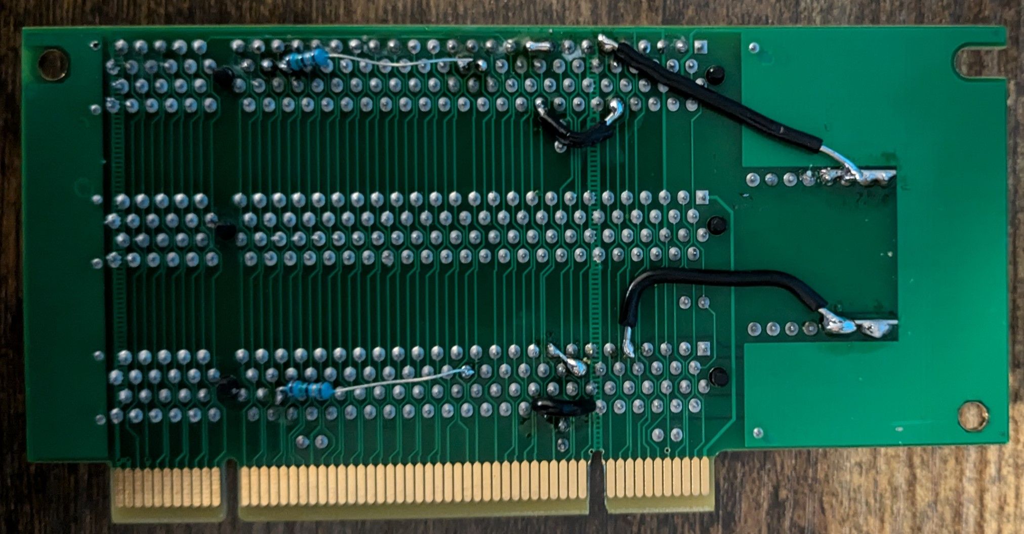

All four interrupts are tied together on the motherboard for Slot_A and on my test riser for all three configurations. Sot_B1 is implemented on Apple's 6x00 Riser just as I've implemented. Can't imagine any reason for Slot_C1 to behave any differently than that OEM riser's Slot_B1.
I said the interrupts were probably ok for A,B,C because there's an interrupt pin on OHare for each of them.

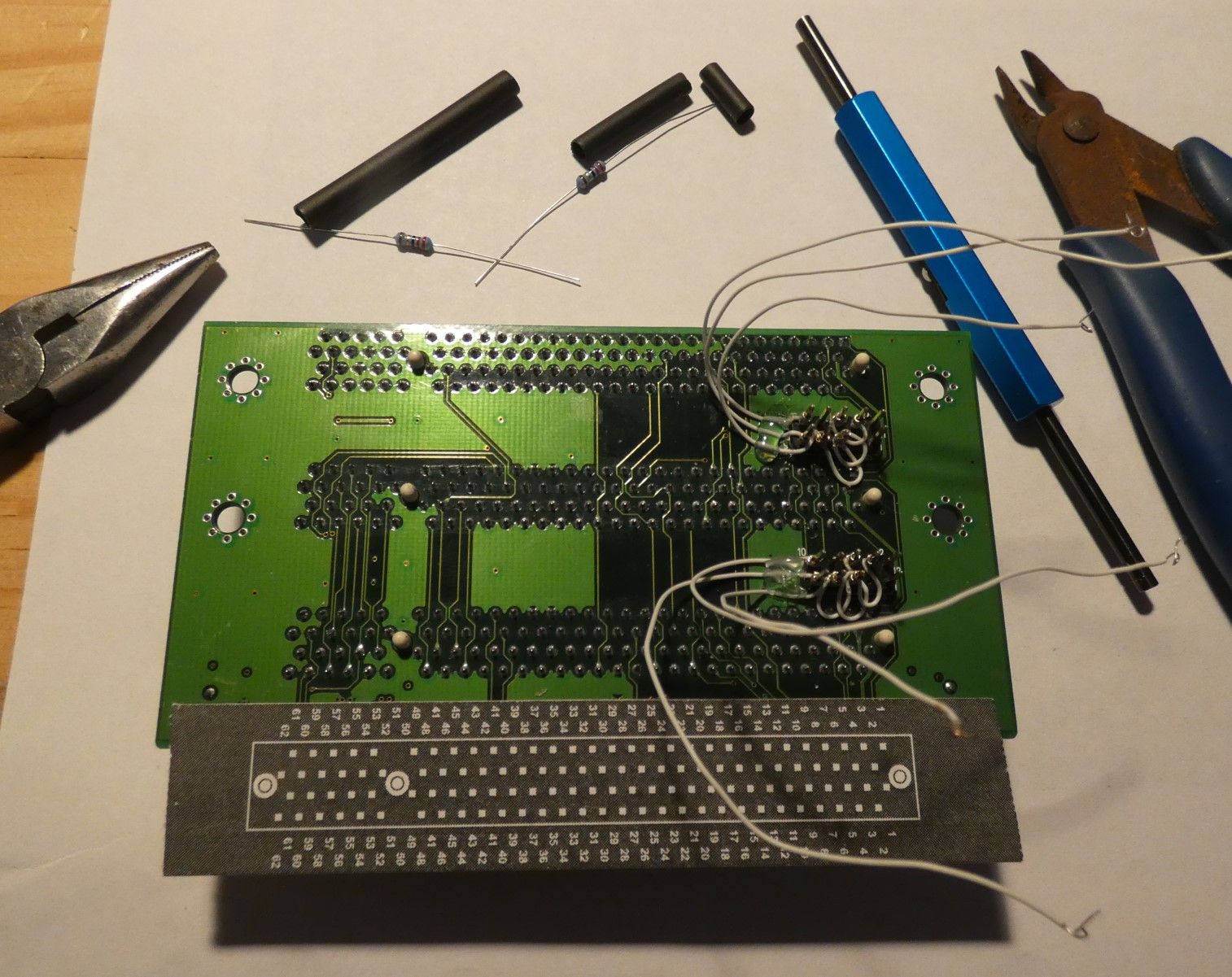

Its the GNT and REQ for C that I'm wondering about. Did you find out if A19 and B10 are connected to anything?
Dunno, I've wrapped this borken test unit project up until I feel the need to bodge connections on one of my three slot PC Risers. Daniël has done so, but not had the ability to test it yet. I'll just tag along after his lead.

Almost unbearable curiosity was aroused by the A/B/C C-600 Riser @trag posted. This has been satiated and then some. ;)
I think interrupts should be working, so you can move the mouse around the display connected to slot C.

After I get a PC Riser or two up and running it'll be time for methodical troubleshooting. Very curious to see what the results will be with your Open Firmware approach to this. Wishing I'd not concentrated so much on collecting Gazelle boards over the years so I could send an Alchemy board out to someone for using your program. I think I've only got the two Alchemy boards. ;-/

Don't recall which of the many configs I played with last night showed a problem with the mouse freezing. VidCard I've been using is a deader, but ROMs show up just fine. Hooked up an ATI Rage128 with DVD decoder daughtercard. One slot or another (probably E1?) had the mouse/cursor freeze when it hit the edge of its window.
You didn't connect an interrupt for E1 so the mouse freezes if you move the cursor onto the GPU that is in that slot. The default interrupt for E1 is the COMM_SLOT_INT. Slot E1 is IDSEL AD17. The interrupt bit is 0x16.

:eek: WTH? No clue here, but it's fun to tag along for the ride.
