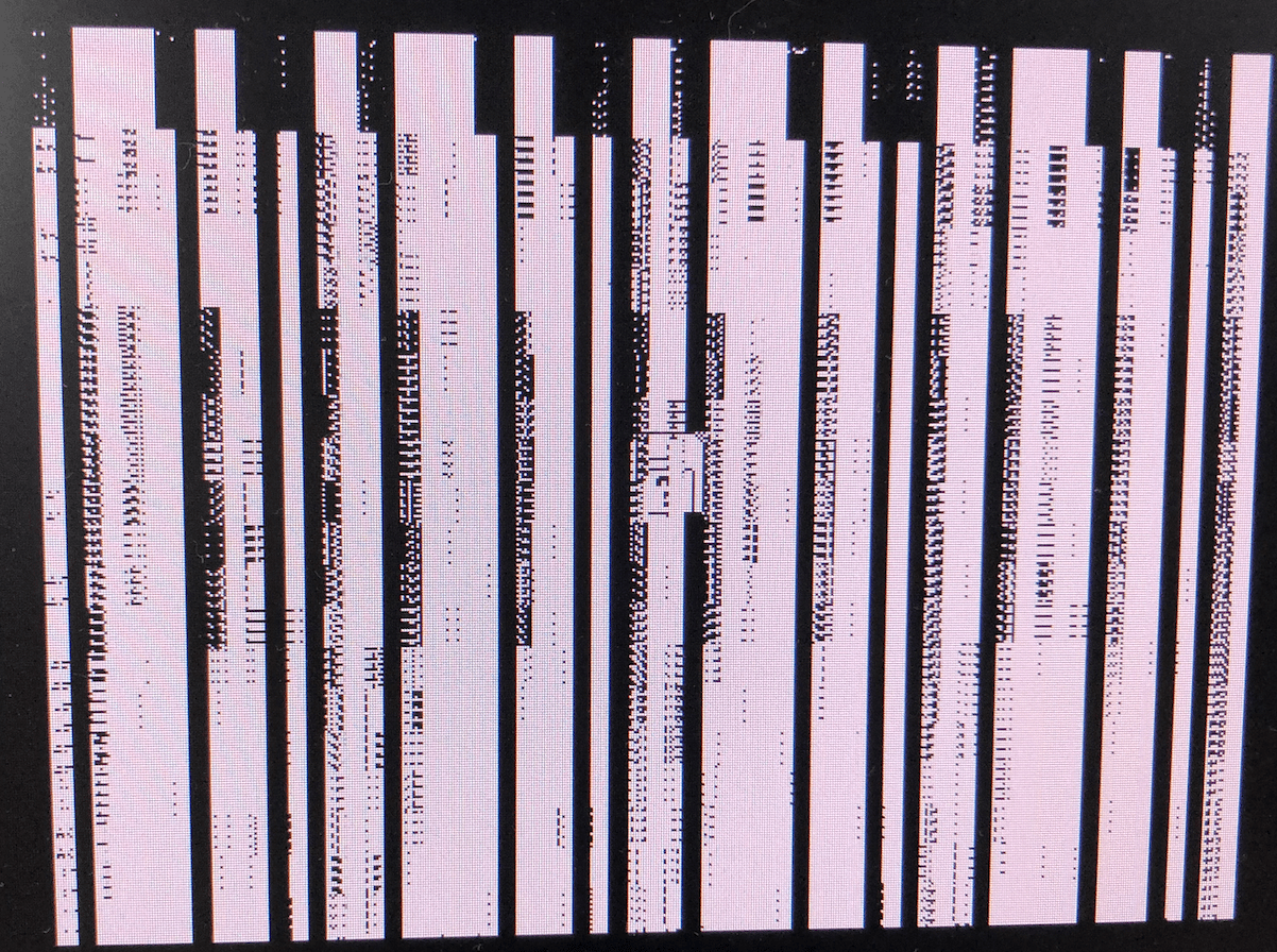

I bought this at a Yahoo auction in Japan, but it was quite expensive. When this is stabbed, it becomes Simashimac (a composite pattern that adds horizontal stripes instead of the usual vertical stripe pattern).
Here's what I did:
-The ROM was replaced by flashing 4.1.1 and 4.0.1.
-Cleaned contacts
-Replaced the CPU with another one that works
None of them worked.
I'm guessing that GAL is bad, I can't do a reverse engineer, so repairs are impossible! But if you can repair it, I think there is also a chance for this. @Bolle Would you like to have this repaired?

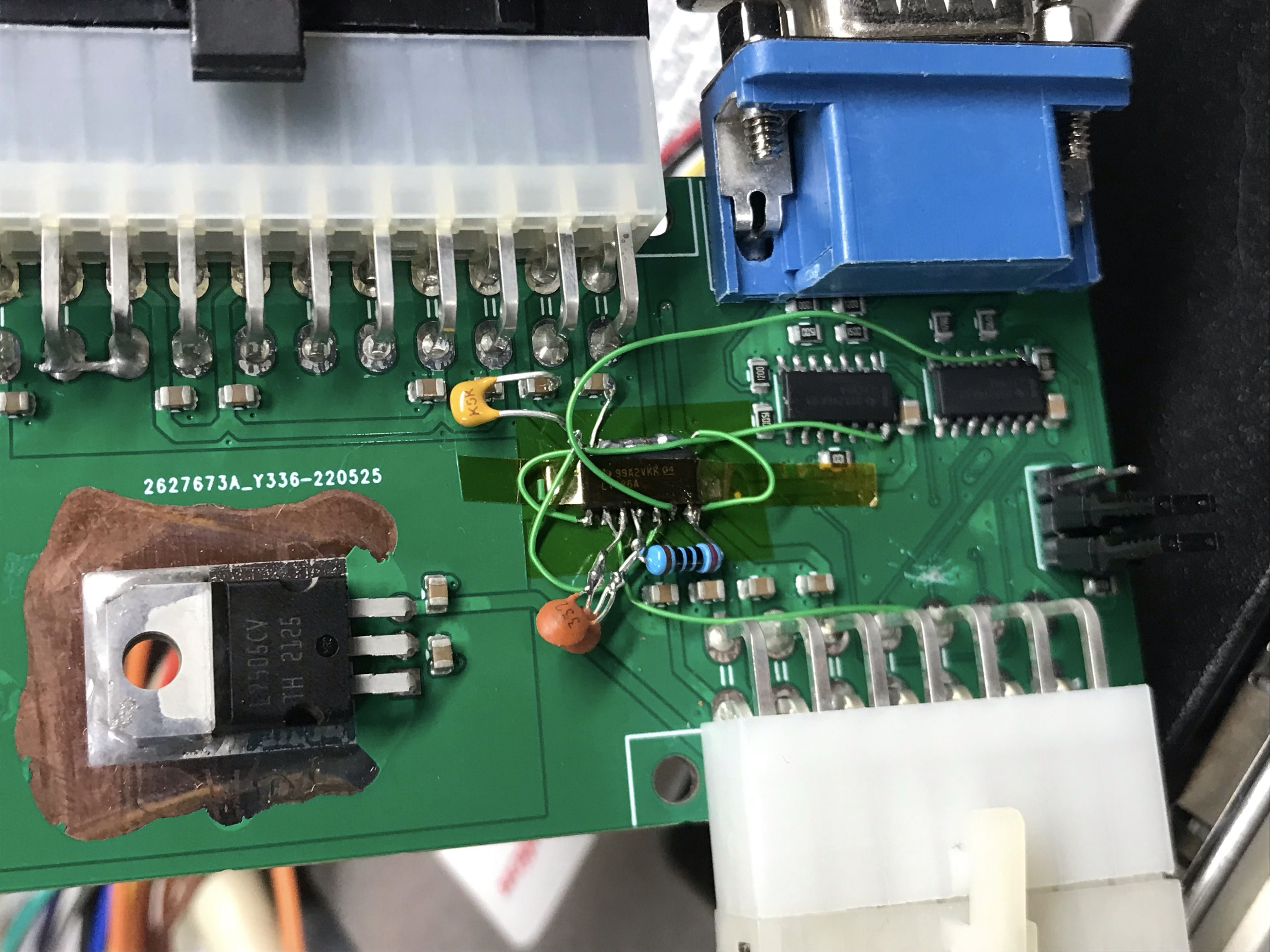

Garrett just fixed the video gizmo with a new bodge circuit:
And now the video is working on the multisync LCD:
Sort of. Guess this Mac SE board is messed up. Gotta fix that and then we can continue.
Edit: That was easy. Just had to jiggle the SIMMs a bit.

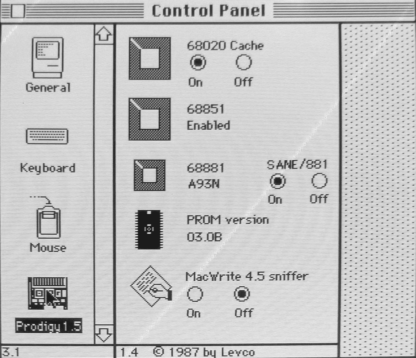

I've been exchanging PM's with a former SuperMac engineer. He mentioned to me today that the ProdigySE could support 8MB, thanks to its 68851 PMMU chip, which is shown in the following control panel...
So merely, connecting address lines alone is not something that would enable more than 4MB of RAM on an SE. The PMMU pages RAM in 4mb chunks. So if any new accelerator like WarpSE were to add RAM as a daughter card (like the ProdigySE did), it would most likely need similar RAM paging via the 68851 or similar chip.
