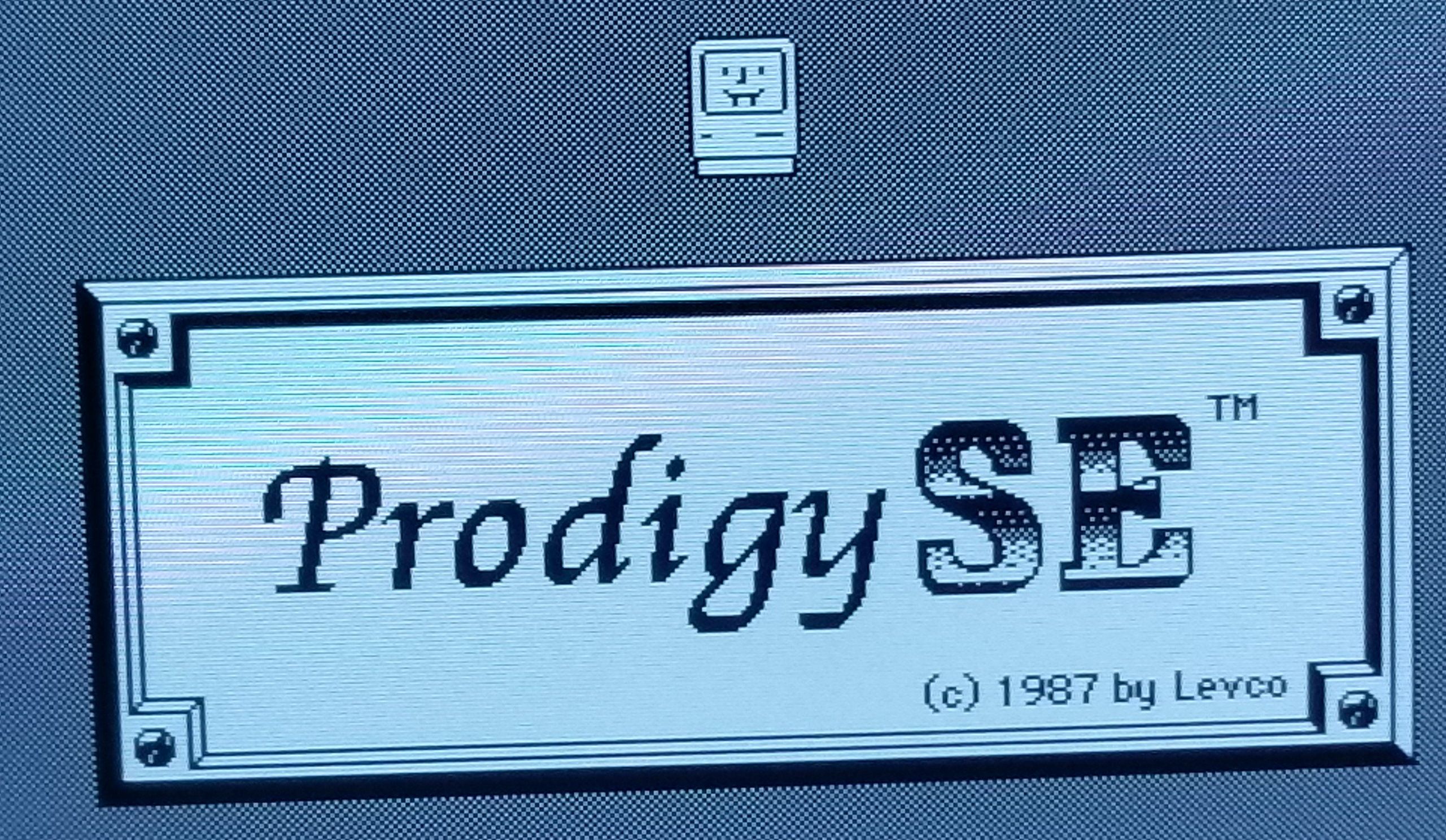

Hi Zane - There was definitely some address magic. I believe the Prodigy SE takes the boot process onboard and replaces the MacSE ROM. The classic Prodigy boot Easter Egg was the Dracula Fang Happy Mac startup (indicating a modified ROM - see attached image). So, the board does its own address decoding. Once you put in a Prodigy board, it's not really an "SE" anymore unless you explicitly disable it with the Programmer's Switch at startup. Otherwise, it doesn't have a software on/off switch, except for SANE and the '020 cache. Also, the board had an optional Bus Transfer Unit (BTU), which passed the bus for use with certain additional SE cards (assuming they fit...and were compatible) -- but don't ask me for a list!
The original ProdigySE boards were 2mb and 4mb and there was a later SKU (and related upgrade mods) to support 8mb that included the PMMU (maybe for older boards that didn't have them -- I think the earlier boards just shipped with an empty socket for the '851) and updated ROM (3.0b, I believe). IIRC, later board manufacturing runs had a built-in PMMU and the newer ROM, and I think the upgrade kits just included the higher density RAM module. I will think about it, but that sounds approximately right.
I hope the above is helpful. I will post some pictures.

Answered above. I also just attached the Dracula Happy Mac image at boot to that post.
The other input I can add is that one of the residual problems with the board from 1988 was that it was not compatible with the FDHD floppies...and the logical reason for that problem is because it was based on the earlier MacSE ROM vs. the updated FDHD version -- so only 800K. I will add it to my research list. I now have old ROM and FDHD SEs.

I'm not sure exactly how much of the ROM the ProdigySE/Prodigy 4 integrates, except to say that it, at least, replaces the boot code. The bin file is on MacRepo, so you can check it. The User Manual also has interesting programming and architecture notes. Prodigy displays a custom splash screen at power-on/startup and replaces the boot Happy Mac. The fact that FDHDs don't work at max capacity points to integrating more (or all) of the (Old SE) ROM vs. less.
The Prodigy SE uses 32-bit addressing and had a max RAM expansion of 32mb. It is capable of using motherboard ("lower") RAM as a RAMDisk (that bridges motherboard and Prodigy RAM). However, beyond 4mb, the board needed a custom PAL and Gate Array.

So are you saying that the Prodigy ROM puts up the “question mark disk” icon, loads the boot blocks into RAM at 0x10000, puts up the “vampire Mac” icon, and then executes the boot blocks loaded from disk?
Not sure if info's a help here, but can confirm that the Radius Rocket does much the same thing as Prodigy at startup. Rocket/Whoosh screen exhibits after ROM is copied into memory on the Rocket in second boot.
Two reasons I think:
2nd - access from ROM copied to RAM at the clock of the Rocket's local bus is faster as it would be on Prodigy as well?
1st - Radius licensing for use of the crown jewels uploaded from a single Mac host across a bank of Rockets under RocketShare.
