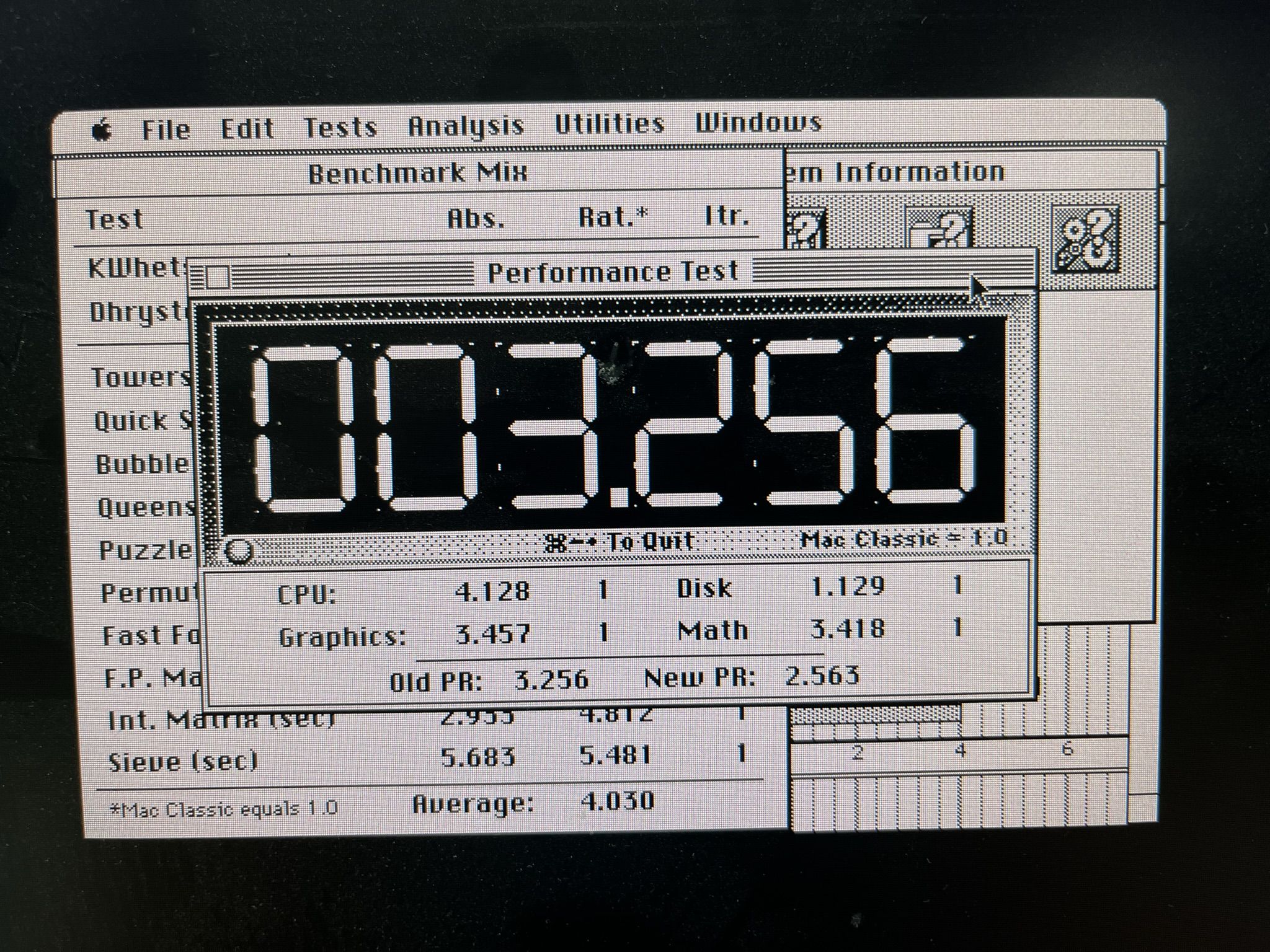

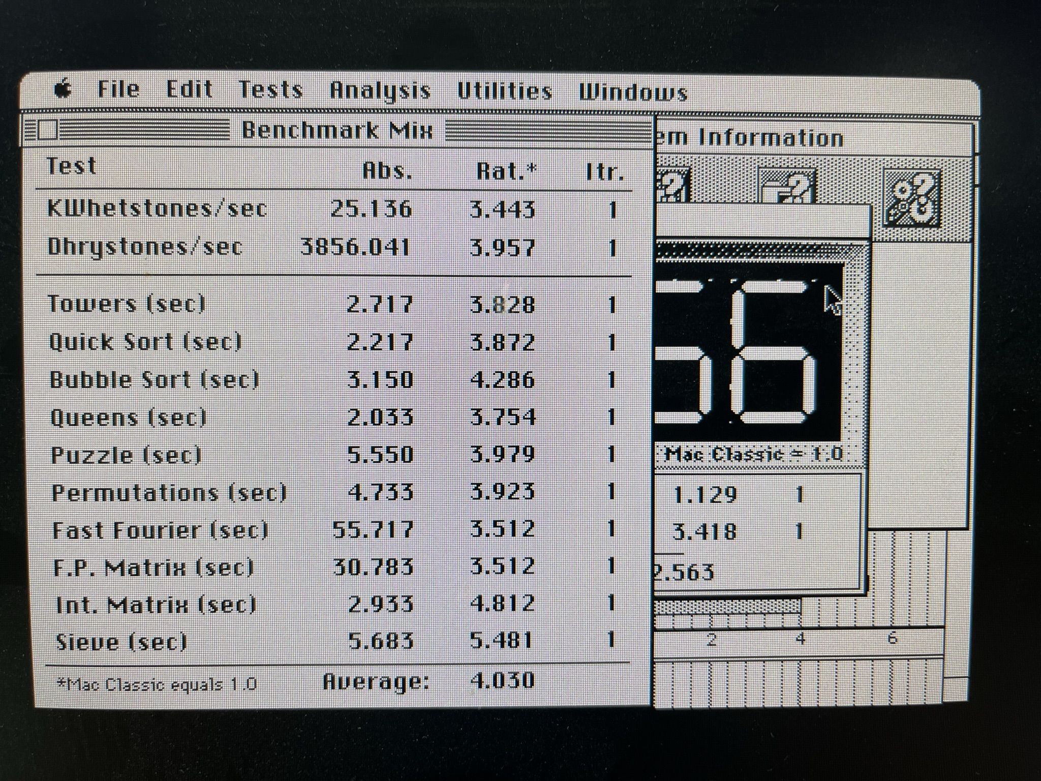

Speedometer 3 results at 25 MHz are looking great:
4.1x faster in "CPU" and 3.5x faster in graphics! I thought it would only be up to 3.8x faster. Huh.

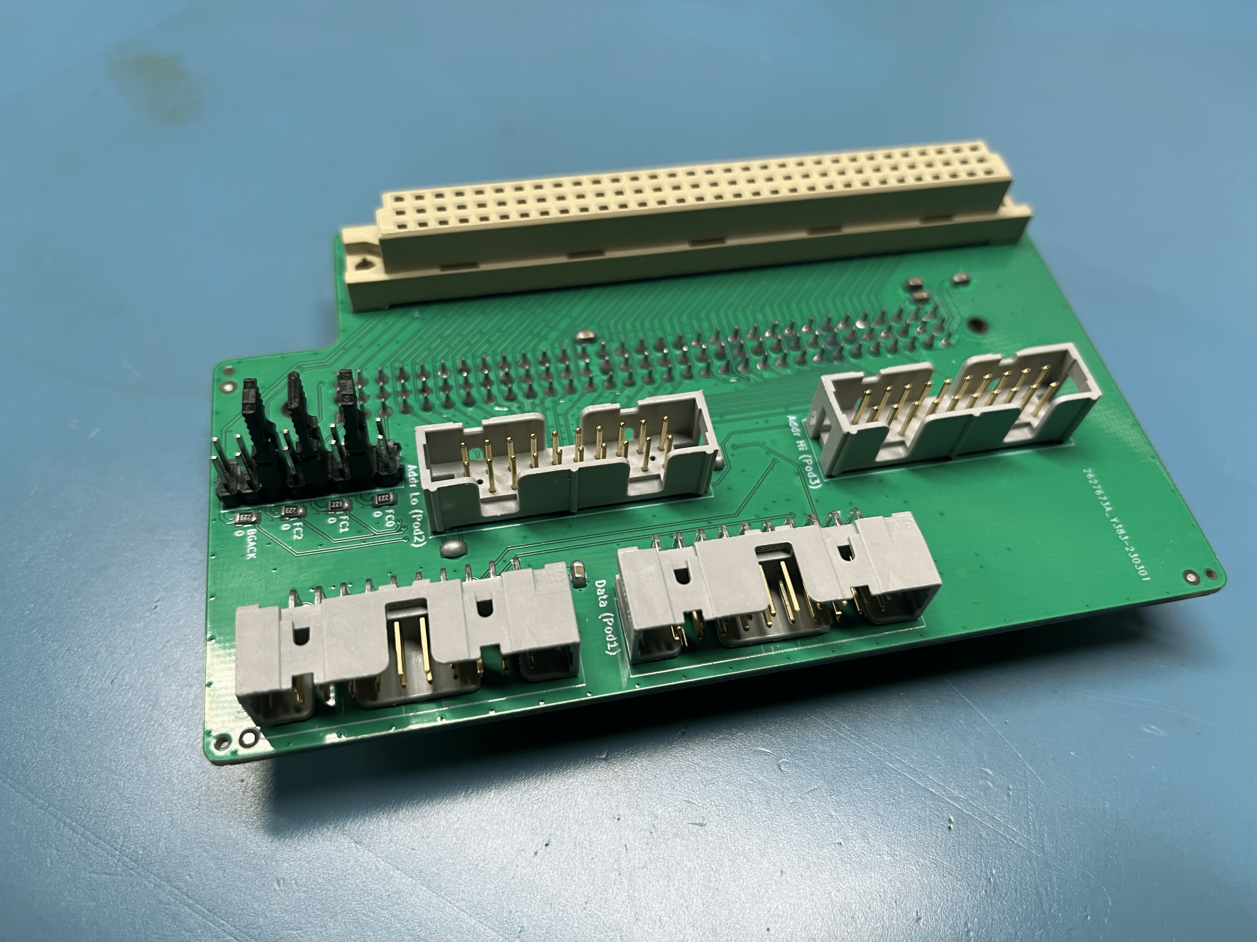

A little more on my development setup. I built this bus probe gizmo to let me directly connect the PDS bus to my logic analyzer. It has a female PDS slot on top so it can accept the WarpSE:

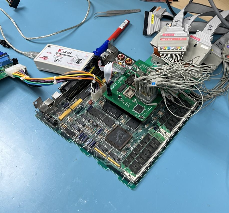

Along with a clip on top of the WarpSE's MC68HC000, this lets me probe basically all of the interesting signals in the system. Here's what it looks like on the lab bench:

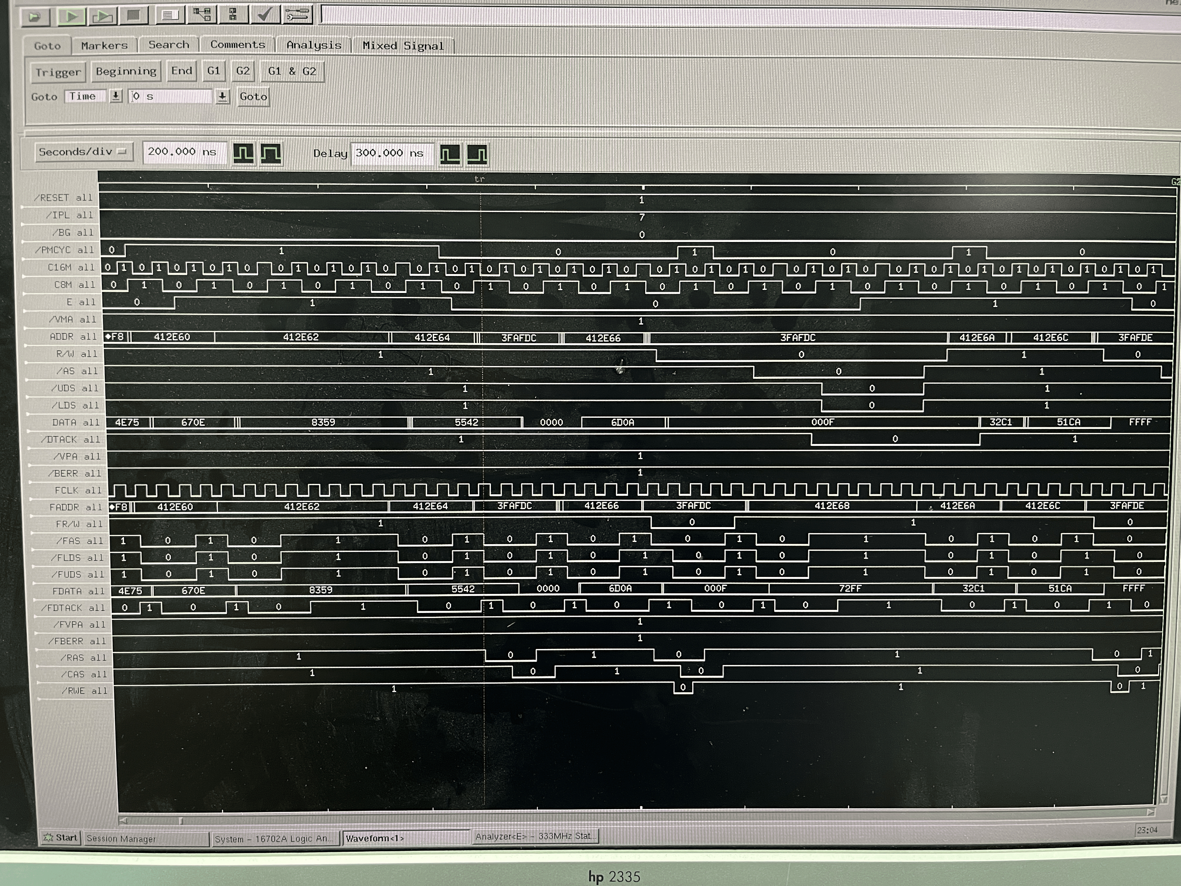

Kind of a big mess of wires but it gets the job done and lets me see everything going on on the analyzer. This is the kind of picture I get on the logic analyzer:
With the ability to look at both buses, I was able to proceed to debug all the problems and get the WarpSE working.
