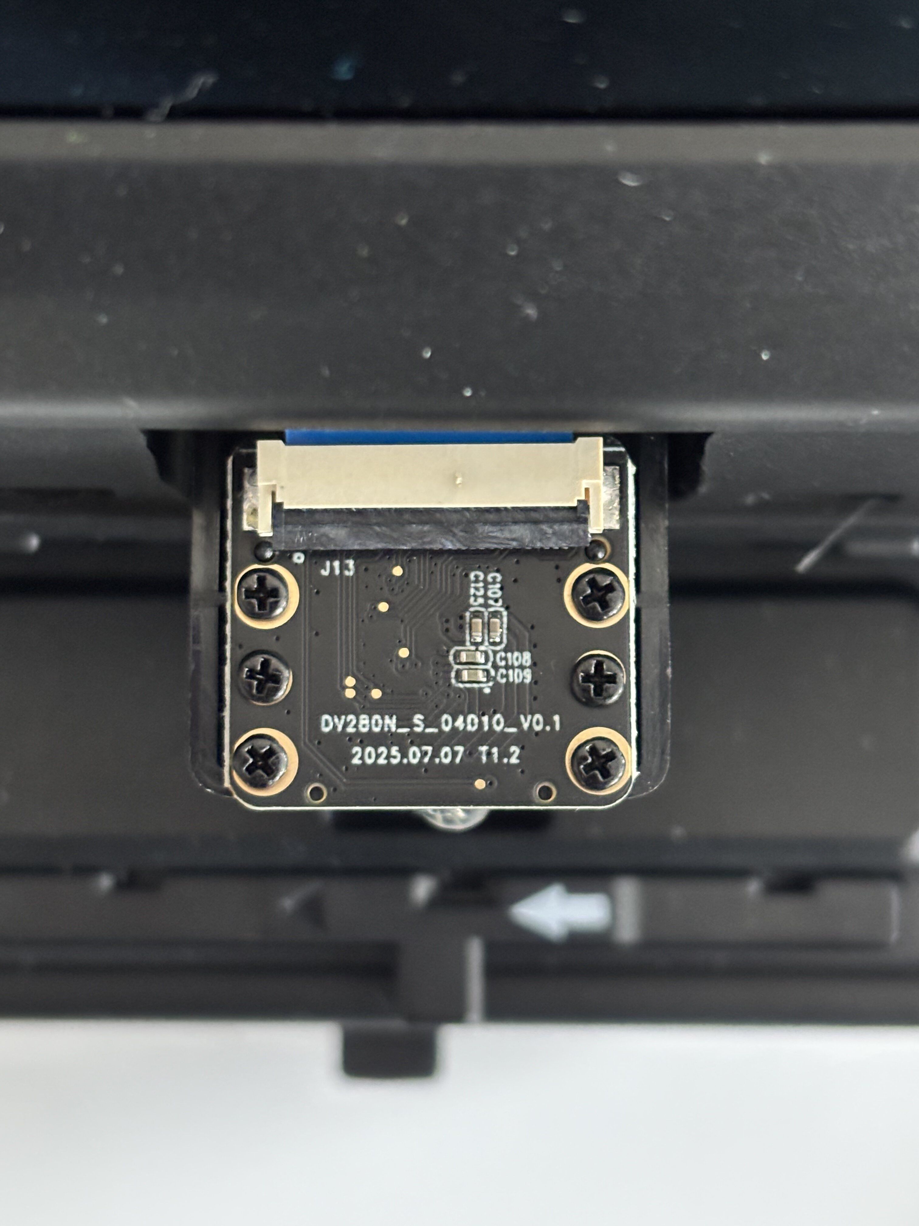

For recent US purchasers from Amazon, what serial numbers are you getting?
H2825, D2825 or something else?

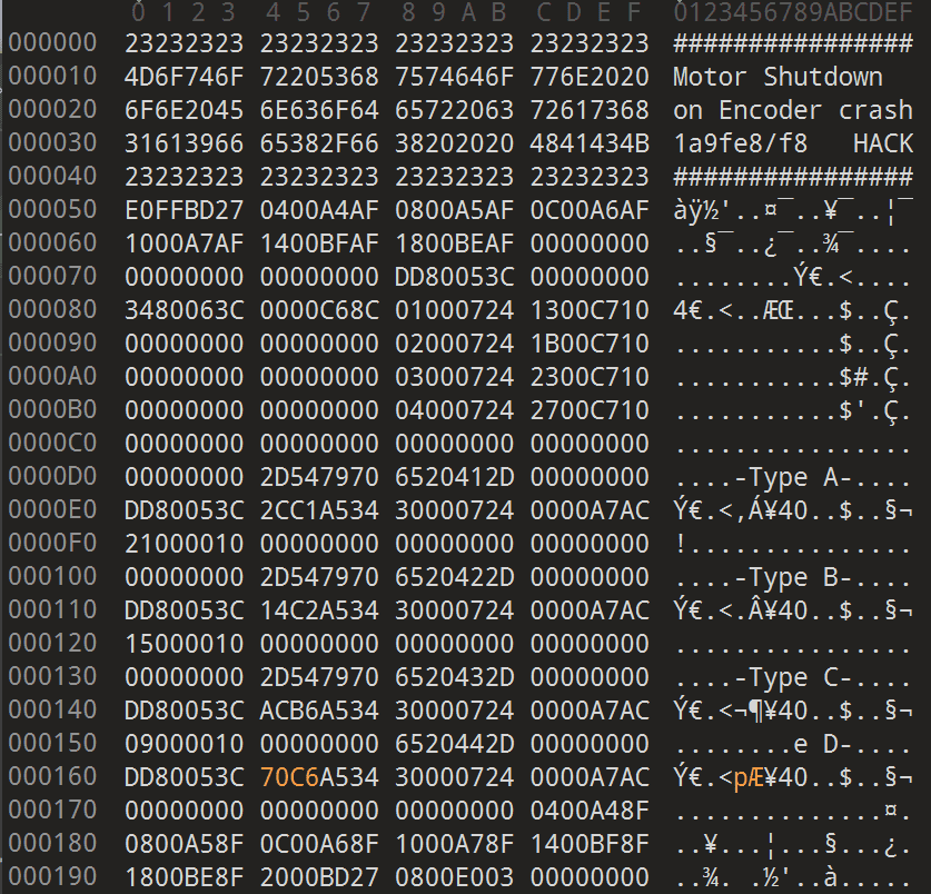

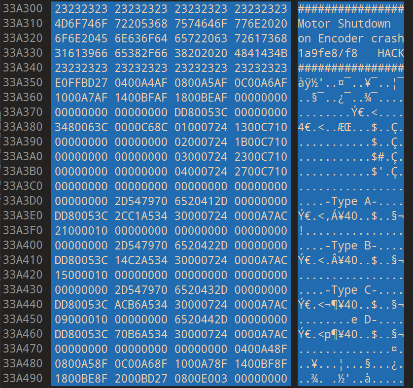

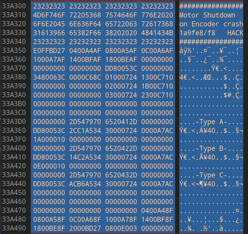

I updated my type-D firmware with the above code changes. This has not merge in your other patches. So you should just grab bytes from 338f28 - 340008. Repo is up to date. Note: the code from 338f28 - 33b200 still will need some Type D support.
Like this motor shutdown code:
If has branches for A thru C, not D yet.
I will have some more time this weekend.
P.S. Attached is the WIP for motor shutdown fix.
I guessing the motor shutdown is at 80ddb670
You can confirm by starting a capture, then:
mem w 80ddb670 30
The motor should immediately stop.

Opps! I made a typo
Try this:
mem w 80ddc670 30
You do not need the motor stop patch code yet, as that is hook to the encode crash, which only happens once you hooked up the rate control (you are ways off from that.)
I'm slowly creating a D-type patch.
Ok, thanks for providing the source code for the RBN utilities, @0dan0.
Indeed, the new command works and stops the motor!
Code:
mem w 80ddc670 30

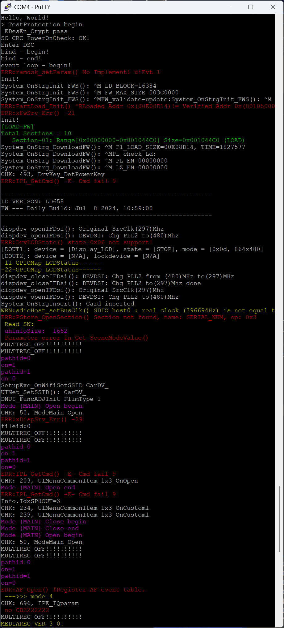

As an aside, I'm seeing this error continuously during capture. Is it normal?
Code:
ERR:UIFlowWndMovie_OnTimer() Record400MinTimeOut 0

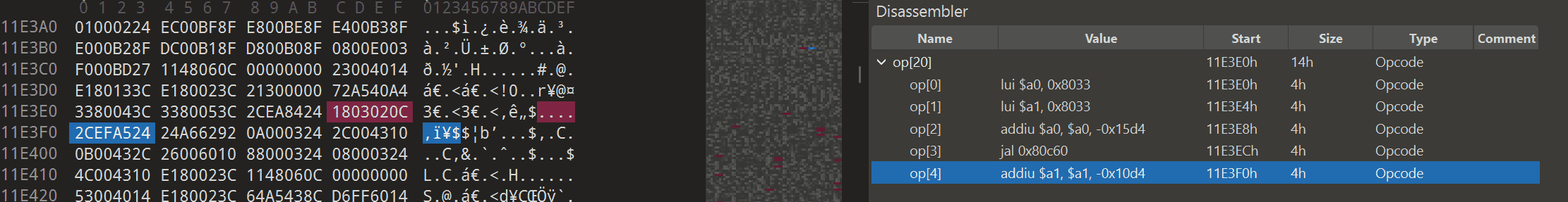

There are a lot of error messages I had suppressed with a NOP over the print console call. I don't remember if this is one of them.
For any string message to find where is it called from:
search on "UIFlowWndMovie_OnTimer"
found at offset 0x32ef2c
This address will be in stored in a0 or a1. As the ERR: UIFlowWndMovie_OnTimer, "ERR:" will be pointed to by a0, and the string we need is in a1.
To find the in the code.
The compiler commonly set up the addresses like this:
lui $a0, 0x8033
addiu $a0, $a0, 0xef2c
If is but confusing at 0xef2c will be treated as -0x10d4 (sign bit, in unsigned math)
So I'm always look for addiu $a0, $a0 ... or addiu $a1, $a1, next to a jal 0x80c60 (call to console - 18 03 02 0C)
addiu $a0, $a0, 0xef2c is (little endian) as 2c ef 84 24
addiu $a1, $a1, 0xef2c is (little endian) as 2c ef a5 24
MIPS run one extra instruction after a call, so it is not wrong that a1 setup is after the jal call.
So string message can be used to find the code. Then use Ghidra at offset 113ef0 to see what is the cause of the message.
However in this case, the error message did not exist in Type A-C, so this is new code.
This will hurt the brain. They are probably better ways.

@0dan0, does this look like the right function to use for your histogram functions? Claude.ai was suggesting I replace a jal at the end of this function (FUN_8008c60), but there some conditions above the end that would cause a return and thus not fire the hook.
The offset looks about right, but I'm away from my computer, so I can't compare, but clearly the auto exposure function has changed significantly from the earlier models. I have been patching a lot of things for type D. The AE hook was one of the last things to do. I will have something to try sometime tomorrow

Thanks for the effort, @0dan0 ! No hard crash, but the buttons are unresponsive on the unit. Here's the complete output from the "Hello World!" string:
Code:
Hello, World!
> TestProtection begin
 EDesEn_Crypt pass
SC CRC PowerOnCheck: OK!
Enter DSC
bind - begin!
bind - end!
event loop - begin!
ERR:ramdsk_setParam() No Implement! uiEvt 1
Init!
System_OnStrgInit_FWS(): ^M LD_BLOCK=16384
System_OnStrgInit_FWS(): ^M FW_MAX_SIZE=003C0000
System_OnStrgInit_FWS(): ^MFW_validate-update:System_OnStrgInit_FWS():
^MFW is just updated.
System_OnStrgInit_FWS(): ^M ok
ERR:PartLoad_Init() ^RLoaded Addr 0x(80E08DAC)!= Verified Addr 0x(80106000)
ERR:xFwSrv_Err() -21
Init!
[LOAD-FW]
Total Sections = 10
   Section-01: Range[0x80000000~0x801055F0] Size=0x001055F0 (LOAD)
System_OnStrg_DownloadFW(): ^M P1_LOAD_SIZE=00E08DAC, TIME=28017927
System_OnStrg_DownloadFW(): ^MPL_check_Ld:
System_OnStrg_DownloadFW(): ^M PL_EN=00000000
System_OnStrg_DownloadFW(): ^M LZ_EN=00000000
ERR:IPL_GetCmd() -E- Cmd fail 9
LD VERISON: LD658
FW --- Daily Build: Aug 22 2025, 11:52:51
dispdev_openIFDsi(): Original SrcClk(297)Mhz
dispdev_openIFDsi(): DEVDSI: Chg PLL2 to(480)Mhz
ERR:DrvLCDState() state=0x06 not support!
[DOUT1]: device = [Display_LCD], state = [STOP], mode = [0x0d, 864x480]
[DOUT2]: device = [N/A], lockdevice = [N/A]
-11-GPIOMap_LCDStatus------
-22-GPIOMap_LCDStatus------
dispdev_closeIFDsi(): DEVDSI: Chg PLL2 from (480)MHz to(297)MHz
dispdev_closeIFDsi(): DEVDSI: Chg PLL2 to(297)Mhz done
System_OnStrgInsert(): Card inserted
WRN:sdioHost_setBusClk() SDIO host0 : real clock (396694Hz) is not equal to desired (399000Hz)
Detected A:\NVTDELFW, delete A:\FWDV280.BIN
UINet_SetPASSPHRASE(): 12345678
 Parameter error in Get_SceneModeValue()
MULTIREC_OFF!!!!!!!!!!
pathid=0
on=1
pathid=1
on=0
SetupExe_OnWifiSetSSID CarDV_
UINet_SetSSID(): CarDV_
 UIInfo: PStore sys param not save before load pstore!!!
ERR:PStore_OpenSection() Section not found, name: SERIAL_NUM, op: 0x3
 Read SN:
 uhInfoSize:  1652
pathid=0
on=1
pathid=1
on=0
DNUI_FuncADJInit FlimType 0
Mode {MAIN} Open begin
CHK: 50, ModeMain_Open
ERR:xDispSrv_Err() -29
ERR:FileDB_GetInfoByHandle() This Handle is not created(0)
fileid:0
pathid=0
on=1
pathid=1

In my version, I've got a hook working for the histogram, but a crash just before it starts to draw the histogram. (I've kept a test green rectangle in the video frame to see how far down the code in hist.c I can get before the crash). I don't think I have the right expo_iso yet. I used the value you had in your commit two days ago for reelType 4, but you may have updated in your working version.
My current reelType == 4 values are:
Code:
expo_iso = (int *)0x80e5590c; //sensor ISO by 0dan0;
nvm_base = (int *)0x80E0ADA4; // confirmed by 0dan0
button = (uint32_t *)0x80E8B7D0; // confirmed working
frameno = (int *)0x80f82464;
That's annoying, crash or looping error messages would have been easier for next steps.
hist.c code will not run without the support from the other functions starting at 0x338f80.

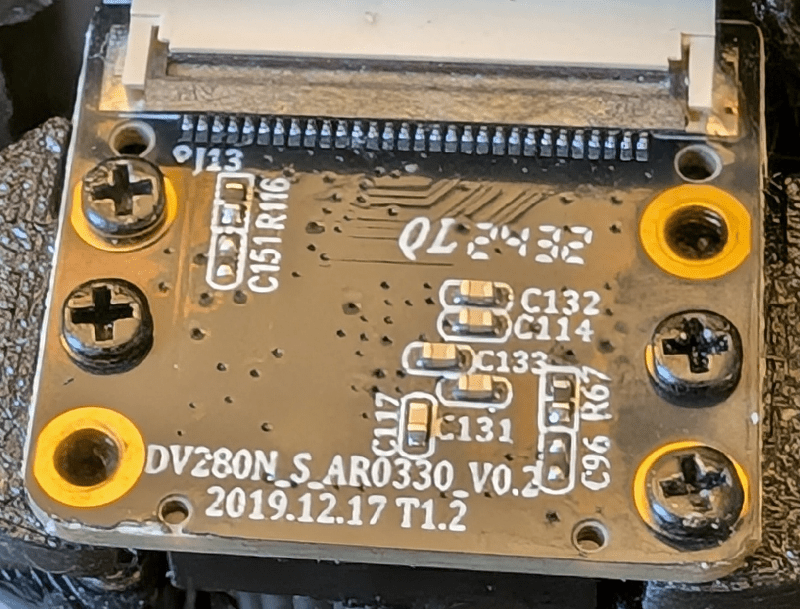

Some good news, and some bad news.
From Type D
> ERR:ChgMode_OS04D10() ChgMode_OS04D10 to 1...
From Type C
> ERR:ChgMode_AR0330() ChgMode_AR0330 to 4...
Look like we know what has changed in these newer units, they have switched out the image sensor from Aptina AR0330, to an OmniVision OS04D. The good news is this is a nice newer sensor, not really more resolution, but better signal to noise. Can you remove the sensor hood and photograph your sensor board?
AR0330 board (Type A,B & C):
The bad news, this likely why things are so different and will slow full support.
That annoying, crash or looping error messages would have been easier for next steps.
From Type D
From Type C
Here’s the sensor on my D unit.
From at 2019 to 2025 board date. I think I will have to get a type D unit, both to work the port, and test the quality.
What you can do, is add prints to the code, to find where it is stopping.
Type D: fileid:0 <- last message???
Type C:
fileid:6
ERR:IPL_FCB_AlgIE() ^GWDR OFF..
pathid=0
on=1
pathid=1
on=0
ERR:IPL_FCB_AlgIE() ^GWDR ON..
Mode {MAIN} Open end
Info.IdxSP8OUT=3
corner :632 328
new crn:312 88
new sze:1440 1080
proc:1440 1080
The last five lines is from my code. Code at 0x339d60.
Type C:
I’ll test again, but that’s where the process froze. We’ll get this solved!
Did you determine all four type 4 variables for your host.c?
