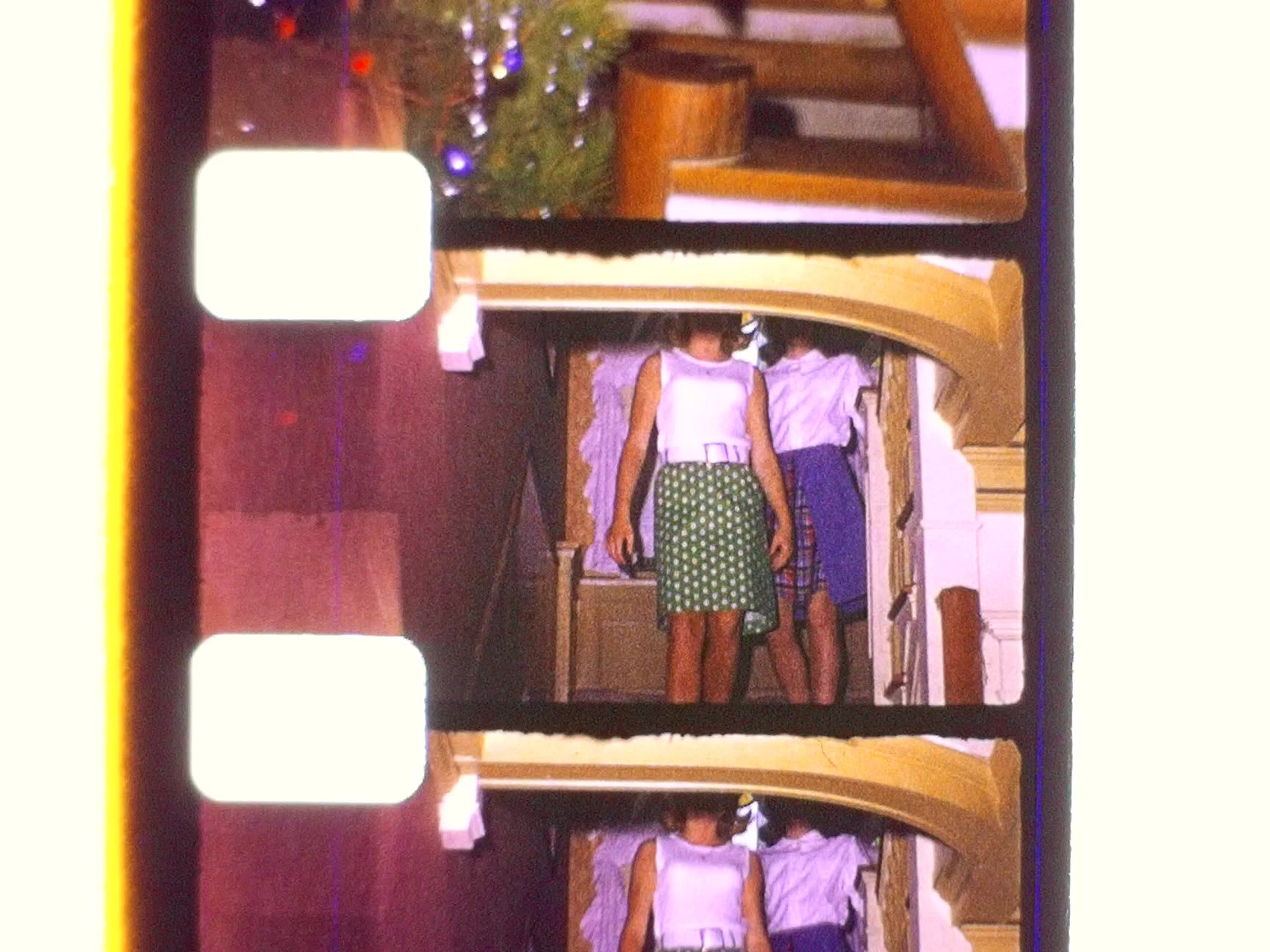

I'm assuming the same lens. Please do a full overscan, need to see the sprockets.
The smaller pixels will slight help the original lens, increasing your scan resolution 10%. New 12mm lens will still be a better setup.

That is weirdly wide for a stock lens and unmodified firmware.
Perhaps they also upgraded the lens in Type D units? And/or the stock Type D firmware has been modified from A-C's to capture a wider FOV?
To be this wide, this is either downgraded the lens (even wider) or they have following this development and a planing a future lens swap.
From at 2019 to 2025 board date. I think I will have to get a type D unit, both to work the port, and test the quality.

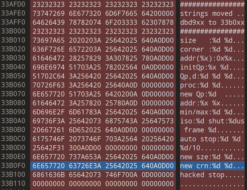

Anywhere you can add 34 80 04 3C 18 03 02 0C F0 B0 84 24
F0 B0 points to the string at 33B0F0. Value in a1 goes to the first %d, a2 the second %d, and so on. Add you own string messages as needed.
The first area to investigate, are the calls to setting resolution.
Attached is an example of print added to the beginning of New Capture Res. This should be the first entry point. It will crash after the print outs.

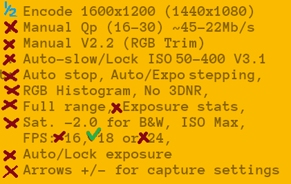

D-type has only 5% of the features ported. The resolution change has no benefit without the in-pinning resolution fixes, not yet ported. Only has 18fps, and lock white balance, AFAIK. No increase bit-rate.
Need a few more weeks.
