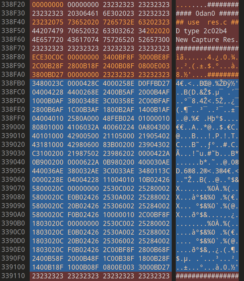

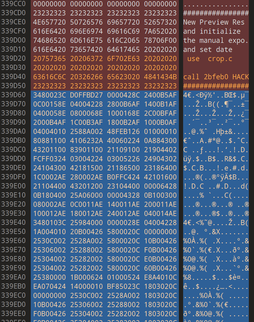

in the rbn, search on res.c and crop.c
This is where the res.c binary goes (bytes in blue.)
This where crop.c binary goes:
Hmmm... well, here's the code I compiled:
Code:
#include <stdint.h>
//extern void console(const char *ctx, int a, int b);
extern void consoleD(const char *ctx, int a, int b);
void res_mod(void)
    register uintptr_t s1val asm("s1");
    uint32_t *scanSize = (uint32_t *)s1val;
        char* format_old_offsets = (char *)0x8033b020;
        char* format_new_offsets = (char *)0x8033b0f0;
        char* format_old_sizes = (char *)0x8033b010;
//      char* format_new_sizes = (char *)0x8033b0e0;
    uint32_t width = scanSize[0x40 >> 2];
    uint32_t height = scanSize[0x44 >> 2];
    uint32_t x_off = scanSize[0x38 >> 2];
    uint32_t y_off = scanSize[0x3c >> 2];
//    int32_t new_width = width;
//      volatile int* reelType = (int *)0x80340000;
//      if(*reelType < 4)
  //      new_width = (width-440)*4;  // Math good for A thru C, not for D
//    if (1600 < new_width) new_width = 1600;
//    int32_t new_height = (new_width*3)>>2;
//    int32_t new_x_off = (int)x_off + (width>>1) - (new_width>>1);
//    int32_t new_y_off = (int)y_off + (height>>1) - (new_height>>1);
//    if(new_x_off < 0) new_x_off = 0;
//    if(new_y_off < 0) new_y_off = 0;
 //   scanSize[0x40 >> 2] = new_width;
 //   scanSize[0x44 >> 2] = new_height;
 //   scanSize[0x38 >> 2] = new_x_off;
 //   scanSize[0x3c >> 2] = new_y_off;
   //     console(format_old_sizes, width, height);
     //   console(format_new_sizes, new_width, new_height);
       // console(format_old_offsets, x_off, y_off);
       // console(format_new_offsets, new_x_off, new_y_off);
 //   else
        consoleD(format_old_sizes, width, height);
      //  consoleD(format_new_sizes, new_width, new_height);
        consoleD(format_old_offsets, x_off, y_off);
        //consoleD(format_new_offsets, new_x_off, new_y_off);
        return;
int main(void)
    res_mod();
    return 0;
and while it didn't crash, the unit is frozen on the main menu page, and this is the output starting with the ERR:AF_Open():

the crash is within the memory space of where I'm inserting the res.c binary. I've done the typical removal of ELF headers, etc that I've done with your other C++ mods.
The last version you showed was working, what did you change. Can I see the .rbn?
