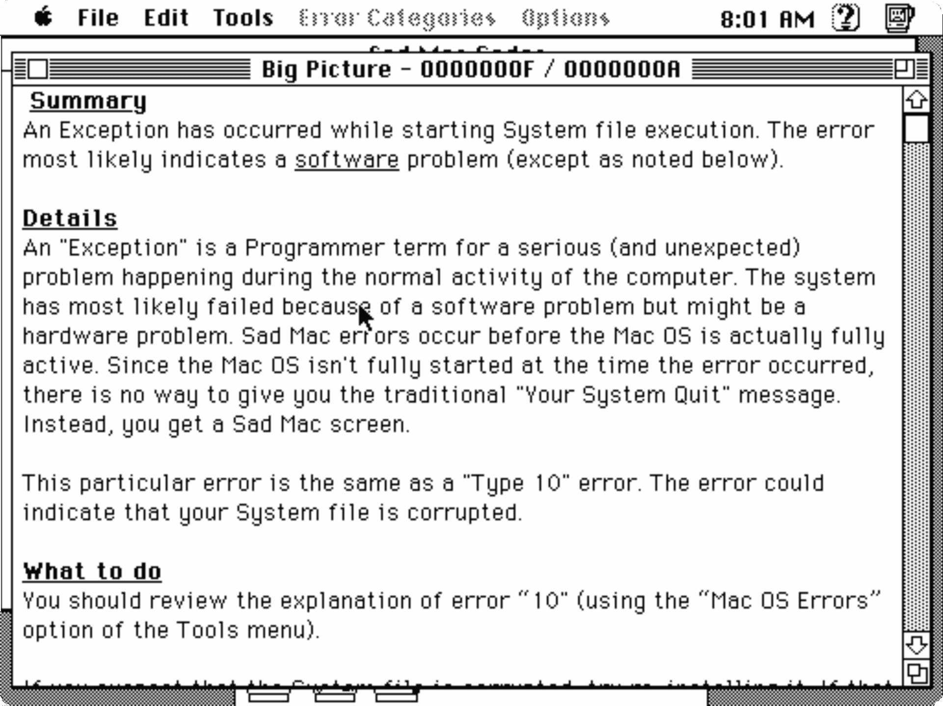

I checked for further insights with the 0000000F 0000000A Sad Mac error code. This is what I learned. That would explain the normal startup bong sound and as the Mac starts up, this comes up?
Excerpted from Black & Bleu™/Pro v10.0
Sad Mac Error (0000000F / 0000000A)​
User Explanation​
Summary​
An Exception has occurred while starting System file execution. The error most likely indicates a software problem (except as noted below).​
Details​
An "Exception" is a Programmer term for a serious (and unexpected) problem happening during the normal activity of the computer. The system has most likely failed because of a software problem but might be a hardware problem. Sad Mac errors occur before the Mac OS is actually fully active. Since the Mac OS isn't fully started at the time the error occurred, there is no way to give you the traditional "Your System Quit" message. Instead, you get a Sad Mac screen.​
This particular error is the same as a "Type 10" error. The error could indicate that your System file is corrupted.​
What to do​
You should review the explanation of error “10" (using the “Mac OS Errors” option of the Tools menu).​
If you suspect that the System file is corrupted, try re-installing it. If that fails to solve the problem, you are probably having a hardware failure. The System file can appear to be corrupted because of bad RAM or a bad disk. These possibilities can only be evaluated with certainty by an Apple Repair shop. Consider having your system examined if you don't feel capable of doing it yourself.​
Thanks for checking. In fact the Mac did not have any disk attached to it, so it is very early in the boot process.
