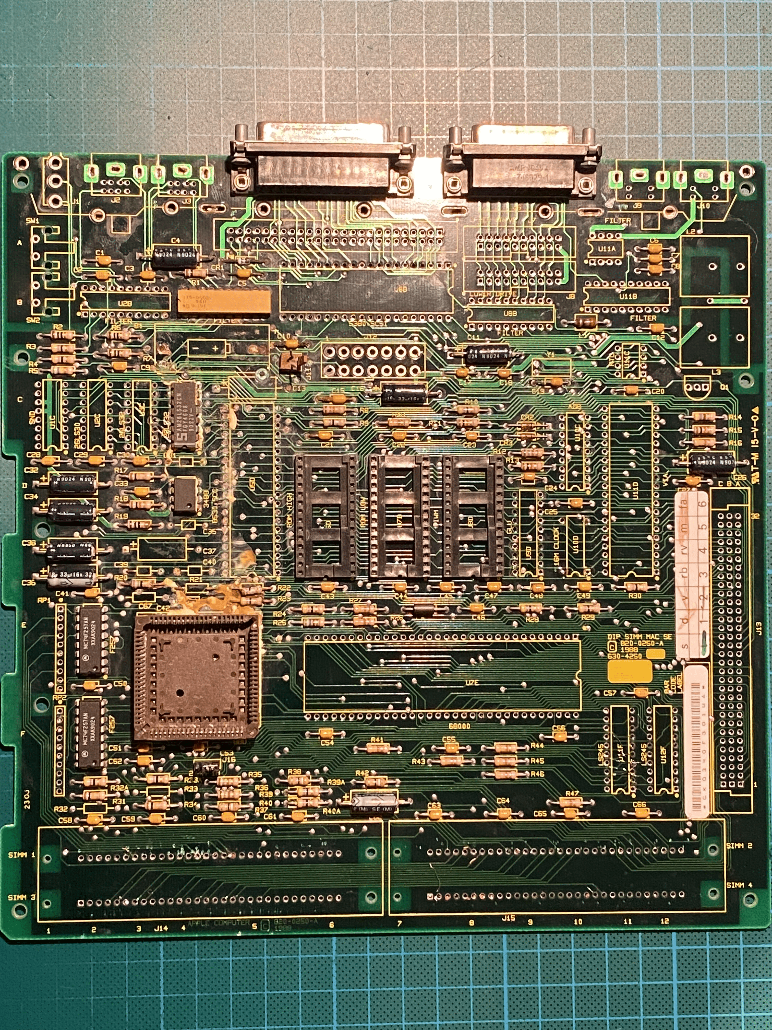

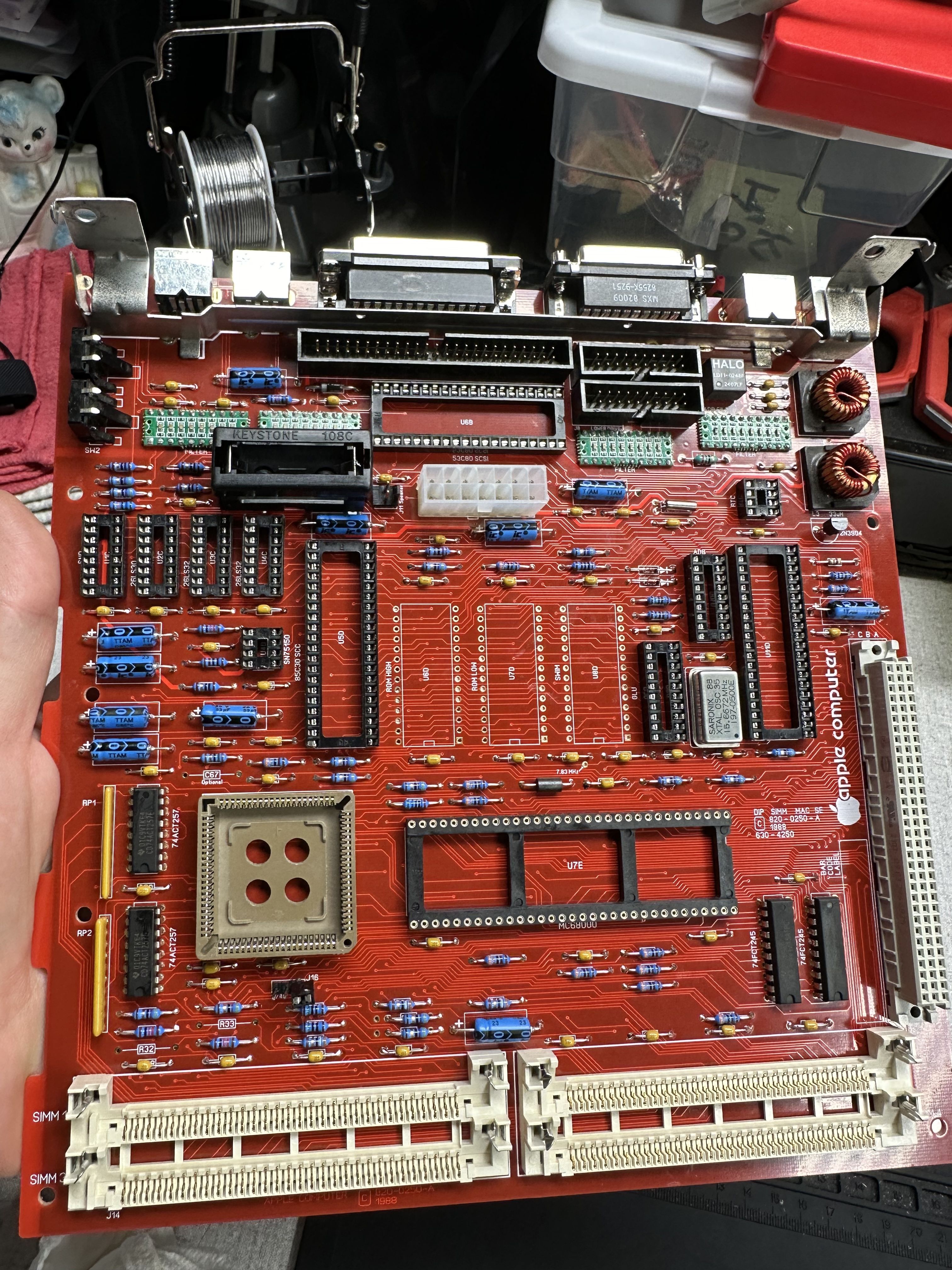

Fred - did you notice the 65C22N in the space of the 53C80 SCSI controller?
Yikes! I overlooked that error when examining his photo, Kai. Could that have killed another chip on the board?
Unfortunately still stuck here!
Fred, can you please tell us exactly what you did prior to reporting that you are still stuck? (For example, I gave you a 7-point list in my previous post.)
Even so, my concern now is about what Kai pointed out. Using a 65C22N in the socket intended for a 53C80 is a potential problem.
I put the correct chip in place of the wrong one and I too was concerned as to what else may have been damaged. I replaced the Ram with tested ram even though it was OK. Replaced the BBU as it was causing boot errors in test board. Checked board for solder bridges. So I now have a new 65c22 in the correct place the 53C80 SCSI in the correct socket. . I think something else is damaged as on first reboot I got vertical lines and then a partial unhappy mac image. But when I rebooted again back to the strange chequerboard. Put the ROM IWM BBU and RAM back in donor and all still work.

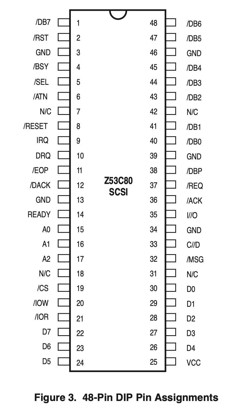

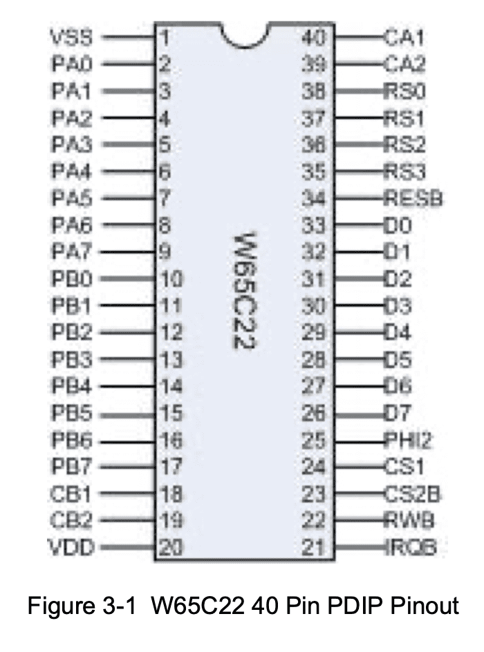

Well, it's going to take time to figure out which chips might be damaged due to the error of putting the 65C22N in the socket intended for a 53C80. You can see from my previous post that the correct SCSI chip has multiple Grounds, which means every pin marked GND gets constant Ground. Which means if the 65C22N ever did get powered, any HI output from the 65C22N on pins marked GND would have been a direct short and could have likely killed the 65C22N chip. That wouldn't be an issue since you have another 65C22N in the correct socket, but I suspect the 65C22N in the wrong socket is no longer usable.
But the question now is what about the other pins. We know from the drawings in my previous post that the 65C22N Ground is VSS pin-1. /DB7 is a signal on pin-1 of the SCSI chip. So if that signal wire acted as a chip Ground for the 65C22N, I wonder if /DB7 sourced more current than it was intended to source, and if so, which chip sourced that current. We also know pin-25 on the SCSI chip is constant Vcc 5V, and that was IRQB. Might have impacted the 65C22N, but it should have impacted anything else on the motherboard.
We also know that VDD (5V input) is pin 20 on the 65C22N, which is D5 on the SCSI chip socket. So the 65C22N chip was probably trying to draw its 5V power through D5 whenever 65C22N pin-1 received Ground.

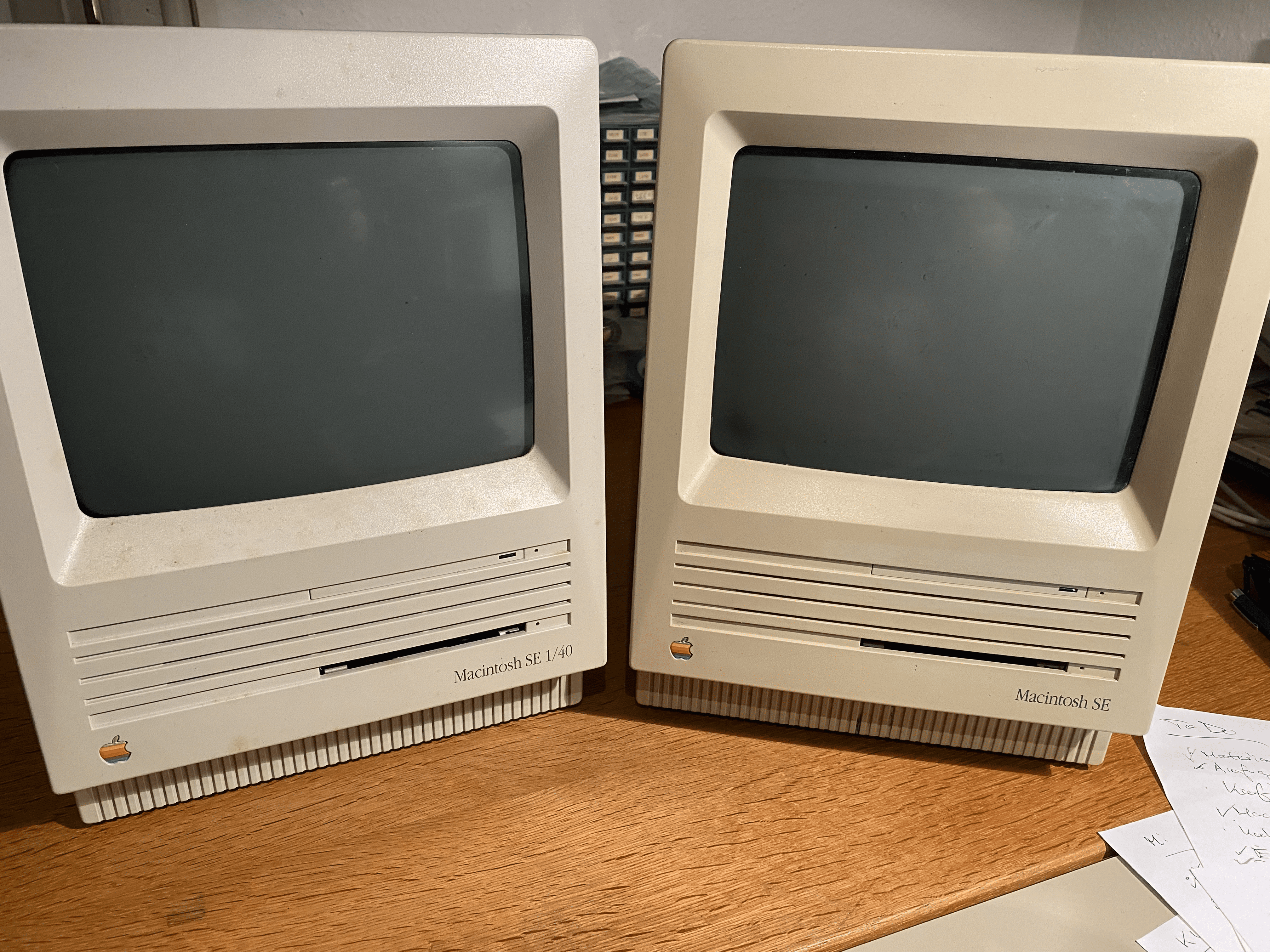

Hello community
I got two SEs last year. One SE (5010) in working condition and the other SE 1/40 (M5011) with an exploded battery.
As you can see I've desoldered most of the critical components. The BBU has slightly corroded pins, which could be treated with white vinegar and the dremel to polish it.
Having the running machine helped me testing some components and I can confirm, the BBU, SWIM, both ROM work. So does the rest of the chassis of the M5011.
Hence the next step is ordering and soldering a spare PCB.

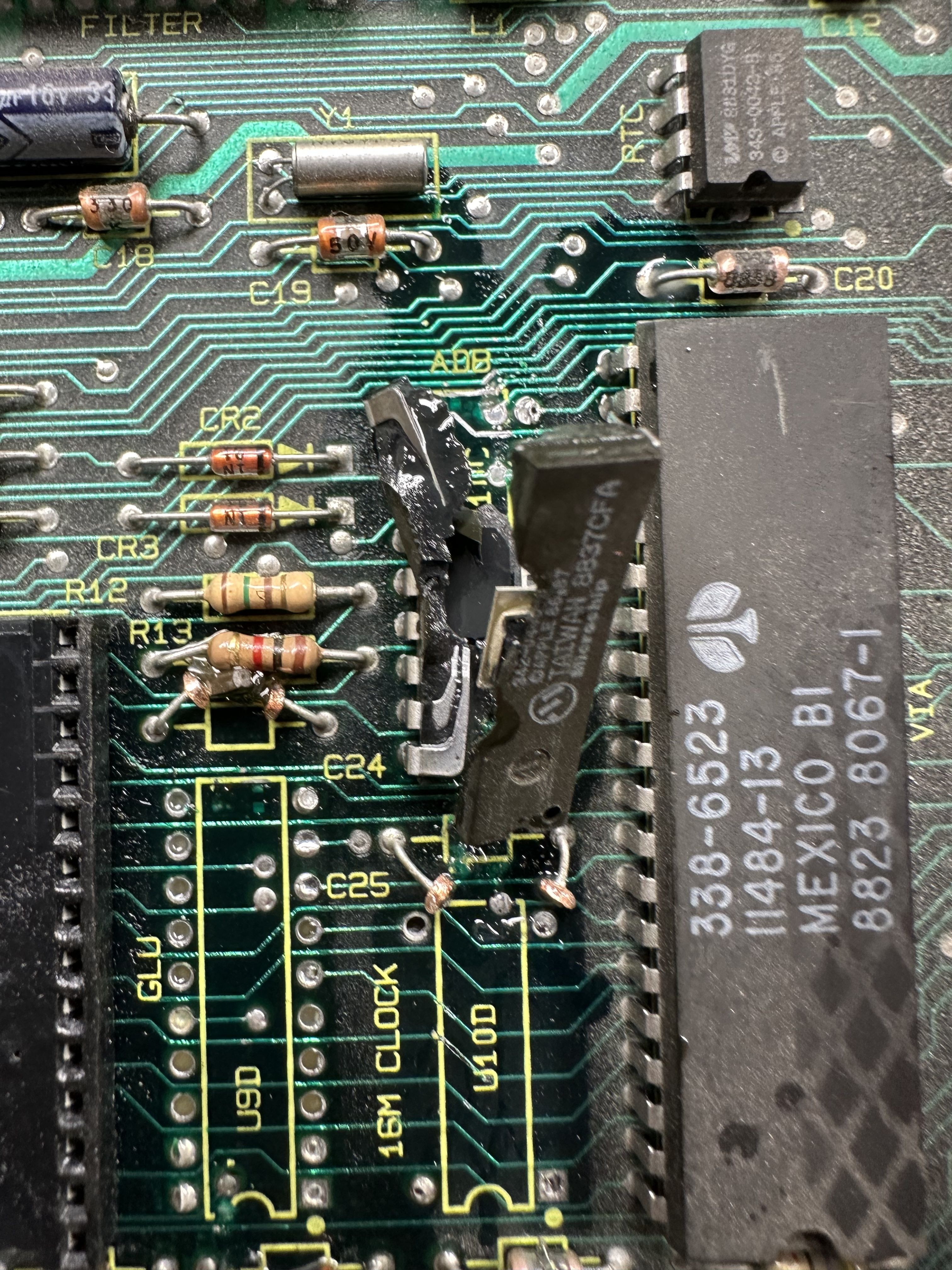

I've been involved in one of these builds, about 9 hours into things with all going well....except for a couple of small parts that I still need to get [the kit I purchased with sockets, had the wrong size 28-pin connectors...too narrow]...but that part is all good.
However...with the thrills of victory, comes the agony of defeat. While removing chips from the old board [mainly ADB]...thinking I had removed enough solder to hot air station the rest out....disaster struck [picture attached]. Thankfully, there are some modern replacements to cover up this little error in judgement [lesson learned].
If there's anyone out there who might either have a spare 'genuine' ADB chip, one of the PIC16F88 replacements already programmed [I don't have a programmer, but might need to get one]....or one of Kai's adapters that's in a completed state that they're willing to sell...please PM me.

Well, that's one way to decap an IC!
My recommendation would be to build a new one from a PIC16F88 - not sure if there's anyone local to you that might have one - @max1zzz might have a DIP one floating around?

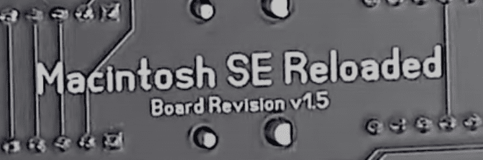

Just wanted to chime in with a problem I had with my Macintosh SE Reloaded board from MacEffects - an internal trace was missing/broken from one of the three RAM configuration jumper pins. So no matter what my configuration was, I would get a crash upon boot that looked a lot like the ones I've seen on the last few pages of this thread! I ran a jumper and it fixed everything.
I can't remember the details of which one was missing, but check the schematics and see if all three pins go to where they should.
EDIT: I'm thinking it was the center pin which should be grounded since that's the only internal one.
Kai, is the MacEffects board a revision older than the matte black boards you kindly sent to me a long time ago?
The reason I ask is because I never had a problem with RAM configurations on my matte black boards.
As mentioned in the section of my video below, my matte black boards are revision 1.5 (not 1.5b) and I had to do one fix which I describe below:

There was a minor revision recently to add a breakout address pin to support the use of the larger ROM from the classic, but no - the MacEffects boards are a later revision than the original black and gold ones. I've checked the gerbers and they look fine from there so it must be a manufacturing error - @MacEffects have there been any complaints from recent purchases?
I've not heard of any complaints with the SE boards but then again they've not been selling with any level of frequncy recently. If you need a replacement, please feel free to PM me and I can get you taken care of.

To be clear I submitted a complaint 2024-01-09. The response I received on Jan 9 (from Mark) seemed to misinterpret my complaint as a question about the jumpers or about revisions. I didn't follow up after that though.
...SE Reloaded board from MacEffects - an internal trace was missing/broken from one of the three RAM configuration jumper pins. Check the schematics and see if all 3 pins go to where they should. EDIT: I'm thinking it was the center pin which should be grounded since that's the only internal one. I would get a crash upon boot that looked a lot like the ones I've seen on the last few pages of this thread! I ran a jumper and it fixed everything.
You are talking about J16, which looks like this on my matte black board:
I never had a problem with it because I didn't use a jumper on it, and that's because I use 4MB of RAM, which doesn't require any jumper. I never tested lower RAM configurations because those configs didn't make any sense to me. It's now 2024, so I was thinking that everyone would most likely use 4MB of RAM, which again, doesn't require a jumper. I can only guess you are trying to use a lower amount of RAM and therefore need a jumper. So it could be you found something nobody else has only because you are the first person who wanted to use less than 4MB of RAM? If so, please tell us what RAM amount and what jumper config you used.
Let it be know that my matte black board is older than what MacEffects sells because mine is v1.5:
The newest SE Reloaded board revision seems to be v1.6 as per what is on Kai's Github page here:
@JdM74 , you have the red-colored v.1.5b MacEffects SE Reloaded board that seems to be what @callanbrown has. It's logical to conclude that your board would have the same J16-related issue that he mentions, so if you are able to check the schematics to see what the problem might be (sorry, I can't find the link right now and I need to get off to work), maybe then we can get to the bottom of this.
